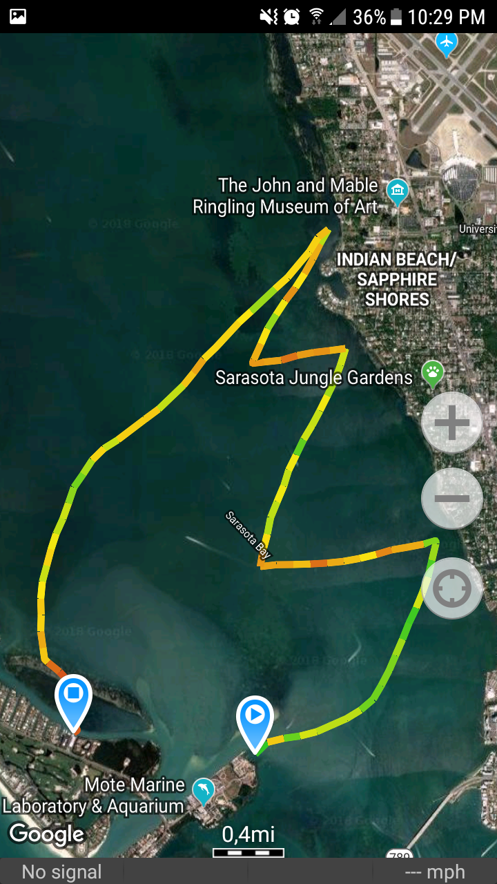

Here's a sail from a few weeks back. It demostrates exactly what JimInPb says.
The goal was to sail from the ramp to the back side of the Ringly museum then to the Dry Dock Restaraunt for lunch. I had never sailed to the Dry Dock. I looked at a nautical chart and it looked like it was next to a deep channel with a shallow area in front. I checked google maps and the shallows looked to me like they might have mangroves on them. I set in my mind that i was looking for an entrance to a channel behind mangroves. Find mangroves, then follow the maze with my left hand until i find the opening. Motor down the channel.
Theres no mangroves. The google images is just sand and some vegetation showing through.
The sailing was great. I got a max speed of 6.7kt (34% over hull speed) and tried out some new telltales in what i think are the best locations for the sail controls i have. It was cool to get a view of the Ca' d'Zan from the bay and have a plane fly a couple hundred feet over us on aporoach to SRQ. You know there was some person looking out the window and is now hooked on sailing watching us livin the dream .

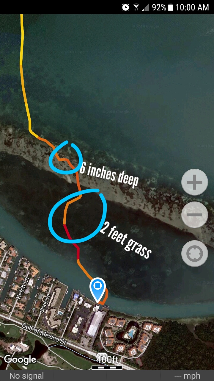

Were on the other side of the bay now, all on the lookout for the entrance to the channel when the centerboard starts bouncing. We unclip the bungee and raise the board to 1/4 (motoring) depth. Its getting calm out and were almost on downwind safety run so no problem with that. The rudder starts dragging too now. Im totally confused because there is no mangrove sandbar. We look around and there's the dry dock just a little bit more downwind.
At this point the rudder is dragging too so that is pulled up. It's still in water so i can steer a little, but trying to be careful so it doesnt snap. The water is like 6-9 inches deep and we are going about 2-3 knots over it.
Realizing that the dry dock is much closer than expected the call is made to furl the jib so its not a hassle later and its easy to shield as we are heading downwind.
Within moments i realize furling the jib was a bad decision. With just a 5kt wind and not enough leading edge of rudder i am not able to keep the bow downwind towards the restaurant. No heel, we are level. The rudder is sticking straight out with the tiller off to the side and making a huge spashing sound as it churns the water while i fight to stay downwind. Rudder is 100% stalled with severe weather helm. Soon we are over the sandbar and on top of a gorgeous clear section of water about 2-3 feet deep with some lush green flowery plants growing at the bottom. We're all lost looking down as we ghost over it. We are almost nose to the wind now and drifting downwind.
The main comes down and the jib is unfurled. Im hesitant to drop the rudder over the grassy section but the jib pulls us nicely past the dock for our motor to the dock. In deeper water of the channel i should have lowered the rudder.
How we run the trolling motor with the rudder straight out while pushing the bow upwind is another post, but we did get to enjoy the Dry Dock.
Ive sailed just the main most of the time, but always with a correctly positioned rudder. Without a jib the rudder has to make up the difference. I knew that before, but it did not feel obvious. It was a chaotic experience with just minimal wind downwind with just a main, over 6 inches of water and no rudder. I lost control. If there was more wind it would gave led to a more interesting experience.
Poor balance leads to chaos, which leads to mistakes.
