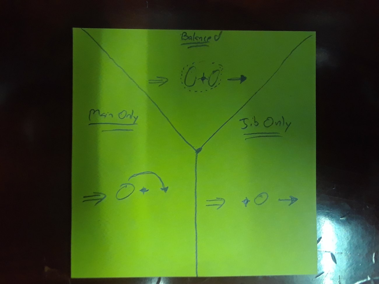

Imagine you could place three lines on a boat.
One line would be tied to the centerboard and then anchored to seabed on short rode.
Line two would represent the forces on the main and would be attached to the main in the bottom third, about one third from mast.
Line three would represent the jib forces and be placed on the jib about one third from leading edge, bottom third. Line two and three are basically attached on the average lifting surface of sails.
If you pull the mainsheet line only the boat will spin around the centerboard anchor then heel. This is unstable, a backwards arrow. When sailing the rudder keeps the bow opposite the force and the bouyancy of bow keeps boat from flipping head over heels, to some point. The centerboard trips the boat and even too much force can overwhelm bow bouyancy.
The same experiment but just pull the headsail line. The boat will rotate around centerboad line some, but instead of heeling will be kept up by bouyancy of bow.
Pull both strings at same time and the main force is countered by the headsail force. There is less rotational force when both lines are twisted together and pulled as one.

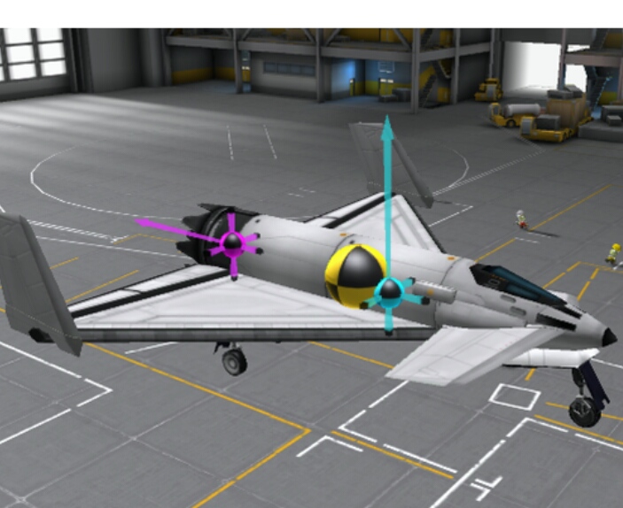

My kids have a video game called Kerbal Space Program. Players are supposed to make space ships and place them in orbit around the fictional star system using pre fabricated rocket parts.
My kids and I instead make "space stations" that have sailboat features.
The main, headsail, and keel are all engines on supports. We can twist the engines into various direction, and place them anywhere.
Fascinating to watch the orbiting sailboats get into unusual spins and then spin apart in a fantastic high G explosions.
The designer allow the player to see the center of mass, thrust, and lift before deployment. By managing the lift and thrust and center of mass we can get these to change orbit without too much spinning.
