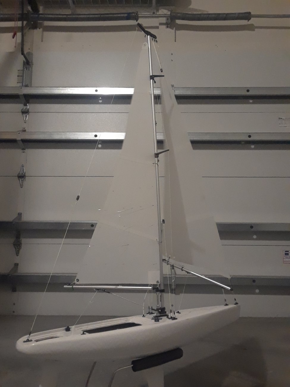

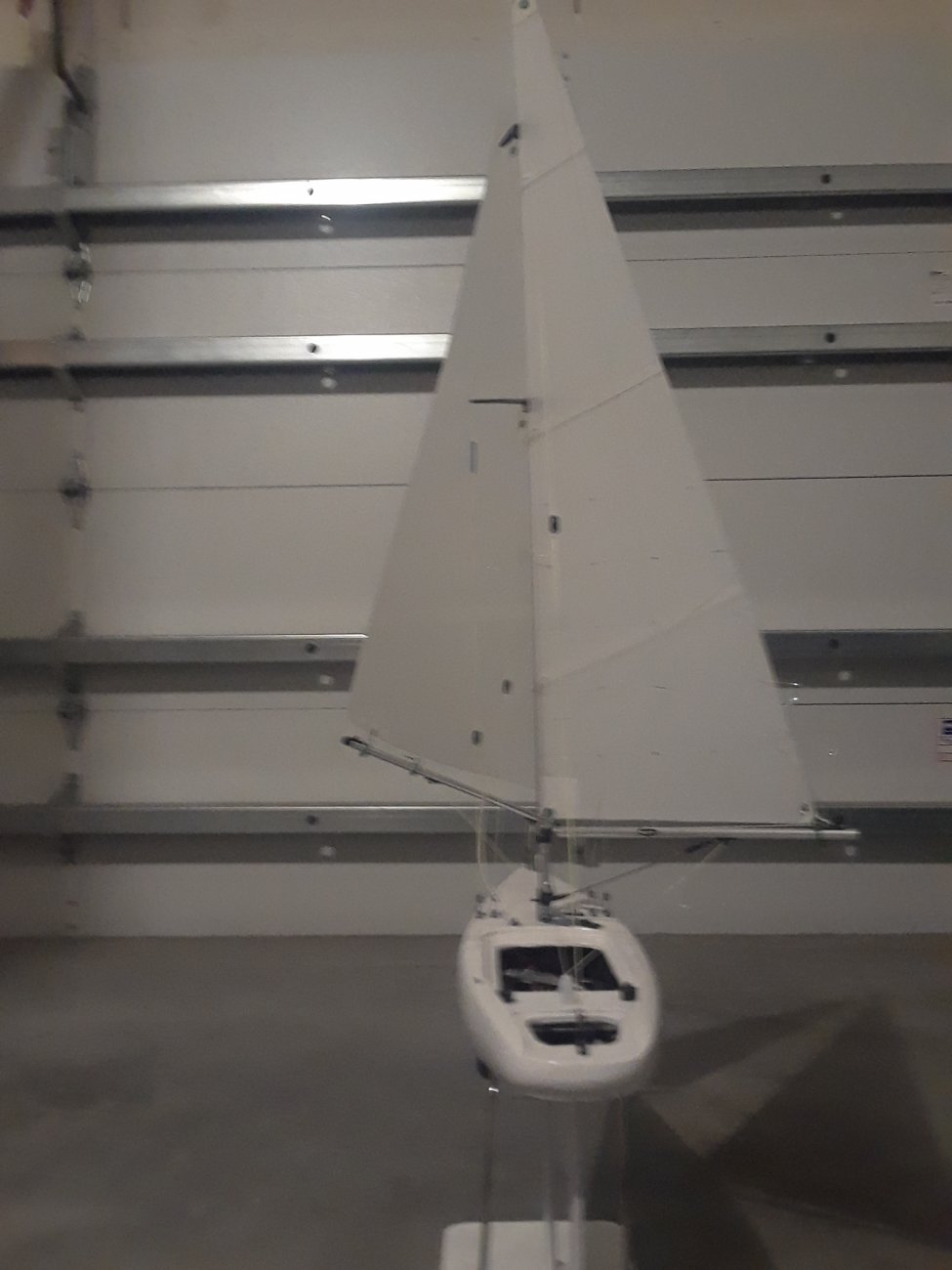

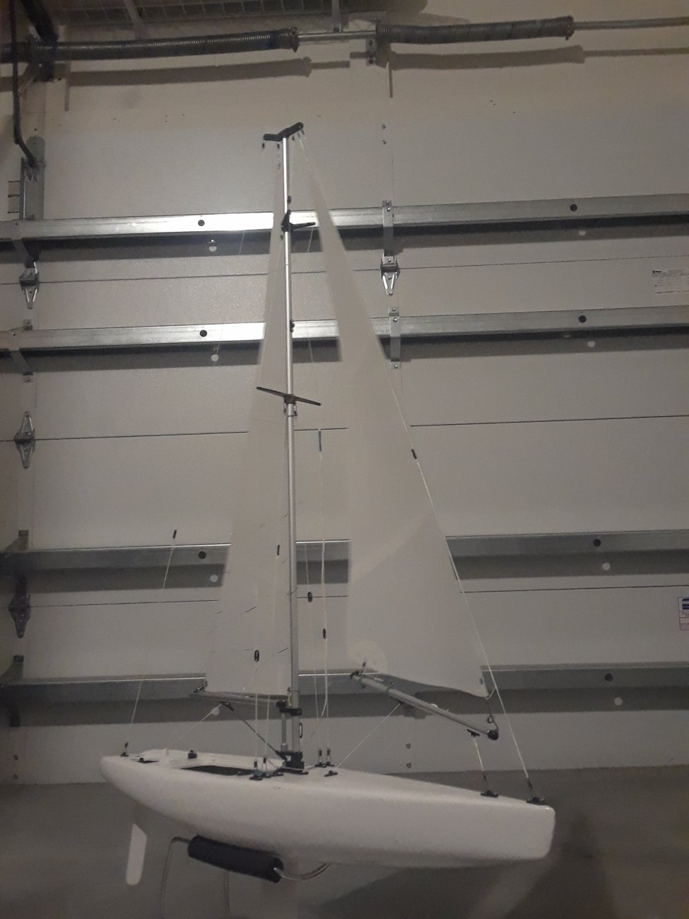

Here are a couple more pictures for discussion. The perspectives are as projections of wind.
These picture offer a better idea of sail balance versus those horrible "ce" pictures in typical sailboat study material.
Downwind: the wing on wing configuration. The main is on starboard, self tacking jib on port. The coverage on either side of mast is close to even. This is balanced enough. If the jib were missing there would be tremendous force on main rotating the bow to port. Without the jib heavy use of rudder is required, and rudder response would be chaotic.
Next picture is a broad reach. Note the presentation to the wind is the same. That is to say, the main and jib project the same here as in dead down wind, however this is a safer and faster sail direction (no jybing) and (lifting versus dragging sail). In addition the keel would also have some lifting versus equal flow on each side. Without a jib the balance is clearly in favor of the main and rotation leading to rudder drag and rudder chaos. Even if the jib was poorly trimmed it would still help balance the rudder.
On a tack upwind notice how the main shrinks dramatically as it transitions to a lifting surface versus a drag and the jib stays about the same to shrinking. It doesnt have to be trimmed great either. If it is trimmed well it will balance the main in addition to boosting the lift of the main. If the jib was missing all the forces would be on port rotating to starboard requiring heavy rudder control.
In irons both sails thin out to almost nothing when wind projects on them. A flogging headsail will easily be more exposed than the main and it wont be long before the bow picks a direction.
Its not a furled jib or unfurled jib that causes capsizing, its unbalanced helm leading to chaos, chaos leading to capsize.
