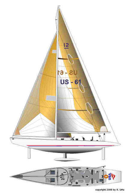

Wonder what would happen if a small rudder was added to the bow. :yikes:
Apr 27, 2010
1,279
Hunter 23 Lake Wallenpaupack
If a small rudder were added, this thread would at least double in number of posts :)
Nov 8, 2010
11,386
Well its been done. And on an America's Cup boat to boot. The Gary Mull designed US-61, skippered by Tom Blackaller. The front canard-rudder was added mostly to add 'stearability', partially because AC designs of the time (12M) were pigs when it came to steering, and Blackaller loved to mix it up in the start. It didn't help enough, as he lost a well-fought match with DC 4-0.
Every time I look at an image of 12M I'm struck by how stuck in an old rule there were. The tiny draft, short waterline, 3/4 fractional rig with jumper stays! Classic leadmine.
