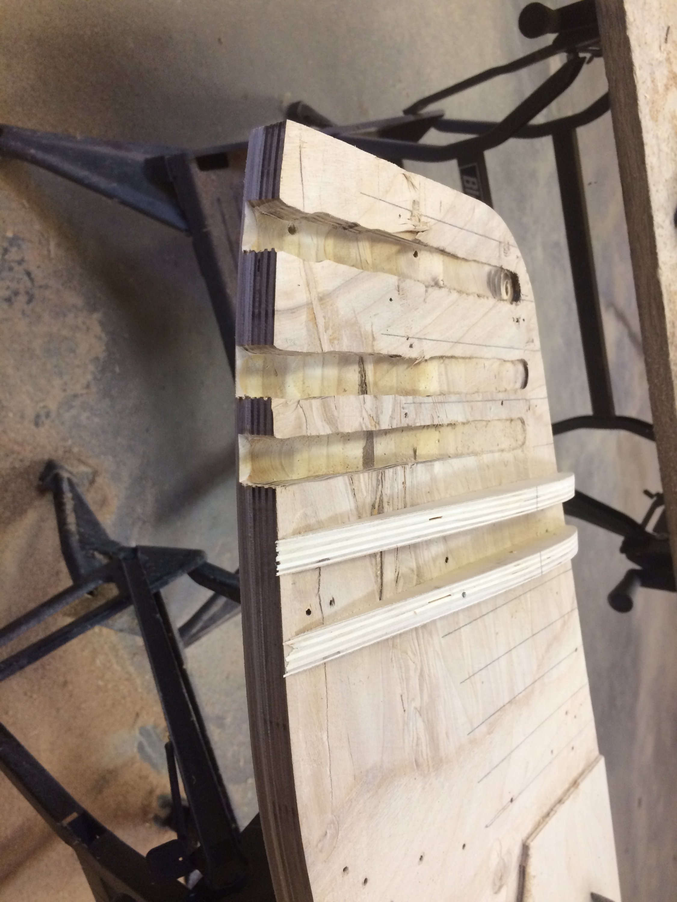

The design calls for a symmetrical lifting centerboard, suspended below the bowsprit and hinged on the bow eye hook. While lowered, the centerboard needs to be held tight against the bow to maintain lateral stability when sailing to windward. Lateral stability is maintained by exactly matching the concave back of the centerboard stem to the convex bow profile
Sailavie1,
As a professional wood worker, I am interested in hearing a little about your shaping and fairing techniques. What tools did you use to shape the convex surface and how did you match up the concave surface to the bow shape?

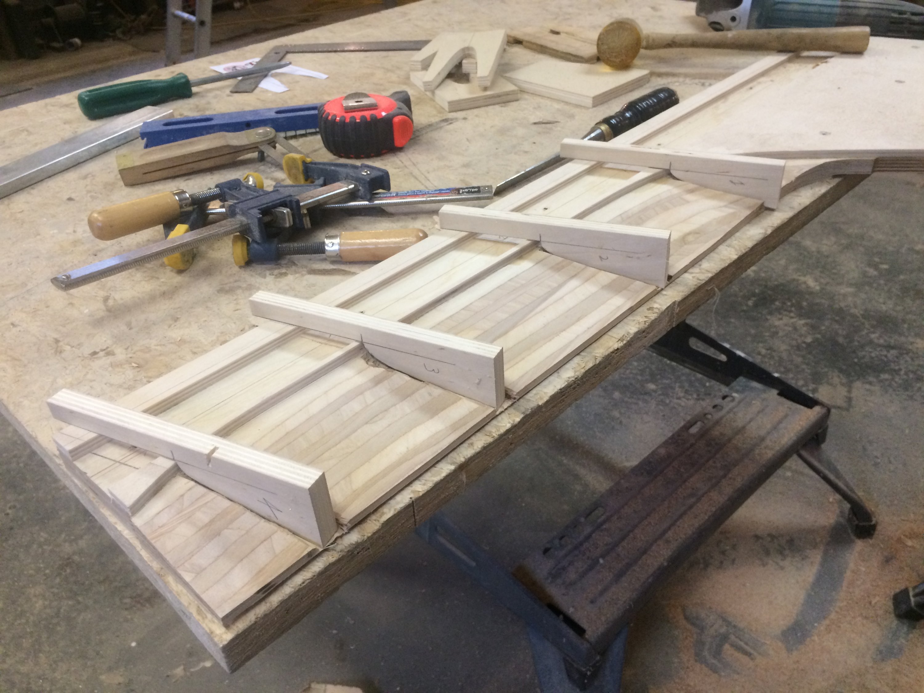

Thanks for asking Will. Wood working is a hobby of mine and building things is as much fun as enjoying the final product afterwards.
To build the centreboard/bow joint, I first taped multiple layers of masking tape on the bow and marked 4 evenly spaced horizontal reference lines. The layers of tape made up the thickness of the fiberglass and neoprene which were to be added later to the plywood joint. The four horizontal reference lines were used to trace the bow profiles along the joint area. A Profile Copy Gauge was used to trace along each unique bow contour and make copies out of wood.
The four wood copies were then used to measure the amount of material needing removal along each half of the centerboard joint. Once the correct amount of material was removed from each reference line (by hand chisel), the segments in-between were sanded down using a disk sander and a Makita 9031 Belt Sander. This process was repeated on the other matching side prior to lamination with thickened epoxy.
I selected the NACA 0014 foil profile only because it looked about right for the job. I simply downloaded the profile and made various sized paper copies suitable for the width and depth of the final blade. I used a similar process to the joint work to get the final foil profile by removing material at each reference line then sanding away in-between with the belt sander. A router, resting on the foil shaped wooden guides, was used to remove the majority of the reference area as shown above.
Hope this sheds some light as to how it was shaped. The fit turned out better than I expected with near zero lateral movement once the unit is tightened in place. Key was taping the layers and taking my time so as not to remove too much material.
For me, there is almost no feeling like having a join like that, work out. It is like magic happened because it is so hard to conceive that my work could be that perfect. You must be flying pretty high every time you look at it. I'd just spend all day gazing at and touching it if I had done it. Great work. :clap:
