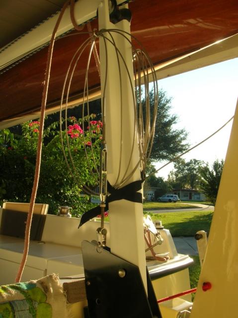

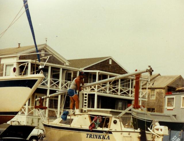

If you keep your boat simple, mast raising will be simple and fast. It's only when you get into installing good roller fulers like a CDI or Harken that the mast raising becomes slow and tedious requiring extra equipment that uses valuable time to set up. A mast holding device that you can build, along with a 60' 3/8" rope with an eye slice on one end, and a single sheave block to attach to the bow cleat is about all you need to raise your mast. The key here is KISS. When you reach "Geezerdom" some day, you can think about those extra goodies. The first picture shows Wayne's mast holding rig for his Seaward 22. The other two pics show your's truly, raising the mast all by his lonesome.This is a great forum with great guys. Everyone is so helpful, I'll definitely be fixing my boat right. Thanks Joe for your pics especially on mast raising I'll also be alone. Maybe Jim can take on a new business for the winter![]()

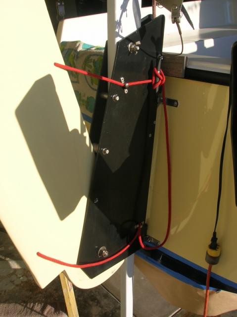

Like Joe, I am trying to keep everything simple to keep setup time to minimum. One small project was to find a method to leaving the rudder on the boat but still have a telescoping crutch. Not sure you can tell everything from the pics, but I moved up one of the spacer bolts on the rear edge of the rudder head, this let the rudder kick up real high, and allowed room to slide in a one piece crutch in front of the rudder. My prototype is wood right now, but the final will be an aluminum tube. The crutch extends about 30" I think, which gives me a pretty good advantage for the manual raising. The crutch also gives me a home for coiled rigging while trailering. I also rigged a continous line for the rudder up/down line to a simple cleat.

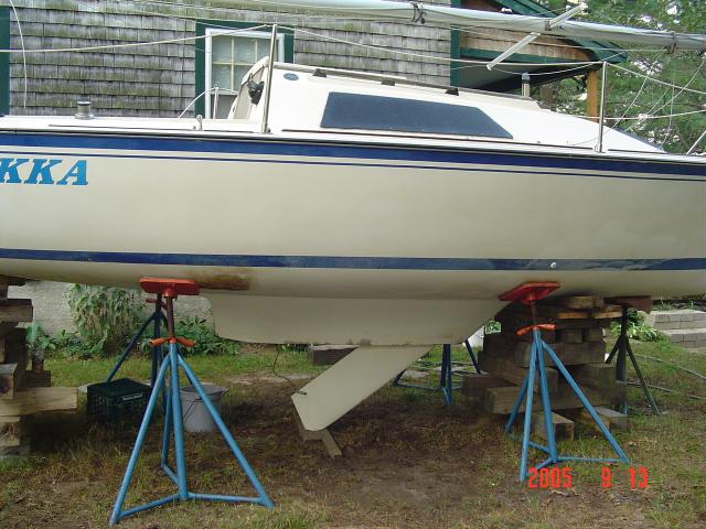

Bill,Thanks for the info on the swim ladder. After some extensive cleaning and redo, I was able to get my 20 in the water yesterday and have a brief sail on the Hudson. The problem I had was that I couldn't get the board to go down. The boat sat on the hard for close to 6 years. Looking at it before we launched there seemed to be space all around the board relative to the keel. Today I bought a3/8 inch steel rod and was able to get down next to the pendant and give it some taps with a hammer but notheing moved. Any ideas how I can get it down (loose) without getting under the boat. Bill
