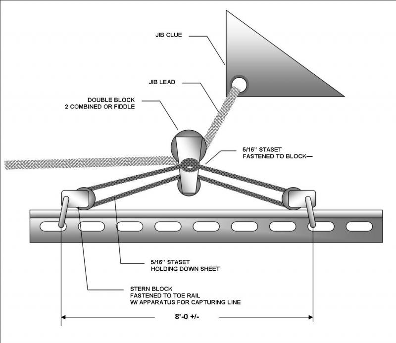

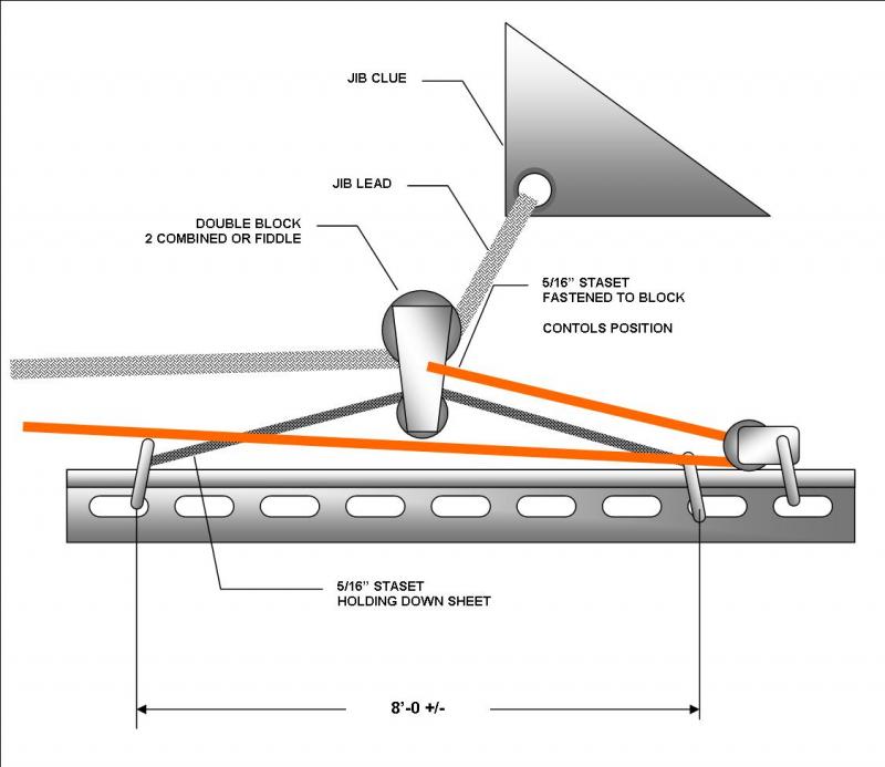

What is the load on the control line when moving the car? I sheet my genoa outside my lifelines. The deck is too narrow to do otherwise and we can still make 6.6 knots, so I think I'm OK in doing this. But, with 150% (+) genoa I really should have a better way to trim the sail than running out on a heaving foredeck to unclip the blocks and move them. I installed a Barber hauler, which gave me a little more control but still a little clunky. This winter, I'm thinking of making a . . . . as yet unnamed contraption, consisting of two blocks fore and aft, secured to the toe rail, a loop of StaSet between them secured to another block. This block be a fiddle or two blocks attached, one to run along the StaSet, and one to run the jib sheet thru. This would allow me to luff the jib, move the block to a new location and lock it there. The locking part has yet to be determined but I have a couple of ideas, one simple, one fancy. Attached you'll see a (gulp) drawing of what I have in mind. I've been a drafter for 25 years, 12 of them a solid modeler, but all I have at my disposal this morning is MS Publisher so . . . be kind!
So . . . .waddayah think?
