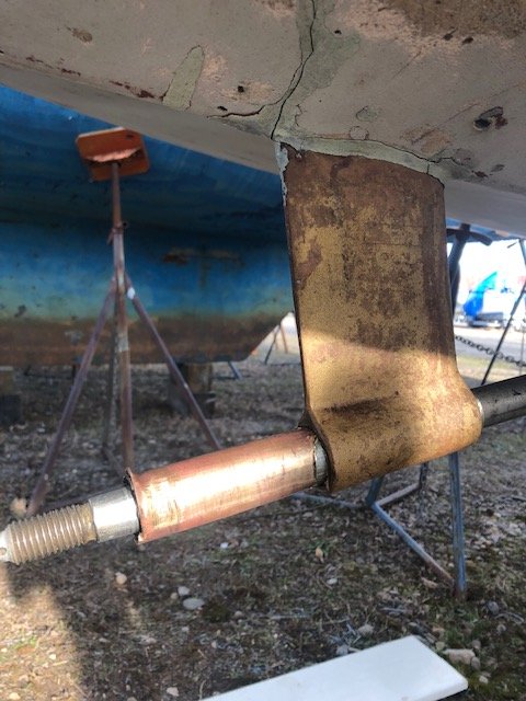

Tally Ho, shaft is 1”, bearing is 1” ID, 1.25” OD, 4” length.
I ordered the single set from StrutPro, single size collets for my boat, which was $350 vs $850 I think.
I am pretty sure I screwed the pooch. I think I should have ensured the collets were contacting the bearing shell before trying too hard. Having never done this before I wasn’t sure what resistance there would be, but I am guessing the the collets were driven into the rubber and wedged themselves. I will confirm Friday, which is my next day off.

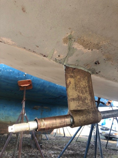

I screwed the pooch on this removal. I finally removed this bearing using 4' length of pipe as a lever. I soaked the thing for a week in PB Blaster, but it didn't help so I decided to just keep ratcheting away until it came fully out. Now, of course, the collets are jammed in the strut and the shaft won't rotate at all. Using a strap wrench I attempted to rotate it, but I am tired of playing with it and will enlist professional help tomorrow.
I think using the pipe on the strut also caused a crack in the fiberglass, which will have to be resolved as well.
I do not like boats anymore. ;)

Yeah, that looks painful.
Can you get the collets out of the strut at this point? Banging on them in the strut isn’t going to help the strut at all.

Nah, they’re in there pretty good. I thought of using new collets to reverse the process, but I spoke to a guy next to me who gave me the name of a professional. I texted him and he is on it. I’ve got so many jobs to do before getting it back to the water, I can’t waste any more time on it.

If you applied a four foot lever to that strut you may have bent it. If so you might as well remove it and bring it to a prop shop to have the bearing replaced and the strut straightened. Alignment, even with the original strut, will be difficult. Good luck.

Bearing is replaced by professional. He did not indicate what he thought went wrong, but he had to install set screws as he thinks my actions stretched the strut diameter. He did not say that it was “bent” or needed any additional work. I dropped the prop off so he could install that when he was done. I will ask what could have caused the issue when I pick it up. Anyone want to buy a SrutPro? Only used once! :)
