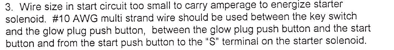

MN: When you say "it won't start" do you hear the "click" but no starter motor engaging? Or does the starter motor turn over the engine but no "fire"? I own a 34 that had a starting problem. It was the glow plug switch AND a bad ground. The #10 wire was replaced before we bought the boat.

@daviddp if you haven’t done the GP relay mod you should - check out required mods on the C34.org or Catalina36.com site —- assuming you have an M25 or other model before glow plugs relays were installed stock — then you only need 14ga between the switch/button and GP relay.
