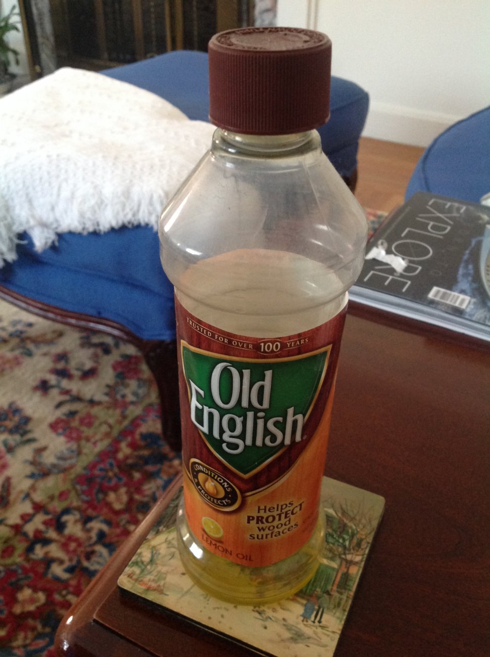

Frederick,
The teak oil will try to give back the teak wood color more than condition the wood.
I use Old English Oil on all my interior woods. It penetrates into the wood, conditions and restores the dried out wood.
I have used it since I bought my boat new (2000 340). I apply it three times a year, once after sitting all winter, during the sailing season ( on one of those days when it's cool and we're just sitting around) and late in the season just before taking it out off the water. I just pour it on a rag and wipe down all the wood. It's got a nice smell and is good for wood as it has no alcohol in it. The wood looks like the day I was installed, as it's maintaining the original oils in the wood.
I use it on all my woods, gunstocks, grips (they take a beating), I've have antique 52 MGTD with a walnut dash and use it on that also. No cracks in the wood, no bleached out spots from the sun.
Avoid the alcohol based products, even with low content, that just draws out the finish and dries out the wood.
Try it, I think you'll like the results.

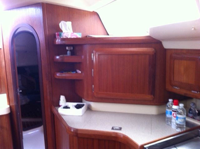

Thanks all for the suggestions. I went with boiled Linseed Oil 50% diluted with pain thinner as suggested by Mike Honcho and after doing a bit of research online. I am done with the cleaning and first coat, and pretty happy with the preliminary results so far - almost looks new... will try to send pics when I am done. (PS: paying attention to proper rag disposal)
