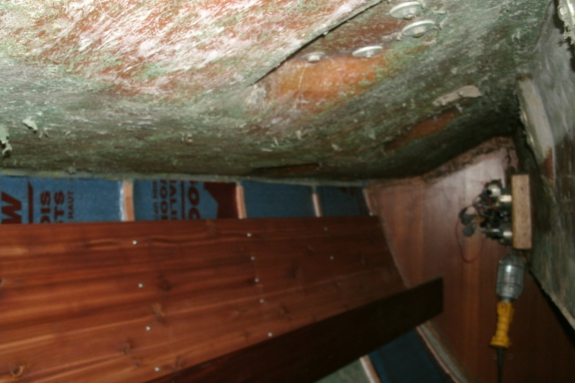

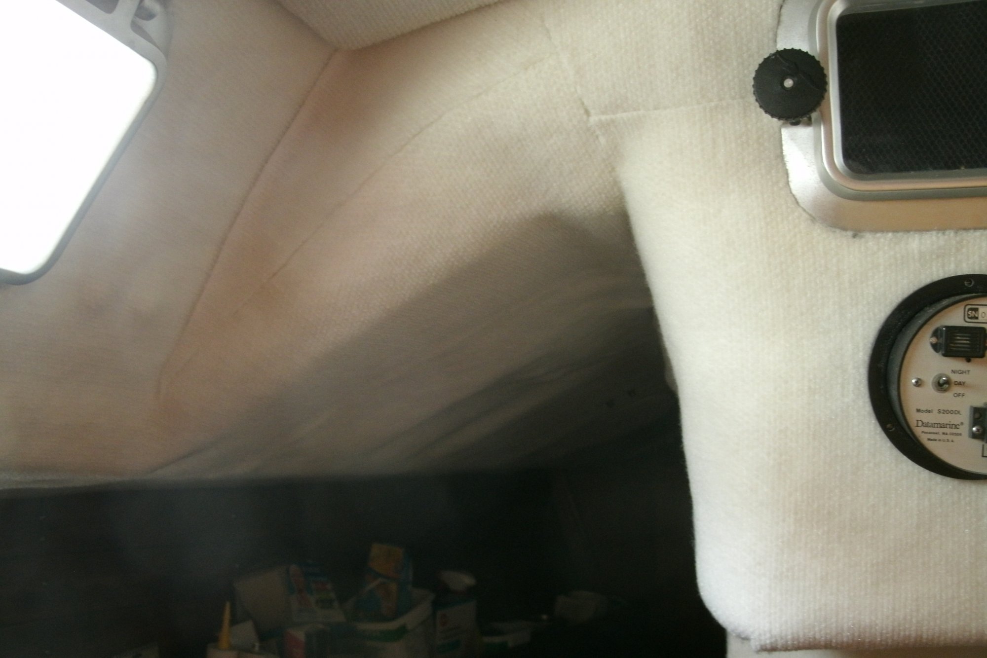

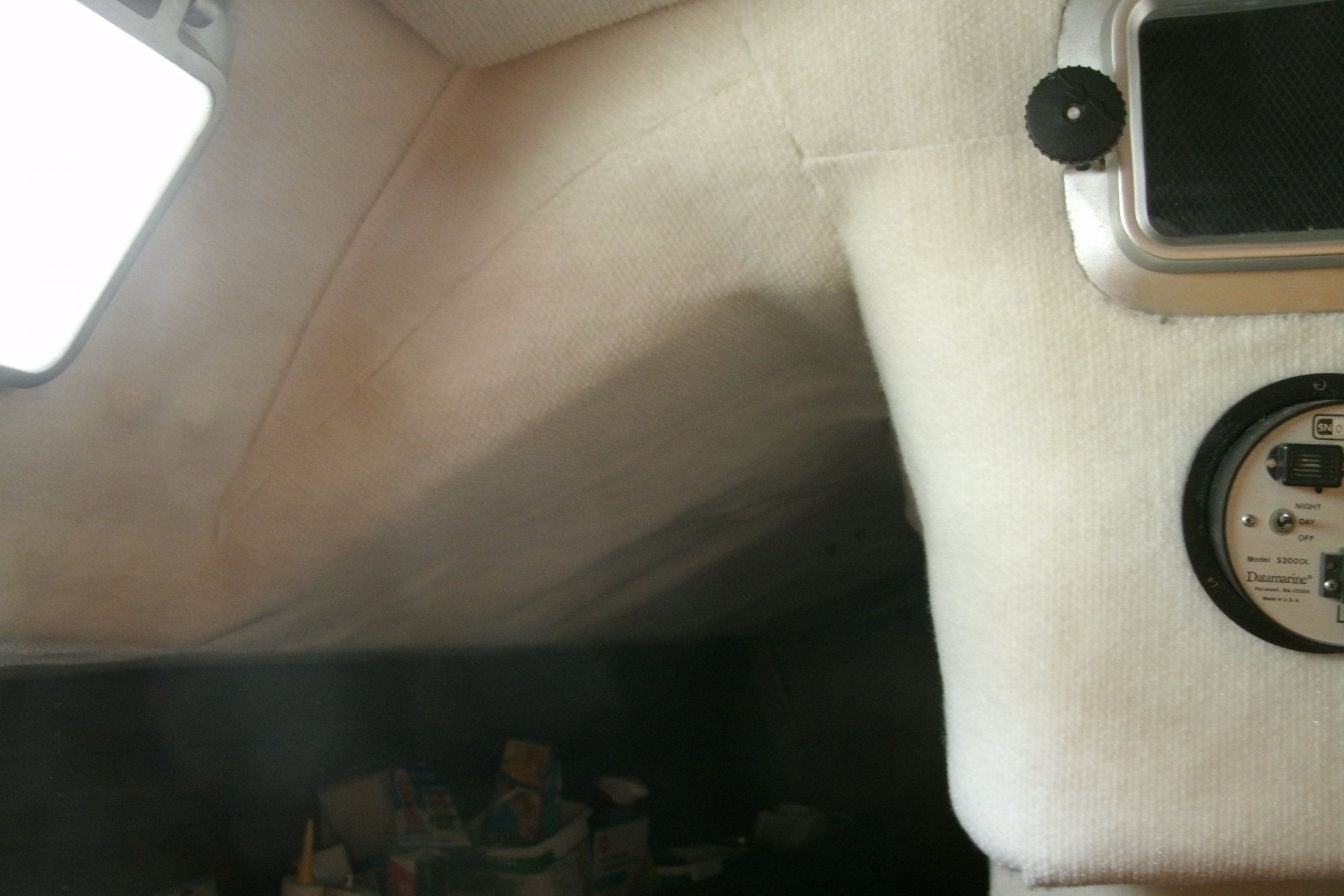

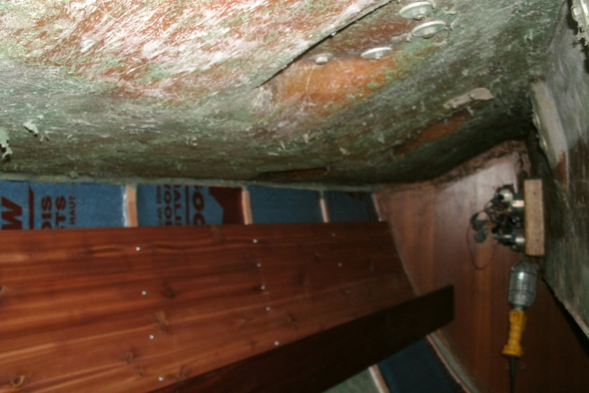

If you plan to insulate you need to make room for the insulation. I used 1/2x3/4 in. fir for spacers at 16 in.spaces. then insulated between them and covered with t&g cedar. Covering with a headliner material covers a lot of bumps and rough spots as will the original foam backed vinyl.
B1B59CCC-E58E-42B2-BBA8-AFB632738D9A.jpeg Under construction
0EDDF8DF-9B1B-4462-B90B-CF1DD76CE0A0.jpeg Head liner installed. I did this first in what I call my tool room and will make some changes in the next part. Everything is a learning experience.

@Michael Davis is guiding you in the right direction. It is possible to sand the bare fiberglass a little to remove some of the roughest points and then paint with several coats of high build epoxy primer and then cover with some sort of fabric or carpet. Whether the underlying fiberglass prints through the covering will depend on the covering, a thin vinyl will probably print through a lot, carpet, not as much.
A more elegant approach is basically the approach Michael used. Clean up the fiberglass and glue furring strips to the ceilings with a few gobs of very thickened epoxy (peanut butter consistency). Align the strips so the surface is fair.this will provide space to add insulation. This approach will provide a several finishing options. Cover everything with ¼" door skin plywood and cover the plywood with vinyl, or use 1" x ½" wood strips of the wood of your choice. Secure the strips with bronze screws. Or use bead board from the local big box HW store. There probably other creative ways to accomplish this.

One caveat: covering the inside of the hull with sheets of beadboard or doorskins will be really tricky, because the sheets only want to bend in one plane, and the hull is curved in two directions at once. That is why ceiling (the covering on the inside of the hull) is usually made of strips, as has been suggested. It would be smart to varnish the strips before screwing them into place. The finish will be less likely to have sags and drips, and you will probably have better light doing the brushwork outside of the boat so you can see what you're doing. The overhead can be done the same way, perhaps painted white instead of varnished, or with wider strips. Plywood might work on the overhead because the bends aren't generally as pronounced.
Jan 5, 2017
2,502
I used 1/4x 3 t&g in the aft state room where the compound curves are the worst. In the V-berth I used 1/8in. plywood as the curves are less. I spent some time in the boat with a bunch of cardboard and a box cutter to make a template then cut the wood at home. That worked out pretty well as I only had to do minor adjustments with a hand plane. Will be doing some more this winter.
