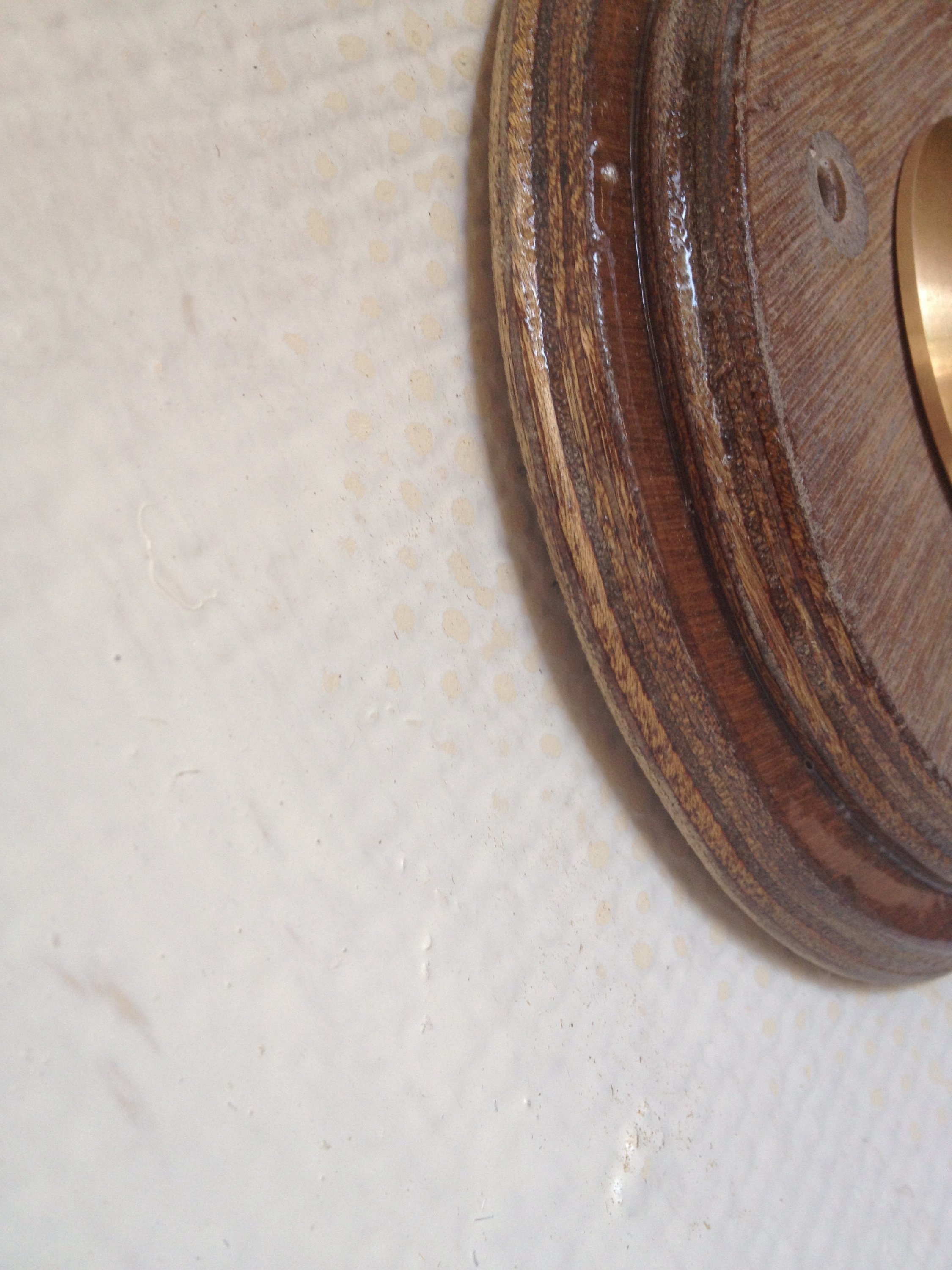

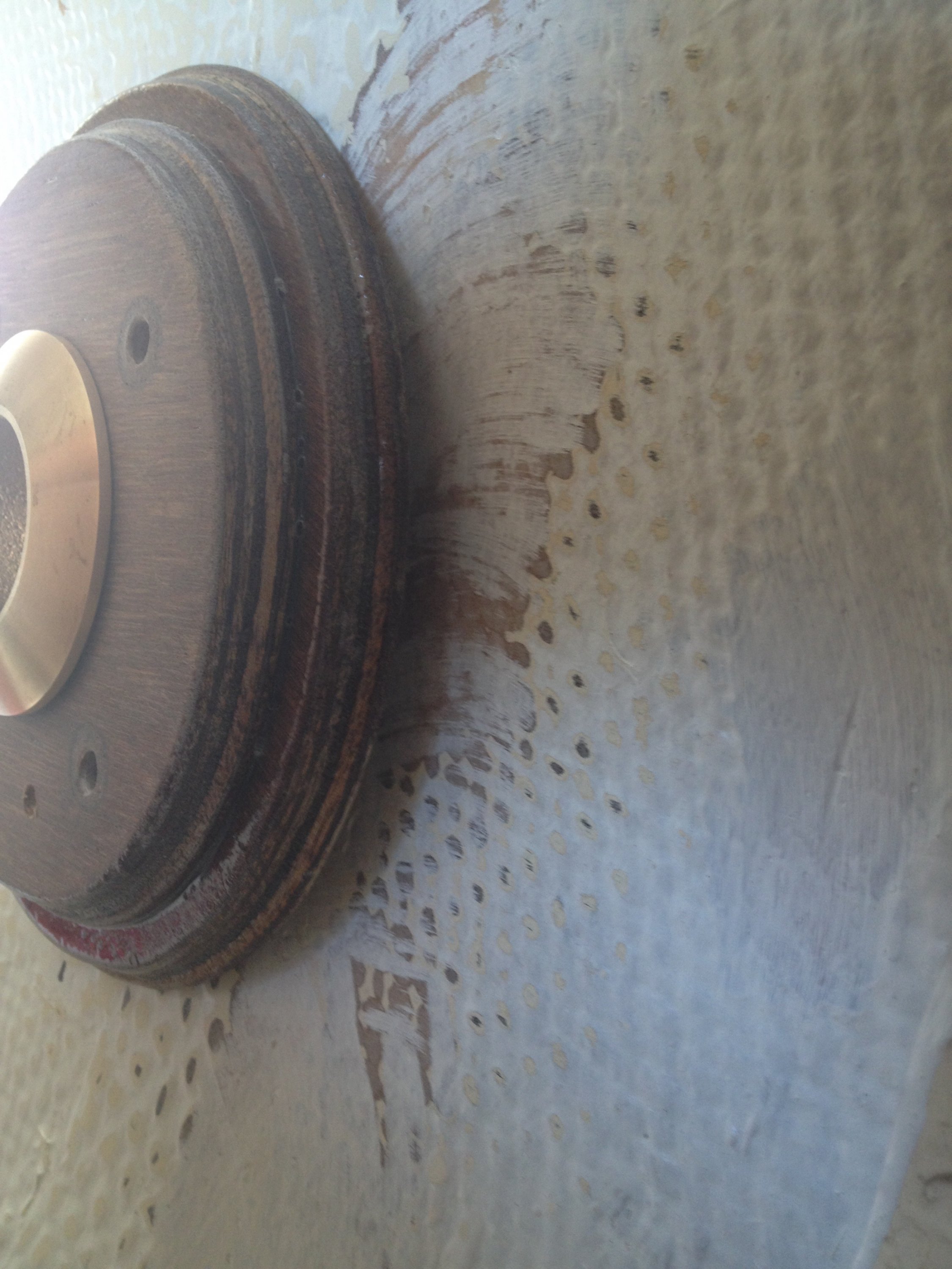

You nailed it! Look at this wonderful fit. It's not even the worst of the three. image.jpgimage.jpgimage.jpg

In the picture the bolt thru the hull is shown as a flat head. The one in the backing block is what? Tapped in or epoxied into block. I have bronze seacock so need bronze bolts. How would you isolate if you used SS?
Jun 4, 2004
392
Hunter 31 and 25 and fomerly 23.5 Stockton State Park Marina; MO
I used nylon washer under the head and a short length of heat shrink on the upper shaft shrunk to fit.
