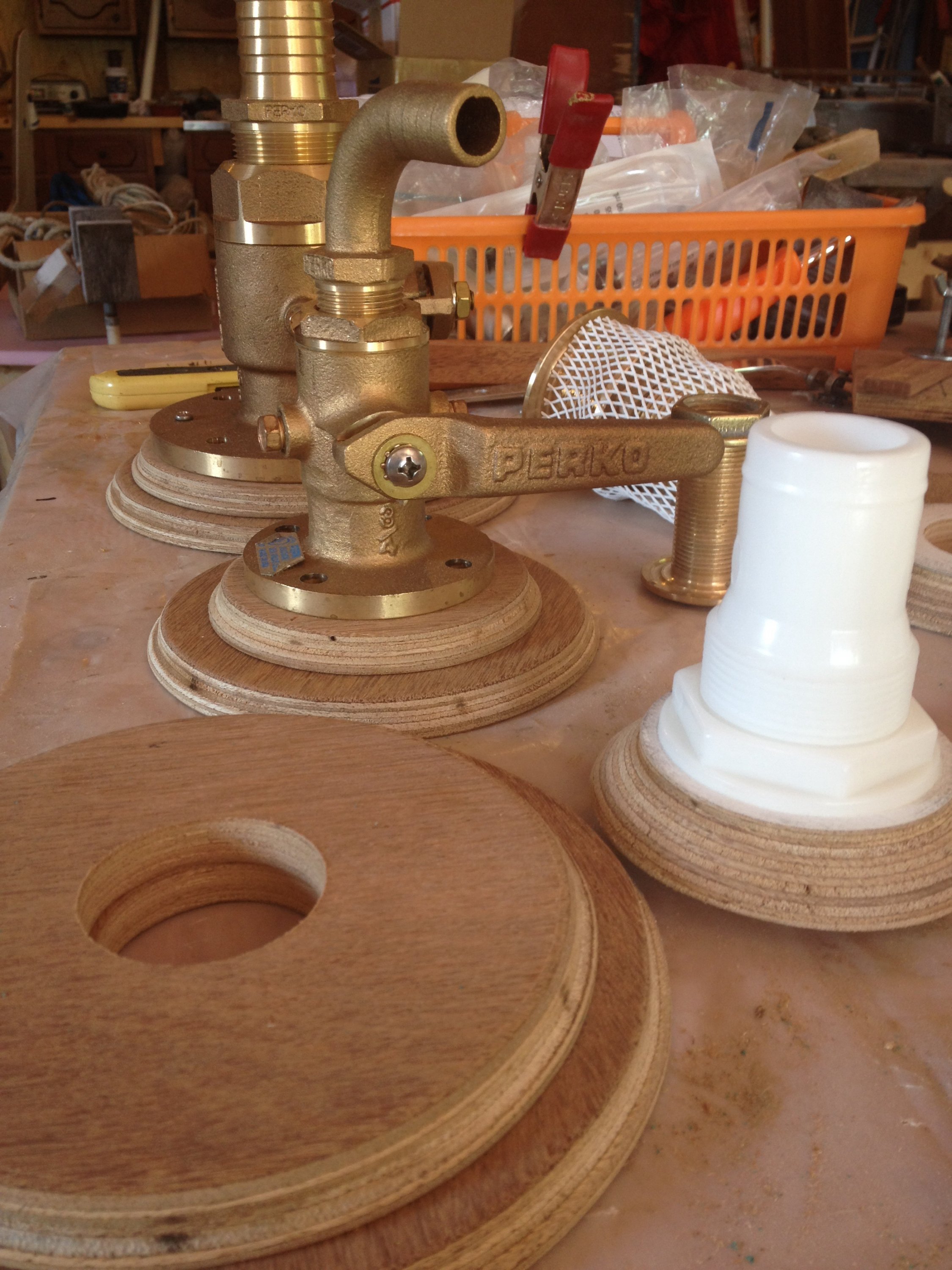

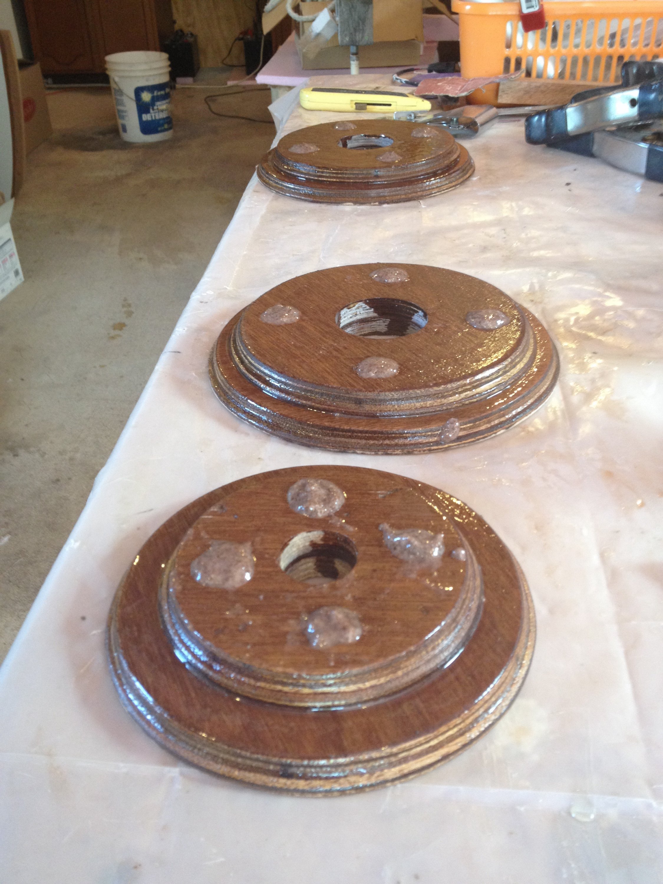

I'm working on through-hulls on my rebuild project now. I used two thicknesses of 1/2 inch Meranti plywood epoxied together and will epoxy to the hull and seal all with epoxy. The bolt holes I overbored and filled with epoxy mixed with the drilling chips and fumed silica. These I will drill out to size for SS lag bolts which I will insulate from the bronze to prevent galvanic action. image.jpgimage.jpg

I'm working on through-hulls on my rebuild project now. I used two thicknesses of 1/2 inch Meranti plywood epoxied together and will epoxy to the hull and seal all with epoxy. The bolt holes I overbored and filled with epoxy mixed with the drilling chips and fumed silica. These I will drill out to size for SS lag bolts which I will insulate from the bronze to prevent galvanic action. View attachment 123315View attachment 123316
Through bolts with nuts, NOT lag bolts, please.

Since no question is a dumb question, what is the problem with proper sized lag bolts? The only reason I see for even having fasteners there is to keep the flange from turning, thus backing off the thru hull.
A boat's hull works and flexes. Lag bolts would probably work loose after some time. If you are going to put a hole in your boat it must be properly done or you could have a catastrophic failure and loose not only the boat, but possibly your life. I can not remember ever seeing lag bolts being used on any sailing vessel, for any purpose. They are not secure and there is no way to insure they do not work loose or back out. See Gunni's post for the acceptable method of installing thruhulls in a boat. No need to reinvent the wheel. It's already been worked out for anybody who needs the info.
Nope; I also did not want bolts going all the way through the hull. I also debated the merits of encapsulating the bolt ( or the nut) in the backing plate but decided since I am epoxying the backing plate to the hull I wouldn't want to destroy the whole thing if ever a galled/cross thread occurred. There is "one big bolt" holding it all together ; it's the thru-hull threading into the seacock. With some seacock arrangements this is all you have with a little backing nut to hold in the thru-hull. However, with a flanged seacock you have the bolts to take the loads will trying to turn a stiff or frozen handle. Wouldn't want to snap off that bronze thru-hull.

Good point MM; I had short strand fiberglass I could have mixed in and thought of doing so. However; since the wood shavings are small enough to thoroughly saturate I concluded it would be a non issue.
