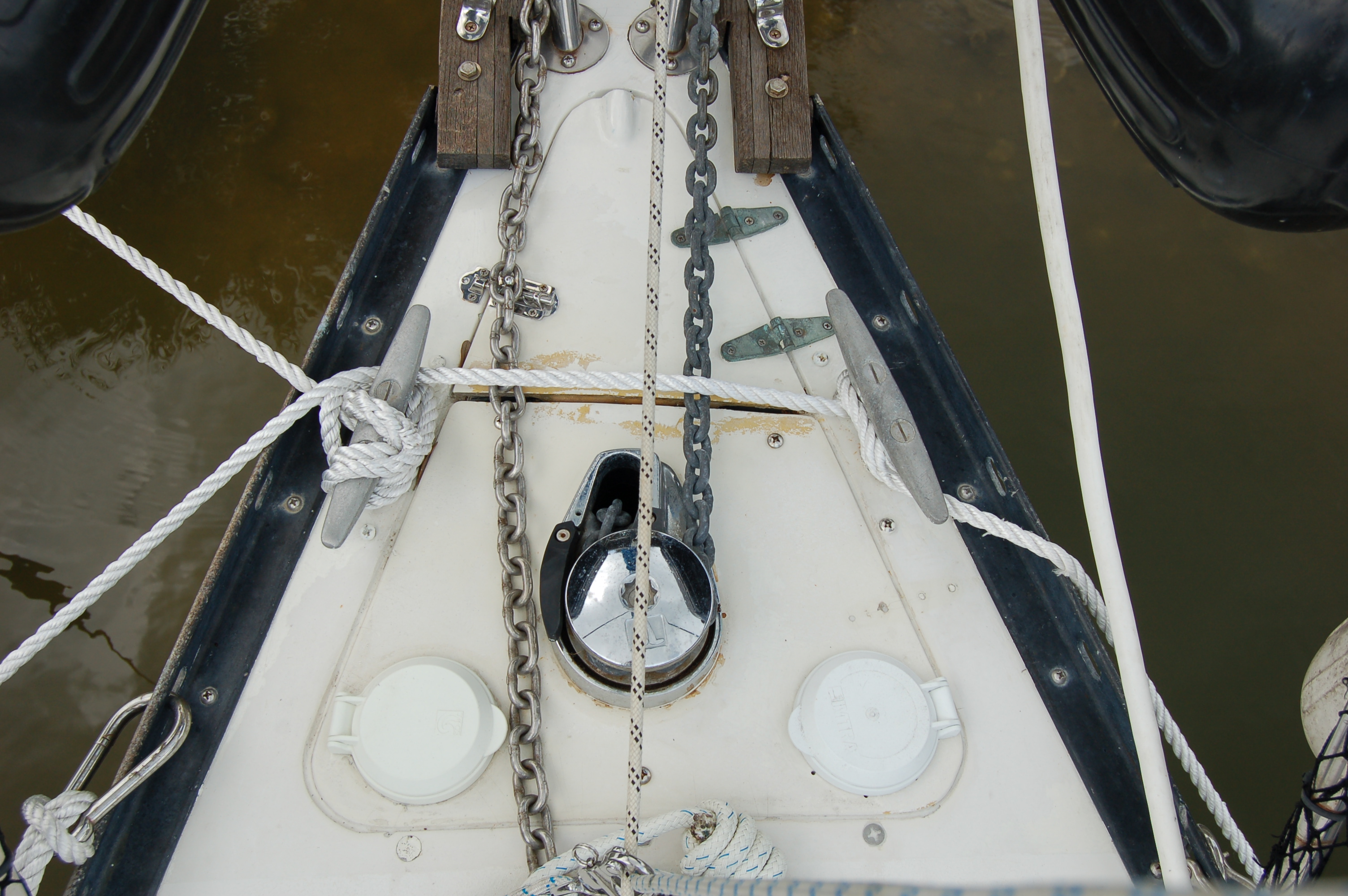

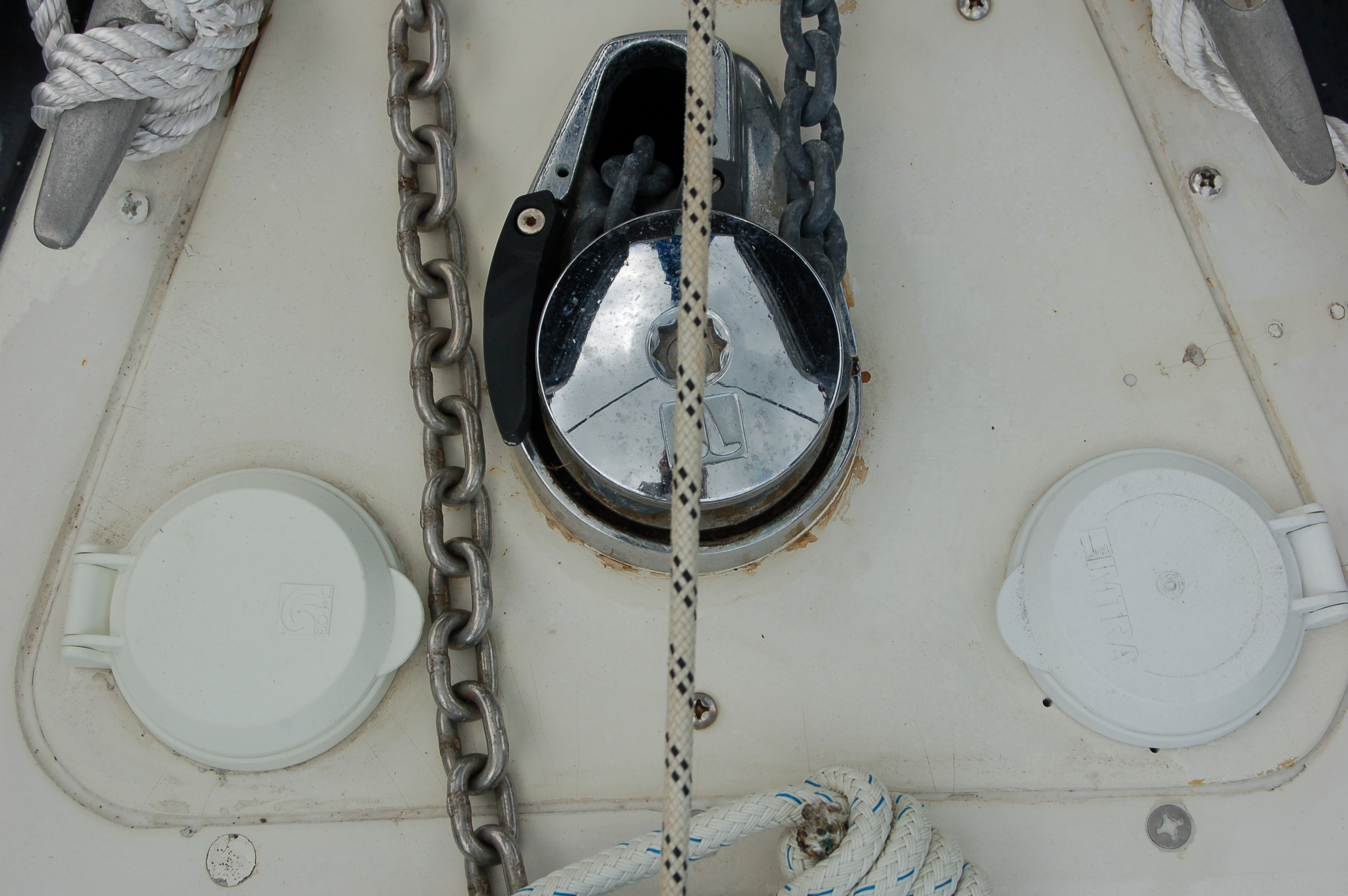

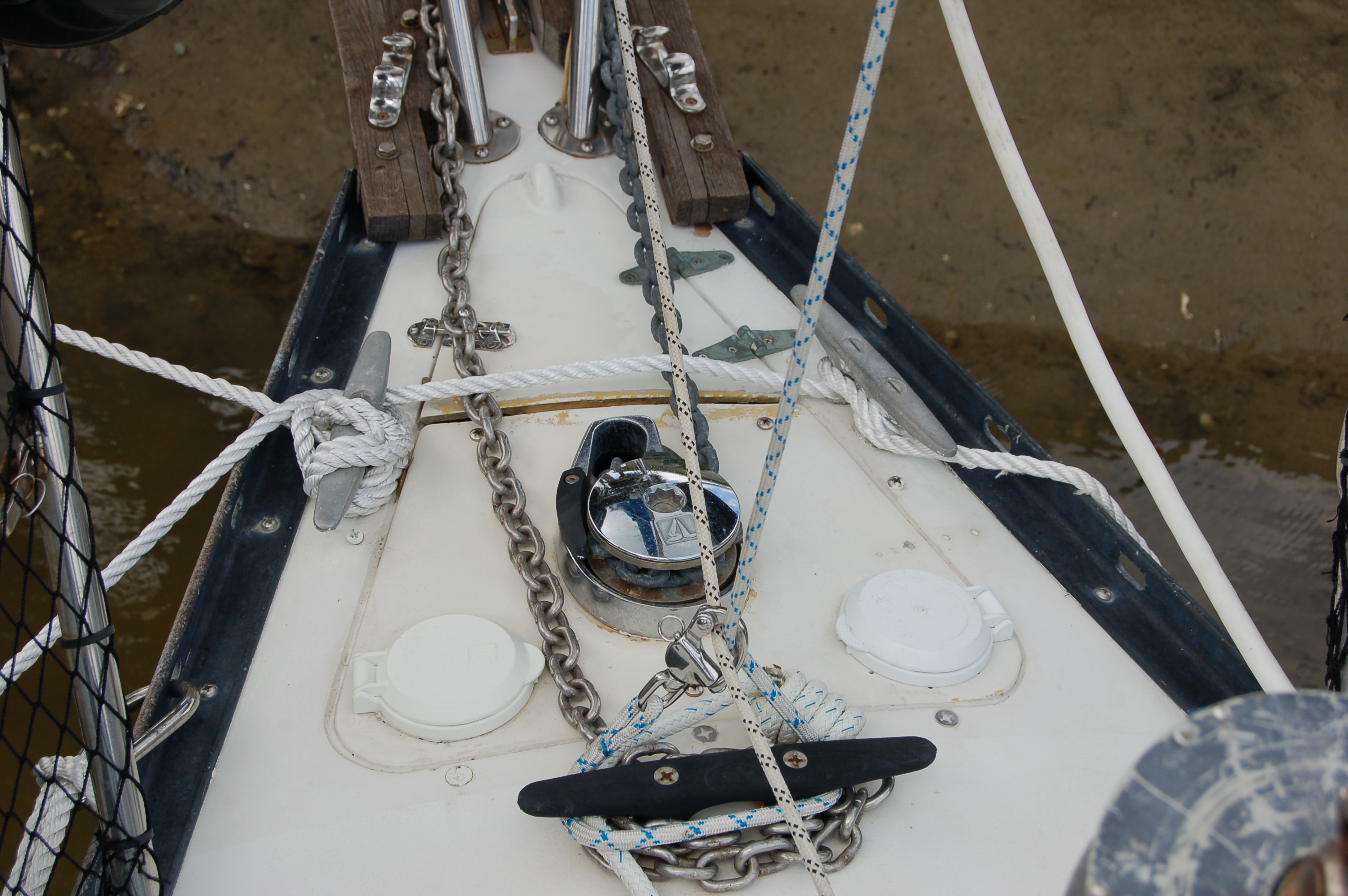

Bill I posted some photos etc of my install of a lewmar proseries on my cat30 - see link - it is under boat photos /specs - "improvements" works well although the cat 30 well is too shallow to take more than 50 ft of chain before it piles up to the hawse hole.

Tom, this is exactly what I was hoping to see!
Is the aft extension of the backing plate a support for the thin cut edge of the aft section of the hatch?
Is there a piece bolted to this aft lid section to help seal/support the forward edge?
How is the fixed piece attached to the boat?
great stuff!!
Thanks again,
Bill
T
tomfoolery
Bill
If you looked at the windlass mount in profile you would see , from top the windlass and 4 mounting bolts, then the top backing plate which extends from roller to the cut edge of the lid, then the original lid (front cut section), then the lower backing plate which extends under the lid and deck from near the aft end of the anchor roller to just aft of the forward lid (yes you are right it sticks out an inch or so to support the aft part of the lid. Windlass bolts go down through top backer, lid and bottom backer.
