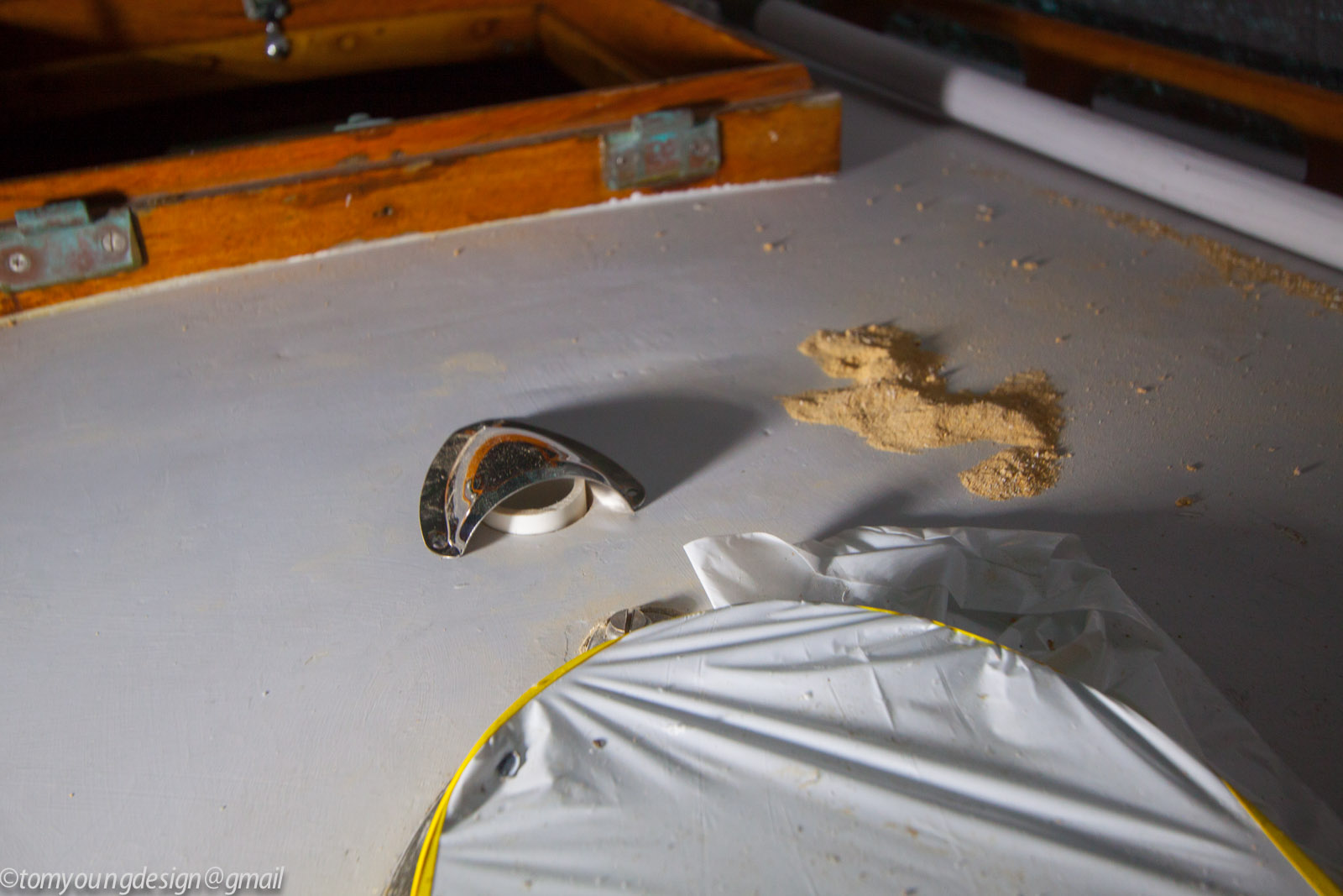

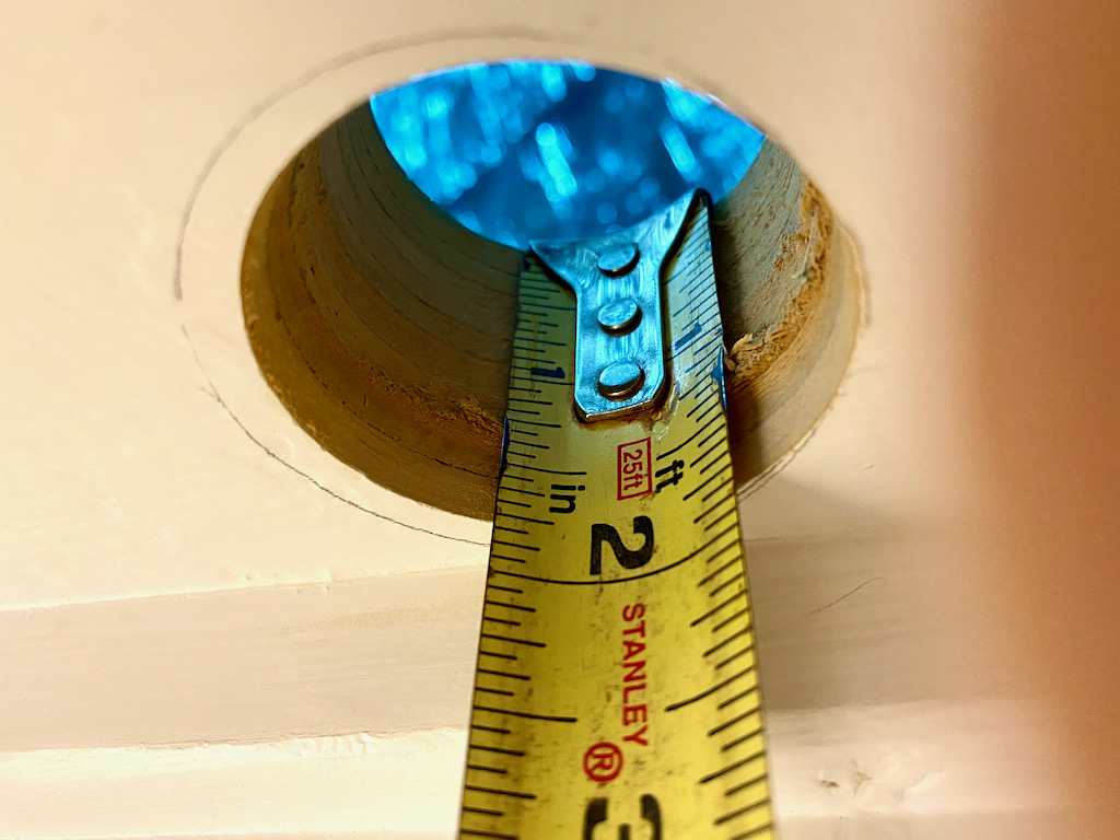

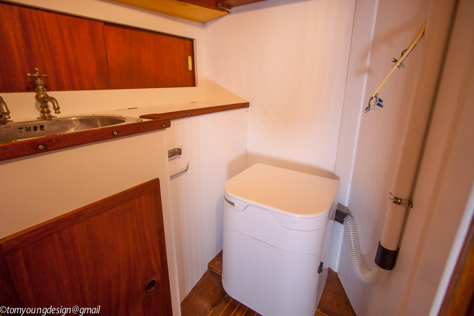

The un-install finally came to an end. The composting toilet install is simpler. First, installing the stack: I decided to keep bends and length to a minimum and vent straight up through the house. In the area of the mast, this old boat is thick.
I've left the 1 1/4" PVC 1/2" proud of the top. Covered with a small clam shell vent it should stay dry unless we sink.
The only other task was run 14/2 wire to the head. The vent stack will be hidden by the mainmast.

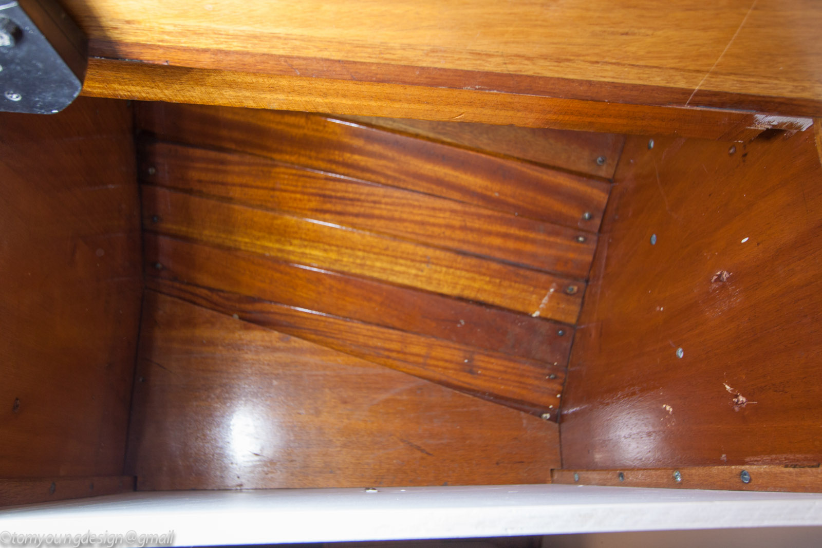

I found this!
Likes: jon hansen
May 25, 2012
4,338
did you seal up all those layers of ply in the hole? for my eye that won't keep that area very dry.
vent upwind of cockpit and hatches and dorades while on the hook. has my wondering.
vent right where you stand when working the halyards. it will
prolly get kick a lot.
i'm just thinking out loud as i wonder what i would do, being our vessels are so similar
Likes: TomY
TomY
Alden Forum Moderator
Jun 22, 2004
2,769
I don't think there's as much odor from a composting vent as a holding tank which can have some powerful odors. The venting is more for drying. And the location isn't perfect but it seems the least traveled area for me. Who knows until you try it?
