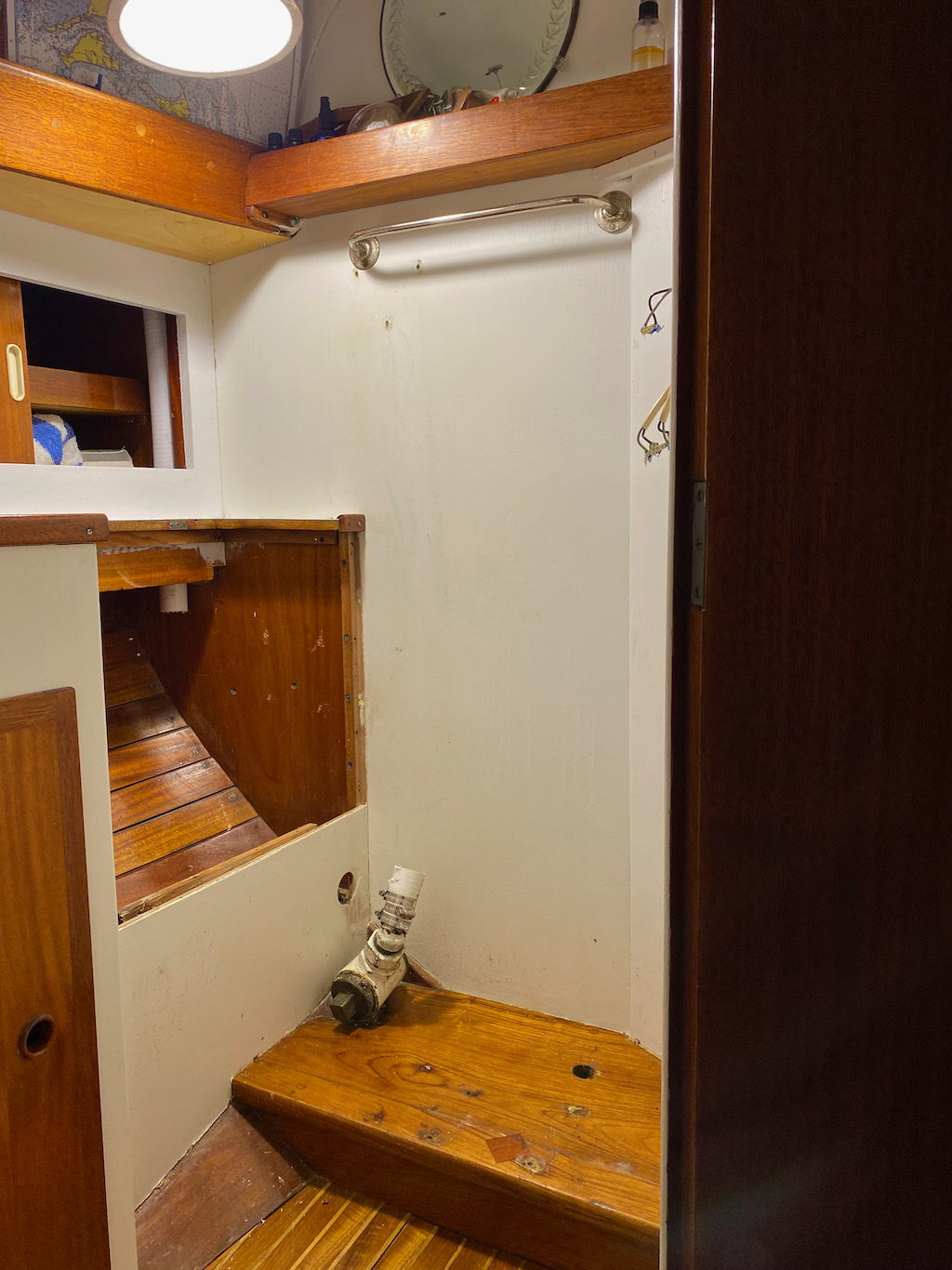

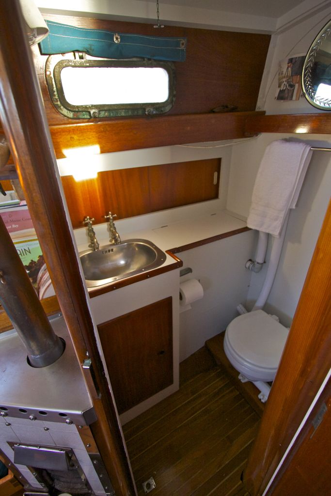

There is head history (not all memorable,...), in the original 61 yr old raised platform.
I added 2, and all the parts of pieces have been replaced at least once, numerous rebuilds of the pumps, etc. The seacock and thru hull will be the last to go. Original 1961, they don't owe anything to anybody.

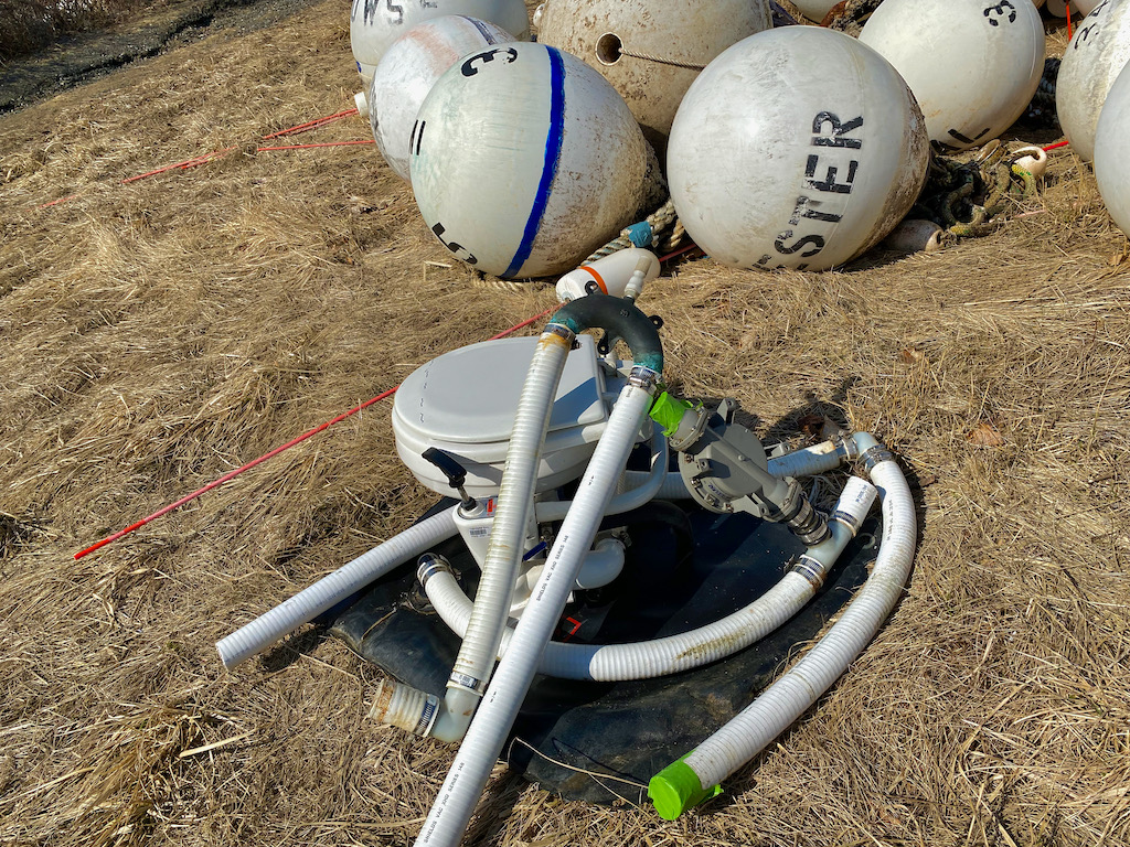

With my head 'in it', I had a chance to assess the change. All I'm doing is replacing one waste management system with another. The old one, fairly complex, collects human waste - solid and liquid - and pumps it, along with 2-3 xs the added seawater (in my case), through hoses, valves, and into a holding tank.
The contents stew in the tank until we travel (#1) to a pump-out to go into a shoreside holding or sewer system, or we travel (#2) offshore (3mi + depending) to discharge the holding tank into the ocean.
As I've decided after several decades I'm not comfortable disposing of our waste via #2.

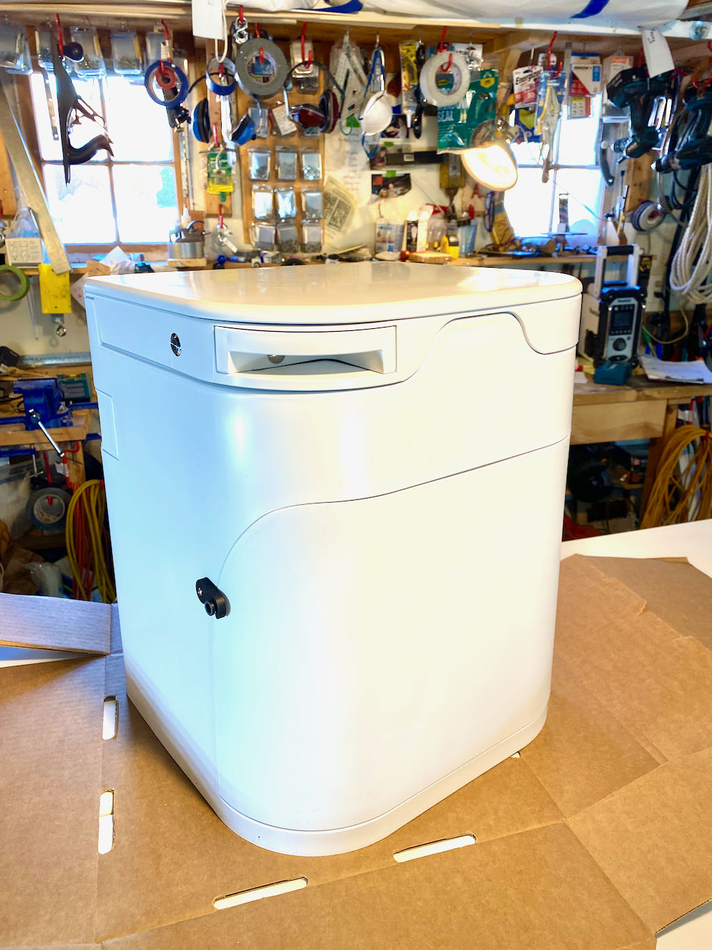

This new system all fits into this:
I've researched and talked to friends using various composting heads. Our need is: Not living aboard, long weekends and perhaps a month stint each season. The OGO caught my eye and while I wrote it off at first, I came back to the idea, did my homework, and bought one.
Aside from running a 1 1/4" vent stack and driving 4 screws, this install is done!

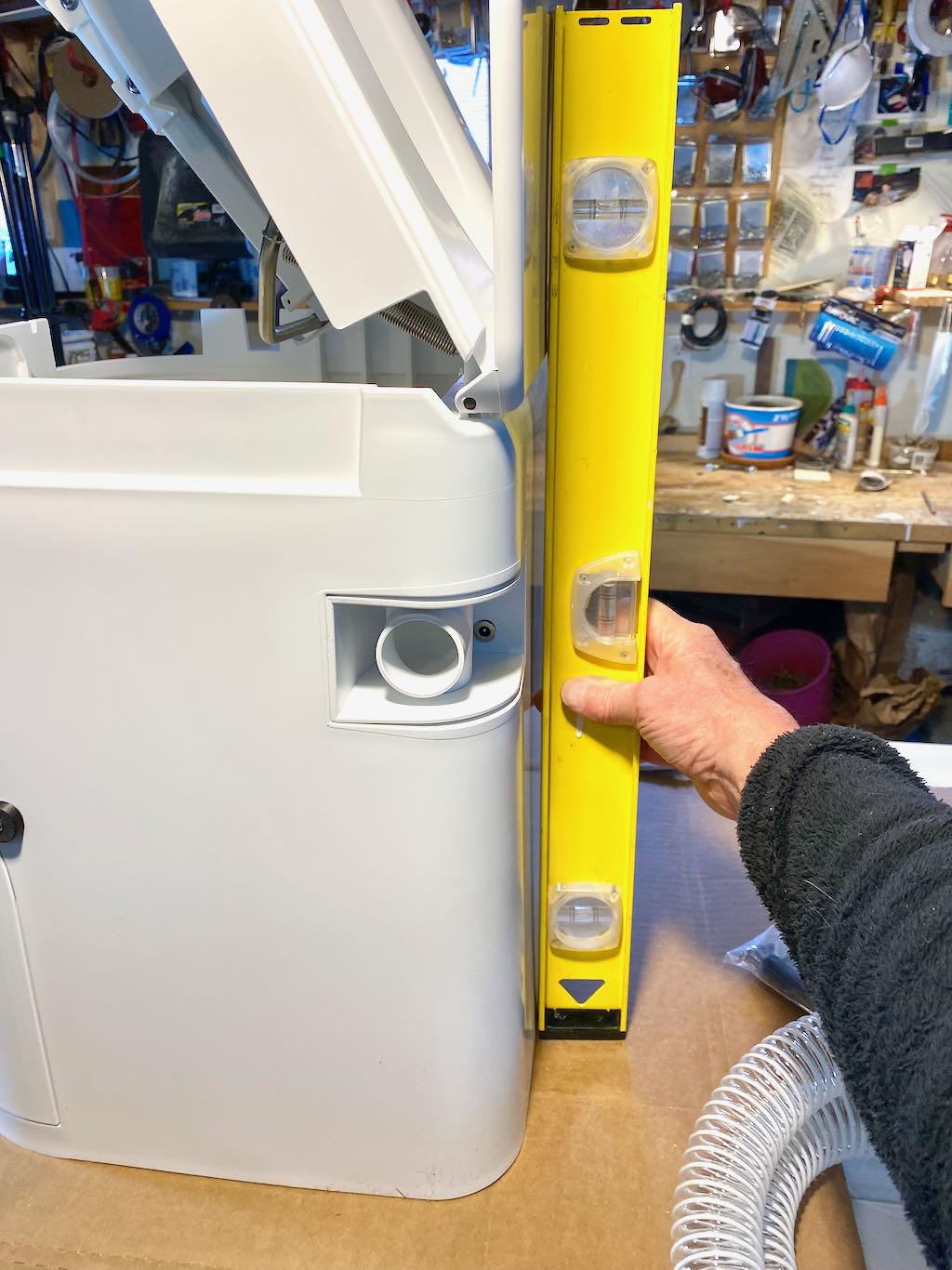

One of the questions to OGO was how how far the lid needed to be raised to allow use and service. I was pleased to hear - and later test myself (photo) that the lid only needs to go verticle. And the vent goes out the side (either side, it's interchangeable) to require less depth than even the smallest marine heads.
The depth of the OGO is spec'ed at 15" but in fact, it's a bit less. It easily fit my raised platform (with an 1 -2" overhang on the front) with room to spare.

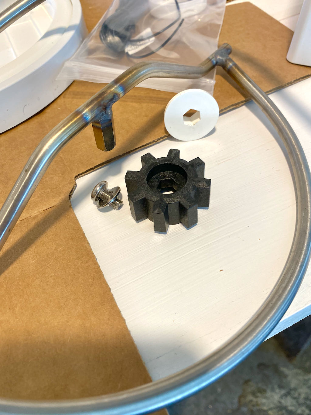

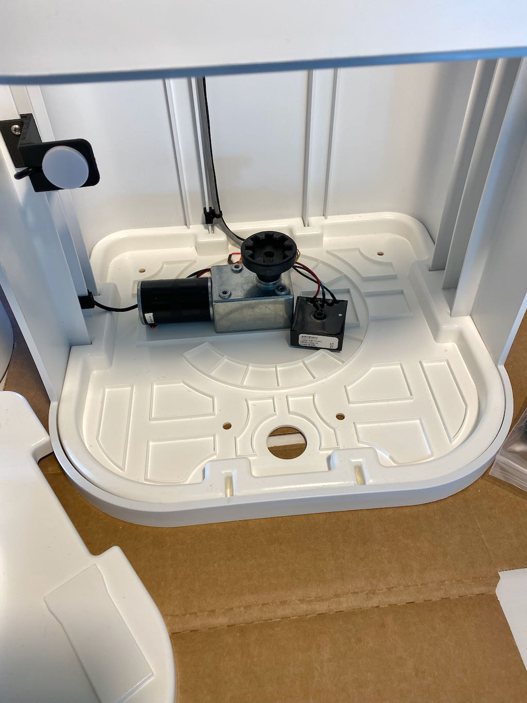

"I've heard questions about the robustness of the connection between the bin auger and the motor. Some folks have questioned if this is really robust enough. And there have been questions about the seal between the auger and the base... Time will tell..."
I wondered that too so I took the connection apart: It's stone age. The hard plastic cog engages it's mate on the gear box.

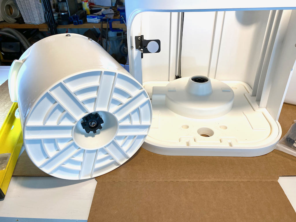

As far as the seal, OGO has a raised hub that if there was a liquid problem (which means you're doing something wrong), it would have a hard time finding the bushing that would leak if submerged.
Plus all this stuff is under a 5 year warranty and is easily replaced. Electrical is 1 year. The motor and gearbox are protected by a thermal breaker (cools and resets).
