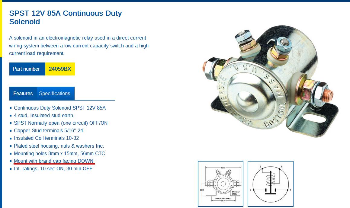

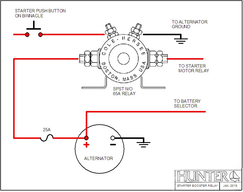

As Roy says, the wiring multi connectors is a prime suspect as well as the green fuse holder Sailcapt references ( just aft and port of the engine) . Cleaning the connections in the two rubber plugs in the harness will help. Running a new heavier wire to the panel, bypassing the connectors will fix it. Another way is to install a relay at the starter to carry the heavier current. Search the forum for “Yanmar starting” and you will find details.

GordonSmith, some info here might be useful to you.
