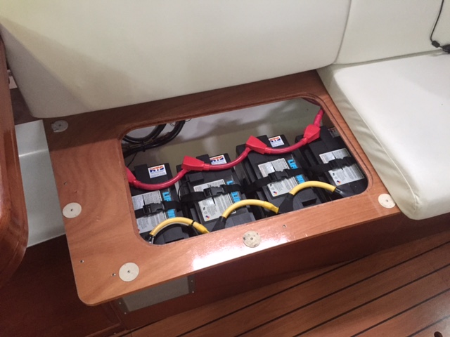

You sound confused about your battery system, suggest you retain the services of a qualified marine electrician to sort out your option. Below photo shows my solution - 4 grp 31 Lifeline AGMs under the port settee. Got the weight out of the stern of the boat and counterbalanced a genset install on the starboard side. Location is midships to port. This install was facilitated by an existing inverter in the settee, and related existing battery cables. 500 Ah house bank, separate Grp 27 starter battery aft the engine. 6B589F37-C55B-4AA5-A6CB-61B21800F88E.jpeg

You sound confused about your battery system, suggest you retain the services of a qualified marine electrician to sort out your option. Below photo shows my solution - 4 grp 31 Lifeline AGMs under the port settee. Got the weight out of the stern of the boat and counterbalanced a genset install on the starboard side. Location is midships to port. This install was facilitated by an existing inverter in the settee, and related existing battery cables. 500 Ah house bank, separate Grp 27 starter battery aft the engine. View attachment 158185

Gunni-well I may have been confusing in my posts but not confused regarding DC electric. I have a solid understanding of DC.
My queries have been about the actual physical placement of the batteries. Your photo is much appreciated but
does not appear to be a Beneteau 373. Yes I can measure and calculate available space for my batteries under the port settee (the most likely place) but prior to jumping in, I am merely looking for someone who has already upgraded to two house batteries on a 373-why rediscover the wheel?
one of my concerns is off midline weight and you account for that with a genset on starboard. The Beneteau 373 has a water tank mounted aft and starboard which will somewhat counterbalance 300 lbs of battery weigh. I already have a 16,000 btu a/c unit under aft-most settee.
