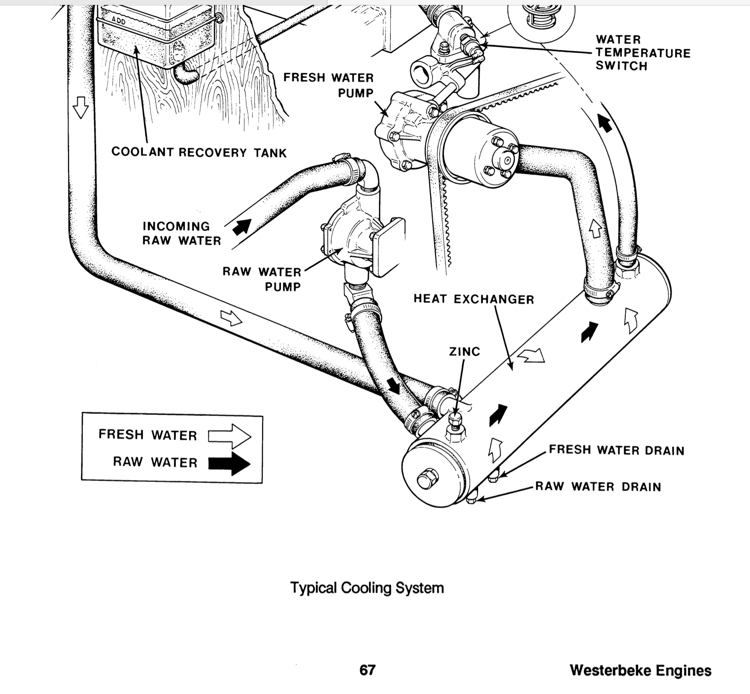

Wait … @sailme88
zinc in the heat exchanger?
I replaced the anode on the prop shaft (magnesium in fresh water) is there another anode I didn’t know about?
(more about that steep learning curve)
YES !!! Didn't pick up that you are a laker, so the battery effect with salt is not an issue. But, stray electricity is. Your heat exchanger should have caps on each end. Pop the caps and inspect the tubes. You're looking to see through without any obstructions. There should be a pencil zinc near the far end cap.
