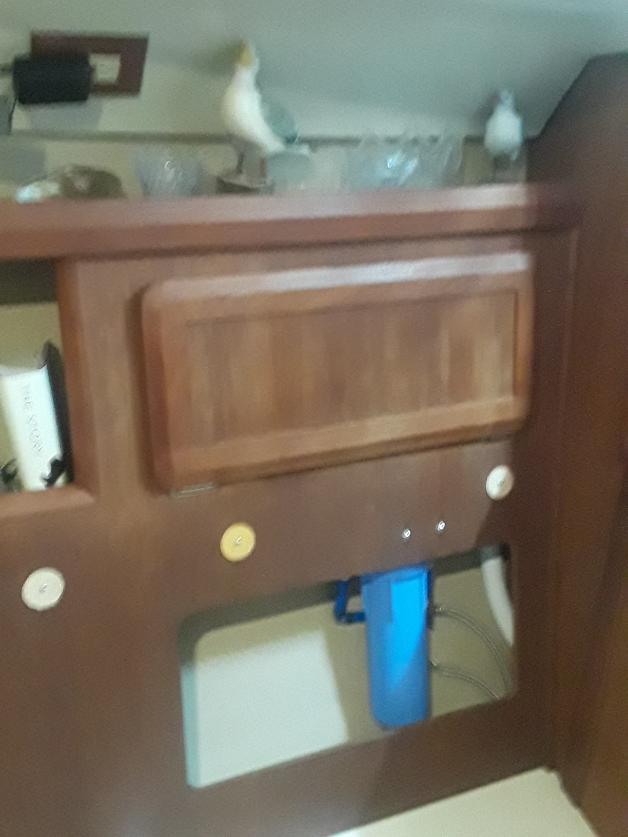

I followed the Practical Sailor article on producing clean water. I installed a Pentek CBC-10 carbon-block cartridge filter inline with my galley faucet.
JBP-PA
Apr 29, 2022
789
Jeanneau Tonic 23 Erie, PA
The last few years I've been using the Pentek Floplus-10. It's the same 0.5 micron performance, but less pressure loss.

Another thing I did/do besides my onboard filter system; I filter the dock supply with another filter before it gets into the tank. I installed a cleanable screen on the vent side to keep bugs out. I also added an inspection cover to the tank so I can scrub it out and keep it bone dry in the off season.
