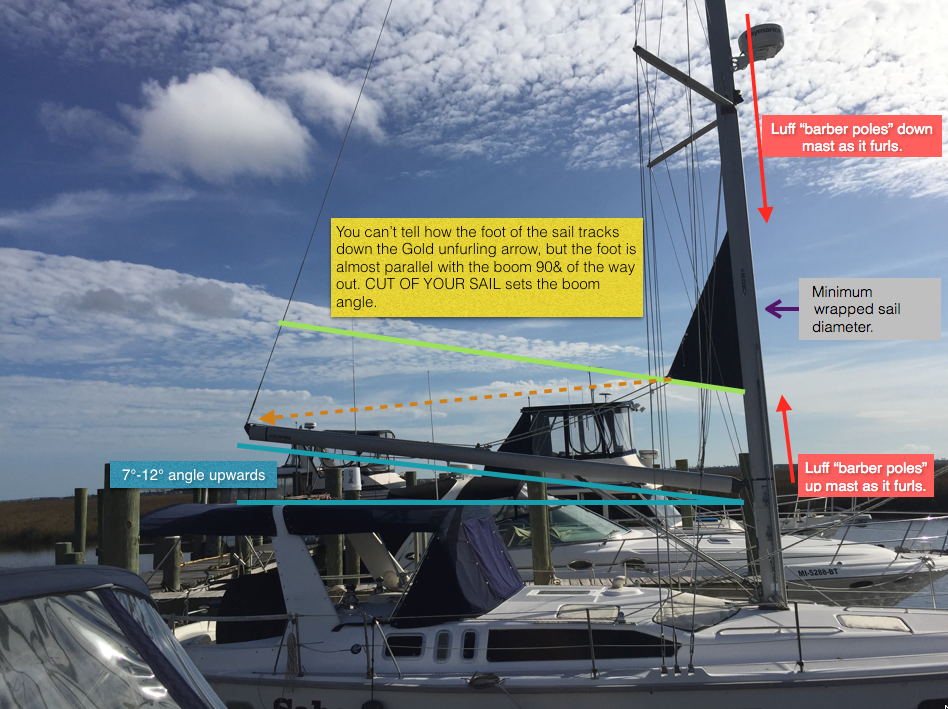

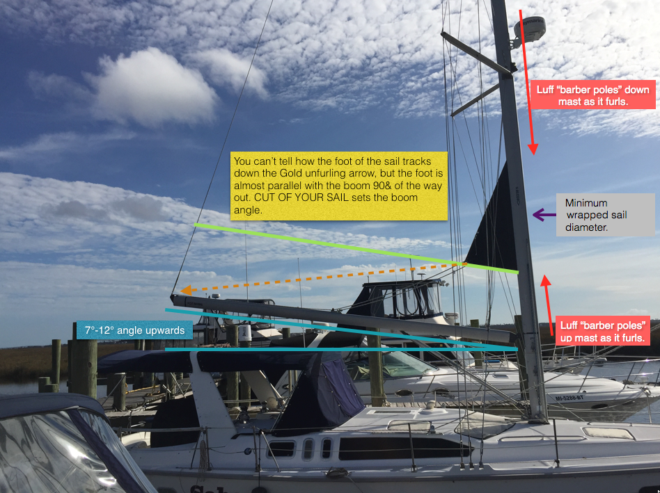

I was at my boat and took a picture to show all what I tried to put in words, above.
I hope this helps more.
Jim...
Thanks Jim. The picture are a great help. I will try to approximate your boom angle. It is much steeper than I have tried, in fact, it had been suggested to pull the boom down as far as possible.
The angle is determined by the cut of the sail and NOT by the rigging or other adjustments.
Find the angle for YOUR boat. By doing this, you yield the least force to unfurl and minimum wrapped diameter in the mast.
If your sail is stretched (bellied like mine was), imagine if your boom angle was 90° and you put maximum stretched cloth and diameter at the FOOT of the sail (jamb time).
BTW I miss labeled the Gold typo at 90% not 90&. It was really weird to see the sail track parallel to the boom until about the last few feet. The reason why...
My sail is NOT a 90° right triangle but more of a 80° triangle with the luff.;)
Good Luck and maybe Santa will bring a nice gift!
Jim...

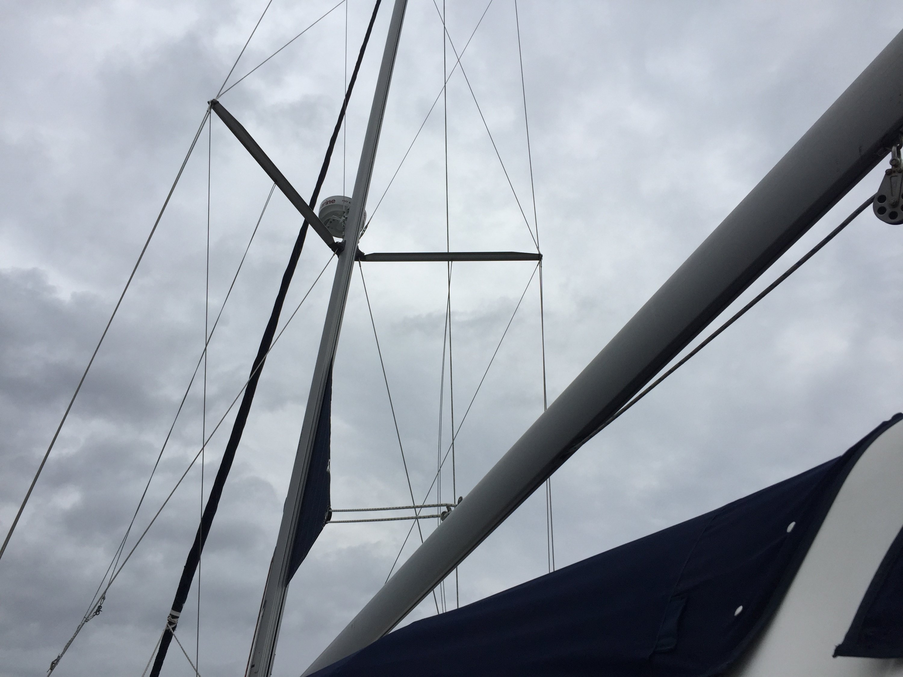

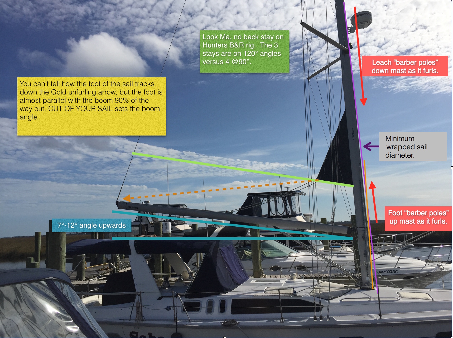

I decided to show the pre-bend on my boat using an updated picture from my post#22. I added two new graphic lines on the fore side of my mast edge (purple sloped and orange vertical). The gap is the pre-bend and note the max bend is where the two lines cross. The purple bend line is "cheated" to aft to compensate for the un-shown mast head (≈20' higher).
Hmmmmm? Right where maximum force is applied by the boom in high winds. Also note there is no furled sail below the boom( furling starts at the bottom of my up pointing red arrow) and very little furled sail where it is "conceptually" dragging inside the maximum mast bend point (if you set your boom angle right).
Make sure YOUR boat's rigging matches your sailing practices and equipment.
Happy furling!:)
Jim...

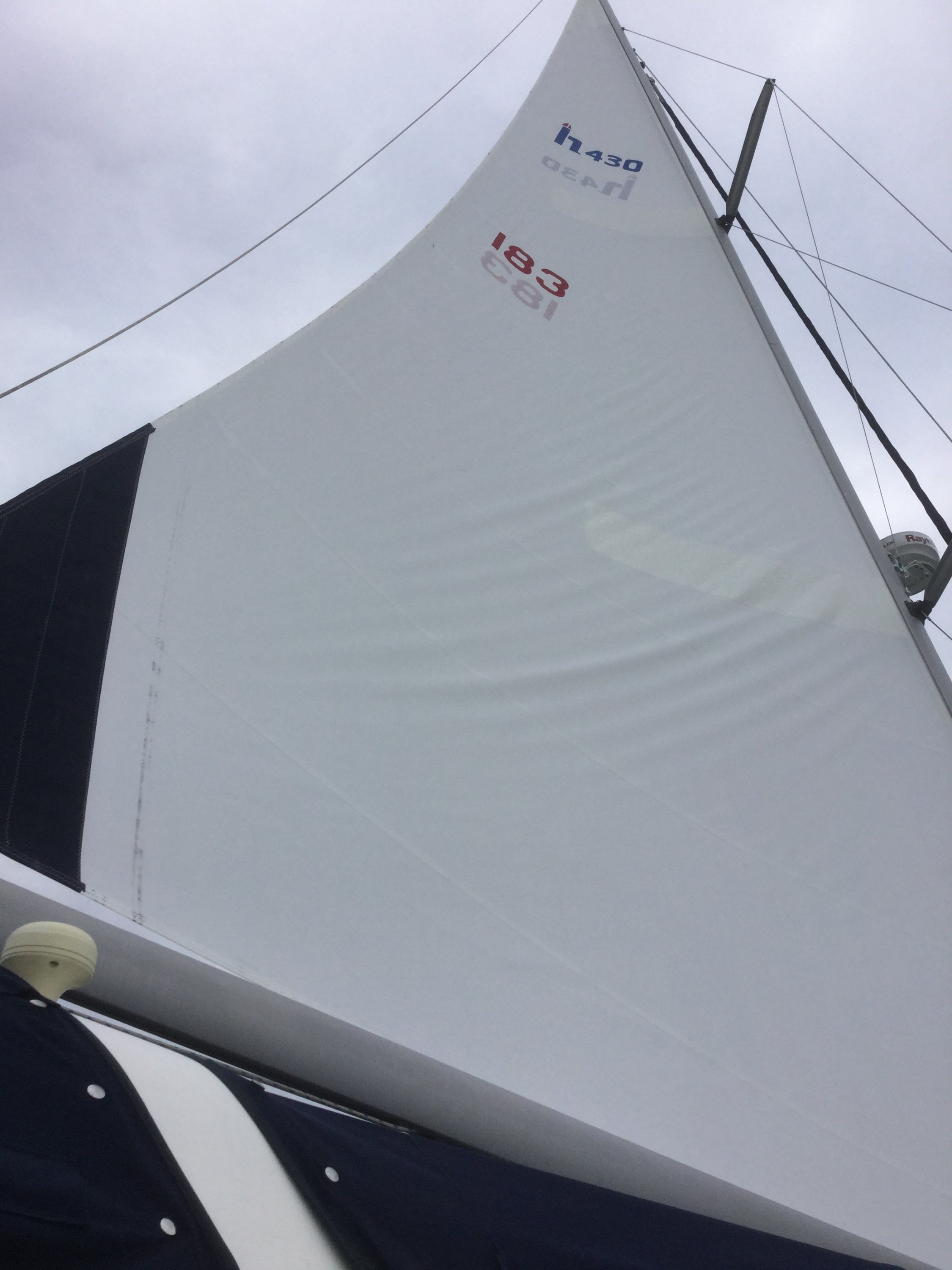

I installed my new main and furled and unfurled with easy.:thumbup:
@Perfect Excuse I hope you are becoming as one, with yours!
