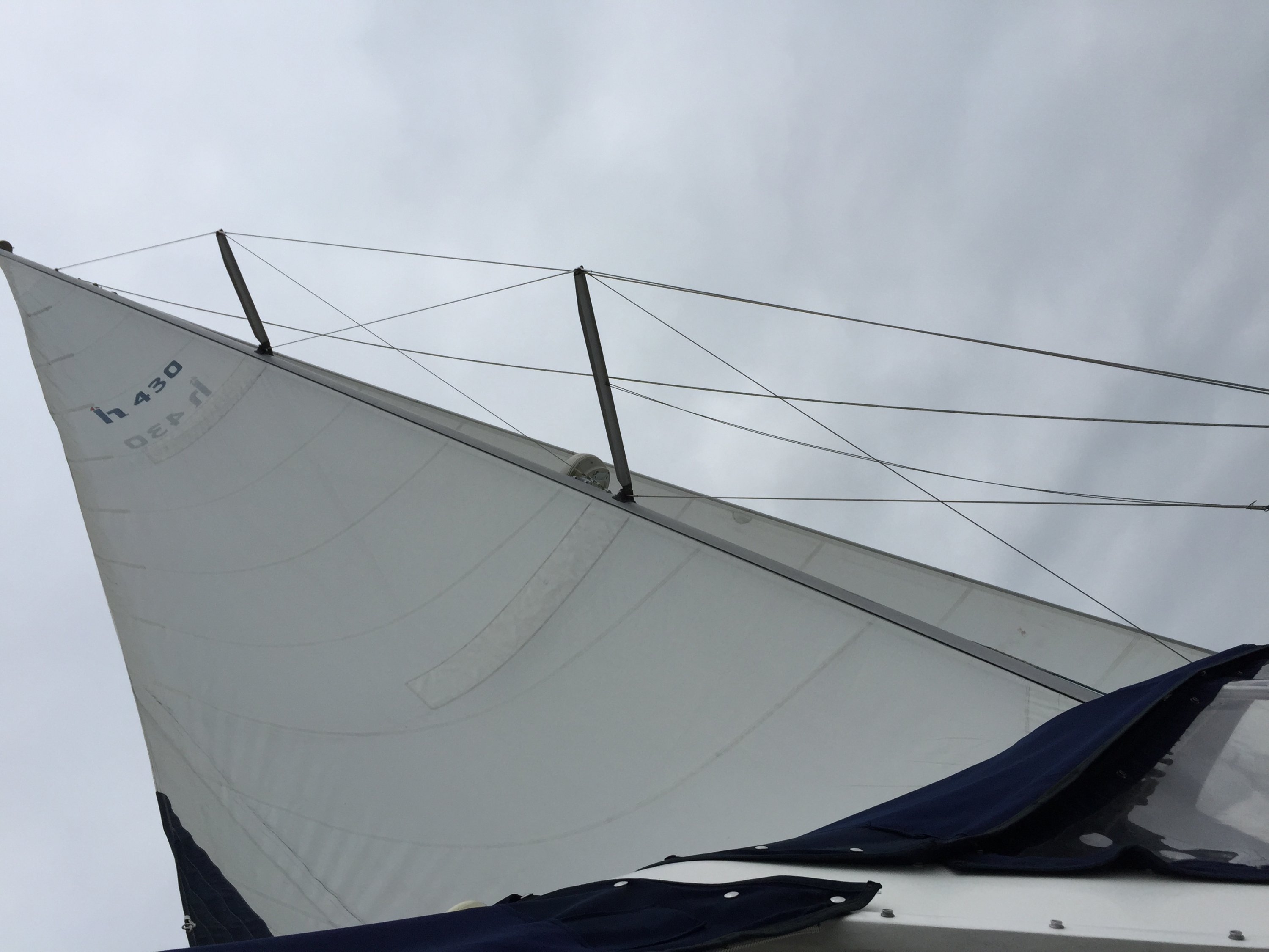

Mine worked fine for my first year of my boat ownership. Z-Spars is the maker. I replaced/rebuilt the entire furling drum for $190 buy US-Spars ( USA Z-Spars ). I talked at length with their furling expert, but it still was way to sensitive.
Then I notice that the OEM 14 year old sails had lost their stiffness and was "baggy at the clew, thus putting excess cloth in the worst area of the furl, THE FOOT.
So just installed my new sail (14yrs of service was good enough). I went in like silk, no struggle or fuss. I out hauled it again and it unfurled. like silk. with an easy never seen before.:biggrin: My helpers, who helped drop the old sail, remarked how stiff then new fabric was and also the material was silky smooth and not like the "raised fiber" or rough feel on the retired sail.
If look at my profile picture, you can see how I made the old sail last 6 more months, by leaving the "excess stretch" out of the mast. You can see the "stretch in sail" near the clew fabric in the big picture.
I am now amazed at and understand why many love the in-mast furling.
My new Sail maker put it up and warranted the performance. Give me a private message if you want more tips I have learned.
