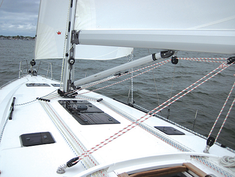

I also discovered that "my" version is often called a two-mainsheet system. Not to be confused with the similar German Sheeting System.
Bavaria46lookingforward
Trimmed in hard, the 46 was able to sail at close to 40 degrees to the true wind. The small genoa sheets inside the side stays so the sheeting angles are quite narrow. The in-mast furling mainsail, built by Elvstrom, was cut quite flat but was drawing nicely. The main sheet uses what is being called the “German sheeting system” since all of the Bavarias are set up this way; the sheeting involves two independent main sheets, port and starboard, that replace the sliding traveler.
You use the windward sheet to trim the sail and the leeward sheet to trim the leech in much the same way you would with a conventional traveler. When it comes time to jibe the main, you can maintain complete control of the boom through the jibe by handling both sheets at the same time, a job easily managed by one person.

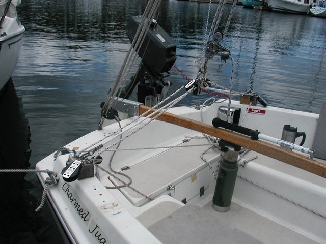

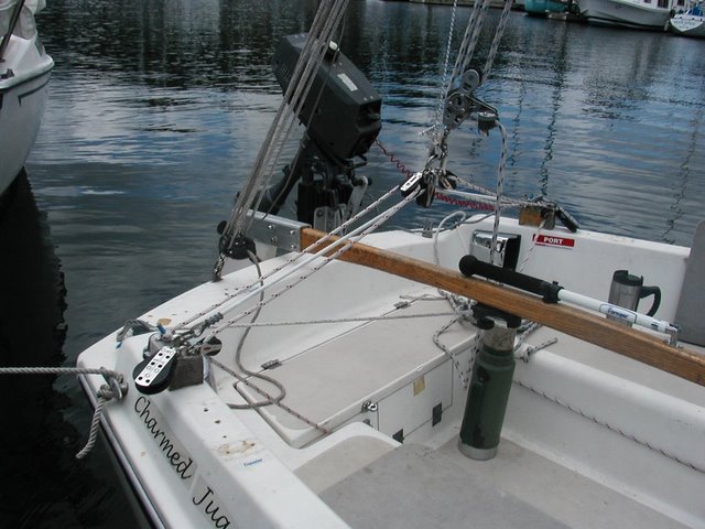

Sorry, I should have given credit. This pic isn't from my boat, it's a San Juan 21:
Travelers - San Juan 21 Fleet 1
His installation is complicated by the Tiller being in the way--you won't have that problem with the 216.
Given the reduced loads of end boom sheeting, I think a 3:1 mainsheet and 2:1 traveler secured to a pair of (properly backed) U-Bolts would be adequate.
-Z
Thanks for the extra photo and the San Juan link answers most if not all of my questions.

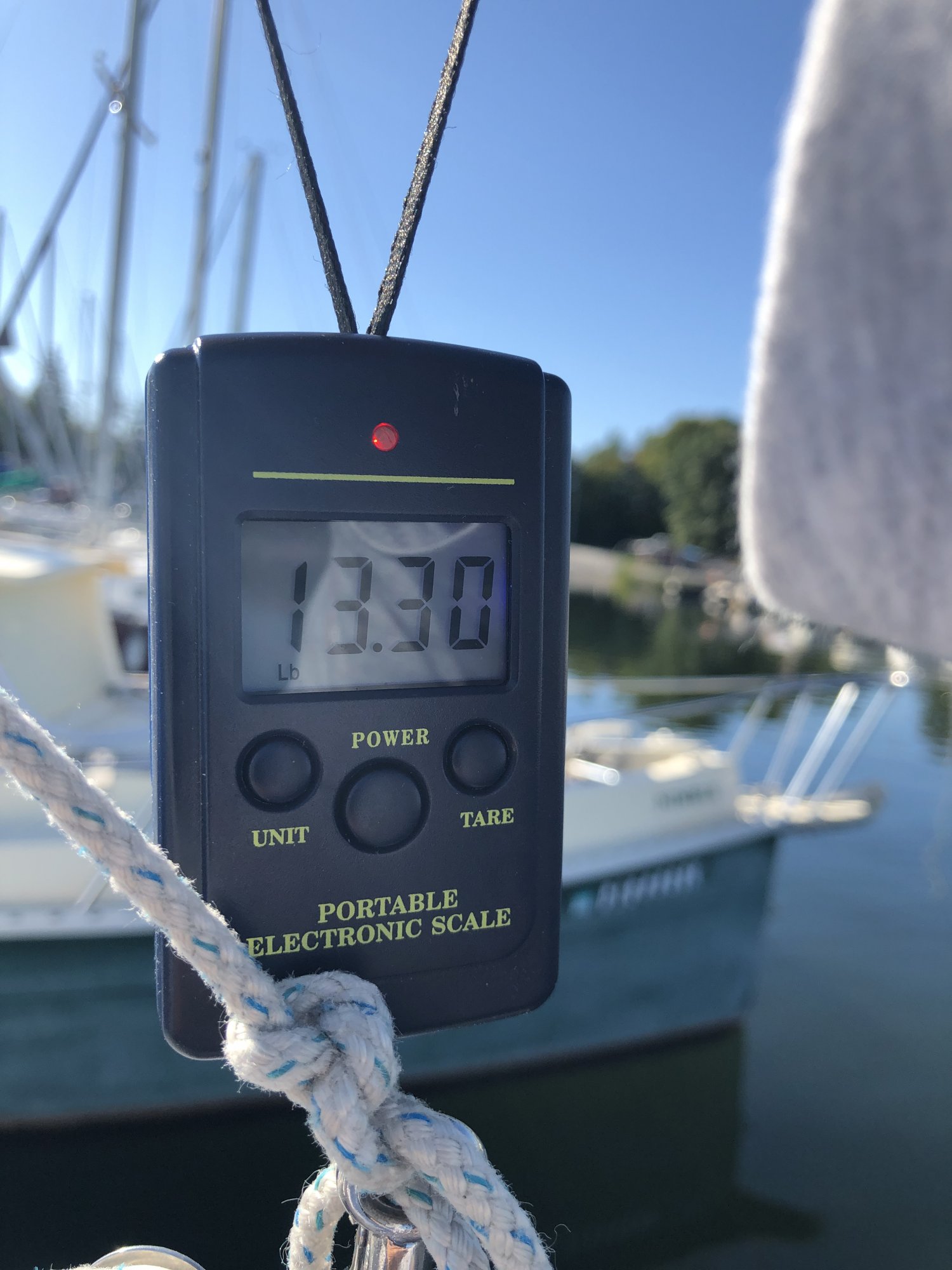

I measured the end of boom weight as I was curious. The boom, mainsail and mainsheet are all stock Hunter. There was also a canvas mainsail cover on the sail when I measured. As you can see it was about 13.5lbs assuming my fishing scale is accurate. Thought it would be more!

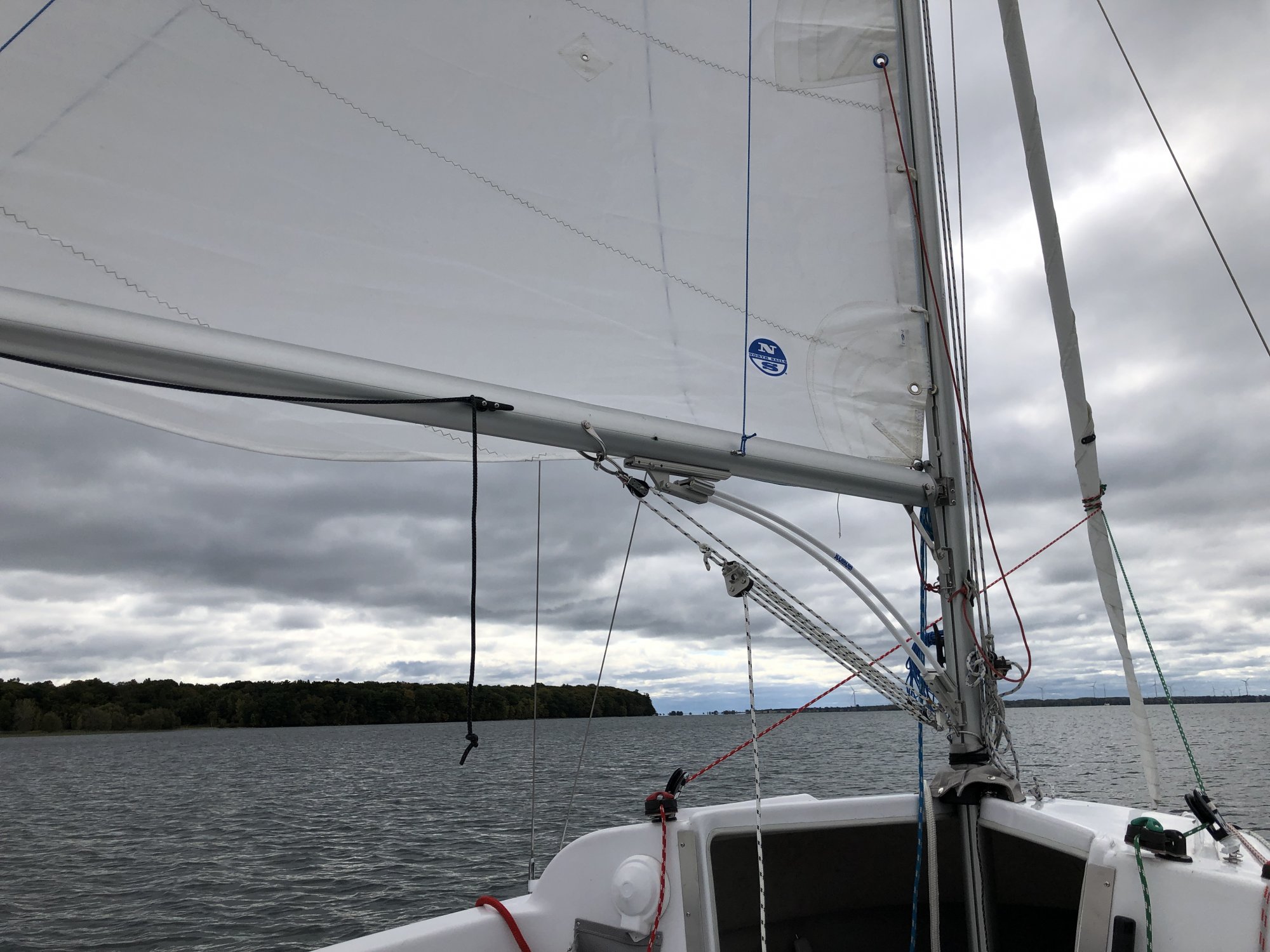

Managed to get out on the water today, getting late in the season here (first frost warning tonight) to try out the new boomkicker / roll stop setup.
As @John Welch said it makes quite a difference in performance but I also noticed that with the rope vang and mainsheet relaxed but snug the head clearance under the boom is much better. So likely less head clunking the boom during swim time!!
