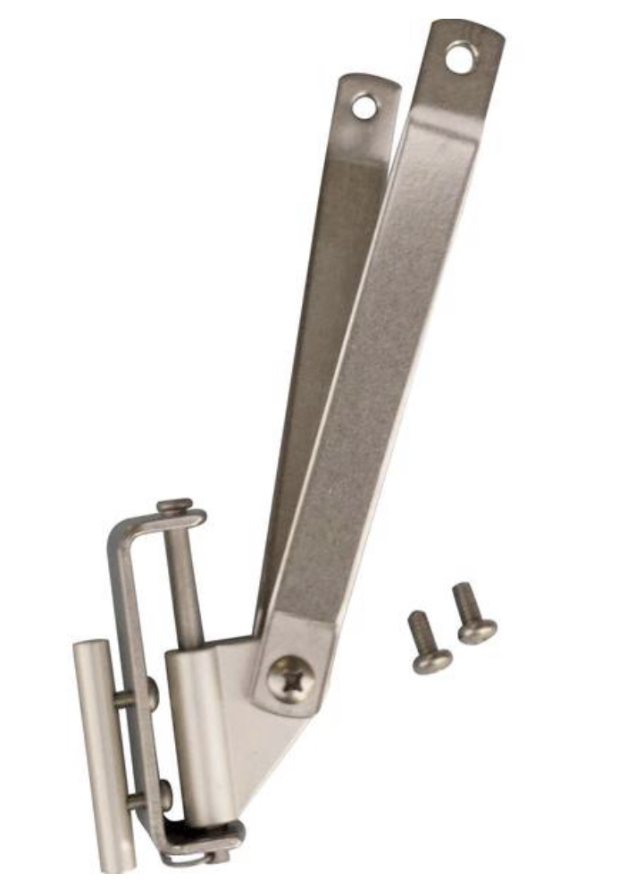

But first we need to control the “sloppy boom” with a Seoladair roll stop fitting.
The roll stop greatly improves the boom response.
The kit uses an eye slug or mast fitting slide that drops down from the mast opening for the sail cars.

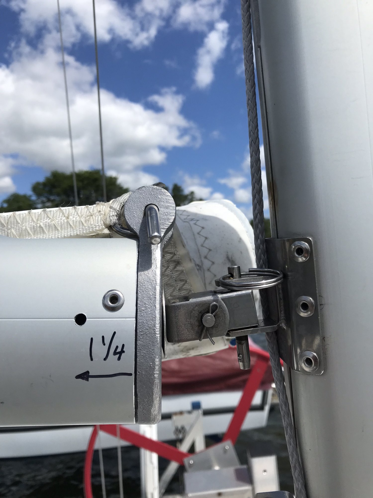

A hole is drilled an inch and one quarter from the end of the boom

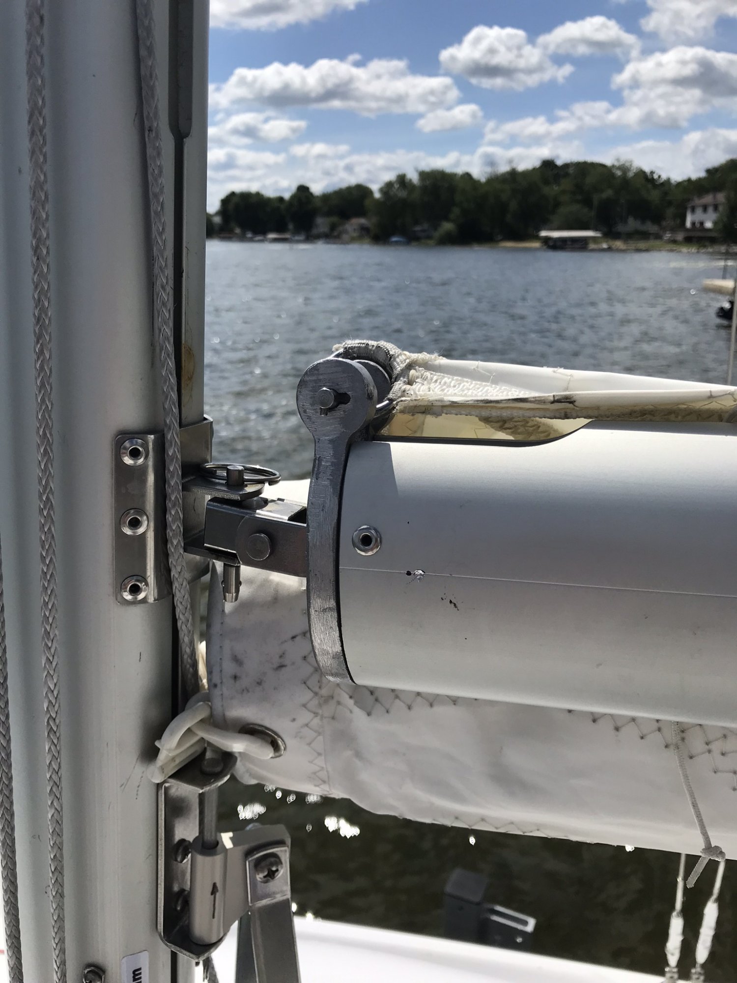

The roll stop U bracket is screwed into the eye slug with two screws.
The two stabilization arms move upward and are secured by two screws in the hole drilled and tapped into the boom.

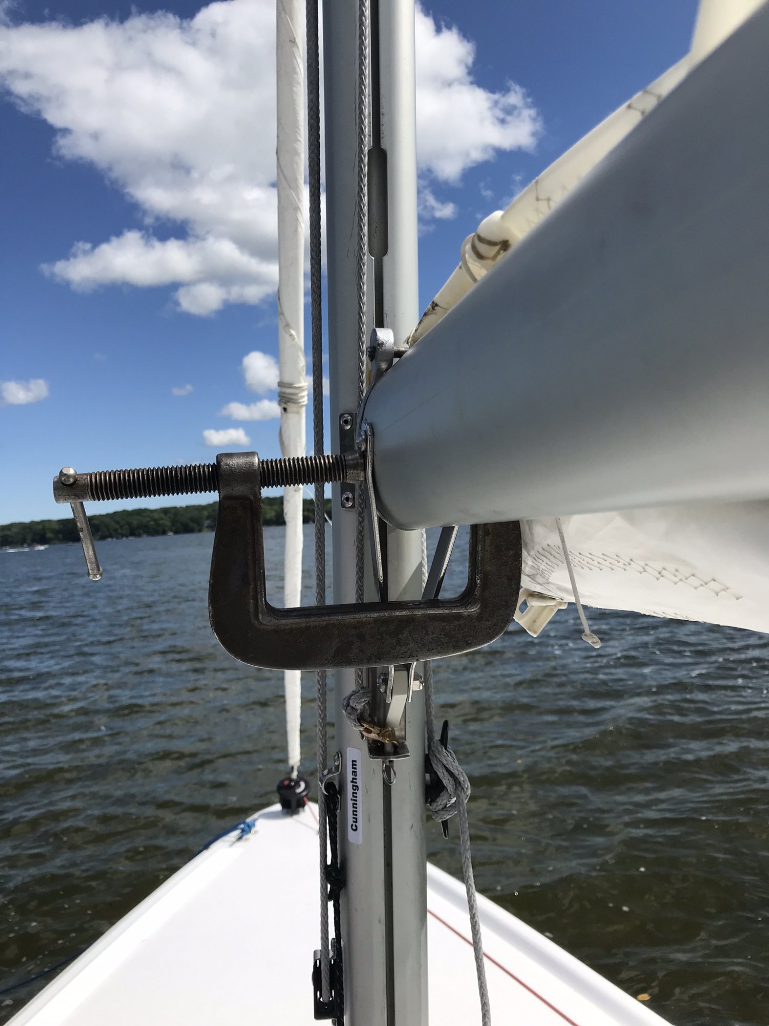

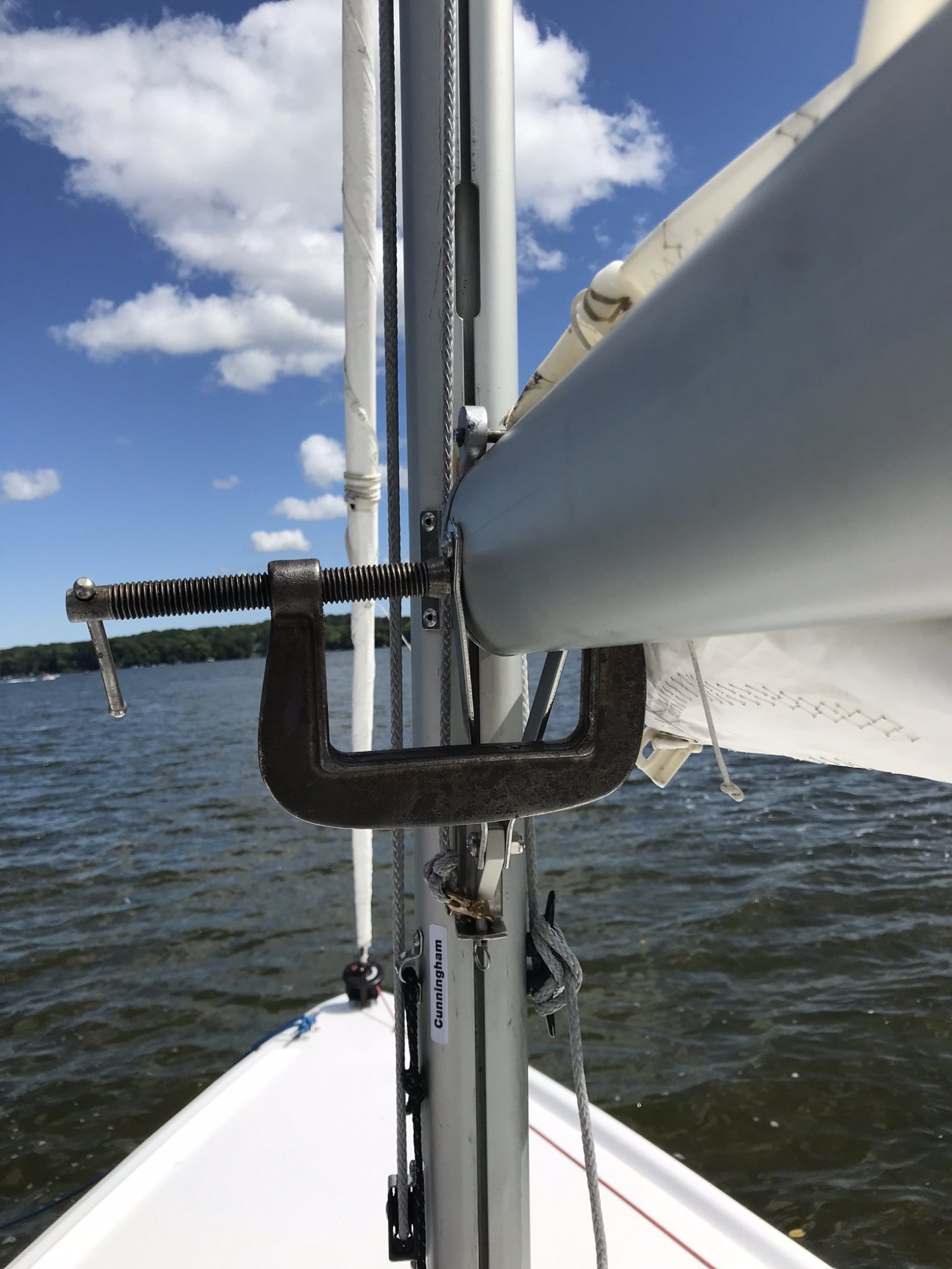

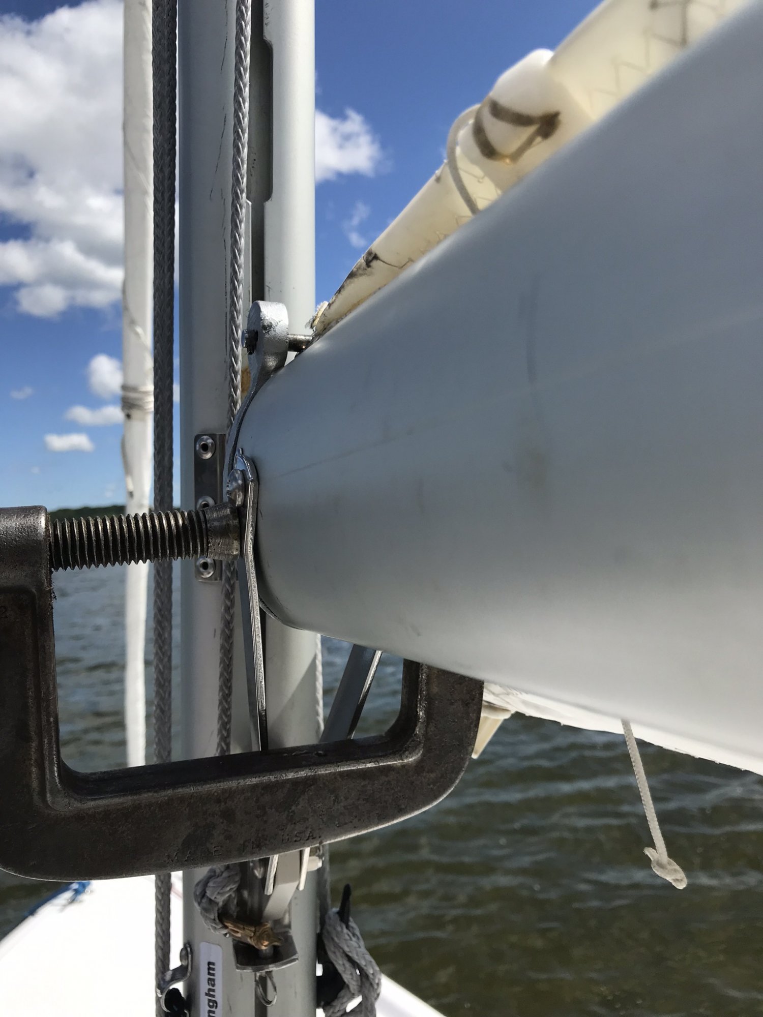

Use a C clamp after the screws are started to slowly modify the roll stop arm to conform with the girth of the Hunter 216 boom

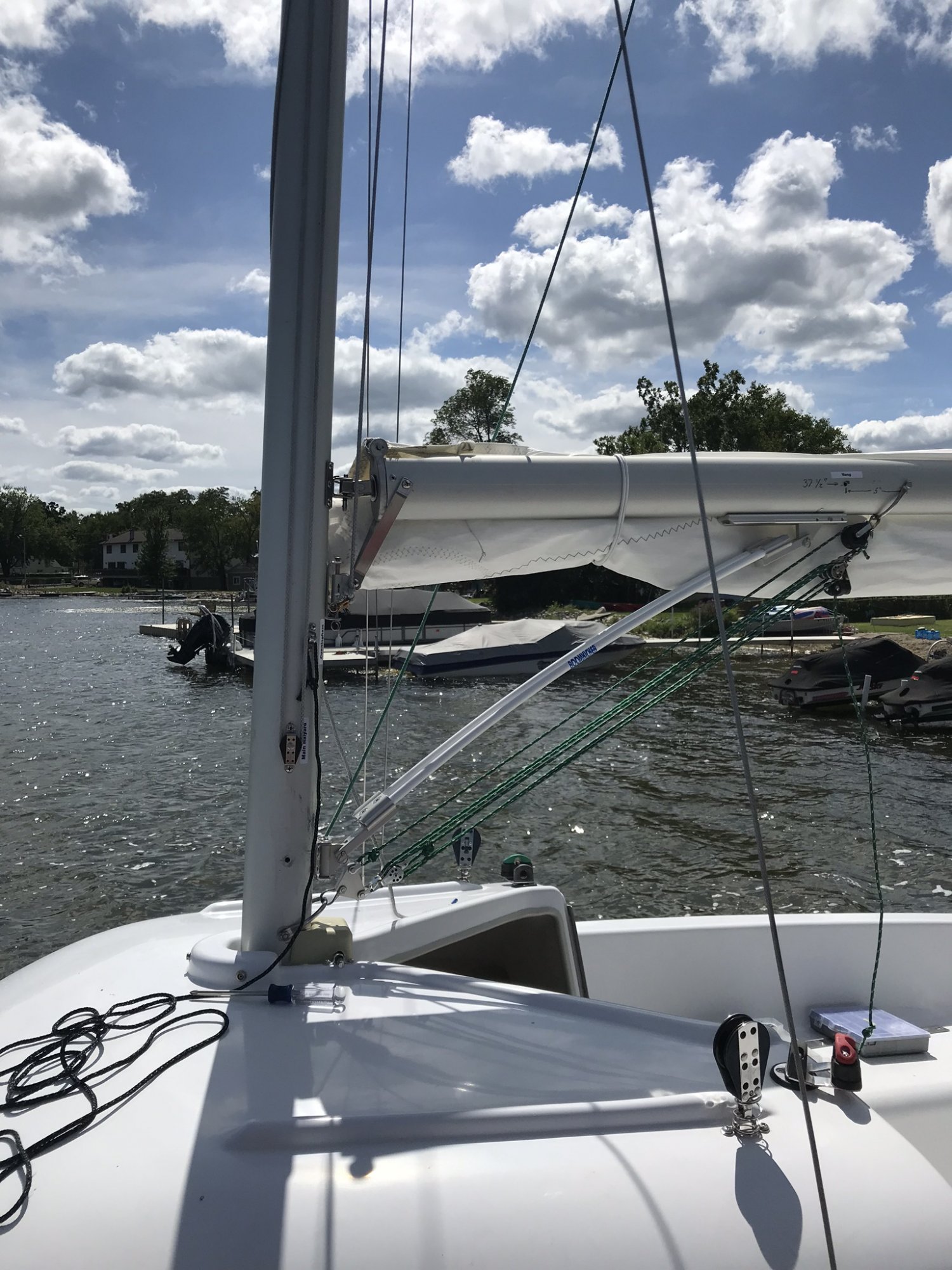

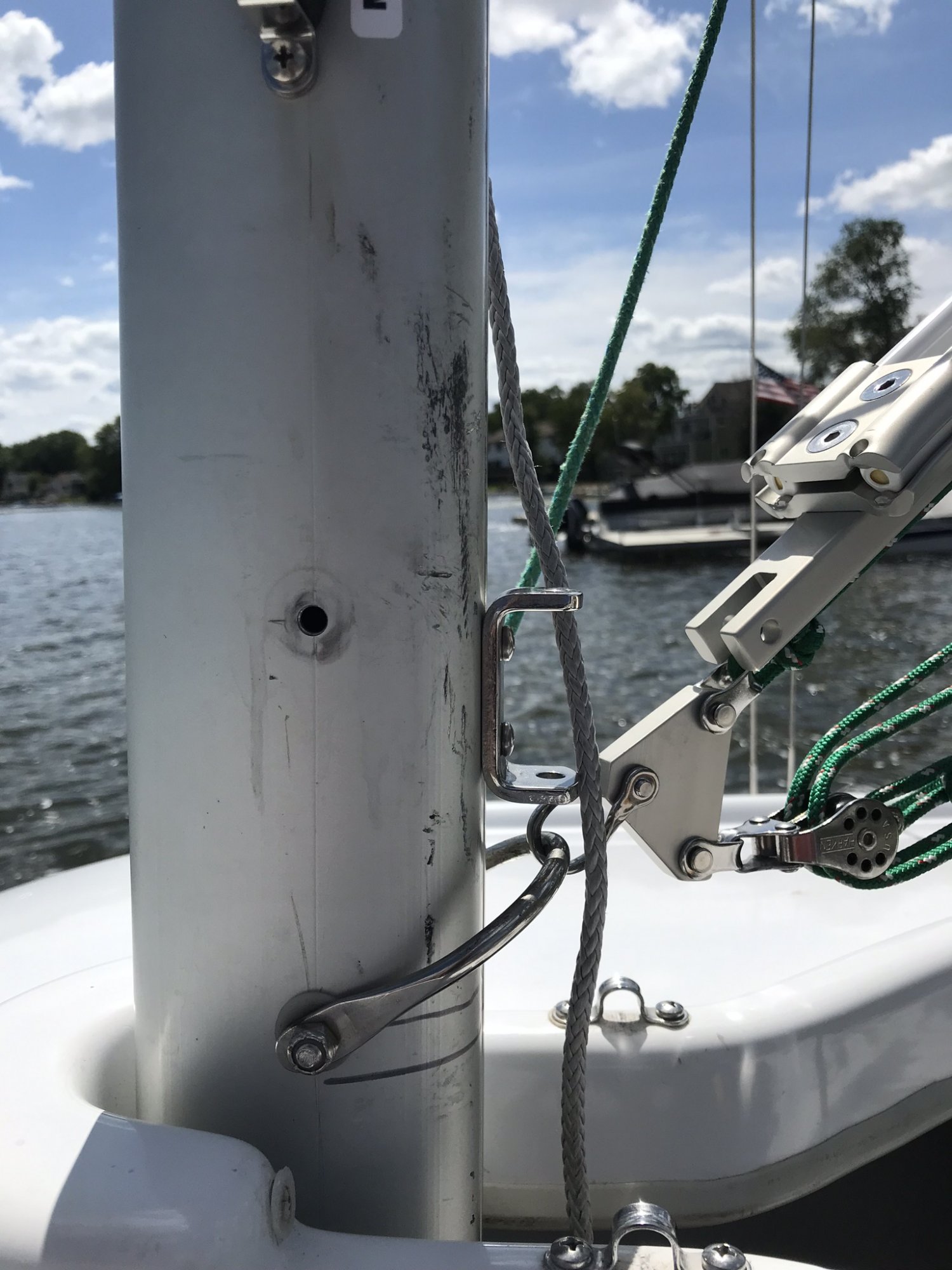

Mounting the Hunter 216 Boomkicker 750 was very straight forward.
Measure down four inches from the original mast bail on both sides and drill a hole for the 1/4 inch bolts.
Nov 19, 2018
28
Hunter 216 Silver Lake, Wisconsin
Tape a small wrench into the mast slot at about the mast rubber bumper to stop the eye slug. Drop the eye slug down the mast sail track opening. Stew the U flange into the slug. Add the bottom mount for the Boomkicker

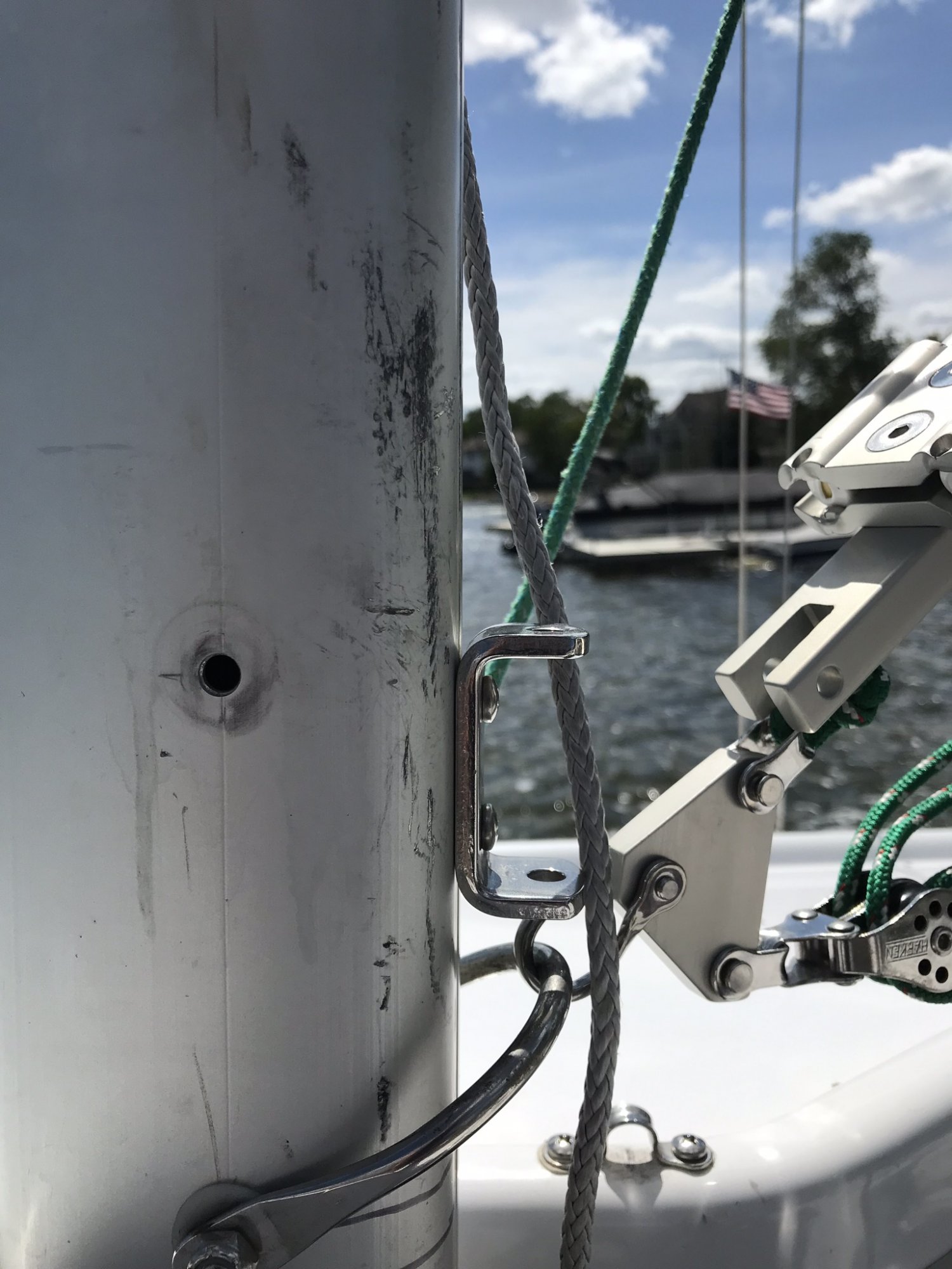

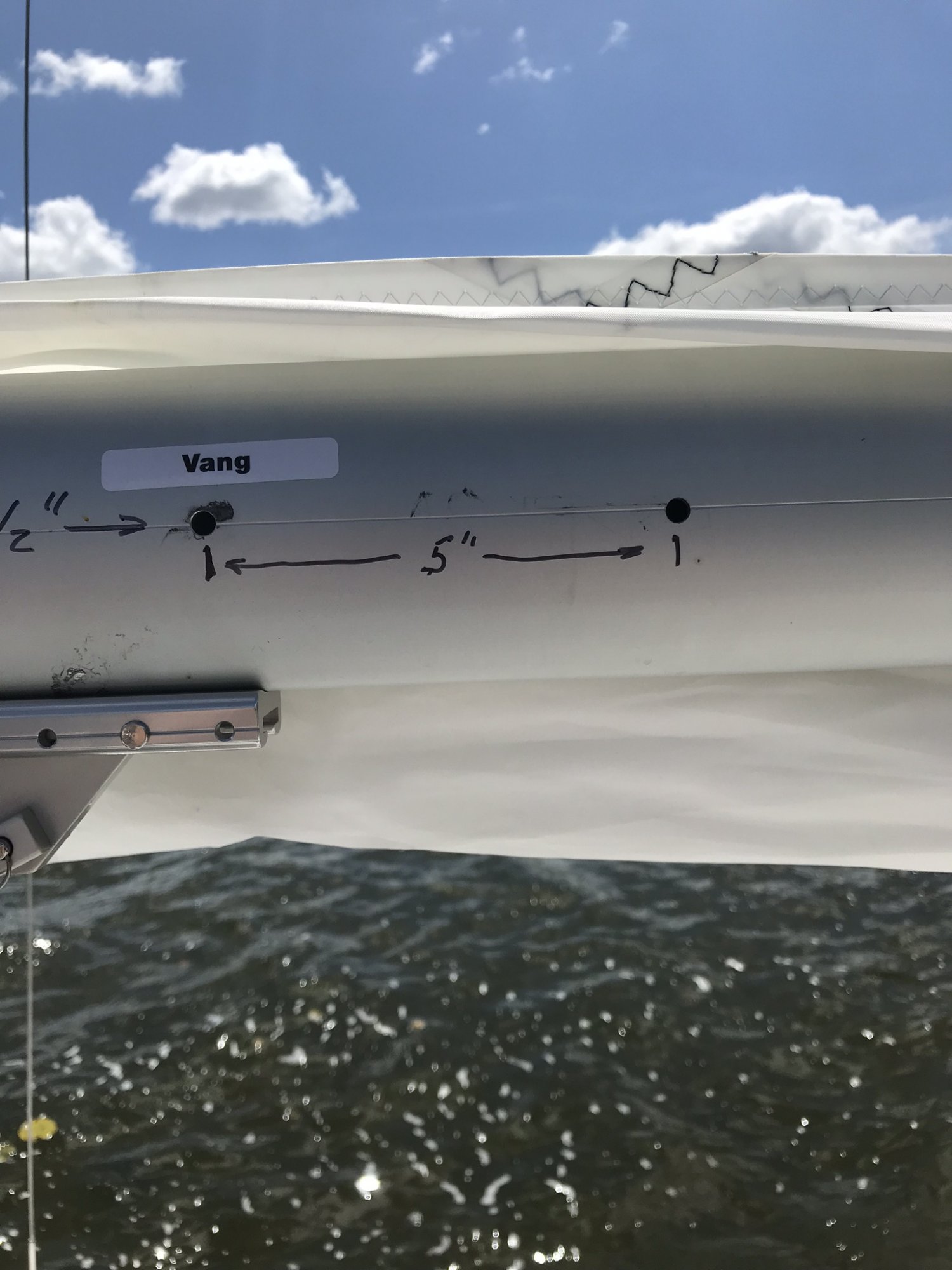

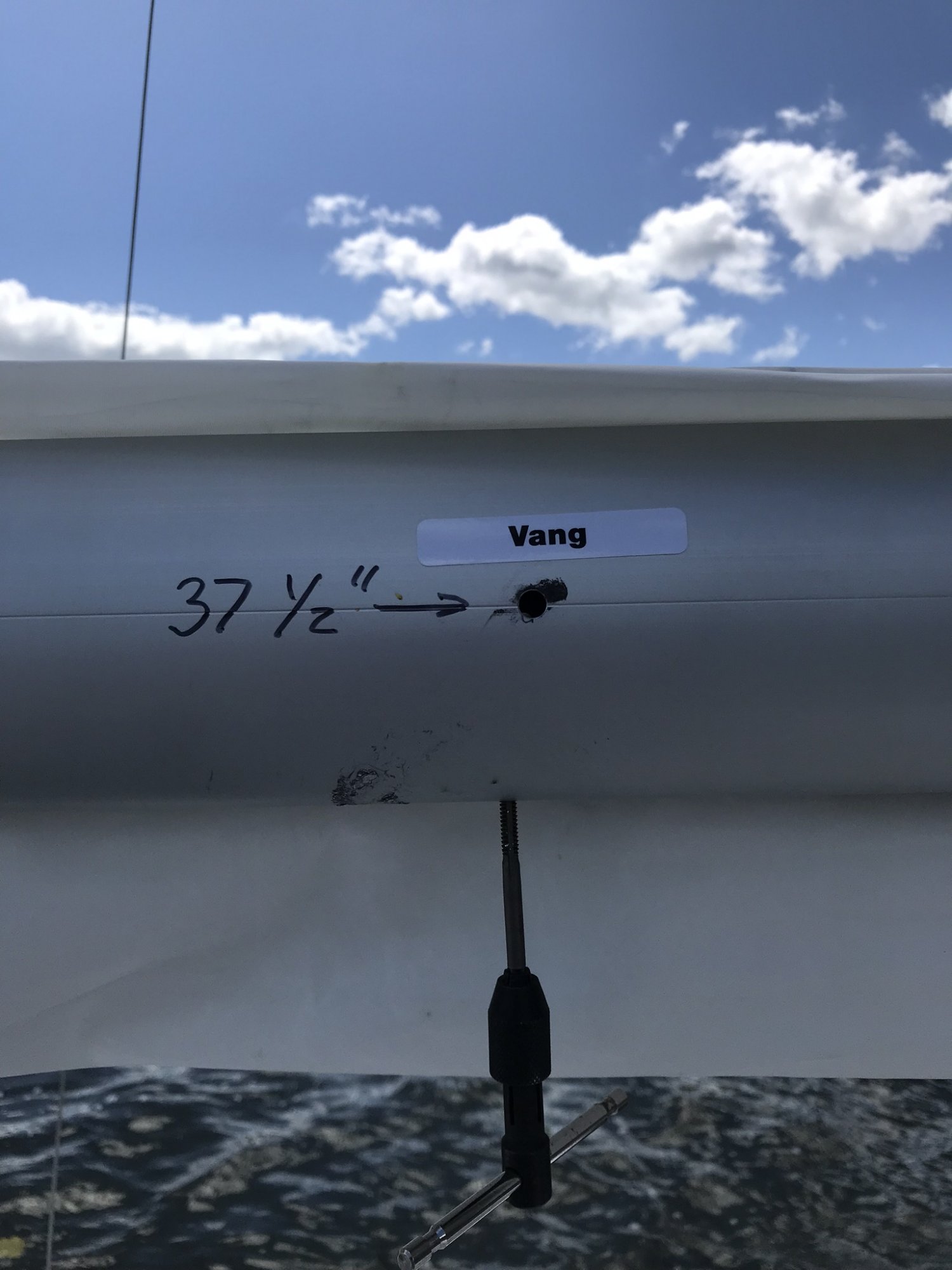

Then move to the boom. Remove the boom bail and drill two 1/4 inch holes farther away from the gooseneck

Mount the upper Boomkicker attachment onto the boom. Mark three drill holes after you tape the track to the boom. Drill and tape with the tools that are provided
Nov 19, 2018
28
Notice the original boom bail holes were 37 1/2 inches from the Gooseneck Pin. Newer boom bail holes are 42 1/2 inches from pin. Srew in the upper track into the boom.
Set the location on the middle hole

Attach the main halyard to the end of the boom and raise the boom. Slide and pine the two ends of the Boomkicker to the mast attachment and the boom attachment. Mount the lower purchase triangle plate to the mast bail and the upper Vang to the boom bail
Nov 19, 2018
28
I took the Hunter out of a sail afterwards and it transformed the boat. My hunter went from a mud-duck, vague handling barge to a Olympic 470 on steroids! In 25 years of racing and sailing I have never spent so little time and money to gain so much performance with control!

Use a C clamp after the screws are started to slowly modify the roll stop arm to conform with the girth of the Hunter 216 boomView attachment 168975
I found this photo that helped me visualize this component. I’m not sure I could install the boomkicker now as I siliconed the track to try to keep rainwater out. I will have to check with your mounting dimensions to see if I will have a problem.

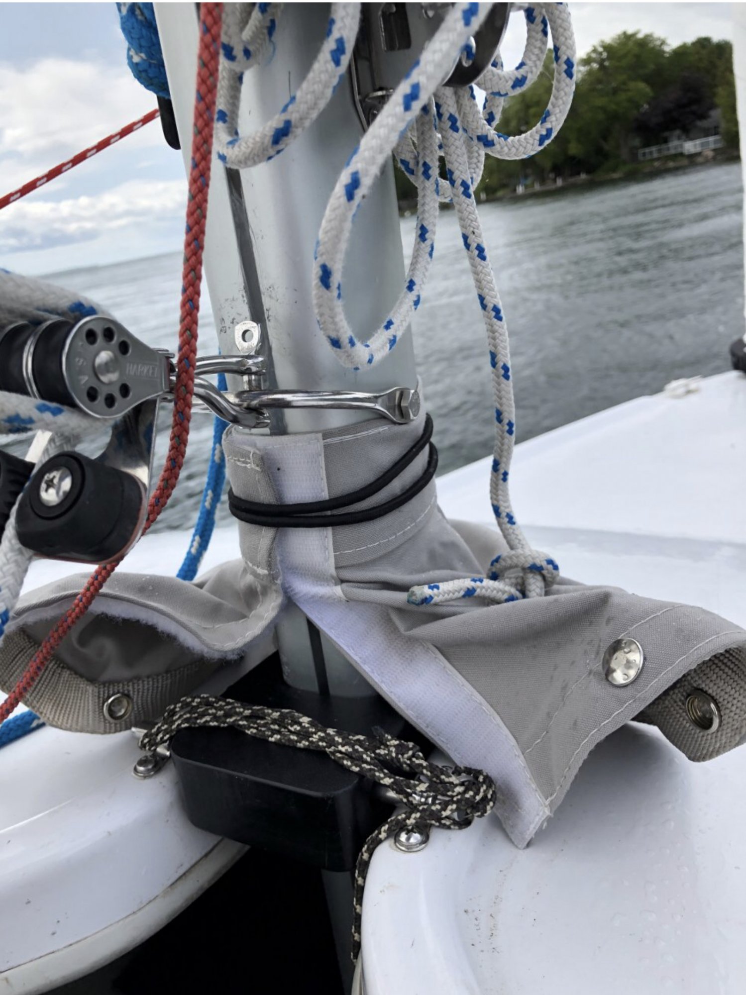

I do have an issue with the siliconed track (photo below) but maybe there is a solution that might also solve for another potential problem.
Assuming I leave things the way they are at the mast (removing the silicone would be tedious) and simply mount the mast connection point of the boomkicker higher than you did I would preserve the current waterproofing of the silicone and canvas mast hole cover (the other potential problem).
The angle of the boomkicker would be different than yours by a few degrees and I might have to shorten the rods to get it to fit to the boom properly but I’m not sure it would work correctly with a full range of motion.
Is there a specific angle that must be attained?
Note my light cord equivalent to your pin drilling.

I’ve read through it now several times and wonder why you installed the roll stop mast slug before inserting the slug for the mast end of the boomkicker. How did you get the bottom slug past the top one?
My other question is about the upgraded rope vang.
Is it necessary to go to a higher MA vang to counter the lifting force of the boomkicker or some other reason?
Nov 19, 2018
28
You are correct, I dry fitted the boom roll stop first and then removed it to drop the eye slug into the mast track for the Boomkicker mast attachment .
Then I reinstalled the rollstop eye slug and finished assembling the boom rollstop

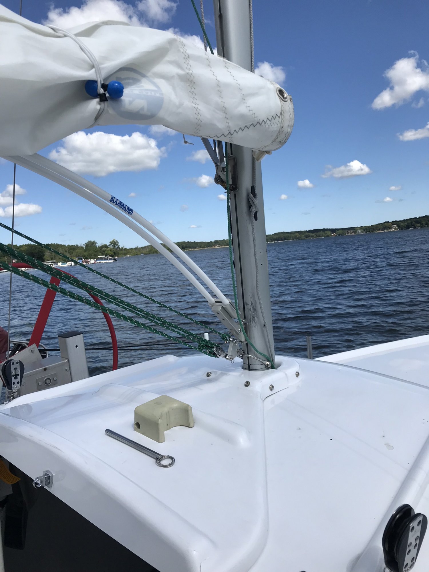

Installed some lazy jacks as I was tired of fighting with the main. It’s made a world of difference for me as I moor the boat and I often drop the main before I pick up the mooring. Before the LJ I struggled to get bungee cords around the sail to keep windage down and also see where I was going, now I just release the halyard and with a few tugs on the main it is neatly stored above the boom.
Even though I tied the top open the battens tend to snag on the way up so I might just use it to drop the sail.
