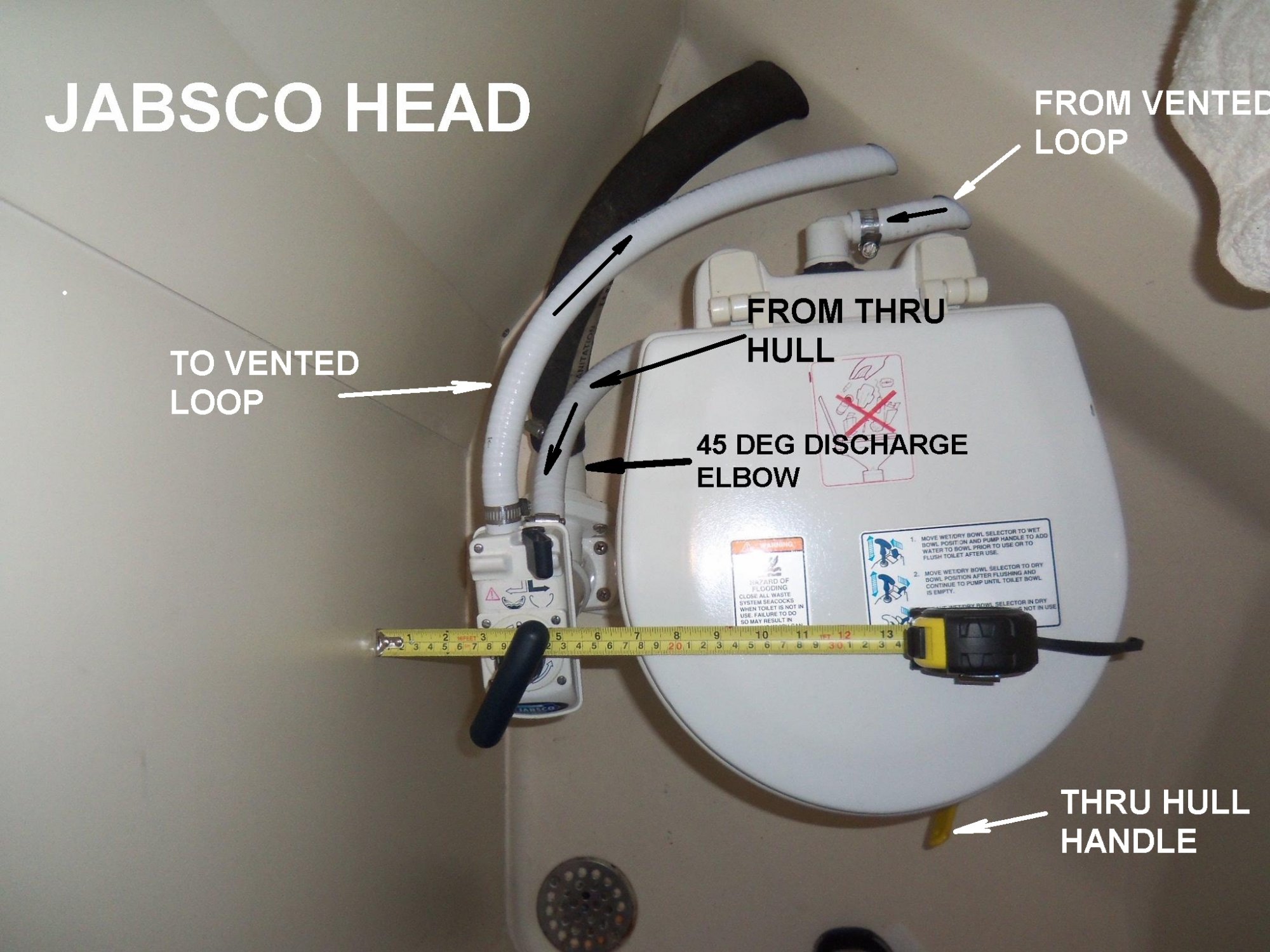

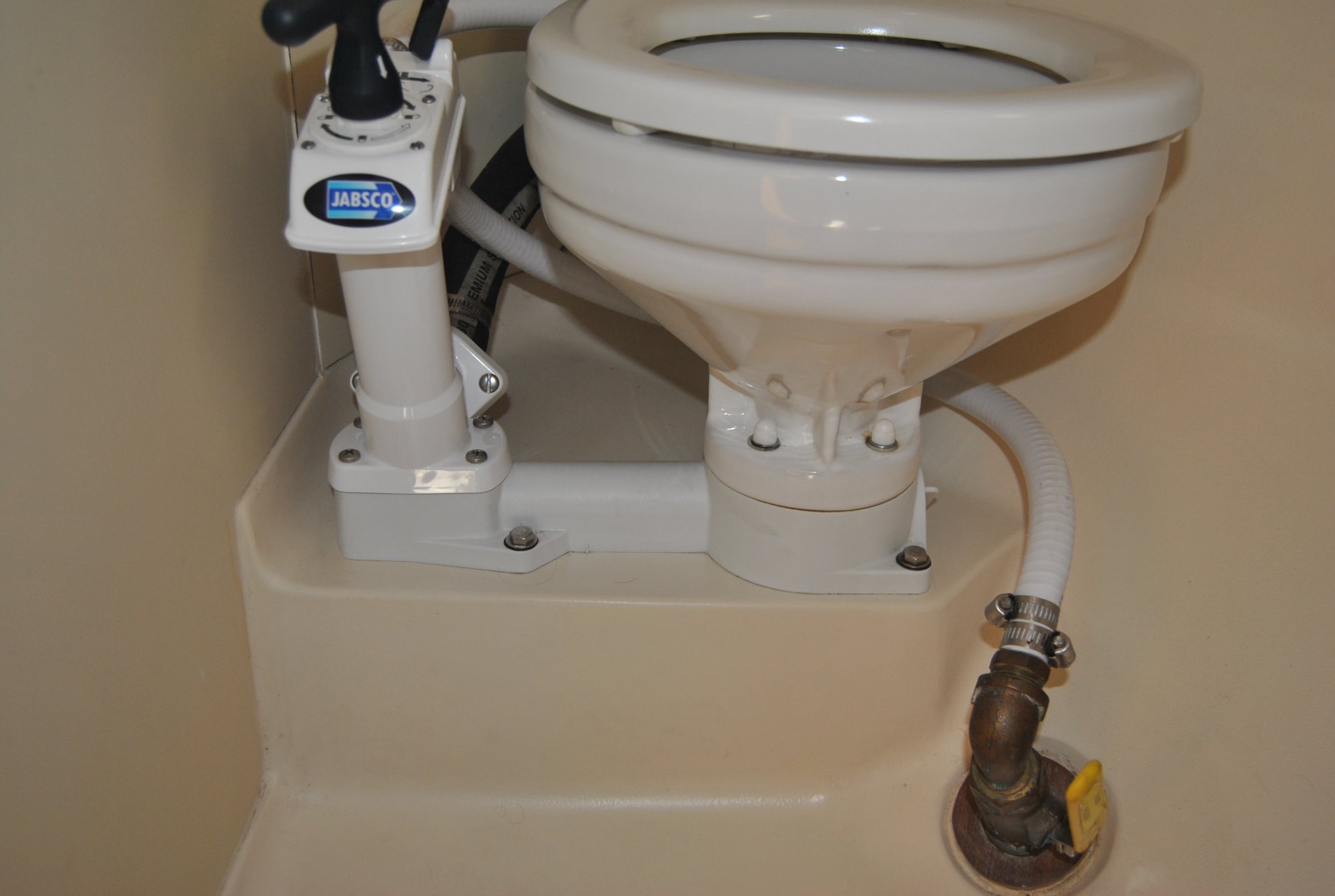

Now the hurdle. The old Jabsco is positioned quite near the rear wall as shown:
and has a 45 deg discharge elbow which feeds the hose through a factory cut hole made back in 1999. All very neat and tidy.

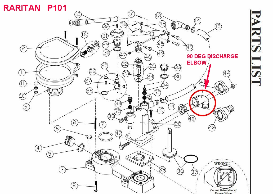

And now, the problem with the Raritan P101. Their discharge elbow comes as either a 90 deg. elbow (41) or a straight discharge (42) as shown:
Either of these two Raritan fittings are not going to allow for an easy installation of the discharge hose behind the new head. At this point, the only solution would be to bore a new hole for the discharge hose and leave a big old ugly hole behind.
My question is, "has anyone swapped out a Raritan head for a Jabsco head and were you able to swap the 45 deg Jabsco discharge elbow for the Raritan discharge elbow "ie. are they interchangeable ? Much of the Raritan appears to be a copy of the Jabsco so just maybe there's a one in a million chance of this working.

Same size fittings are pretty much interchangeable, so you should be able to re-use the 45 from your Jabsco. However, it looks like you've omitted something important when you installed the Jabsco that should also be installed with the Raritan: a vented loop in the intake...see Figure 5 on page 5 in the owners manual Raritan SuperFlush Owners Manual for the correct location, which is between the pump and the bowl. And if you'll be flushing directly overboard, you'll also need one in the discharge line...which MAY solve your fitting problem, 'cuz you'd aim the 90 straight up...use the 45 to go through the wall.

The Raritan is not a direct replacement for the Jabsco as you are finding out. If you check out the dimensions of the discharge location you will see that it won't work in some installations. Check out some of the previous threads about this issue. Here is just one of them.

For once I am ahead and “a head” of you! I swapped out the old Jabsco for a Raritan Sea Era electric. As I recall this had the same 90 degree elbow as your new toilet and I ended up having to re route the discharge hose. I will be out at the boat today so will take some photos. I liked the electric because it is a macerator which I think is easier on the holding tank and easier on my marriage. Not necessarily in that order!
