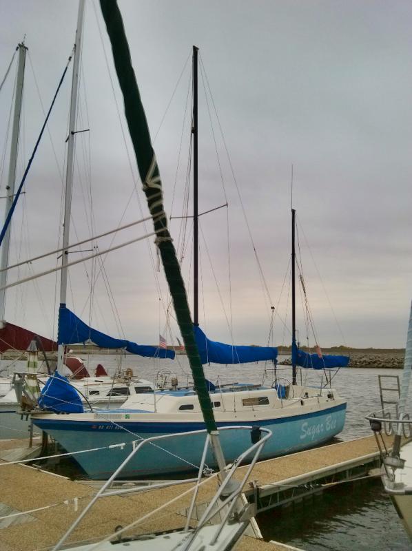

Update:
The season went well, and the 32 aft cabin floats without foam or rum bottles. In fact, bilge stayed dry all season.
The oxidation came off with the application of 400 dollars to the right hands.
She is back on the trailer again for winter storage.

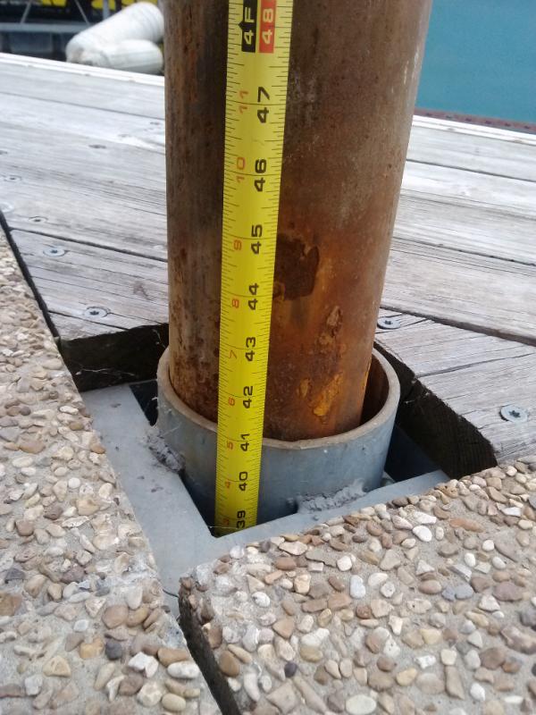

The problem is not water swamping the boat, it is water absent from the lake. When I pulled her this fall, I was an inch from the bottom in my slip.
Hoping for a wet winter.
