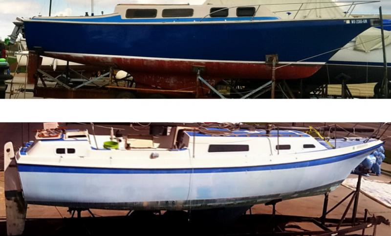

Oct 6, 2011
678
CM 32 USA
Thanks for the upside comments on the CM 32. I will not go out in heavy winds, and I hope to not run her into the rocks, but the idea of a floating boat, always, is not a bad thing. Currently, she only has a manual bilge pump. I plan on changing that real soon to an automatic pump.
The posts in this thread where folks point out their yachts would sink like a stone, swamped, is a wake up call in some ways. The training wheels comment was also a good one.
The bottles stuffed inside the boat was not an original idea, I saw someone post about it years ago, on another forum, and I wondered if it would even do anything. I do not think it would keep a typical sailboat afloat given the stuff we tend to put in our boats.
Blue hull is in the slip, waiting to get pulled and put up for sale and the Aft Cabin is in the diesel shop waiting on an exhaust gasket, to be splashed soon.
The spot of light blue? That may be the original color hiding under the oxidation. Gets wet sanded and polished after the diesel shop.
Back on topic, all thru hulls have been replaced with bronze and all hoses look good, and I will double hose clamp them.
Every time I go out to the marina, I half expect to see the blue hull full of water. She is doing good! When we splashed her, a hose was off, and in no time, she was holding 6" of water on the cabin floor. We found the leak, and pumped her out. I will not be so quick to take the Aft Cabin sailboat off the trailer when we back her in the water. Will look all over inside first, and pull her back out at any sign of a leak.
