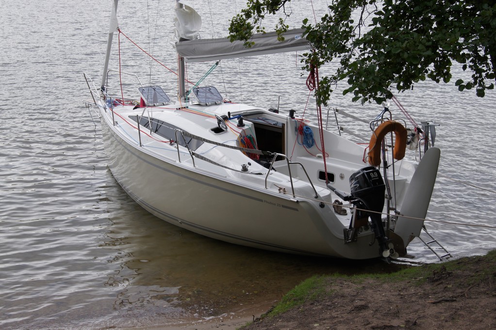

Have you seen the Tes 28? I was quite impressed with it!
Link: http://tes-yacht.ca/Index.html
Nov 8, 2010
11,386
They are interesting boats, too bad they are not in the states. To my eye the 28 is much like a Hunter of the same size, tying way too hard to cram 'big boat' in a small hull. The huge freeboard, limited storage, 4 berths, and a wheel on a perfect tiller size boat would make me pass.

I have seen Magnam 28 at Toronto Boat Show and I did like it. My two negative points (and my only) for this boat are:
- one needs a full-size pick-up to move it around (what I don't have and don't want to buy a pick-up that is impractical my lifestyle). I currently borrow the company truck to move the boat twice a year. This could be solved by purchasing an option with removable ballast - large SUV will then suffice, but barely. Two trips would be required.
- the price, at $115,000 US, while very good for this size of the boat and equipment (version with inboard diesel), is little more than I would like to spend (source: http://www.yachtworld.com/core/listing/pl_boat_detail.jsp?&units=Feet&id=2588664&lang=en&slim=broker&&hosturl=northlakesyachting&&ywo=northlakesyachting& )
Jack - the boat is available in either tiller or wheel steering. High freeboard (although in my eyes the boat is very proportional) relfects what You wrote a page earlier - most (Europeans) will truly weekend on it while most Americans will day sail it. I cannot agree with you more on this, as great majority of members at my marina will just come for a day of sailing on larger boats and head home for the night. We are the only few that actually do stay on the boat for the entire weekend (sometimes longer) and full standing height does make a difference at the end of the day. Boat seems to be available for US customers through North Lakes Yachting (see link above) - the company was recently present at 2013 Chicago Stricly Sail Boat Show.
Nov 8, 2010
11,386
Bos,
Glad to hear it is available with a tiller!
They seem to be willing to try lots of innovative things; and that's cool. New ideas are why people buy new boats.

I spent allot of time looking over that TES at the Toronto boat show.
Very nice boat! (Better put together than the Jeanneau and Beneteau's I was on there!) (With exception to the 30' Beneteau.)
Really well thought out and built like a tank!
