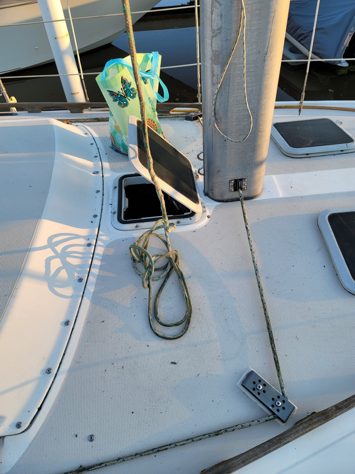

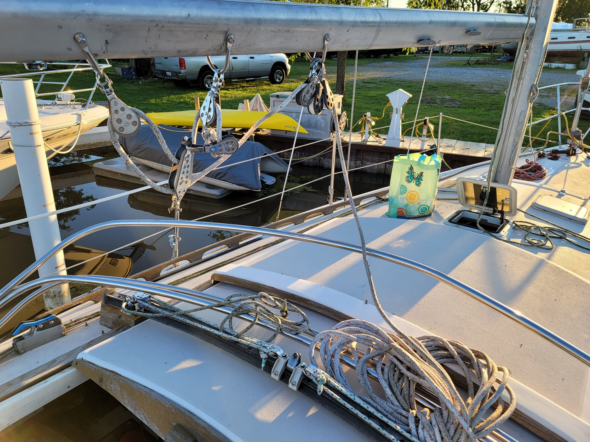

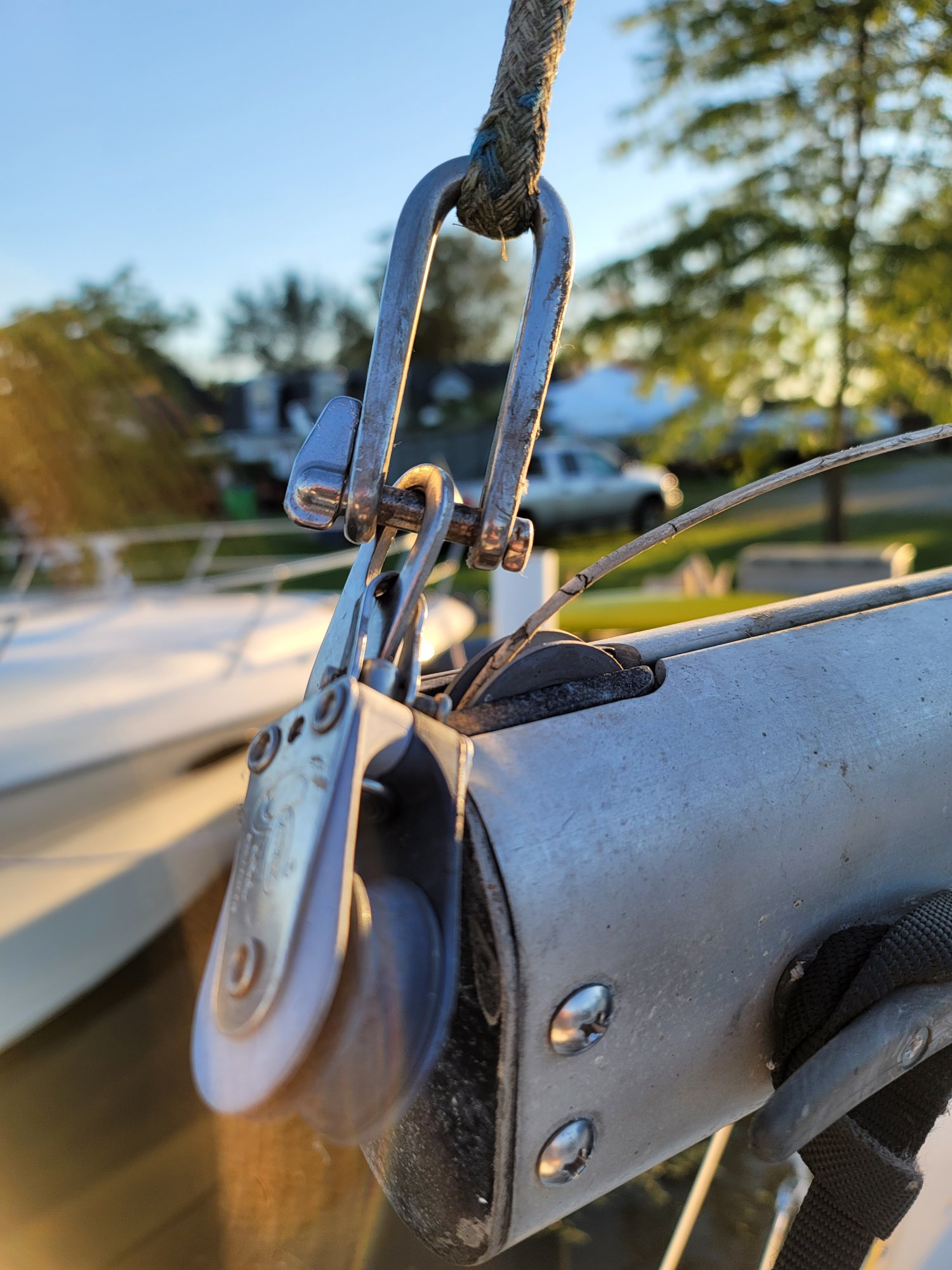

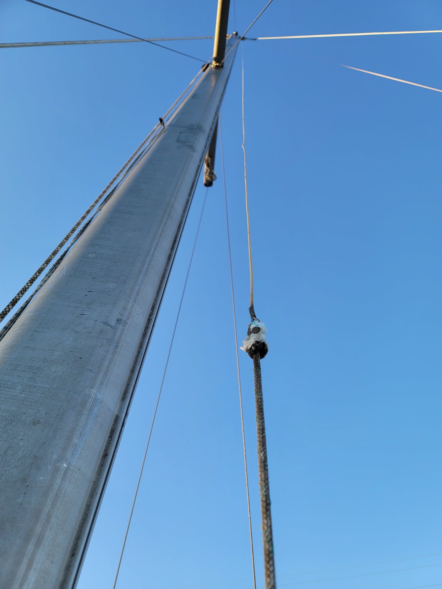

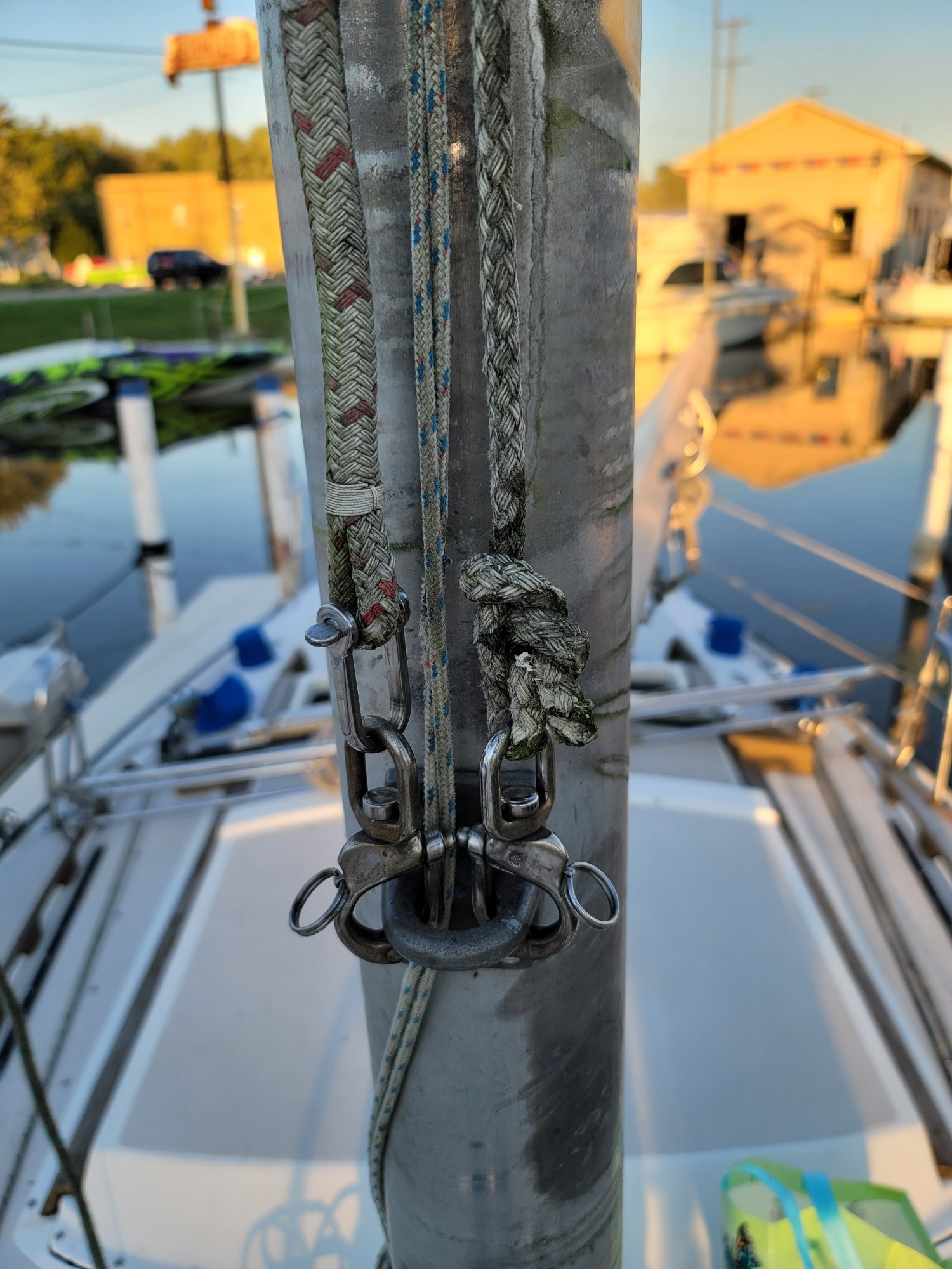

Does anyone know if this picture that shows the combination wire/rope line on the aft side of my mast has a possibility of being anything other than the main halyard? The only other line coming from the aft side of the masthead looks like 3/8" poly and has a shackle with a captive pin that I assumed was used as a topping lift (although I suppose it could work as a main halyard). The front of the masthead has two halyards which I assume were meant for the jib and spinnaker (even though the boat only came with a spinnaker pole, but not a spinnaker sail). My big concern with my running rigging (other than the fact that I need to replace a large portion of it for next season) is that that mystery wire/rope doesn't exit the bottom of the mast. As you can see in the photos the bottom of my mast has two sheves on each side, and one of them on the starboard side has no line exiting it. When I pull on the mystery line, it doesn't move either.
I'm making another long trip back to the boat again this week, and my hope is that I can motor out into the middle of Lake St. Clair and hoist a sail or two for the first time. After this trip the plan when I return in two weeks is to replace window seals and put her on the cradle for winter, so I think this is probably my last chance to actually pull a sail up. It seems like once the foot of the mail is in the boom and all the lugs on the luff are in the track I can have a helper hold the boom end up momentarily and remove the topping lift to use it as a halyard, right? It doesn't seem ideal, but seems like it should work.
Jul 6, 2013
223
Catalina 30TR, Atomic 4 2480 Milwaukee
This site will help you sort out your lines.
Your topping lift (the rope/wire line) should run thru the unused block on the end of the boom, and be tied off to a cleat on the boom. That lets you have a little more control of the boom height.
The main halyard normally comes out on the starboard side, as you have it. At the top, it should run over the sheave and down the aft side of the mast. In you photos, I don’t see a line coming down on the aft side.
The jib halyard runs over its sheave in the opposite direction, down the forward side of the mast.
Just a guess, but the lines may be tangled or off the sheaves at the top of the mast.
Likes: Mooseman
Aug 22, 2021
31
Catalina Yachts 30 Lake Huron
Oh okay, that makes sense! So the 1/8" cable with 5/16" line is certainly the topping lift as you stated above and as shown on the 7th page of the rigging pdf that you provided a link for (marked page 21 in the document). So it's pinned or bolted to the aft side of the masthead and that's why it doesn't move when pulled on, it's clearly not supposed to. I get it now. Thanks!!!

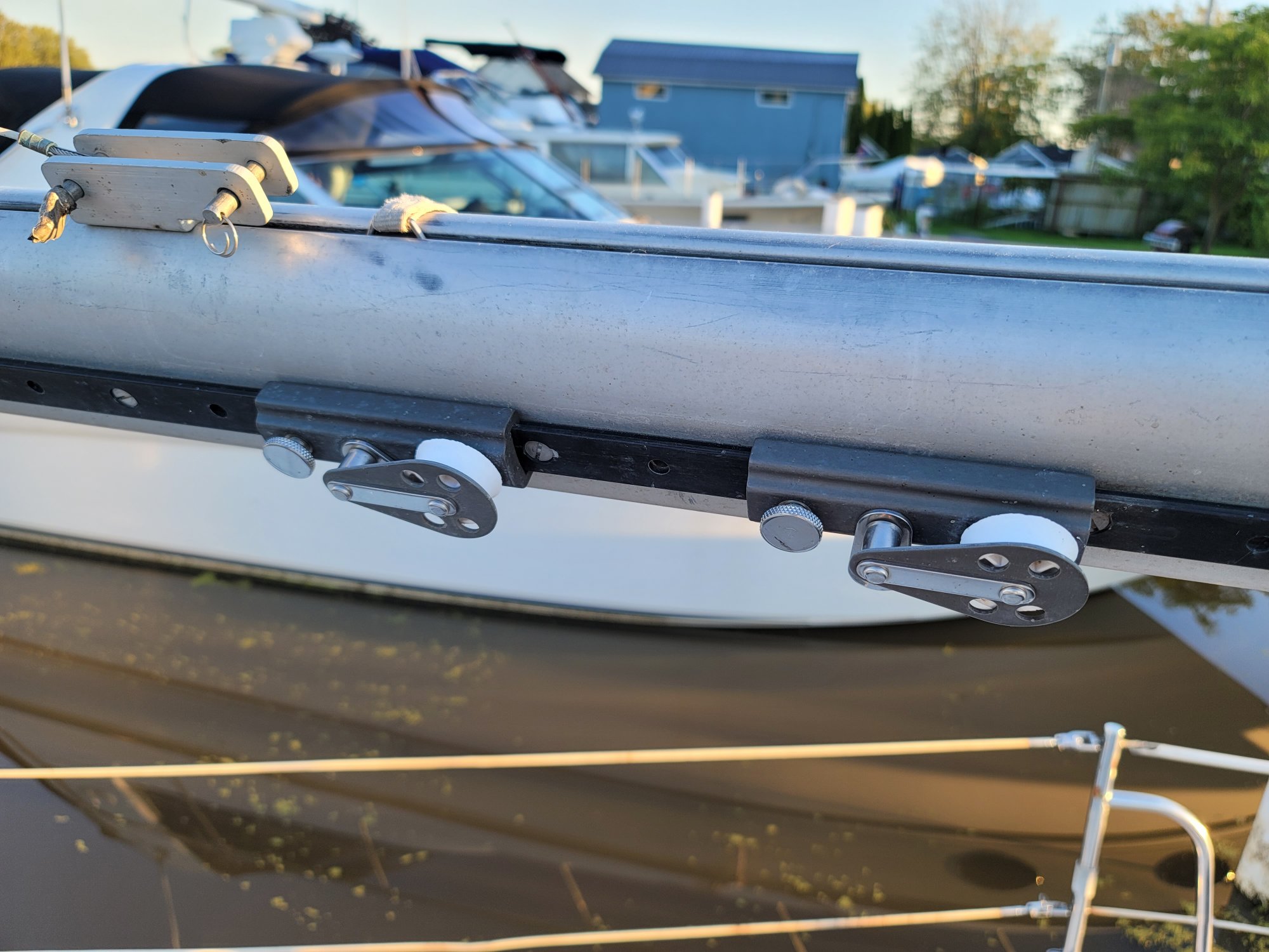

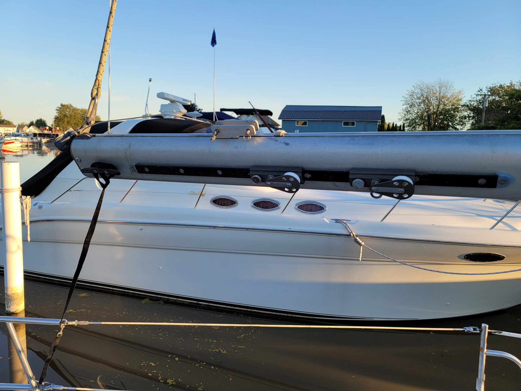

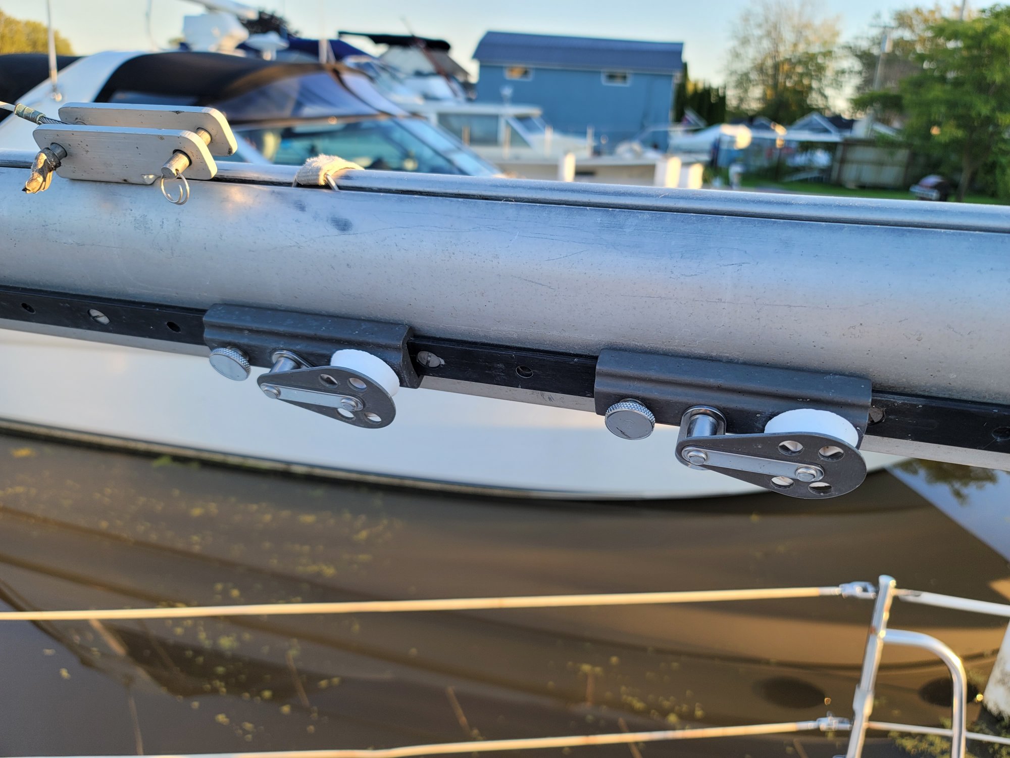

Thanks for the info on the topping lift Jim! Would you know what function the rail with those two cars/blocks on the starboard side of the boom are for? I'm such a complete noob, and in watching a million hours of YouTube videos it's so rare to see an identical rigging setup to study.
Aug 22, 2021
31
I think I just figured it out! Probably for reefing lines, right?
24,774
Yes :plus:

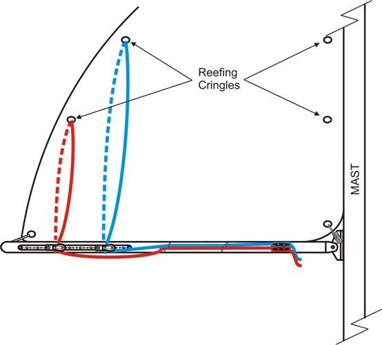

Reefing turning blocks. The lines drop down from the reef cringle in the leach of the main sail. With 2 turning blocks you would expect 2 reef cringles on the mainsail leach.
The turning blocks serve to turn the lines so that they run forward to the mast along the boom. Then either terminate on the boom at the mast or through another two blocks, run down the mast to the base through two blocks and back to the cockpit.
Here is an image of the lines terminating on the boom at the mast.
Note the dotted line. That is the reef line running down the other side of the sail and it is tied off on the boom.
Sailing in Lake Michigan you may need a reef or two “when the winds of November come early”.
