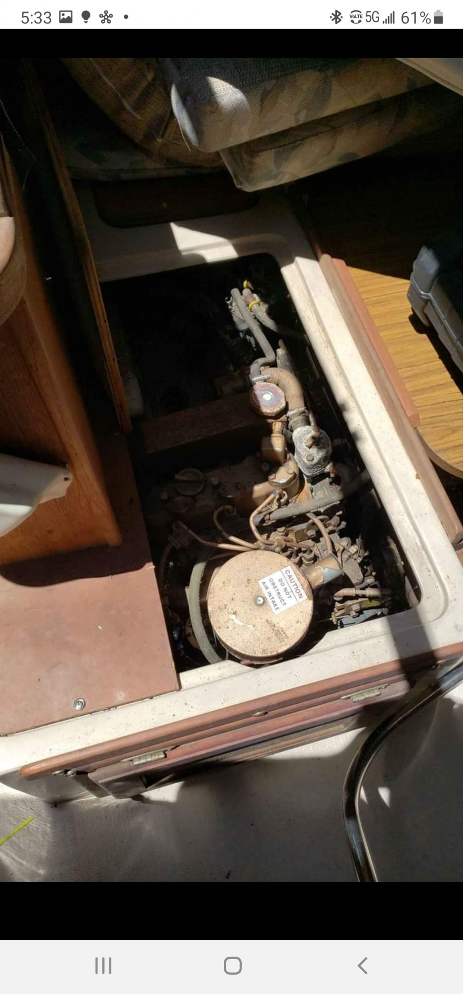

Thanks! I'm hoping it's the M25, since I think the extra HP will be helpful when battling river currents. This is the only photo of the engine I have at the moment, can anything be discerned from it?

Robert, that photo doesn't help, too dark to tell. Please do not crack any injectors on a Universal engine. Until you know what engine you actually do have. It may not never ever be necessary. Don't break it to try to fix it. Please.
Also no need to drain the fuel. Change the primary filter. But wait on the secondary until you learn more and know what you are doing.
You have a lot of research and homework to do, so take some time and read up first.
I put off getting an inboard engine for years. When we got this boat, I spent the first month reading! :)

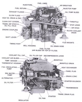

I found this parts list for M25 M25XP engines. It might help to identify the differences or more important for you, what parts are the same on the engines.
@Mooseman,
Ward's reference material is very good. However, the "short story" is simply this: the differences between an M25 and an M25XP are:
--- XP has two more HP with slightly different bores & strokes, essentially immaterial
--- XP has a 3 inch HX, the M25 had a 2 inch HX; many of us with M25s simply installed 3 inch HXs, a simple task
--- XP has the improved alternator bracket, a NECESSARY upgrade, which is discussed in the C34 tech wiki Engine link I provided. It is essential to do this. Mandatory for the M25 if you want your engine to NOT BE IRRETRIEVABLY BROKEN when the old alternator mount disintegrates.
