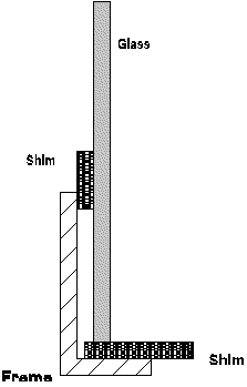

These threads might help. The first one is on a 1984 Hunter 34.

IF your 34 has the aluminum port frames, a butyl/795 fix as Rich Breyer posted is what ya need.. If your 34 has the crappy, brittle, undersized plastic frames (like mine has) then a fix like Allan Hadad suggests is a fine one.. You can do the ports separately, as original, or together as Allan did..
