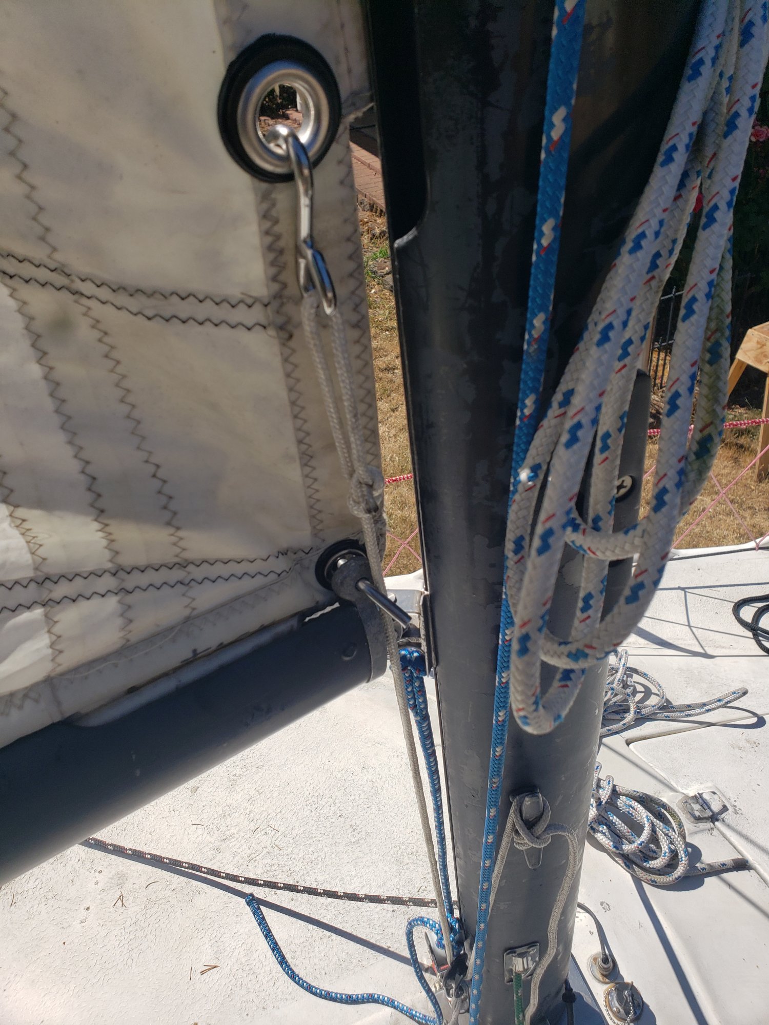

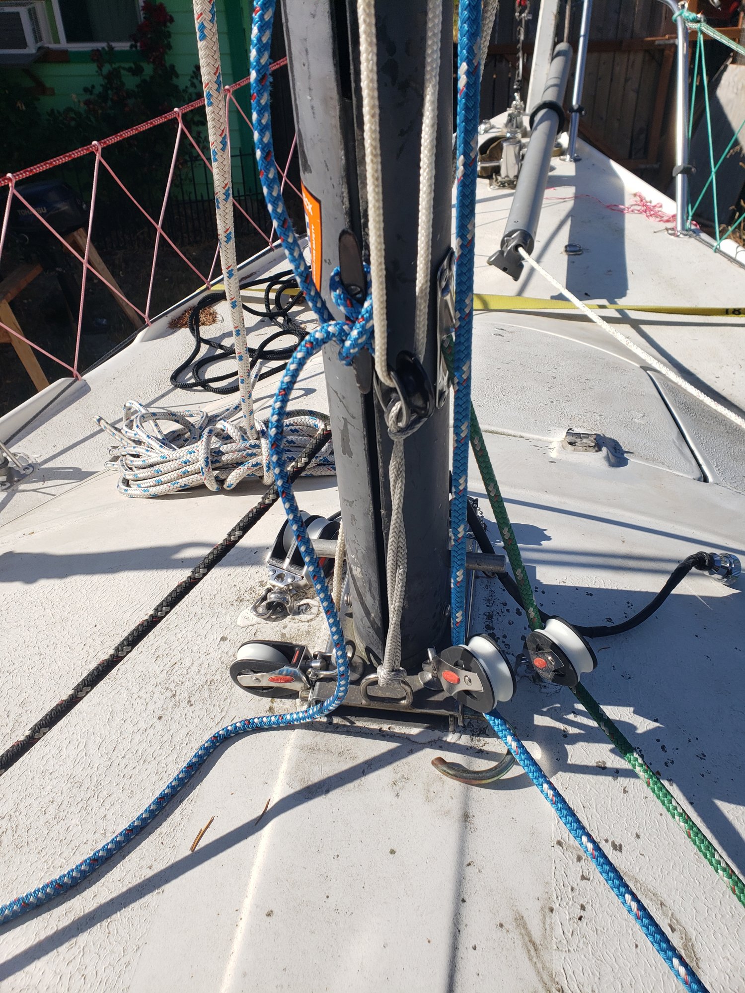

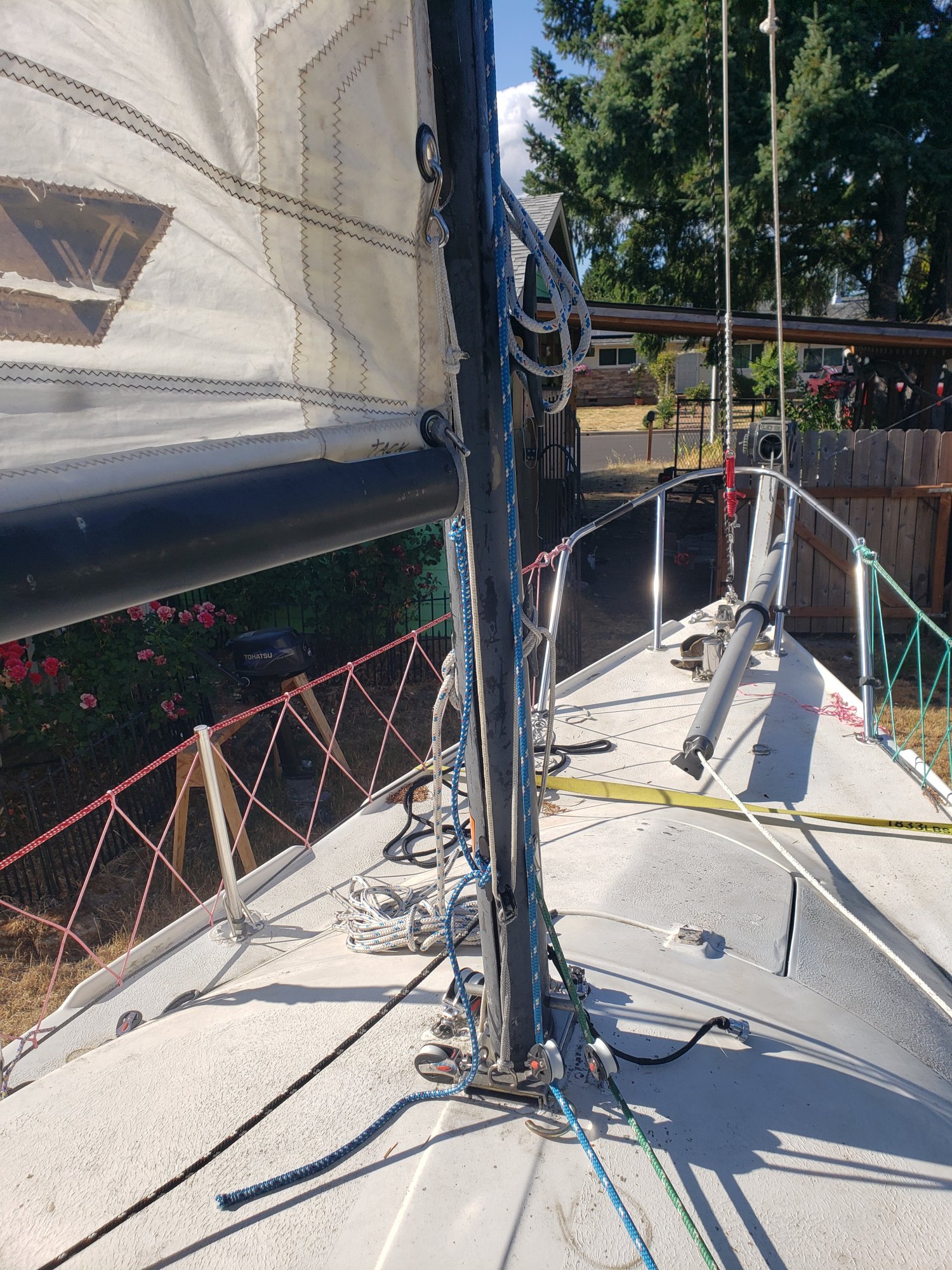

Lets go back to the :Short Sail", problem.
As you can see from the pictures I got the cunningham hook and attached a frictionless ring to pull tension.
I did a test run on short sail adjustments and fund that I will also need to add a plug below the gooseneck, because when I drop the sail to move the hook to the first reef point the gooseneck falls to the bottom of the mast.

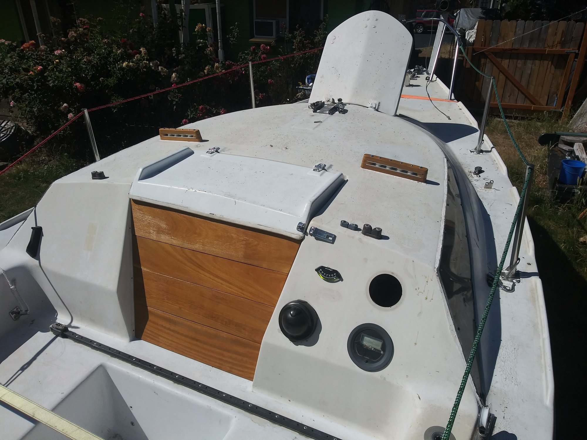

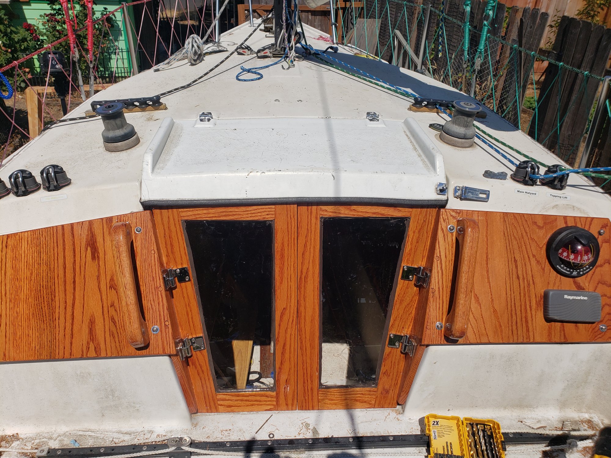

Along with the improvements to the "short sailing" you helped me with, I made some changes to the hatchway on my boat.

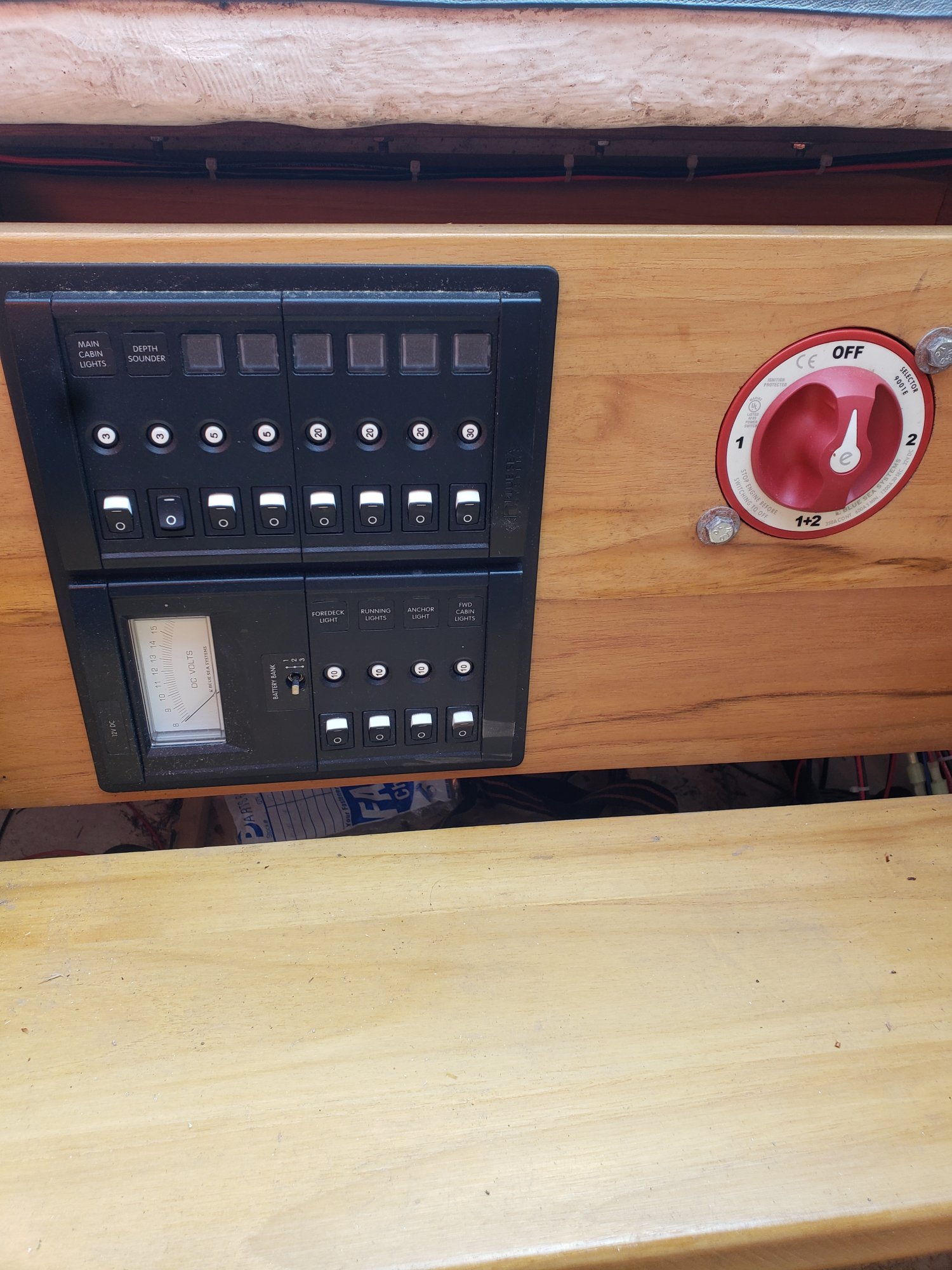

What I would like to talk about today is "battery maintenance". Last year I rewired the boat, including the wiring in the mast. I have only the typical lighting for a 21' sailboat. Nav lights on deck and mast. Below deck I only installed two small reading lights in the "V" birth. I never did end up using any of the light except to test them a couple times, as I never took the boat out at night. When I took the boat out of the water this year to make some improvements I found the battery was dead, and my charger said it was "Bad".
Is it ok to put a battery maintainer on the system and leave the battery installed, or do I need to disconnect the battery to charge it. I have shore power available so I can plug it in. I do not have any faith in Solar, but I would listen to someone with real life experience.
May 17, 2004
5,676
The battery being “bad” could mean a few different things, anywhere from being discharged and just needing a recharge to being internally damaged and unusable.
Some questions to help narrow that down- What kind of battery is it? What kind of maintainer/charger is available on the boat? I presume the battery was just sitting connected to the DC circuits but not actively powering anything? What does the battery read for voltage with a multimeter?
Nov 30, 2021
16
American Fiberglass 21 St. Helens
When I took it to "Interstate battery", and pick up a new one I asked that they test it. there meter read 3 volt. They are going to put it through a deep cycle charge and will get back to me on if the battery is any good or not.
I am more interested in information on keeping the battery charged on my boat.
May 17, 2004
5,676
If the battery’s been sitting at 3V or anywhere near that for any length of time it’s likely beyond redemption.
If you have access to shore power a 3 stage marine battery charger is the way to go for that. A maintainer / trickle charger won’t have the output to bring a discharged battery back up to full quickly enough to prevent it from sulfating. And a 2 stage typical car charger won’t keep the battery floating at the right voltage over time

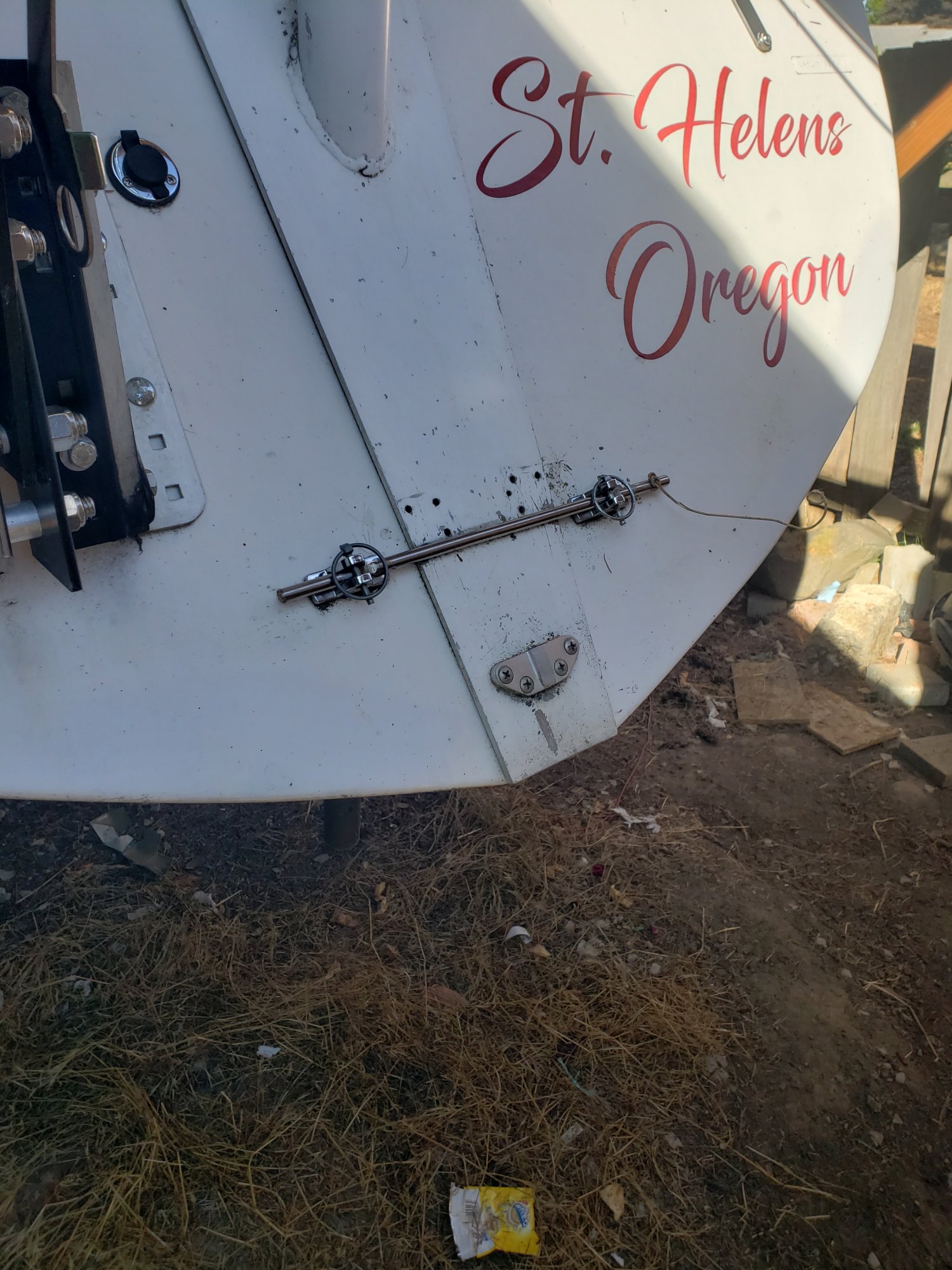

Hi Guys
New question

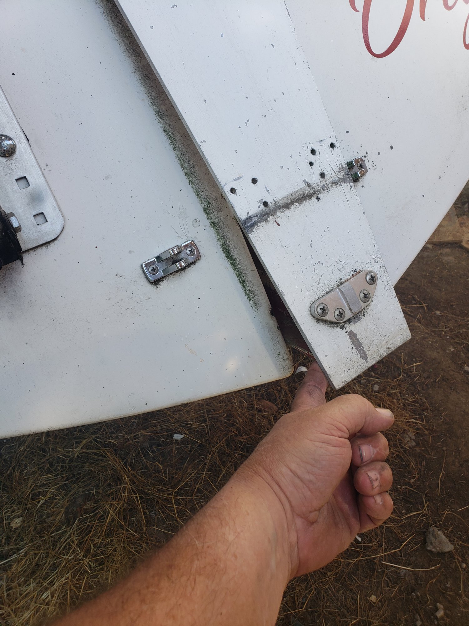

On the stern where the rudder mounts on the boat there is a stainless steel rod that prevents the rudder from swinging out. It is easier to launch the boat when i remove the rod so i can swing the rudder up and out of the way. It's my understanding that the rudder needs to swing if it is hit by something when underway. Is that correct?
If the rod is not suppose to be in place underway then what is it for?
10,442
-na -NA Anywhere USA
@Perry Welch
I am having a difficult time what you have. Can you remove that rudder and take a full picture of it. Also, take a picture of the transom with emphasis where the rudder would hang.
I have never seen a rod like that on the back of any sailboat in the years of sailing nor as a dealer who also helped design sailboats. I do see a lot of holes where hardware was attached
