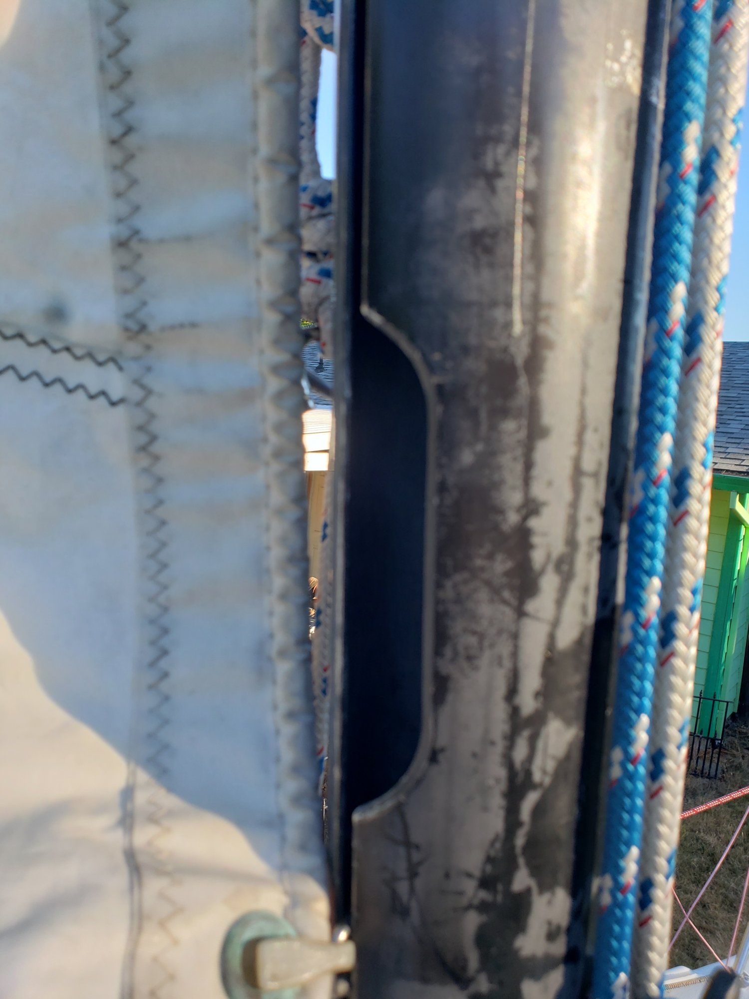

Remember, I do not know the proper names for most items, so please understand. The notch seen in the third pic, i know is of course used to put the boom, and sail on the mast. When you need to lower the sail, how do you prevent the plugs from falling out of the grove.

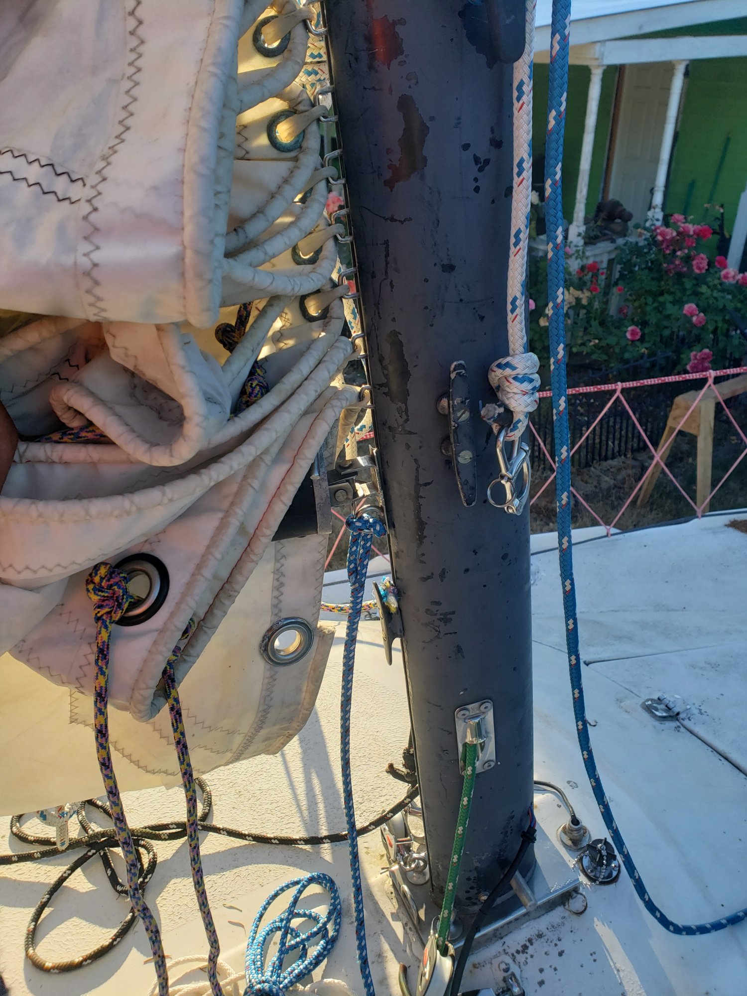

When the sail is up and you are "sailing", is the glide at the end of the boom suppose to be secured to the cleat near the bottom of the mast, or do you let the boom vang, keep the boom in place? The main sail has the gromets for two positions of "short sail". I have a plan on how I will set up the needed rigging at the aft end of the boom, but what do I do at the mast end to secure the gromet?

"The notch seen in the third pic, i know is of course used to put the boom, and sail on the mast. When you need to lower the sail, how do you prevent the plugs from falling out of the grove?"
For a trailersailer, like the 21 America, the designers expect the sails are most often removed when lowered, but you can buy a track throat plug that will fully capture the sail slugs that ride in it.
"When the sail is up and you are "sailing", is the glide at the end of the boom suppose to be secured to the cleat near the bottom of the mast, or do you let the boom vang, keep the boom in place?"
There is a piece of tackle called a Cunningham that can be used to pull down on the gooseneck (the glide/swivel at the forward end of the boom). The purpose is to allow tensioning the sail's luff for fine tuning. A vang is for more control over the over all flattening of the the sail, but the sheet is the primary control that also keeps the gooseneck from lifting. I don't know how the 21 America is rigged, but some boats position the boom below the track throat while a few hoist it above the throat. There is a whole book's worth of knowledge just in how to use these trim controls: vang, sheet, traveler, Cunningham, down haul, halyard, and out haul. Even the way the sail battens are tied in and the topping lift can contribute to special needs in sail trim. Not all sailboats have all of these pieces of equipment. The sheet, down haul, and out haul, are on almost all sailboats.
"The main sail has the gromets for two positions of "short sail". I have a plan on how I will set up the needed rigging at the aft end of the boom, but what do I do at the mast end to secure the gromet?"
These are your reefing points. There may be a reef hook to use on the forward gromets.

The device you are looking for is Sail Track Stop. They come in different shapes, so you need to know the shape of the mast track.

While you are looking for a track throat plug, you can jury-rig a sail track stop with a bolt, a flat washer, and a wing nut, preferably SS. Chose a bolt with a shaft just small enough that the bolt can be slid up into the slug slot with the bolt head inside the slug slot. Add the washer and wing nut and tighten. This should suffice. They do sell these with a nice knurled knob, but after dropping a few overboard, I just go with the cheap option.
As for reefing, there will be two large grommets at the aft end of the sail (clew) and the mast end (tack) in line with the smaller grommets in between. Starting with the sail down or partially hoisted, secure the tack end where the boom meets the mast. I don't see a hook in your picture, so you can use the blue rope attached to the underside of the gooseneck (part that connects the boom to the mast) if it is not being used for anything else. Next, tie a rope to the clew and then tie it tightly to a pulley or cleat at the aft end of the boom. This will be your "outhaul", and should be as tight as you can make it. For the grommets in between, use some short sections of line to pass through each one, then around the bottom (foot) of the sail or the boom. These should NOT be tied tightly. They are just to keep the sail neat and out of the way. As for the outhaul, I got fancy with mine and put a 3:1 block and tackle arrangement inside the boom to make it easily adjustable.
The end of the boom should be secured somehow, but I don't see a mechanism for that in your picture, so securing the rope at the underside of the gooseneck to the cleat below it should work. The cleat on the starboard side of the mast might work for the cunningham, but might be too high.

Because of the position of the track throat the gooseneck must be below the track throat. So if I put one of the track stops at the top of the throat it will prevent the plugs securing the sail to the mast from falling out when I lower it. Thanks.
I can get a Cunningham hook from "West Marine". For now I secure the gooseneck to the cleat at the base of the mast with the blue line in the picture, so I will have to add another cleat, or find another way to attach the Cunningham. The cleat on the side is used for the Jib halyard.
About the gooseneck. I would like it to slide better. Can I replace it, or is there something I can lube it with?

Curious as to why you would want the gooseneck to slide (except maybe in the course of rigging). On boats I have owned, the gooseneck attaches to a stationary bracket on the mast.
If you want to replace it, you might try determining who provided the hardware for that boat. See if you can find a name stamped on the mast or boom, or failing that, any of the hardware on the boat.
Not sure if it applies to this boat, some boats have a sliding gooseneck instead of a Cunningham. To tension the luff, on pushes down on the gooseneck and secure it or there may be a line that goes through a block at the base of the mast.

The Cunningham is a mod. It usually is not necessary, depending on your sheeting, etc. On a small boat with end-boom sheeting, it is nearly a must, but with mid-boom sheeting, a Cunningham is a addition installed for high performance sail trim.

My main sail is outfitted with two reef points, plus a gromet near the tack to make more trim adjustments of the luff. I am learning, but as an inexperienced sailor I would like to setup my boat so I can take it out in some stronger winds. For now I have limited my sailing for days the winds are 10mph or less. If I can shorten my sails and go out in stronger winds I will get more practice/experience. Without the rigging I need to trim I won't learn anything sitting on the dock..
From a previous post:

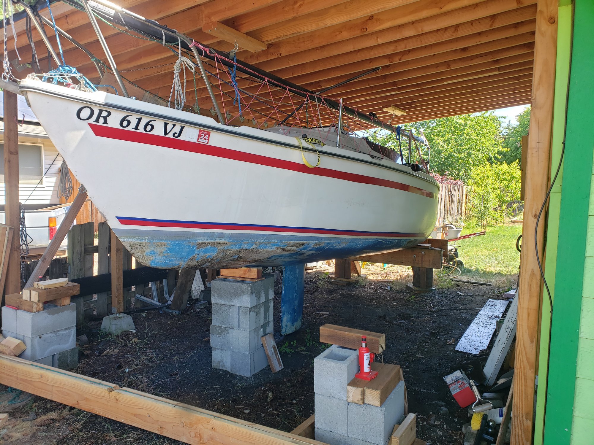

OK guys, I am working on all the information you gave me about rigging the mail sail.
Now lets talk "Center board".
When I had it on the stands I was hoping to get that answer to some questions about how it is setup, and how far I should lower it when sailing.
Because of the overhead limitations, and a few other obstacles, I was not able to lift the boat high enough to see if the center board had some mechanism that would prevent it from falling out the bottom if I lowered it to far. I was able to get a measurement on it. I believe it is something like 38" long.
So what useful information do you have to pass my way?

The CB is simple. It is your lateral resistance that makes the sail actually work when sailing in any direction that isn't dead down wind (DDW). There are nuances to adjusting the depth for the purposes of reducing drag when sailing DDW, and for changing your center of lateral resistance (CLR), don't worry about that right away.
There are usually mechanisms in place, length of CB pendant, designed stop, crashing into the front of the CB trunk, that keeps the board from dropping too far. It is likely held in with a pin, so it won't just fall out.

I can say with confidence that your centerboard (technically a swing keel) will not fall out from lowering it too far. These are usually held in place by a long bolt and raised and lowered using a hoist of some kind.
As for position, try it all the way down at first. If you are experiencing excessing weather helm, try raising it slightly and see if that helps.

If you would bother to look at the picture, you will see that the center board is a Dagger, NOT a swing. The only pin in it is the one on top of the Dagger that connects the cable that raises and lowers it.
