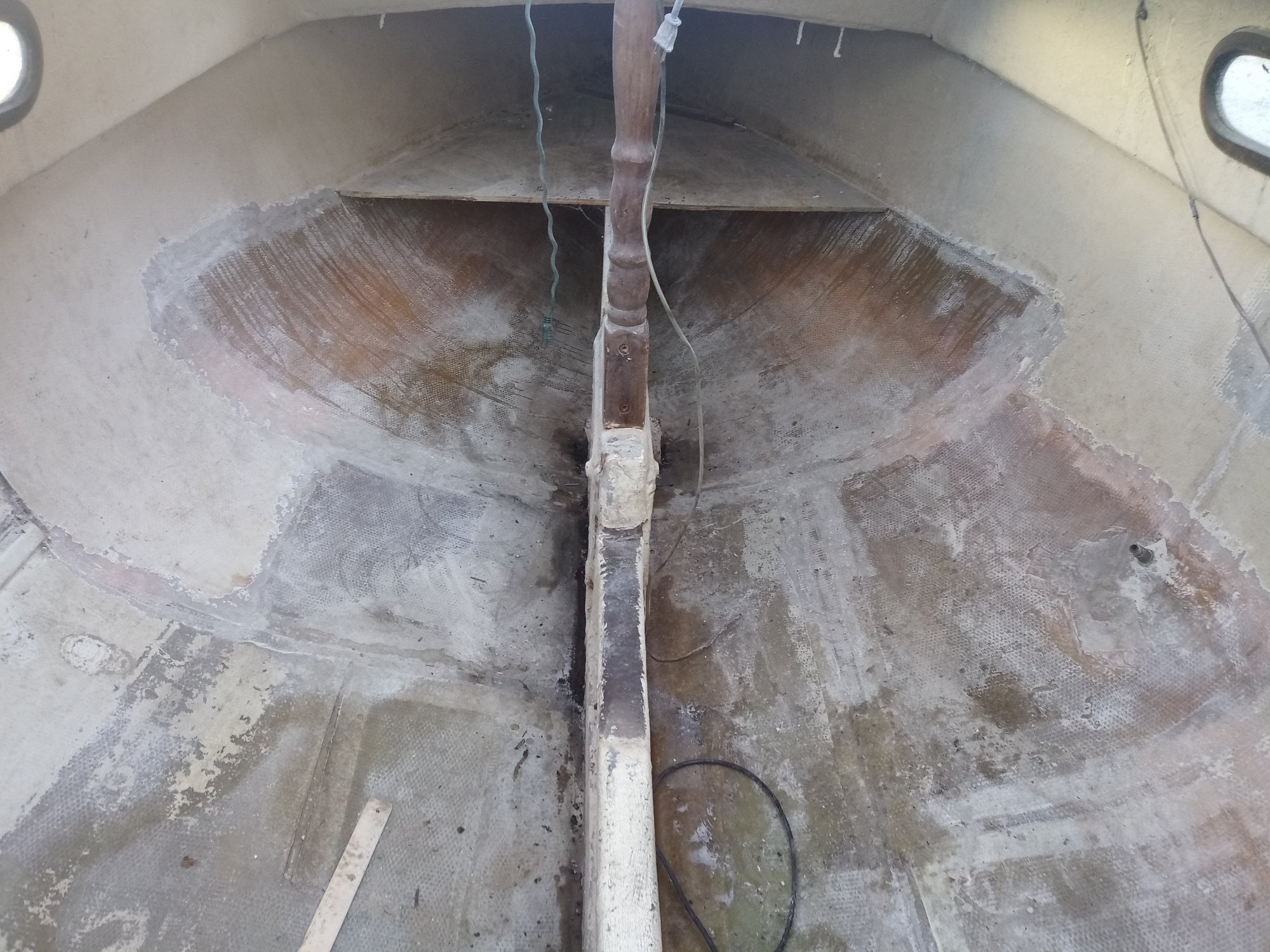

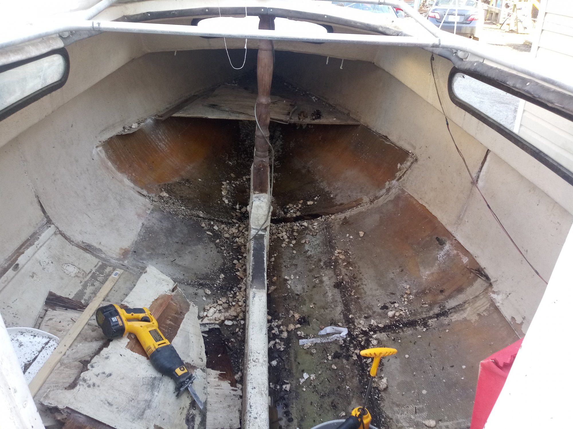

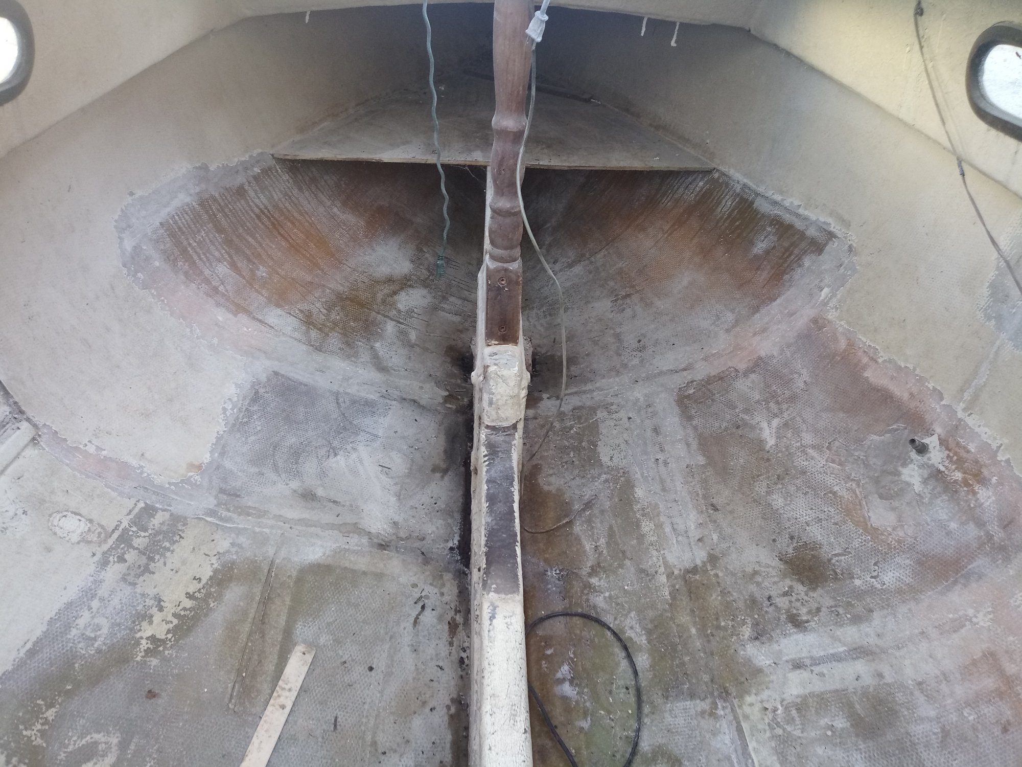

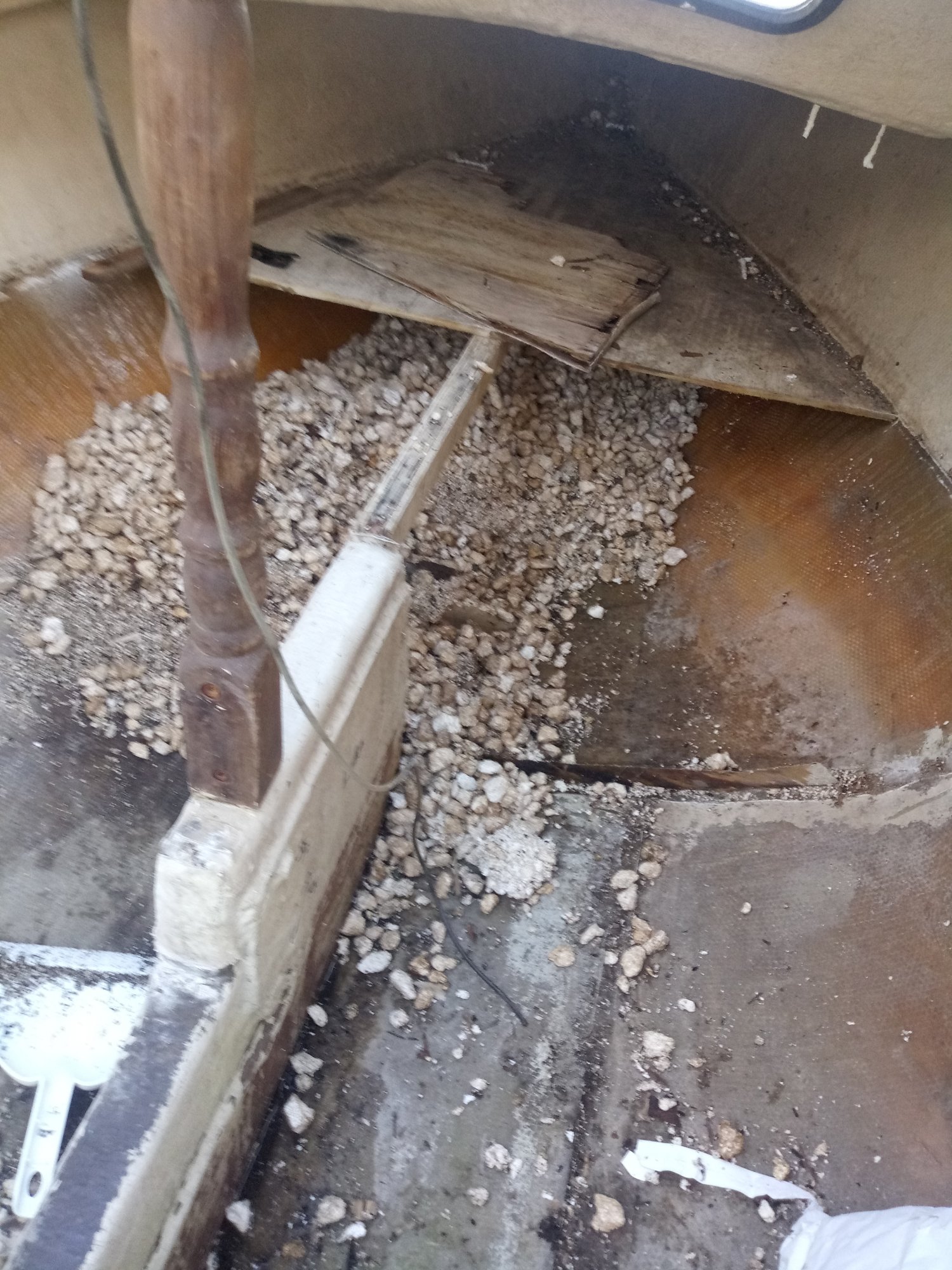

Here is the inside of my south coast 22... I had already cut out the plywood galley on the starboard side. I was planning on replacing the knee for the starboard chain plate and the port side bulkhead, also where the chain plate mounts. An hour later it was all gone..... by my rough math,
3 sheets of plywood should put it back together, with a slight redesign, as I never intend to use it for more than storage. This is a trial run for practice fitting installing bulkheads and interior bits on a great project down the road. Please stay tuned for progress updates.

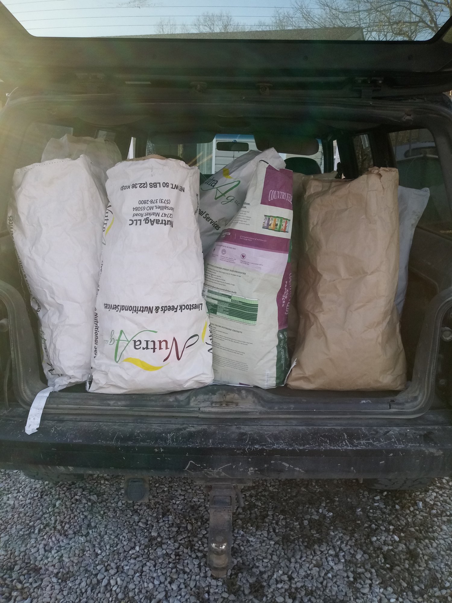

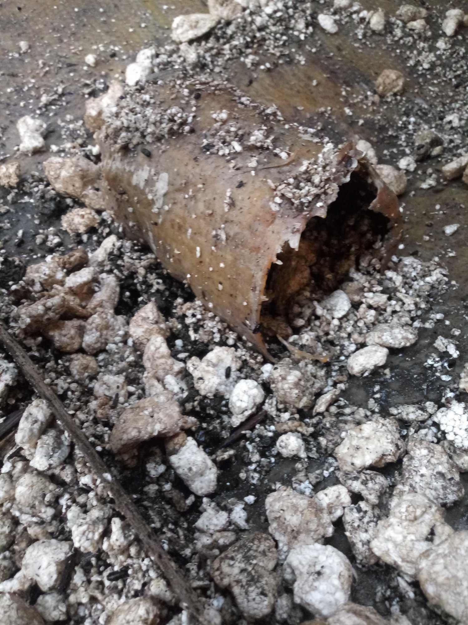

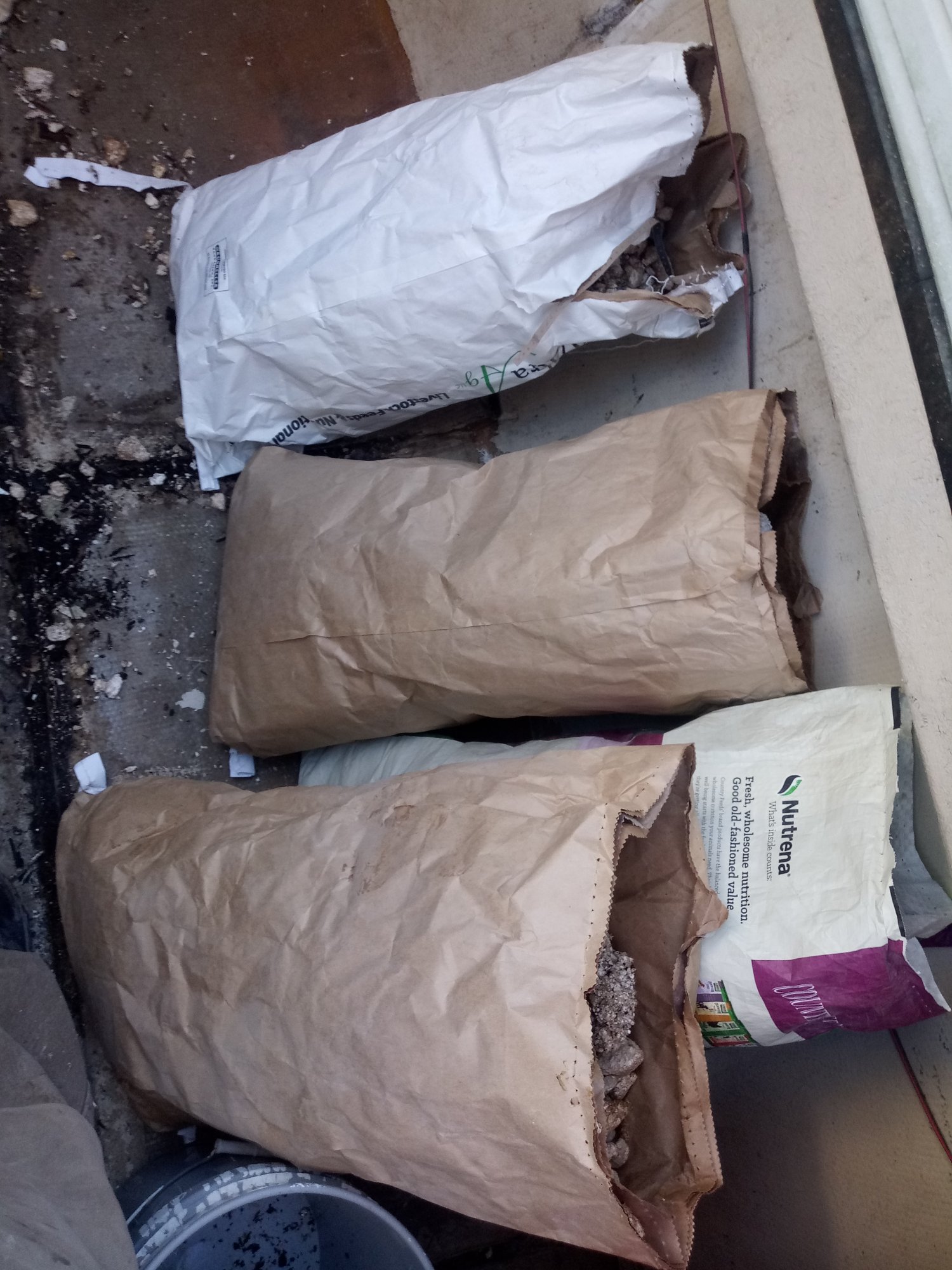

I am not sure what the fiberglass tube in the bottom of the hull is, perhaps for moving it at the factory? There were 2 dead critters in the flotation. That makes 4 total dead critters so far.... A grand total of 9 feed sacks full of rotten foam.

That tube might be a stringer. Stiffens a flat section of the hull so it won’t flex under load.

not long at all. I would say less than 3 hours to this point. a cordless sawzall and and oscillating multi tool make quick work of it. A 36 grit flap disc eats the old tabbing pretty fast after that. Digging out the foam took the longest. I am curious as to how it will handle with out 150lbs of water logged rotten foam in the bow.

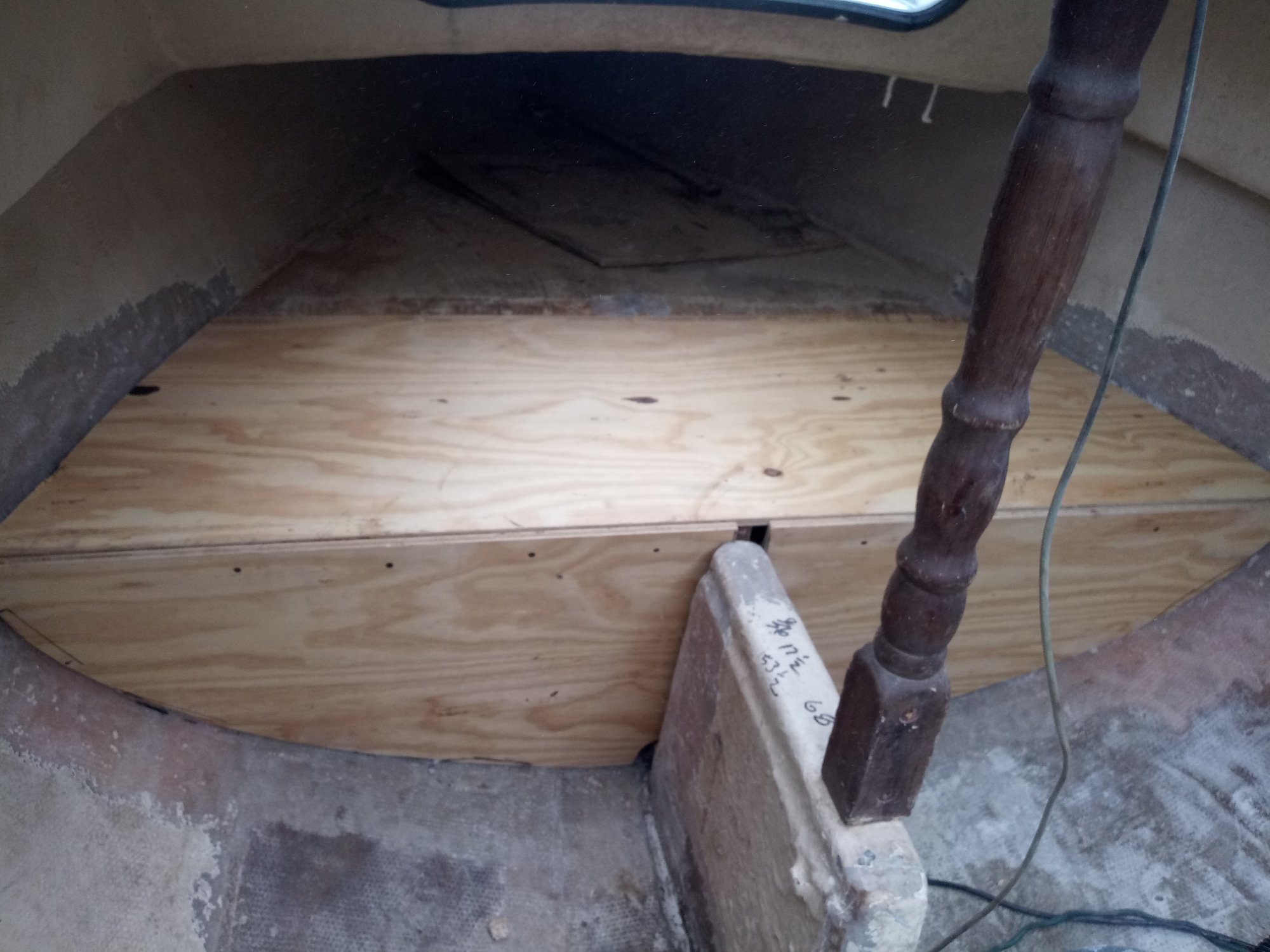

When you go to fit your plywood back in, look into a technique called spiling. It is for fitting planks and plywood into odd shaped spaces.
That was my plan for the stringers were there is less curvature. The bulkheads themselves I will make a rough template of the curve with paint sticks and hot glue, cut slightly over sized and grind to fit.

I like to use old cardboard boxes to make templets. Easy to cut and shape then off to recycle so clean up is easy too.

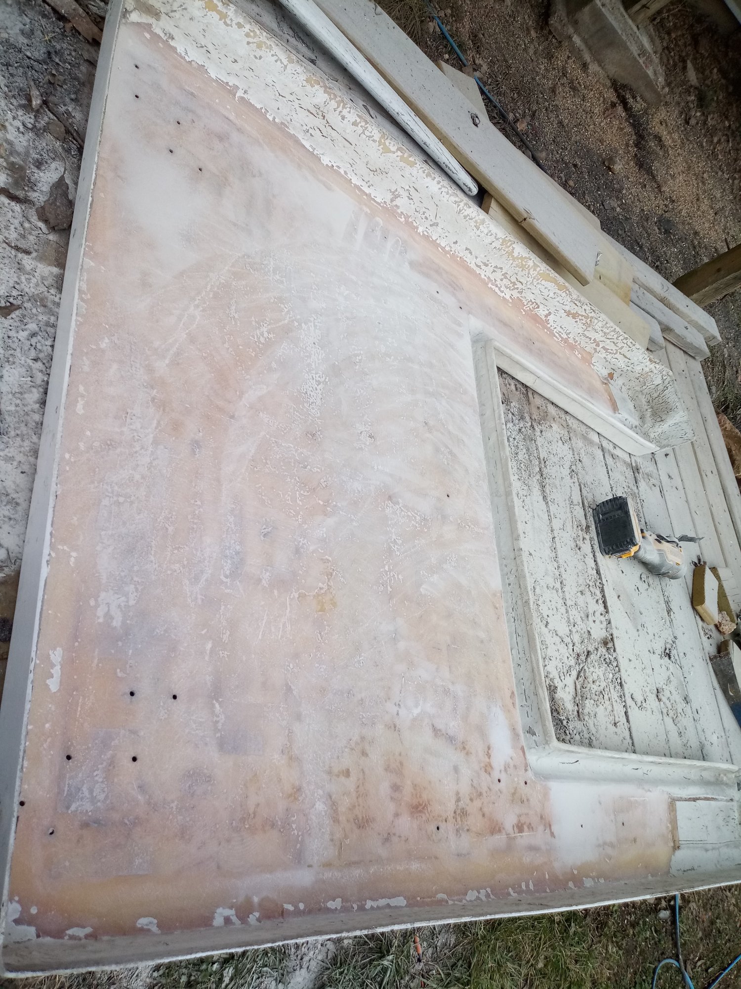

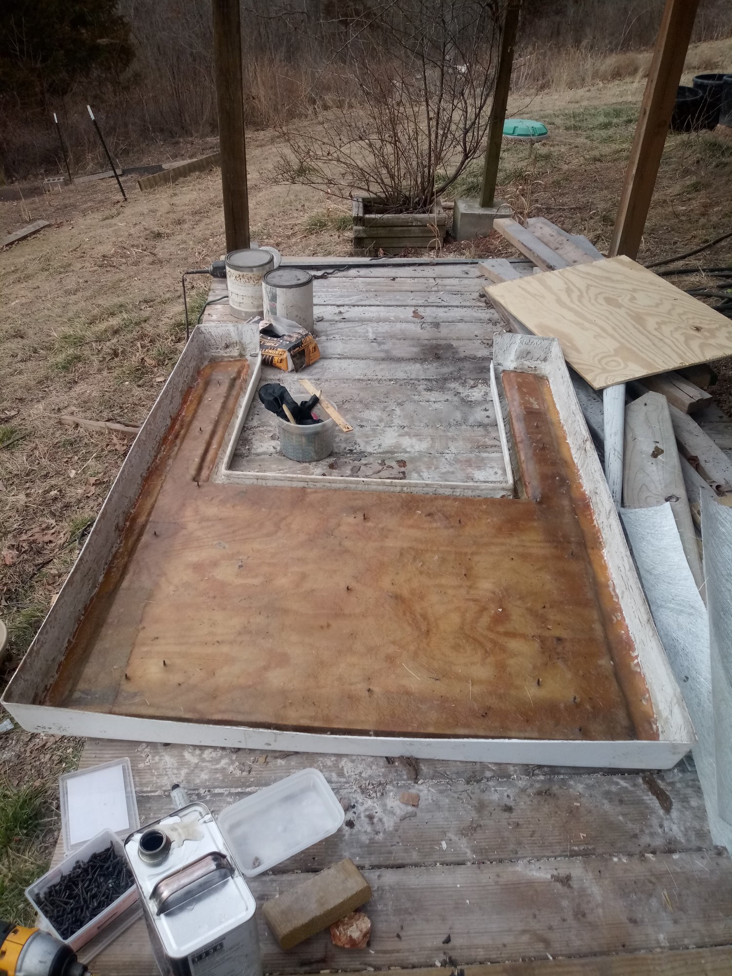

hopefully I get some of interior bits cut and fitted tomorrow. I picked up the plywood and 2 gallons of resin today.

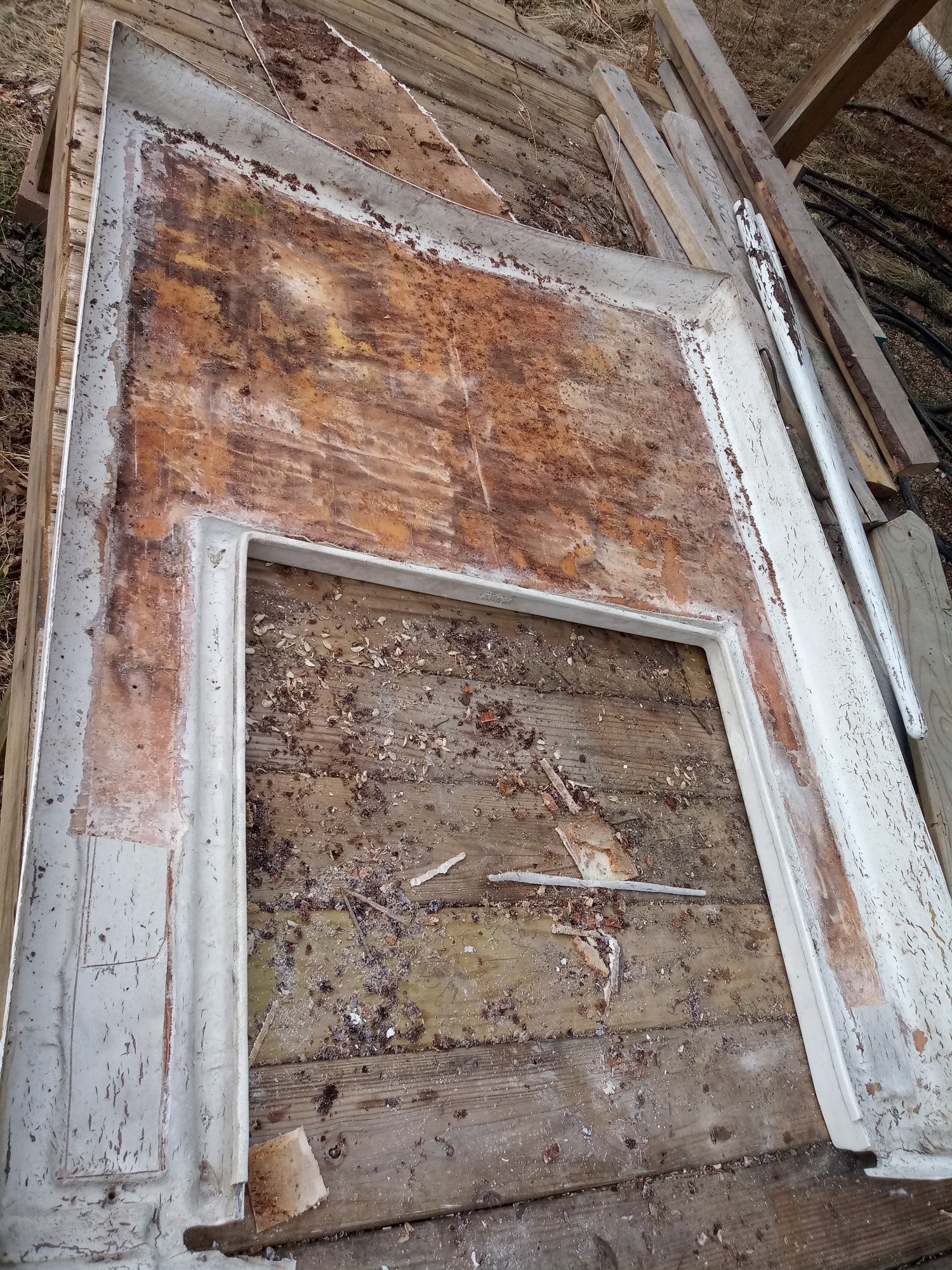

This pop top left me with over half a sheet of 3/8. It may become the side decks or core for the foredeck.

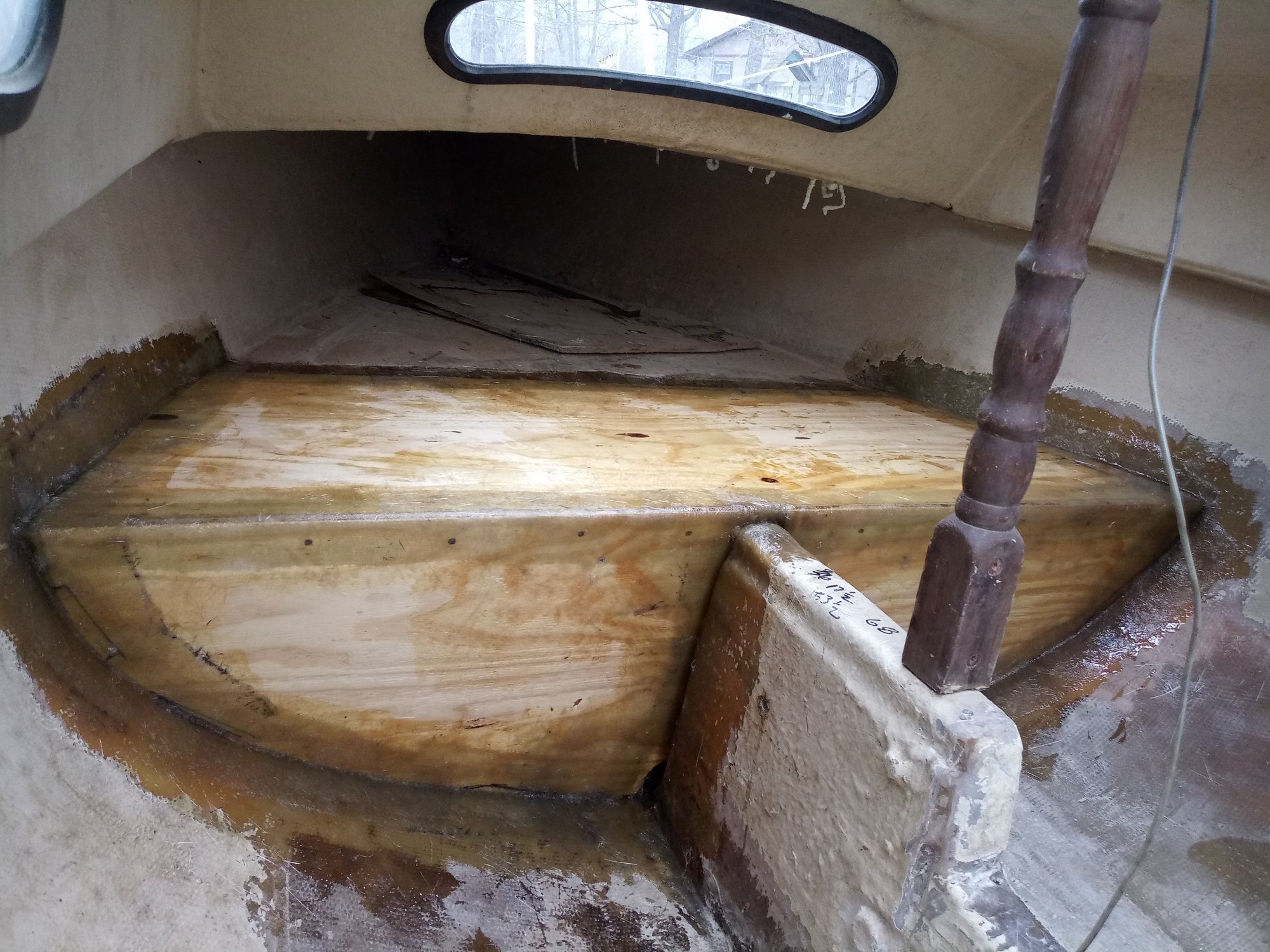

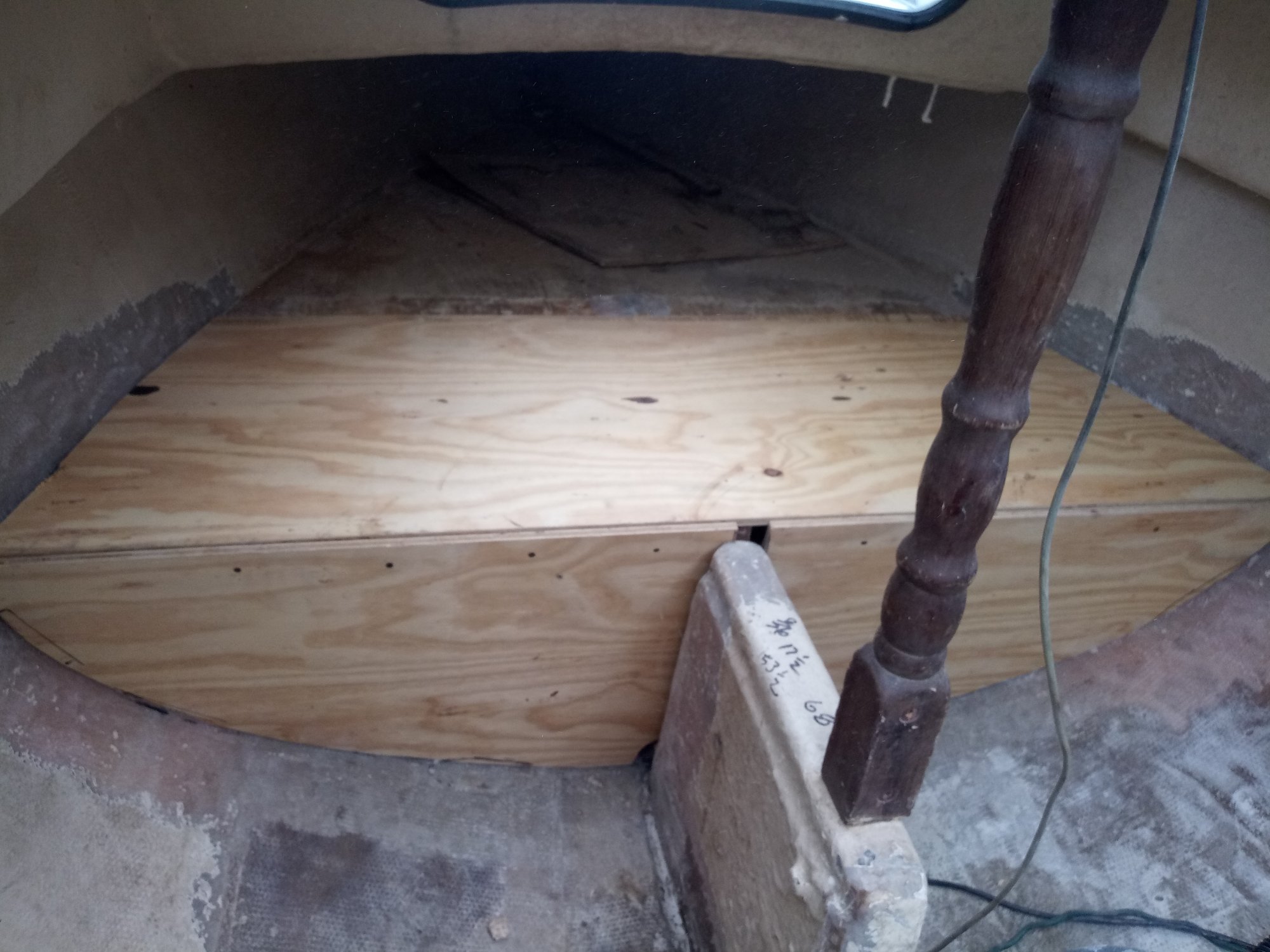

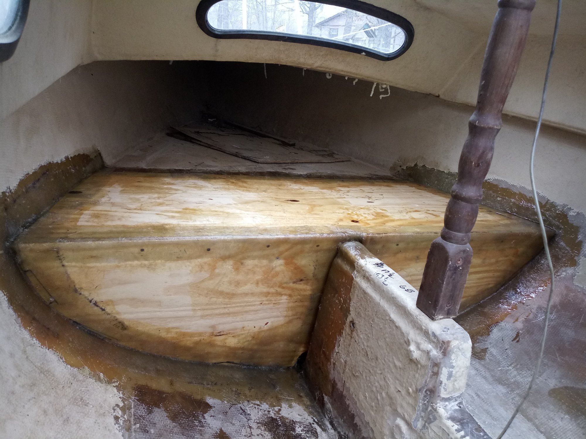

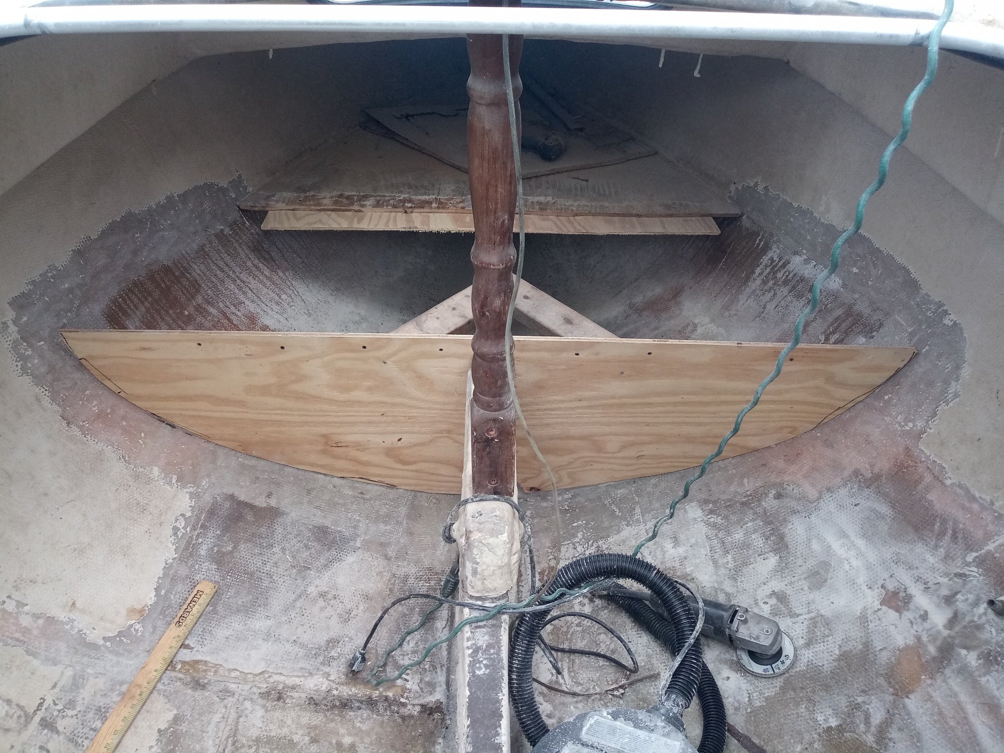

Front v berth area all fitted and glassed back in. I tabbed the bulkhead on both sides. 2 layers inside and out. 3 layers tie in the keel trunk. 1 layer on the seam, 2 down the sides.
So far I have used almost an entire piece of 1/2" plywood. Half a sheet of 3/8 plywood. 2 gallons of resin. I don't count the mat as I have a huge roll I've been using for years. Hopefully the main bulkheads go in tomorrow and I can start figuring out stringers.
Minus the engine, title and registration, I have right at $300 in it so far.
