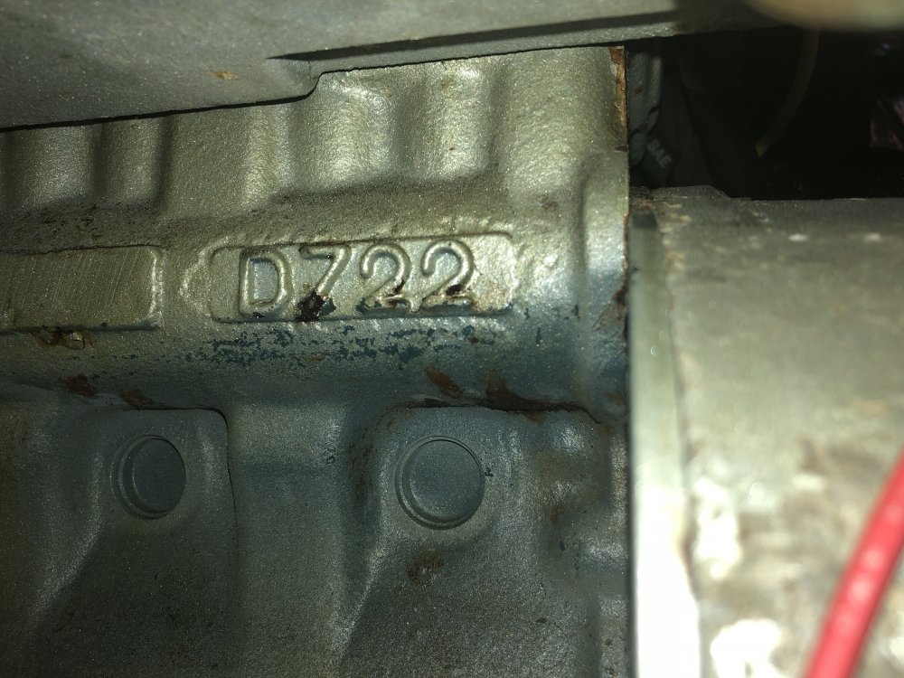

Guess it’s a Kubota d722, still can’t find ID number, almost took off valve cover to see if I could scrape paint off, maybe tomorrow

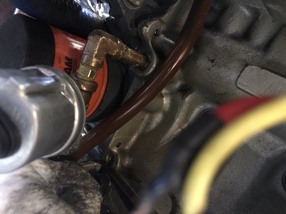

Here is the oil pressure sending unit. It is still cobbled together, with old buggered threaded nipple and not what I would like. I have some new parts to try and make it shorter and in better shape. I cannot get a pipe wrench in there, so I only have a small vise grips (YIKES I know). I thought about a short extension, a 90 deg elbow and then sending unit. Im not going to do it until starter is in because that banging around was what bunged it up in the first place.
I am open to any suggestions, as you can see the sending unit will not be able to be screwed directly into case due to proximity of oil filter and that little threaded dog ear (which I do not know what goes there). I thought maybe if I did the 1 1/4 threaded pipe, 90 deg elbow and then sending unit it would reduce the weight and allow it to be out of the way with less chance of injury. What do others have in that spot. This is a kubota right? WTH do other people have in that spot?

The old M25’s had a hose nipple in the engine block hole your using for op switch and op sensor. Then a hose ran the oil to a manifold with three taps located ahead of the heat exchanger - only the center tap was occupied by the op switch. The oil hose ran into a side tap. Maybe something like that would work for you.
Les

Thanks for suggestions Les. I’m trying to visualize what that could look like and what materials to use, and where to put it. What if I used fuel hose, double clamps, and run to suspend from wiring harness near wiring for units? They make bronze nipples with hose barbs.

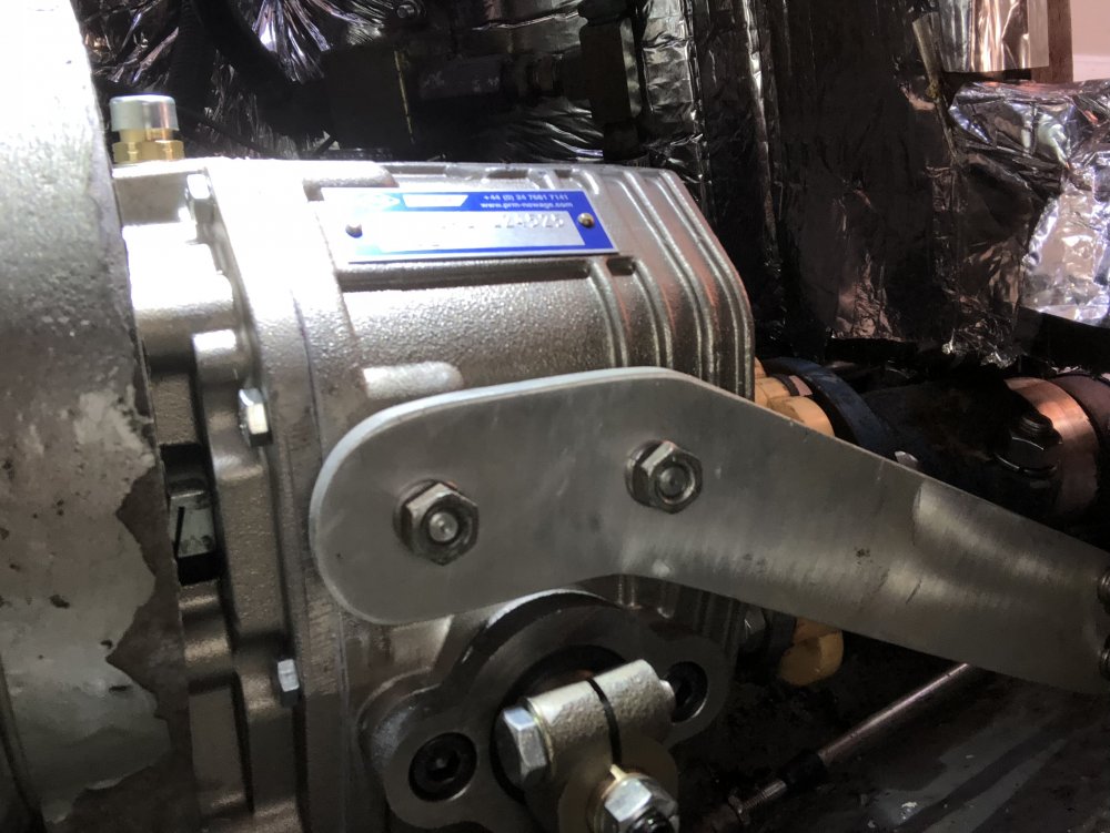

Starter in. Fired right up. More updates to follow. Shift cable nightmare in junked up locker, transmission did 15-20 min, got hot, but able to keep my hand on it....got more to do....but just had to get OFF THE DOCK!!

Here is video of transmission in gear, still need to lock down mounts with split lock washers. I need to figure out oil pressure sending unit. But here is after starter. I also need to change fuel separator filter, it threatened to puke out and it was hard to start. The fuel filter has not been changed in over 3 years, maybe a little dirty? Could just be dirty and need to run for awhile. After I ran it for 15-20 min with frequent speed changes, the gearbox was definitely hot, but it was cool enough that I could keep my hand on it. This is supposed to be solid test for transmission on Russian motorcycles, hopefully it holds true for sailboat transmissions too. It seems to have a lot of vibration at idle, with early engagement, then smooths out with throttle. I am planning on having it checked out by marina mechanic. Never hurts to have work checked.

Regarding the oil pressure senders, I used a "grease hose whip" that I purchased at NAPA for about $10. It is complete with 1/8" NPT fittings attached on each end and is rated for about 3,000 PSI. I think it was about 10" long. I made a bracket that I attached to the engine near the starter mount to hold the sender units. If necessary, you can purchase an adapter to go from NPT to BSPT. (I don't know it NAPA has the adapter, but I've seen them on Amazon).
