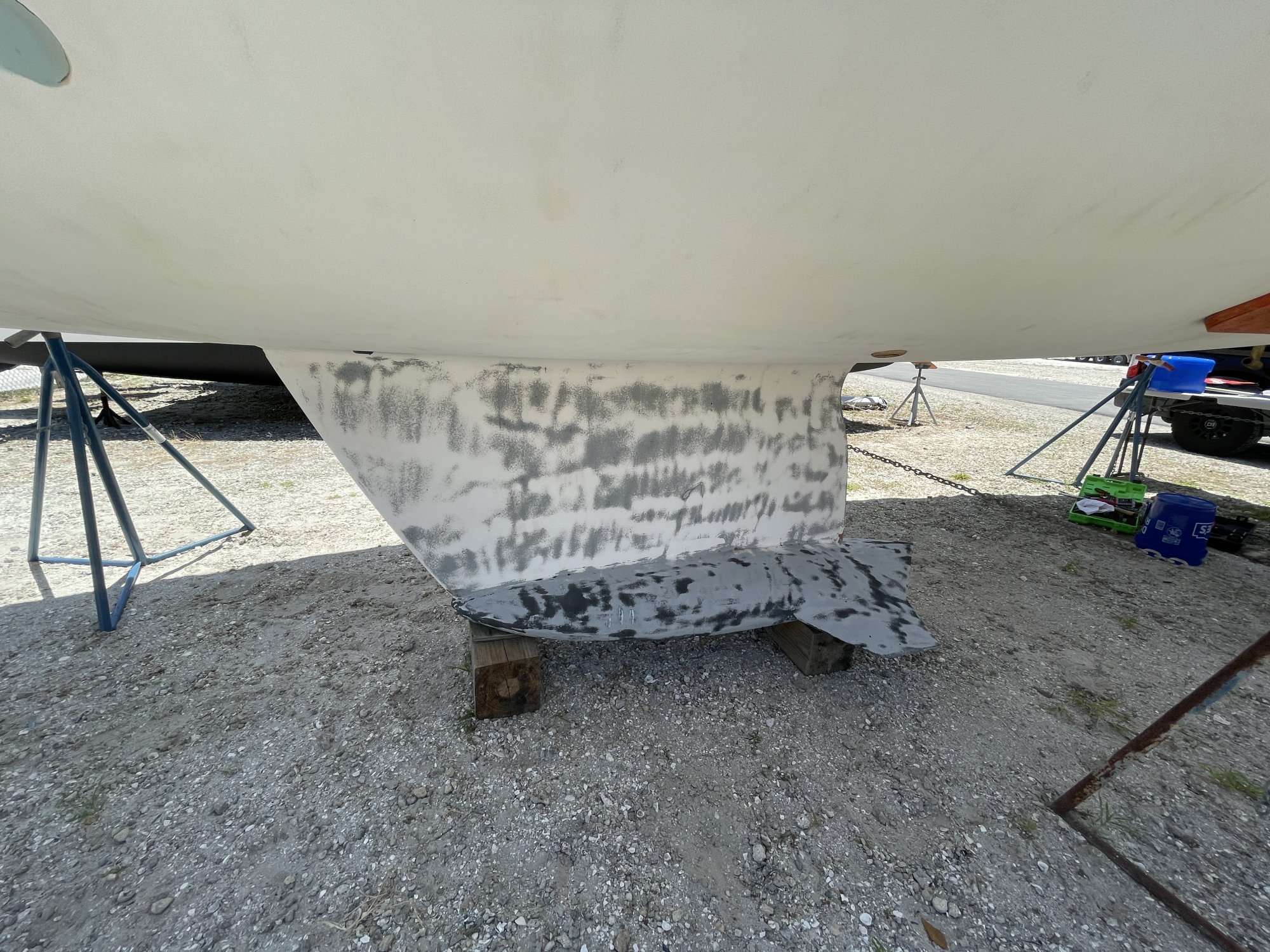

6 months after our survey haul out we are hauled out again for a bottom job and rudder repair that we knew about when we bought it. This time we noticed movement in the keel when it was on the travel lift the keel moves almost an inch or so left to right. Most of the movement appears to be around the keel joint. No water leaks into bilge. We suspect the boat had been grounded by the previous owner, and twice it has been softly grounded by us, we also dragged a crab pot for a mile or so before realizing recently. Our keel bolts were loose ish when we tested those. Started turning (tightening) at around 70 FT lbs. Mostly friction for the first 20 degrees of turning. We could not find the official specs for our bolts from Hunter but the chart circulating online said 135 ft lbs for 3/4” bolts and we were a bit nervous to do them that much. Since we also don’t know the condition of the bolts I only torqued to 85 ft lbs planning on to torquing to 100 ft lbs after i clean and lube the threads. I believe 124 ish was the max torque for 3/4 inch stainless bolts. Even after torquing the keel bolts we still have movement (torquing to 85 ft lbs didnt seem to reduce any movement). We are considering grinding down the cracks along the keel joint and filling with 5200 or Gflex, the fairing and paint. Also considering laying a few layers of glass around the joint also to add some strength (would fill the crack with something that the glass/epoxy would adhear to instead of 5200 if we chose this route). We know some flex is the nature of the beast for these boats and results in the “Hunter smile” ( however nobody is smiling at the moment). We are trying to figure out what is an acceptable amount of movement/flex and what is not acceptable? Anyone have experience with this issue and could determine the best option forward?

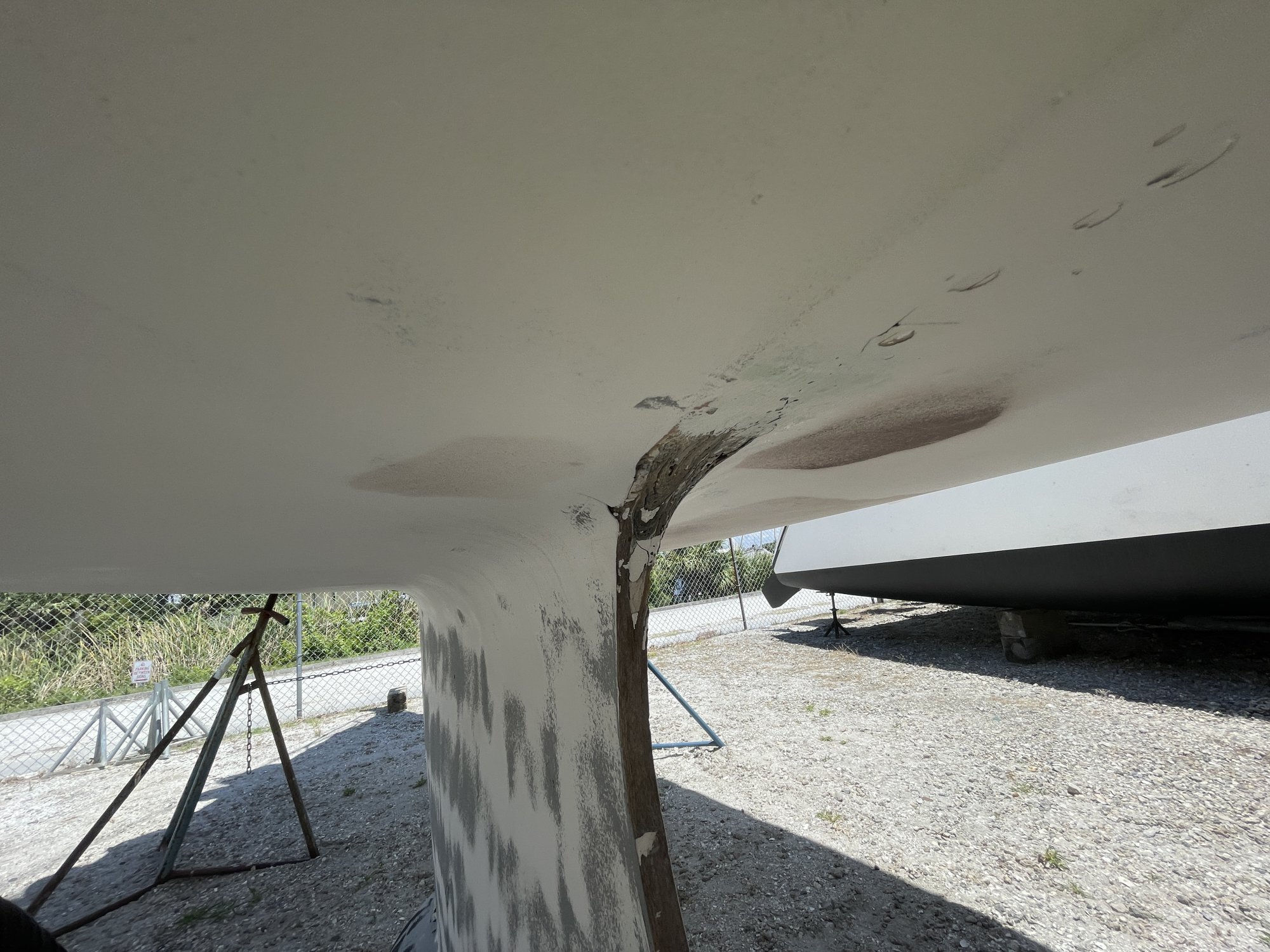

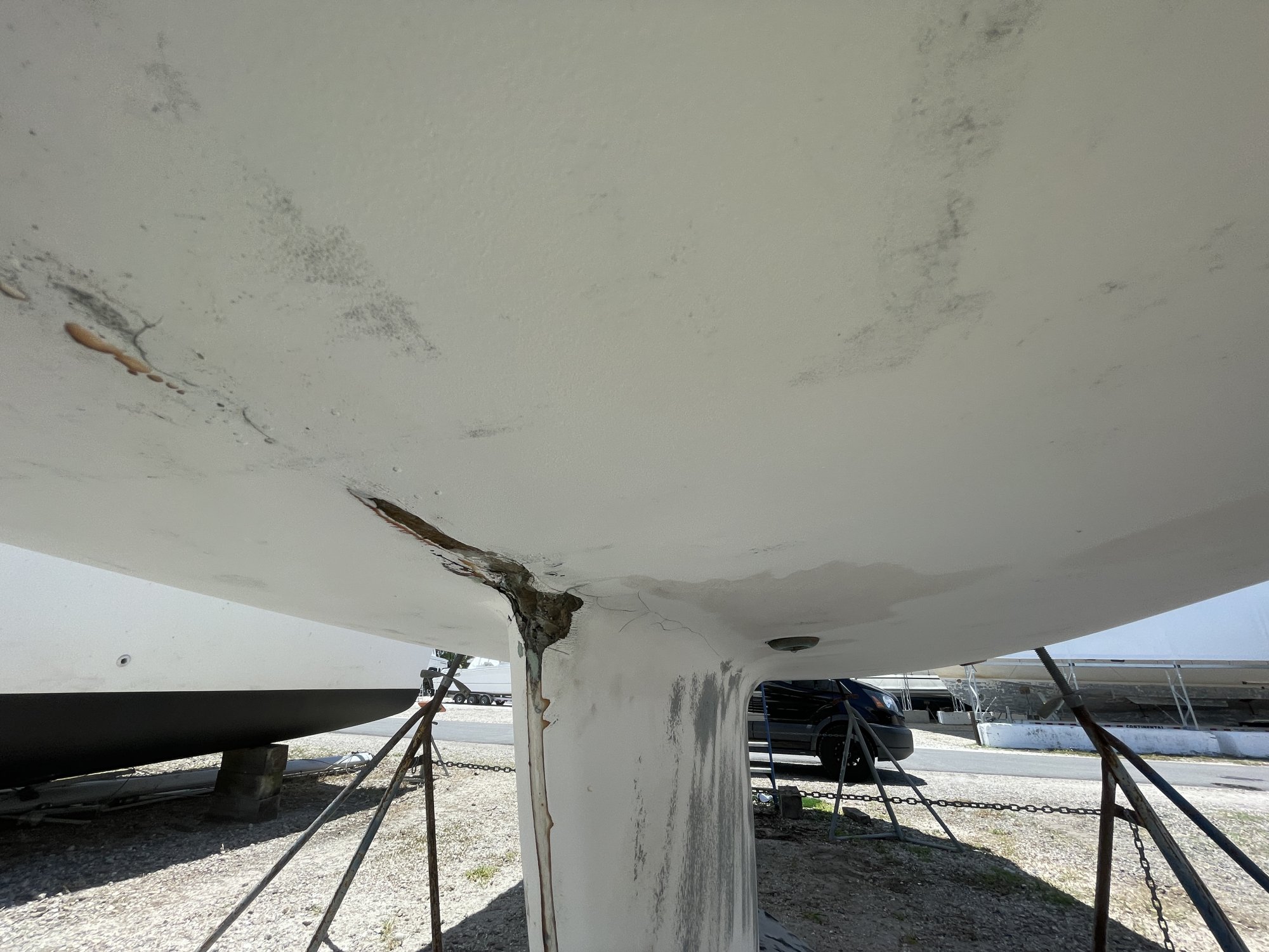

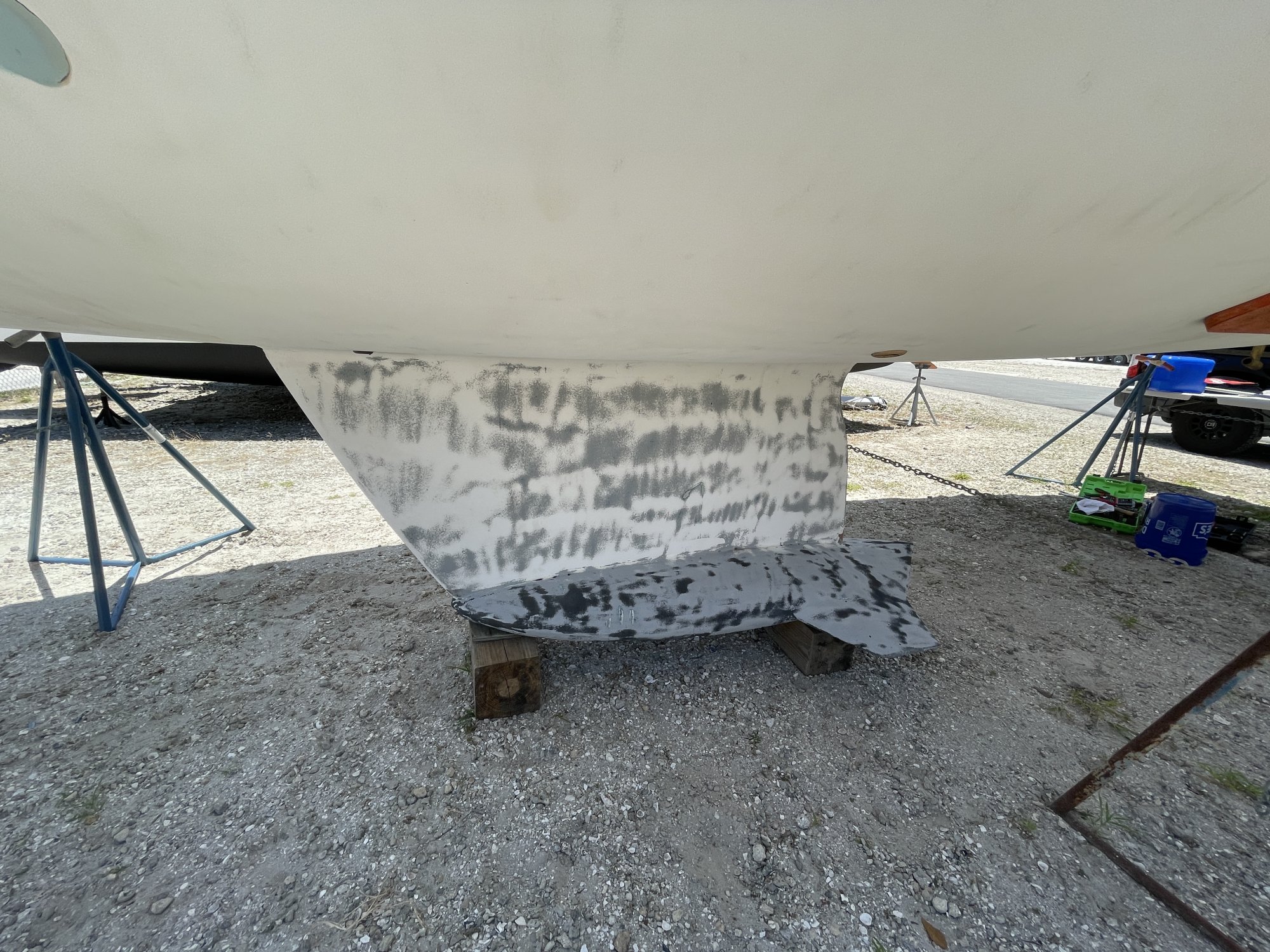

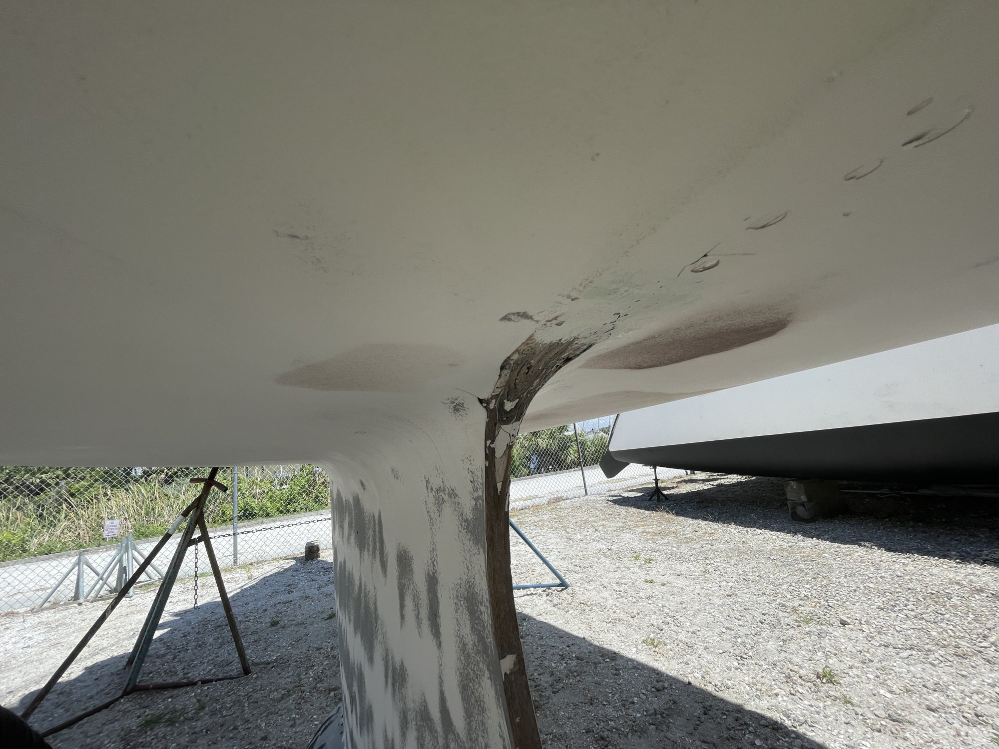

Thanks all for the input. Just got some different advice from the local keel guy basically saying it was normal. After being sand blasted the “smile crack” at the front of the keel turned out to be less severe then we expected. And revealed a place at the back corner to be drinded out and repaired as well. What continues to baffle us though is how otherwise good it looks. We’re very hesitant to cut into it as all the videos we’ve seen of others doing it are working with fun keels and our bulb keel seems to have a different attachment based on the sounds when knocking on it. We’ve only managed to find 3 keel bolts also and are still looking for the others.

It does look like it's in good shape. He's saying 1" of movement is normal/ok? Seems like that would cause issues after a while.

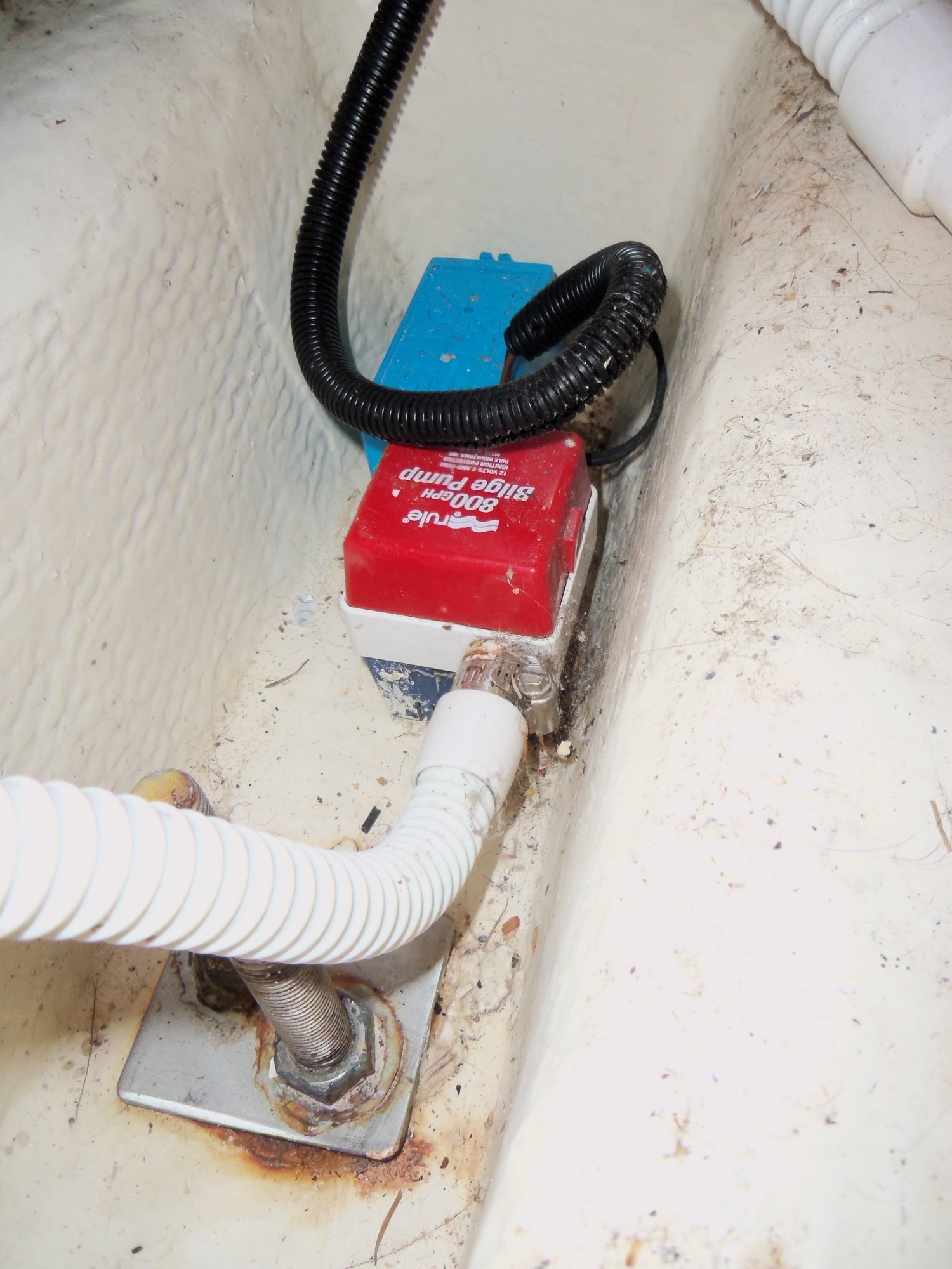

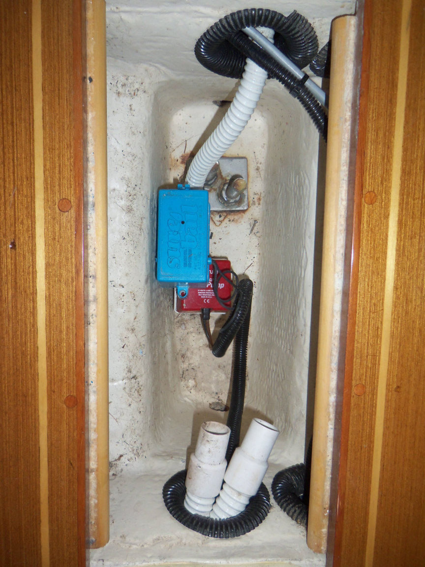

...... We’ve only managed to find 3 keel bolts also and are still looking for the others.
I wouldn't think it should be so difficult to locate ALL your keel bolts! You'd expect to have to lift the sole plates, though....
They're usually in the bilge proud as can be :

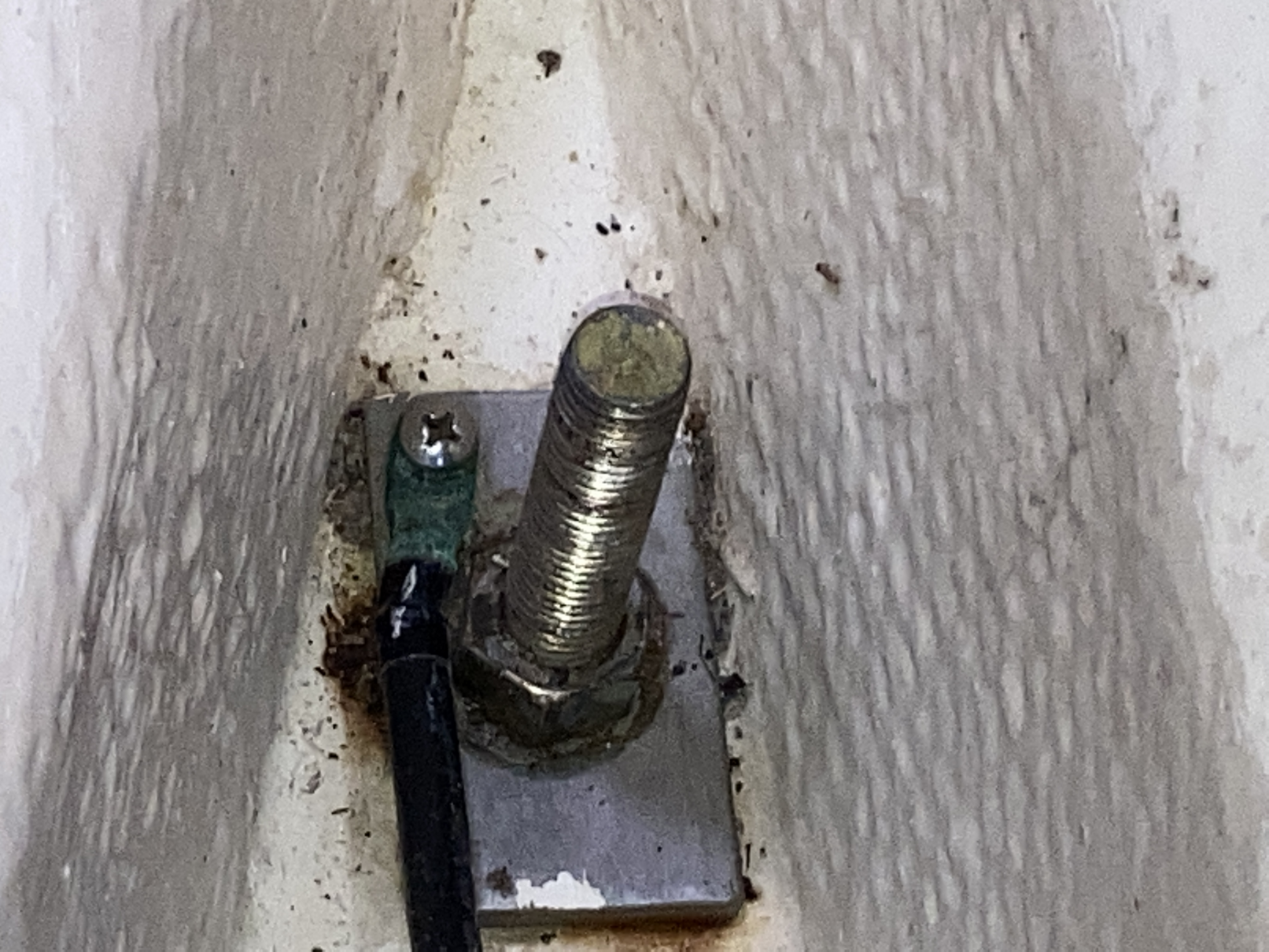

You're keel guy can't find the other bolts .................... and this doesn't worry you just a little bit ? Time to sit down, take a time out, and start asking yourself some serious questions. I can imagine you're under a lot of pressure to do the right thing now, but from my experienced and unpressured point of view, you're starting to make some very poor choices IMHO.

Have you found more than three keelboats? I’ve only found three myself, but I believe that the bulb is also bolted through the bottom into the Fin.

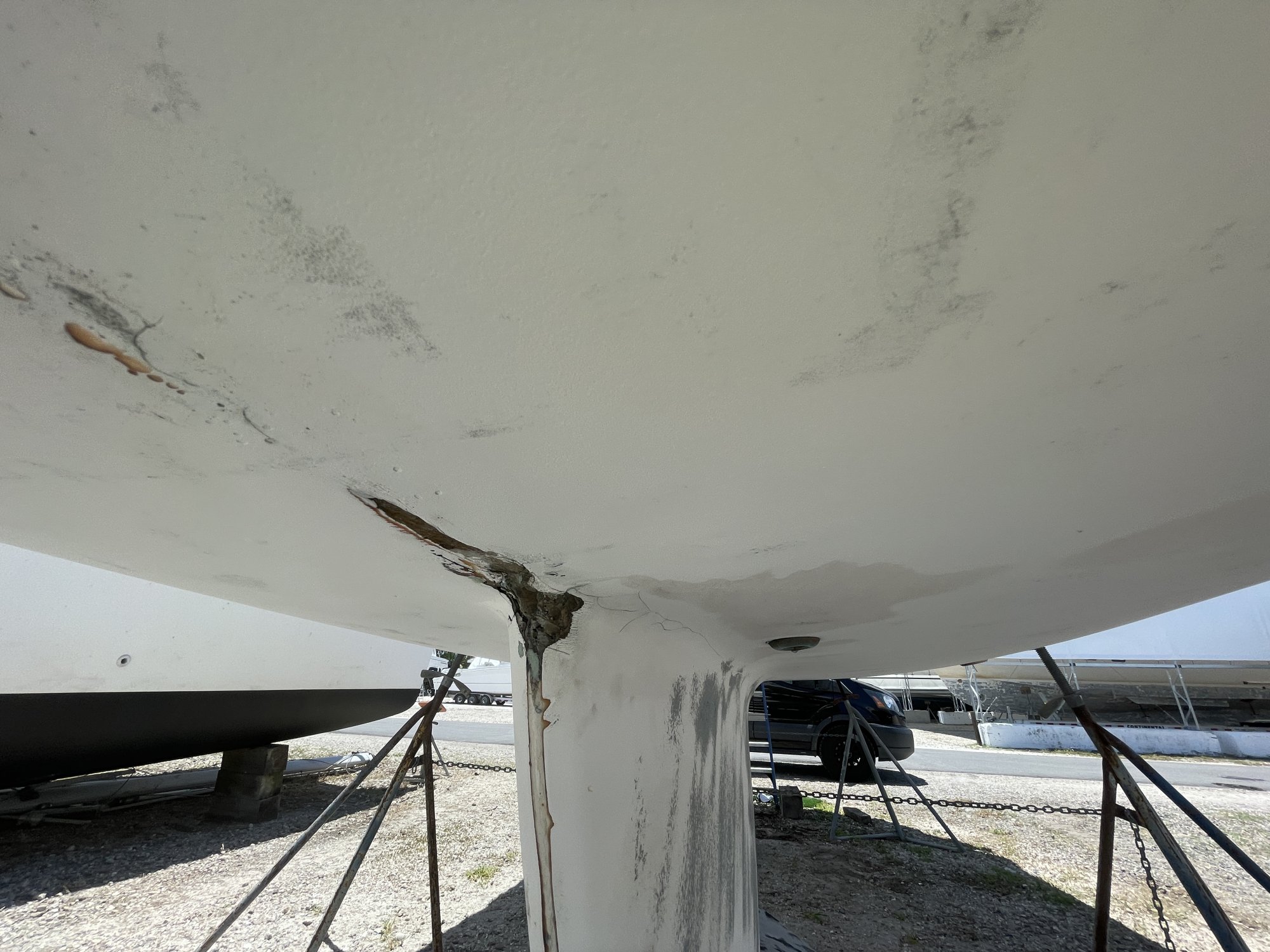

Thanks all for the input. Just got some different advice from the local keel guy basically saying it was normal. After being sand blasted the “smile crack” at the front of the keel turned out to be less severe then we expected. And revealed a place at the back corner to be drinded out and repaired as well. What continues to baffle us though is how otherwise good it looks. We’re very hesitant to cut into it as all the videos we’ve seen of others doing it are working with fun keels and our bulb keel seems to have a different attachment based on the sounds when knocking on it. We’ve only managed to find 3 keel bolts also and are still looking for the others. View attachment 215794View attachment 215795View attachment 215796
Hello mystic blue. I’m presently dealing with a hunter 336 Keel repair myself, and I’m shocked that so far I’ve only found three keel bolts in the bilge. I find that shocking
