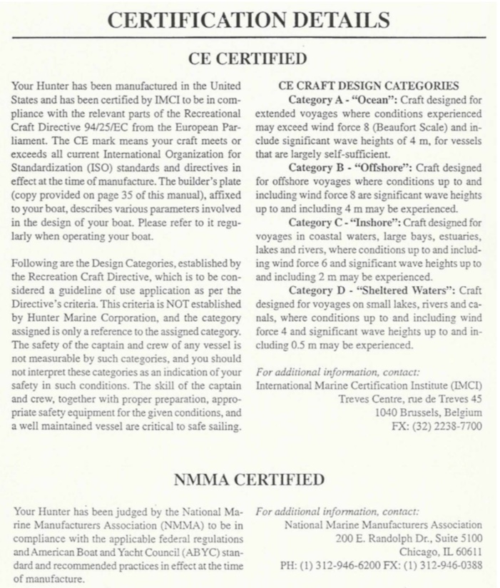

Hi, the same page / doc is in my manual, but there is no plate, what is the purpose of this doc if not CE certified ? at least curious.....
if there was any 380 CE certified will be useful for my new flag doc, but i didn't found any in Europe, I think I will do a deposition....hope will be aceptable....

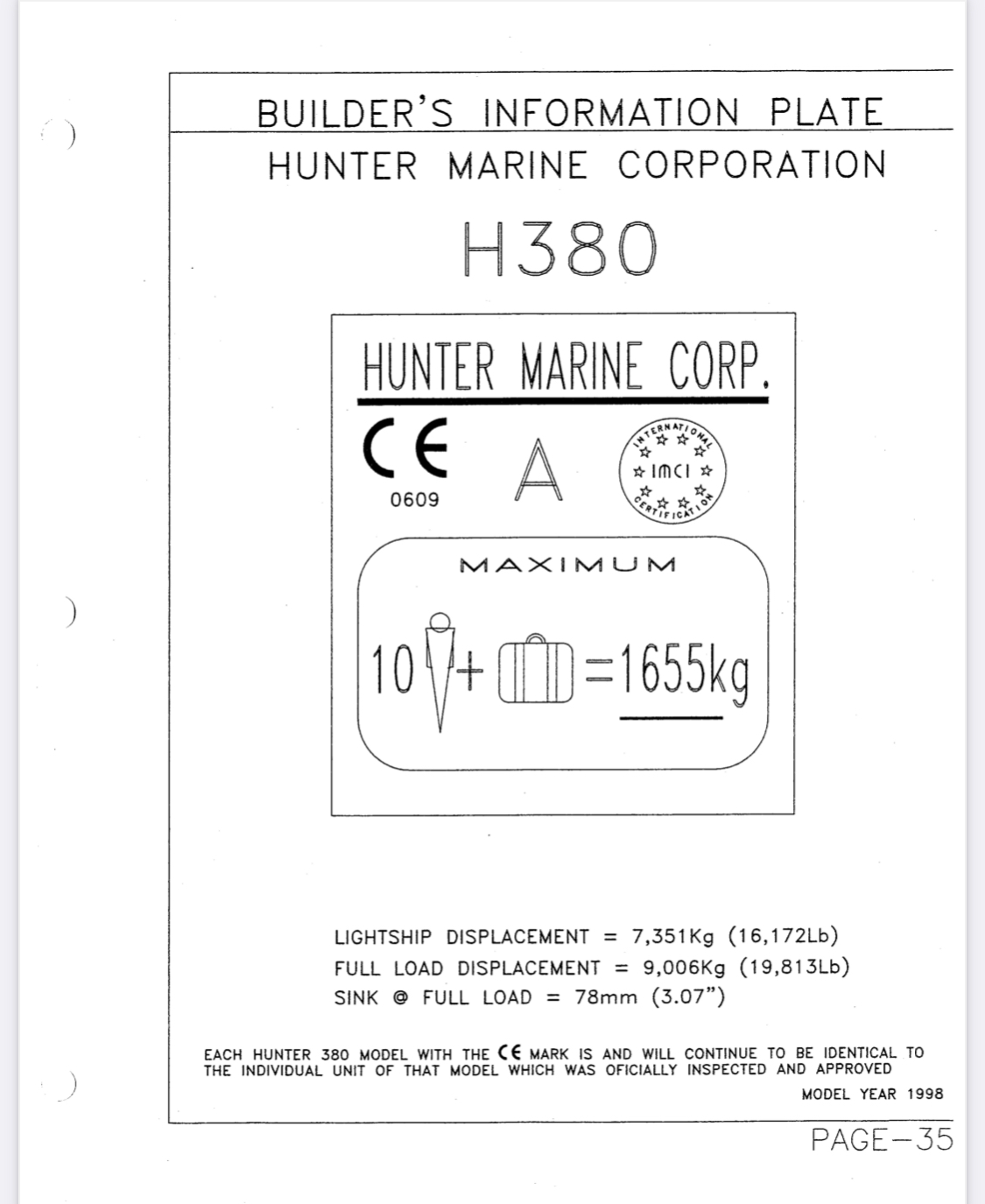

Does the page 35 in your manual that shows a “copy” of the builder plate show 2001?
I think you might be onto a solution. If you have purchase documentation, and a Hull number that all matches the “year” on page 35 in your manual you might be able to have all the documents legally “certified” enough to get the registration you are after. :)

your idea are great but the page in my manual is exactly the same you found, there is no conection with a specific boat , it is a general statement more for marketing purpose i guess, don't misunderstand me , I am very happy with my Hunter, I think was one of best series they build, the manual are incredible complete but this point of the CE certification is something ambiguos......perhaps Phil, the "master" magician behind this site could do any comments.
You might do a direct contact with IMCI in Brussels Belgium. See the info..
Use your HIN# to confirm your boat builder and model. HIN# is affixed to your boat with a metal tag.
Jim...
