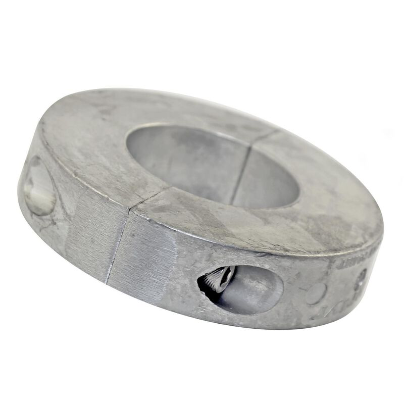

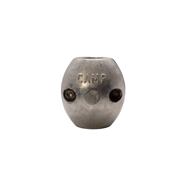

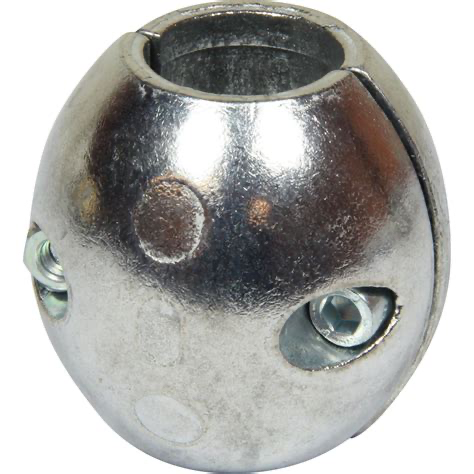

It would not be specifict to Hunter. It would go here...
They look something like this...
You can find them at any chandlery (like West Marine etc.). You just need to know your shaft diameter.

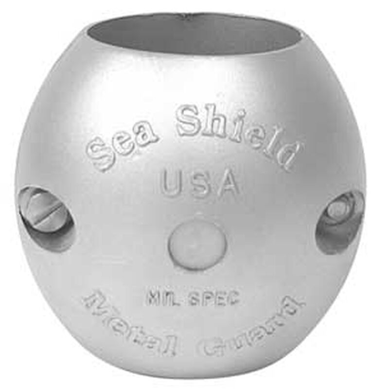

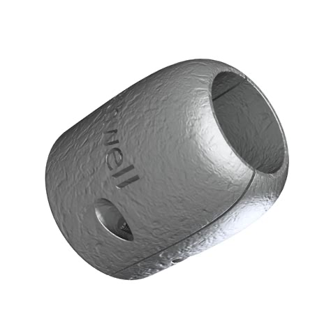

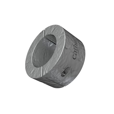

Additionally the space available between the prop and the cutlass bearing. There are a couple of designs to help deal with the available space. You need clearance between the bearing and the anode so that water can get through the bearing to cool it.
Commonly used shape (as previously shown)
Limited clearance zincs
good luck..

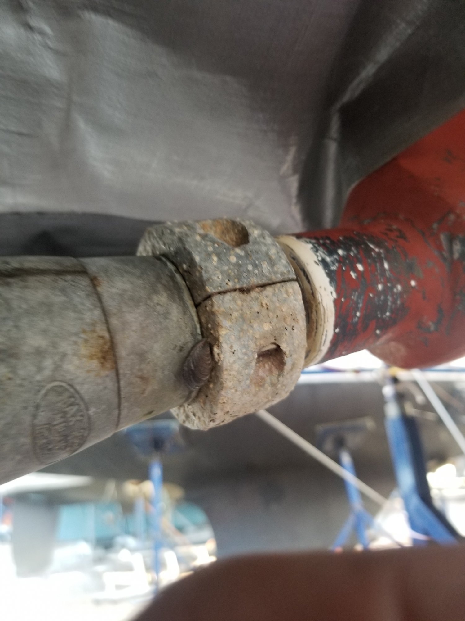

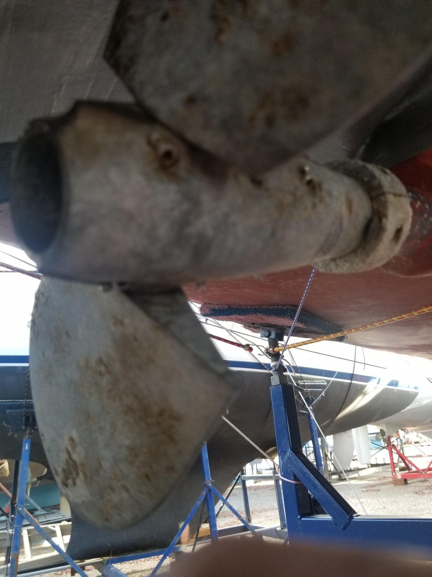

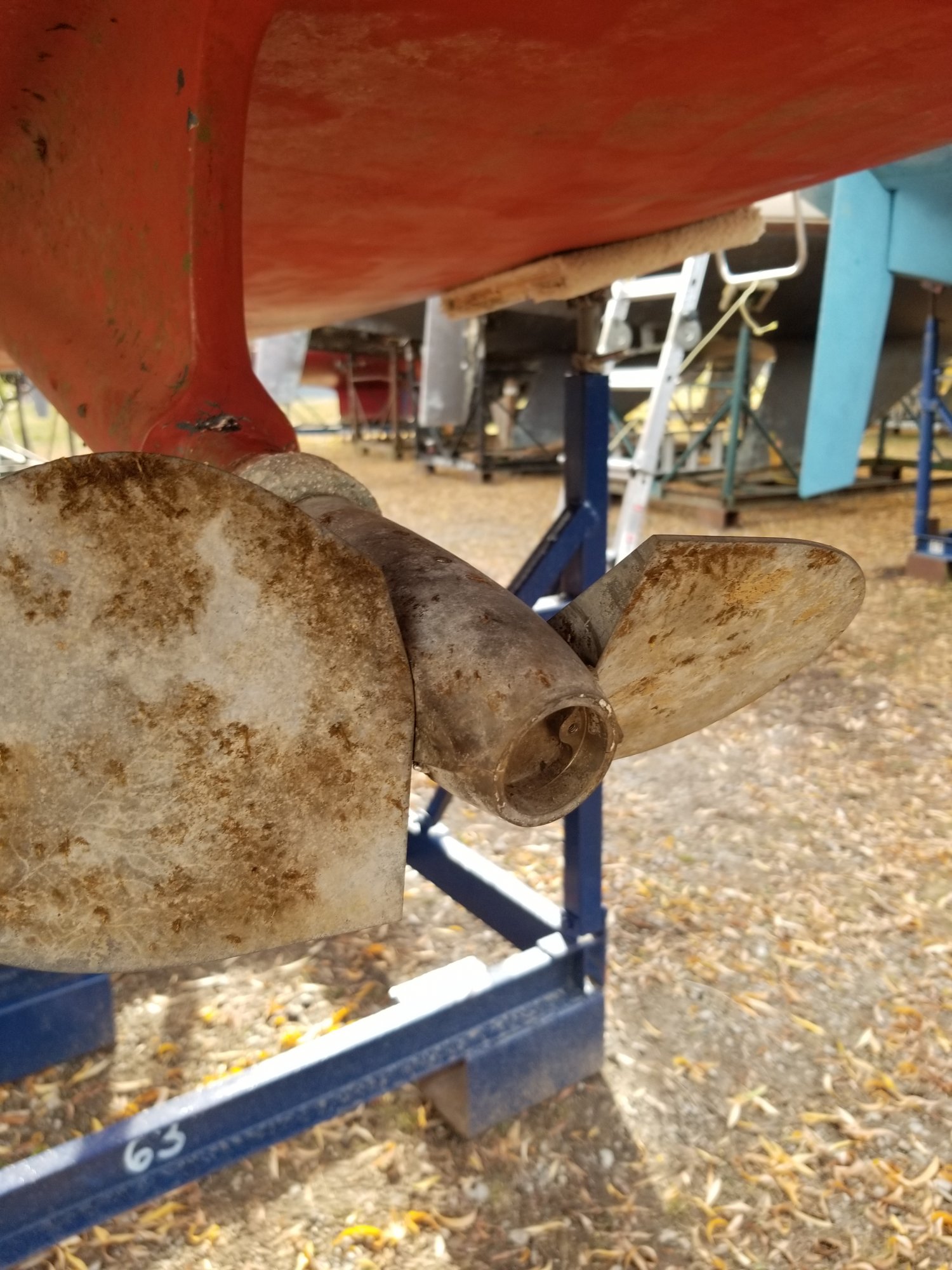

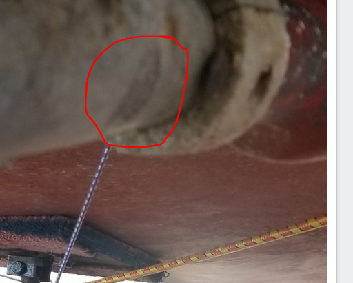

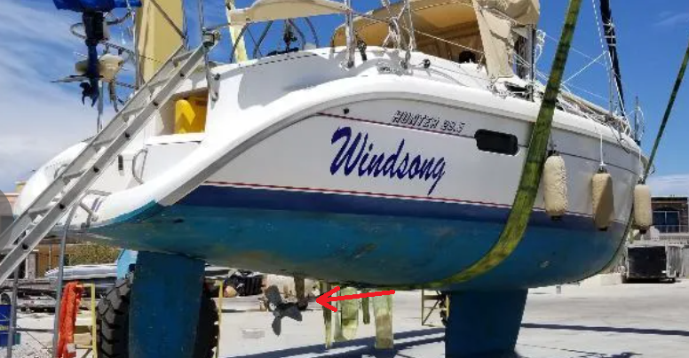

Thank you all for the replies. Do sailboats normally have both the propeller anode and the shaft anode? Mine seems to have the shaft anode on but missing something at the end of the prop. Please see the attached photo.
14,166
Dunno. Been looking for it but can't identify it.
The interior gearing, the blade shape, and the socket screws with cotter pins, is consistent with a Max Prop, however, the blades seem a little thick and the hub shape isn't quite right. Perhaps a very old Gen 1 Max Prop?
Feb 26, 2011
1,440
Achilles SD-130 Alameda, CA
No. Older model Max Props have 6 machine screws fixing the end cap to the hub. This prop has neither the machine screws or the end cap. Newer model Max Props do not have the blades mounted so close to the after end of the hub.
Dec 4, 2023
160
Hunter 44 Portsmouth
Is this some kind of brand mark?
A picture that is focused better would be helpful.
Are the blades turning pink at all? Any signs of corrosion on the running gear?
Based on your location and the cradle you and the boats around you are in I'm guessing you're in fresh water. If you're not seeing any signs of corrosion consider running the setup that's already on the boat.
Feb 26, 2011
1,440
The thing that is throwing me the most is that the end of the hub appears to be open or somewhat recessed, . That may just be a function of the poor quality of the pic. But you are right, the dead giveaway is the socket head screw with a cotter pin, which I didn't notice before. I now beleive the prop is a 2-blade Classic model, only a small number of which used an anode on the end.

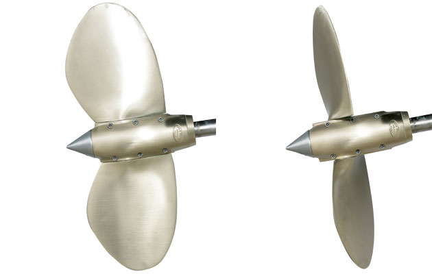

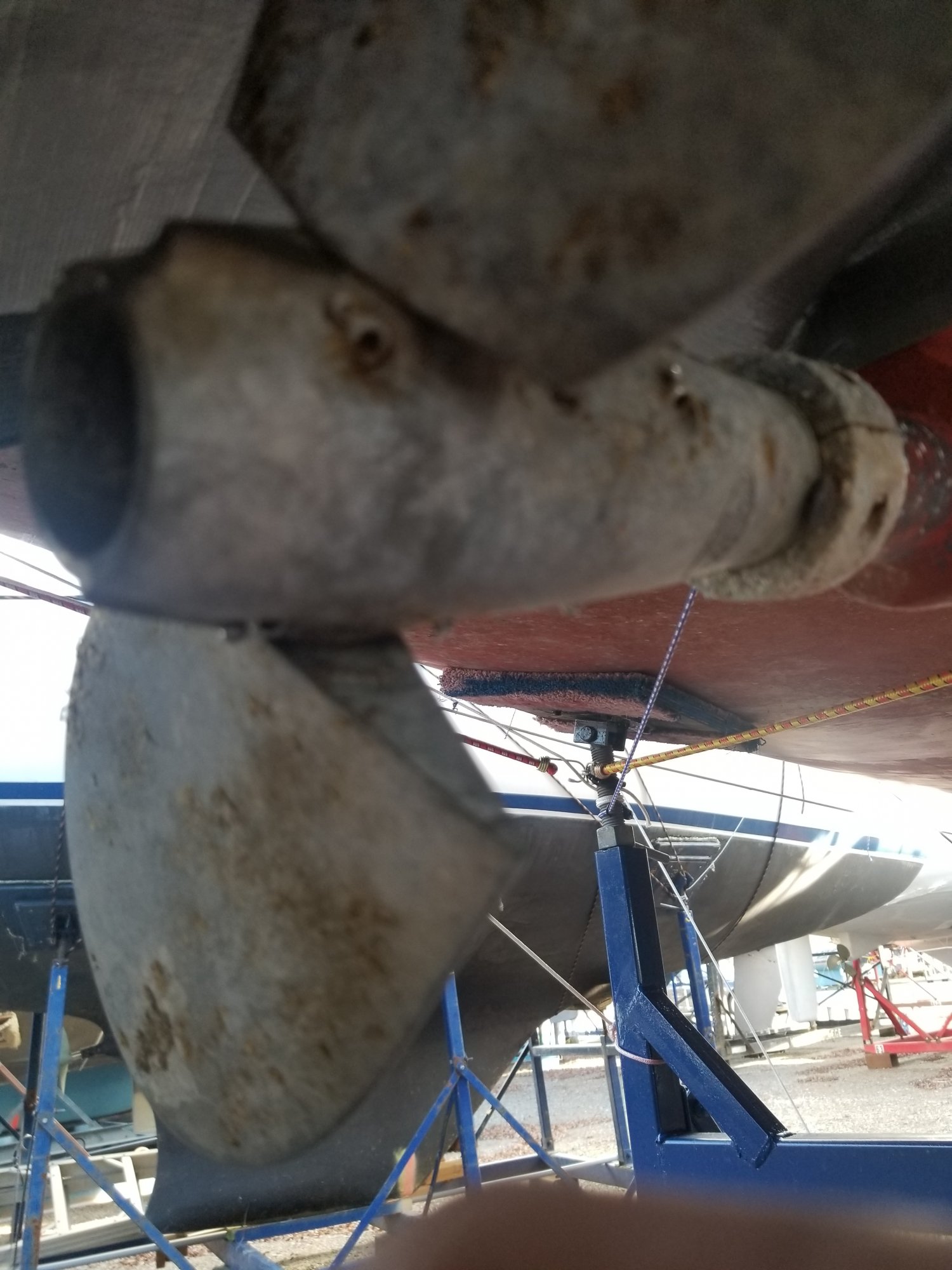

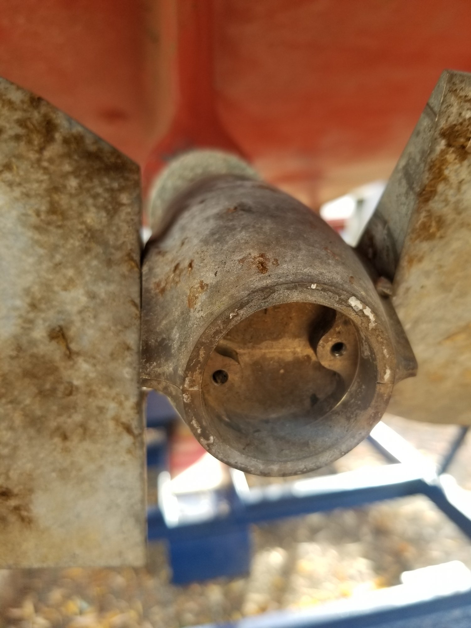

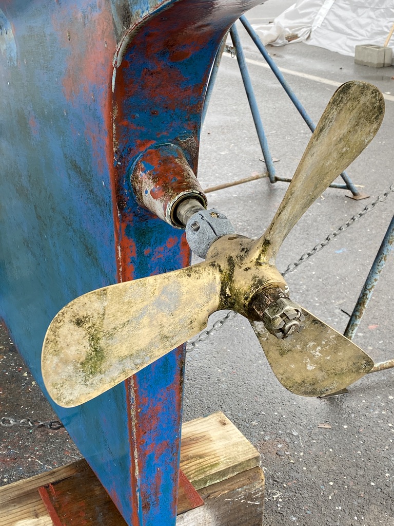

Thank you very much again everyone. I'm attaching new new photos that show the propeller better. I sail in fresh water on Lake Ontario exclusively.
Definitely a Max Prop. Here's the anode you need:
