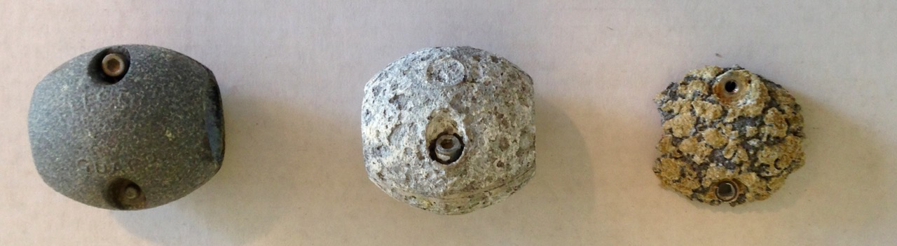

Thank you again everyone. Regarding the already installed shaft anode, although someone mentioned it's Zinc (and needs to be replaced by Magnesium) however, considering there is some wear and tear on it, doesn't it mean that it's actually functioning properly in fresh water and therefore a magnesium or Aluminum?

Here are 3 anodes that were on my boat. From left to right, Zinc installed by the prior owner, aluminum after one season, magnesium after 2 seasons.In freshwater, zinc form a hard coating which insulates the zinc from the water rendering it ineffective.
