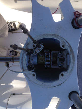

PedestalCable.jpg not that it was hard, but just took some time to get the screws in the pedestal that hold the throttle and shift handles removed, they did not want to come out ... then the cable stop out... reading the instructions helped...

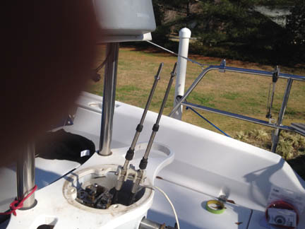

PedestalCable1.jpg sorry about the finger, once I found all the ties and mounts , I just tape the new cables to the old cables and with an extra hand they guided right up through the bottom ... was a tight corner though...

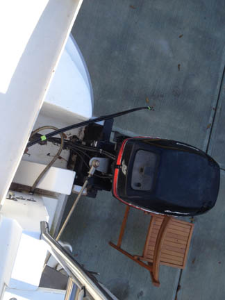

Motr.jpg I used a chair to help keep them level through the steering hole for the rudder and after I got them up the pedestal I routed them to the motor...

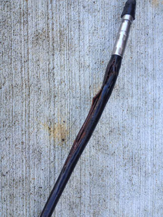

BadCable.jpg rusted right thru ...

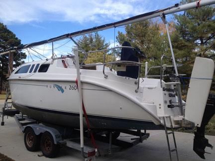

Boat.jpg it is amazing how things can just go bad from sitting, and neglect
