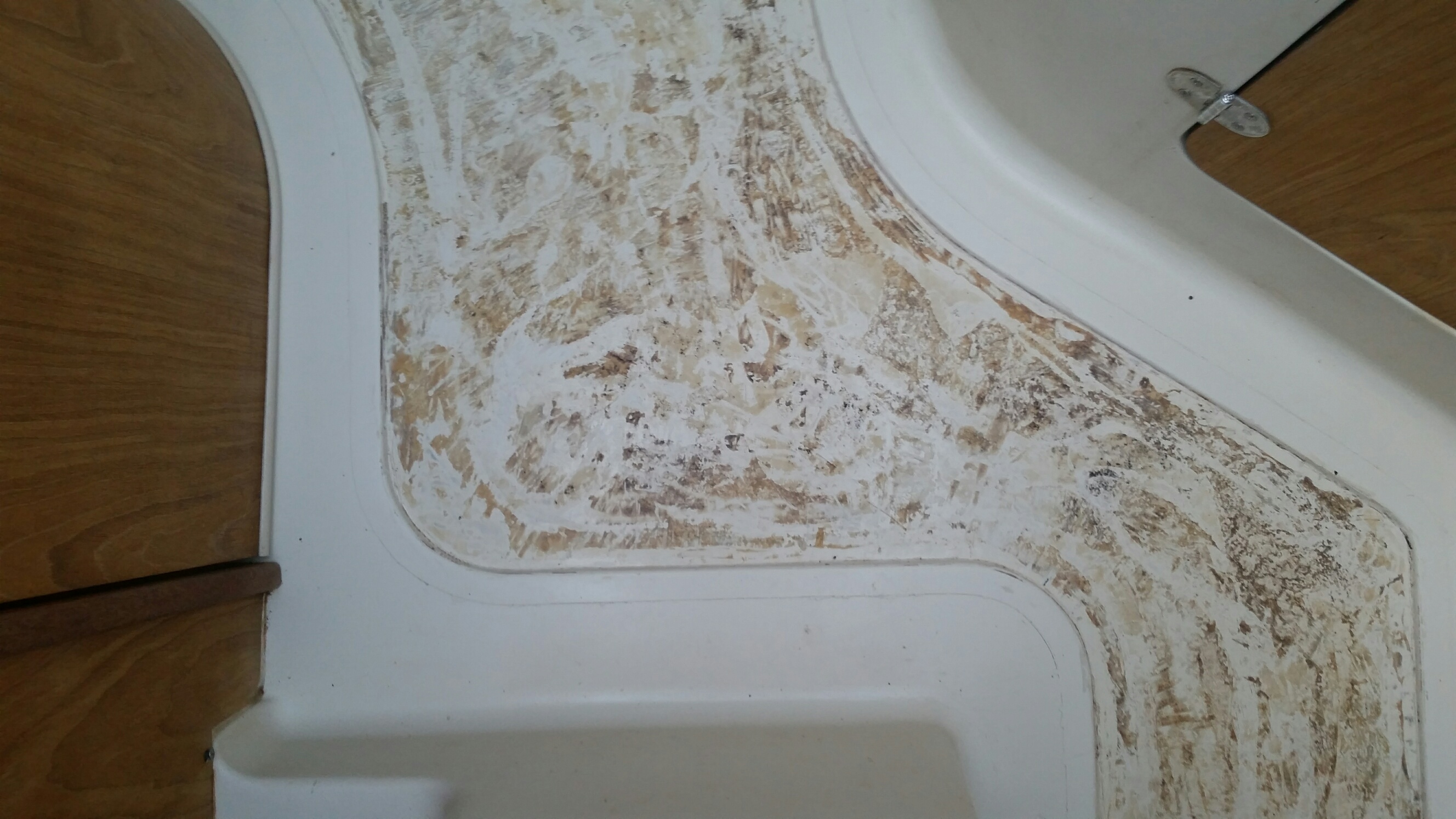

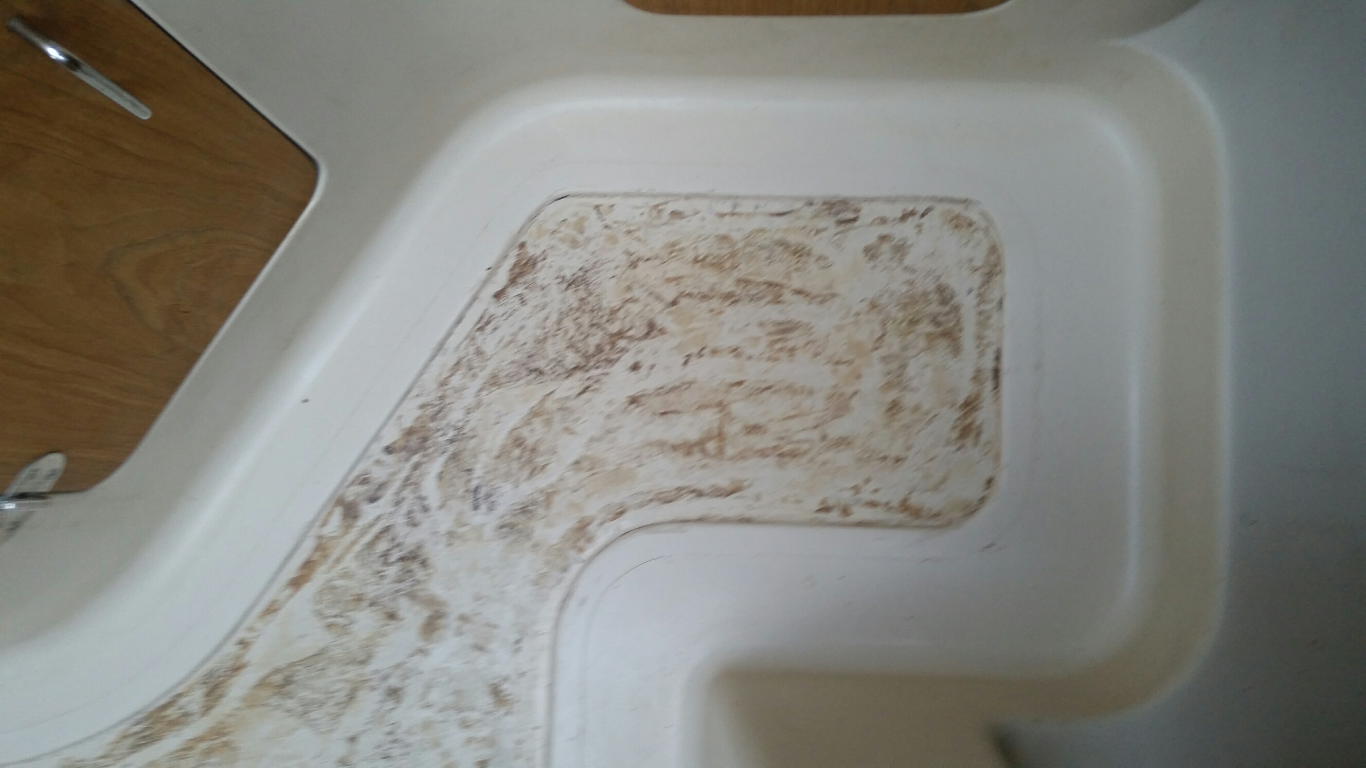

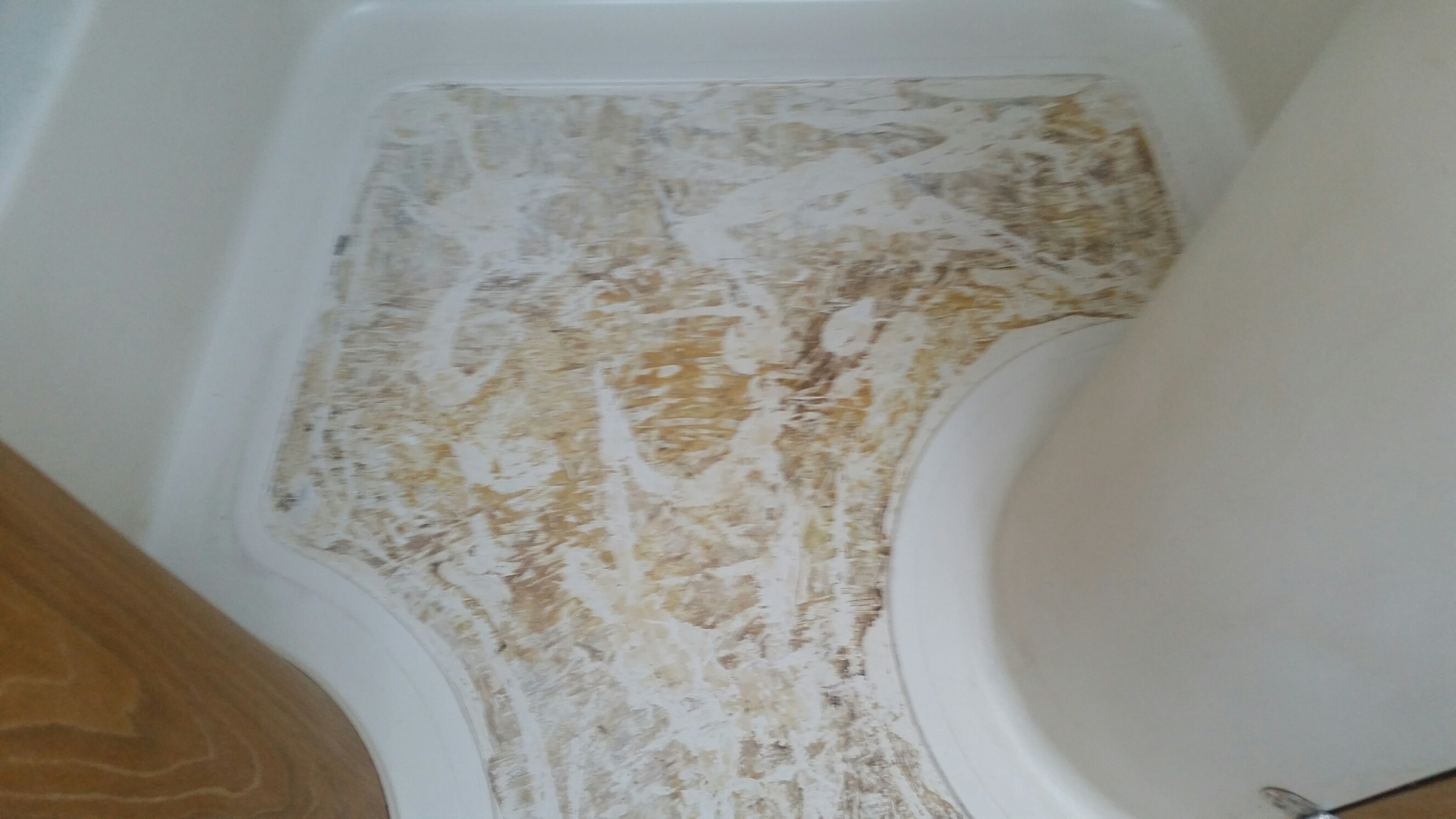

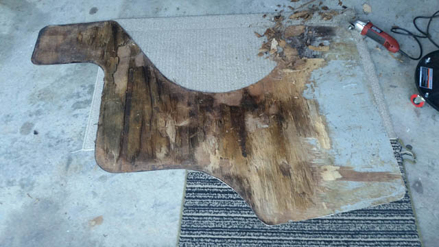

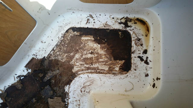

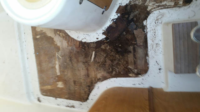

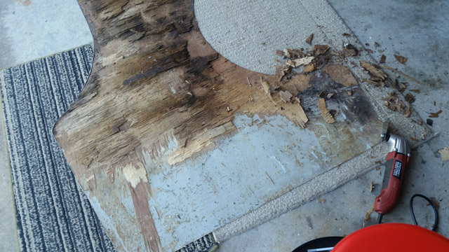

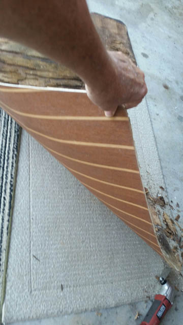

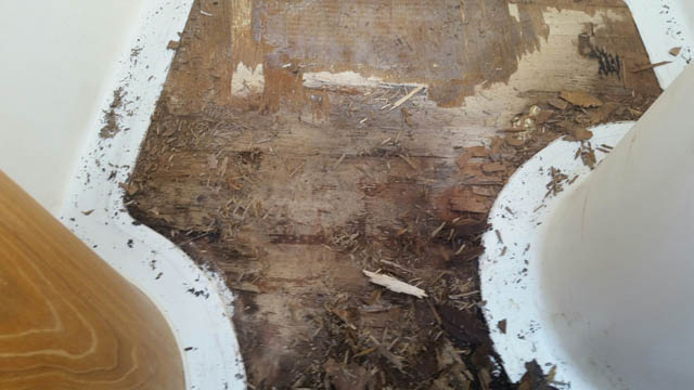

Cleaned it all up and the fiberglass looks fine... will need to cut a piece of 1\4 marine plywood bed and will put a new piece of laminate down.... I am surprised that the floor there has no way of draining water to the bilge ... it could hold 4 of 5 inches of water .... Why is that? dip it out with a cup?

20171020_181807_1508783517739_resized.jpg 20171020_181759_resized.jpg 20171020_181803_resized.jpg
should I use the 5200 to attach the plywood to the boat floor? I assume its to be permanent.

Please DONT use 5200! Satan's glue is great for bedding Keels and other serious structural stuff, but on the interior you should use something that gives a great bond but you could potentially pry or peel up without ripping out the glass laminate with it.
Disregard my previous post about epoxying down old the teak/holly after planning to new plywood. I was under the assumption it was real wood and not a vinyl laminate. Is the old vinyl damaged or discolored? If not it can be re-used if you can get all the old wood and adhesive scrapped/sanded off. Use the old floor to trace out the new 1/4" marine ply piece. Once it's cut out seal both sides with epoxy and sand flat. Two coats, one to soak in and as soon as it kicks hot roll a second coat.
Assuming you can get the old vinyl sheet clean and its undamaged, you should be able to glue it to the wood using natural flooring glue they sell at the big box stores (its basically melted cow hooves). Spreads on with a comb, let dry to tack on both surfaces then place together and seat with a roller. Use the same glue to attach the plywood back to the fiberglass.

thanks cloud diver... I wasn't to sure what to use... I got the old vinyl pretty clean but there is a defect in it, so I will replace it.. It will work great for a pattern.. going to order a 4x6 laminate sheet this week... For epoxy any suggestions?

I am the expert here sir as I was involved with the design. The floor pan is one piece and to accommodate a floor so it would be flush and not raised, it was designed to be recessed in the mold with the rest of the floor to avoid tripping, now you get the picture. As for floor adhesive, my suggestion to use Liquid Nails was used by Hunter to attach the floors with but must be trowled all around. Push the floor down completely into the adhesive. Then I would cover the floor adding weight for 24 hours in order to hold it down. Once dry, I taped the edges of the floor and the outer rim of the deck pan as well to spread a bead of Dow silicon pure grade that was used on the windows which comes in black, white or beige at that time. Spread that while soft. I used my finger dipped with spit or alcohol constantly and let dry removing tape. This avoids water getting under the floor so you will not have a mess like you experienced again. Water coming from above was the general culprit and that has been discussed much in the past now in the archives. To prevent that buy a cover for the top of the companionway and make sure you put a throwable cushion underneath the cover. Make sure if boat is on the trailer, The boat is sitting level with the ground. Any other advice on epoxy and other adhesives, you are on your own .

Thanks Dave, that gives a clear picture of what is needed... 1 question is the plywood thickness .. the vinyl is 1/8th and the recess looks to be 5/16th ... was the original wood 3/16 thick?

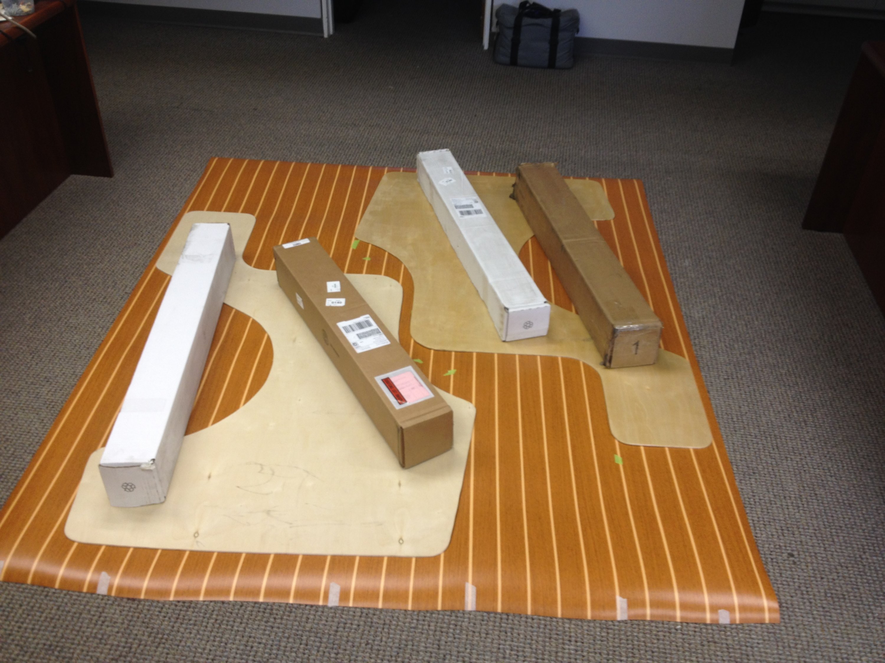

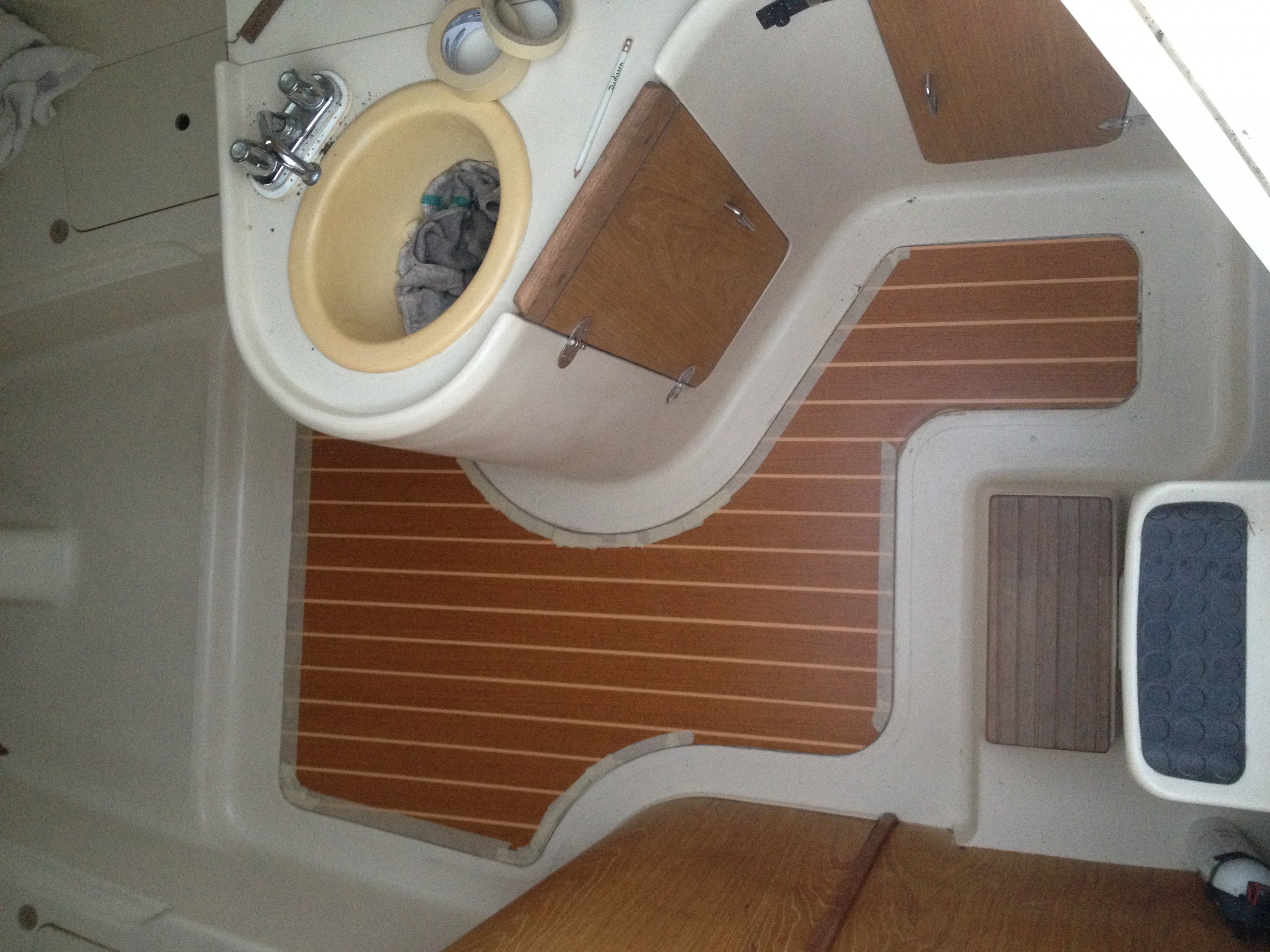

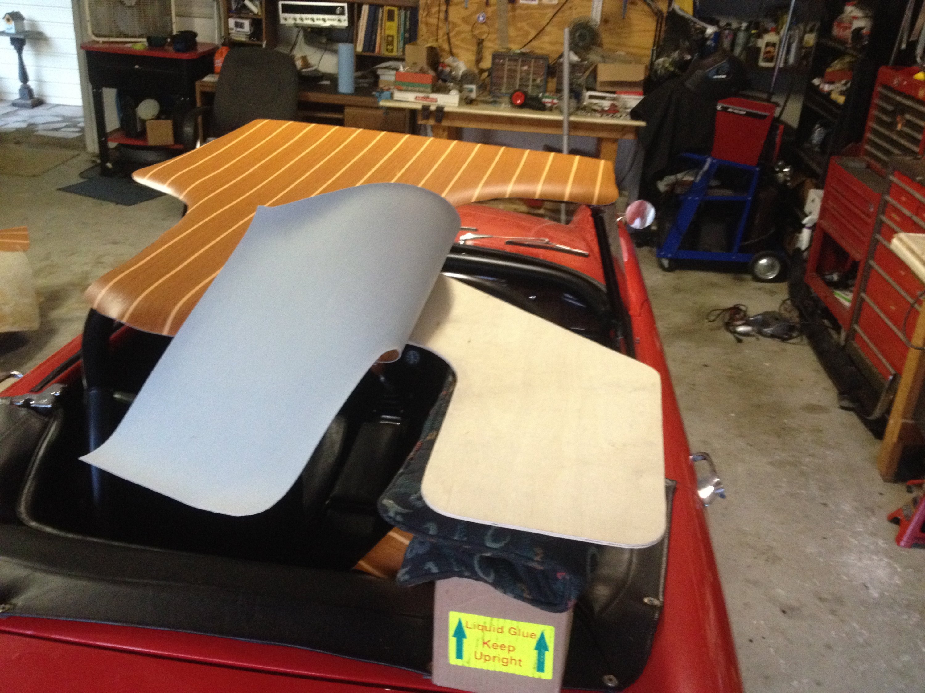

Update to floor... used a 4x8, finished quality 1/4 birch plywood and cut to pattern, bought 6ft of laminate from Defender and quart of glue from Plasteak . It gave me enough material to make 2 complete floors.
IMG_0780.JPG IMG_0800.JPG IMG_0801.JPG After a few test fits I got the fit just right... Used liquid nails to mount to floor of boat... will add the silicon seal around it in a few days... Over all I am pleased how it turned out... just like new! thanks for all the help

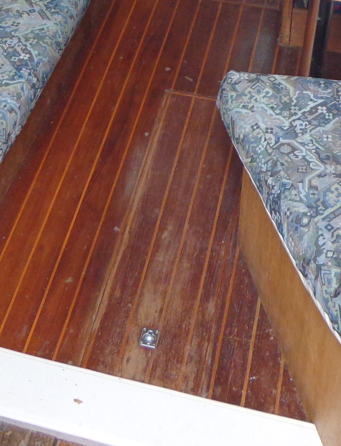

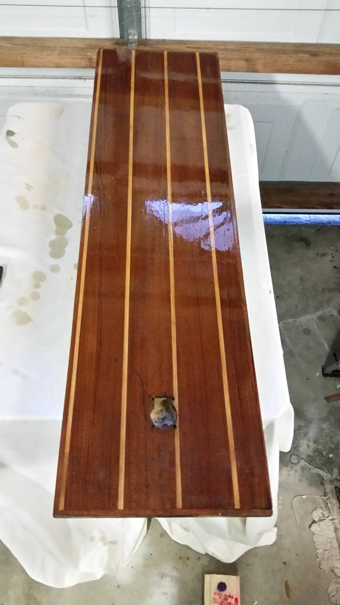

I wonder how the Mahogany and Holly Lonseal would look on our sole?
Our boat had some water intrusion issues when we got her,
and we refinished what we could.
But with the hot water heater leak last year, we now have some very soft floor boards in the galley and quarter berth that I need to replace. New plywood with Vinyl might just be the ticket. I'm just not looking forward to disassembling all of the salon and galley cabinets to replace the floor that runs under them.

Chip, I guess it matters to the structure that is underneath... I used the birch because I was unable to get fir... and after I pattern cut it, I applied a couple of coats of minwax wood hardener... it sucked right in... vinyl was easy to work with, used electric tin shears for the block size.... and a rotary sander after I glued it to the wood to get it to fit...
