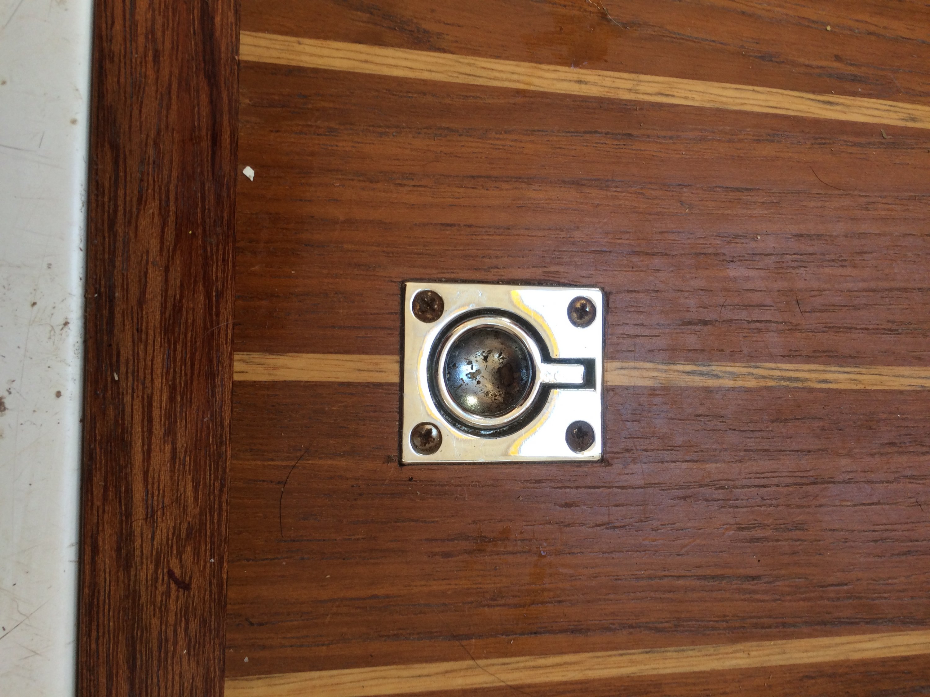

Got up to the boat today and started to put her to bed for the winter. I took some pics of the bilge covers that I redid. Mostly what I tried to show in these pics is the 1' x 1/4' strip that I inset along the ross grain edge of the covers. Also I inset a ring pull in each cover to aid in removing them. Previously the covers were screwed in place and had to be pried up, resulting in lots of chipped gel coat .
As you can see I haven't got a clue how to post pics, what am I doing wrong?IMG_0984.JPG
