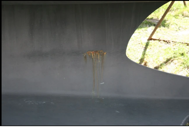

Hi, found this forum post through google search. Speaking of Lead/Cast Iron and the Hunter 49 Keel. I was perusing Hunter 49 boats for sail. I noticed rust at the Keel/Hull interface in one of the pics (attached). Obviously being new to sailboats, but a little naive - is the rust shown at point of serious concern to anyone on this forum? Somewhere else there was a thread that stated this was not a matter of concern - that it can be easily repaired. I'm sure if I was interested in this particular boat I would have a surveyor take a look at the keel bolts, etc...
Again is the attached pic a matter of concern for anyone on this forum?

If you are looking and it is on the hard. Get a big magnet to test it.;)
All the looks rusty in not necessarily Iron.
Jim...
Jim...
I have not seen the boat first hand. Just was concerned over what looks like rust. Though having read a few forums on the internets - this seems like a common problem issue with Cast Iron Keels.
Not normally. Diver can inspect that for deterioration. Under water there would be NO red steaks. Red, if Iron, would be the Oxidation process of Fe + O2 --> Fe2O3.
Clean up spot and repaint. Done.
I would be more concerned about the Keel Bolts that can be seen in the Bilge.
Jim...
Rust will never hurt it, a rusty keel will still likely outlast the boat

Can you get the broker or seller to provide a full shot of the keel. What year is the boat? Also ask for a photo of the keel bolts as well.
That will help to get better responses

What Crazy Dave said,, and also have them do the magnet test on the keel. If it's iron, it's an easy fix, if lead it could be a big problem.
