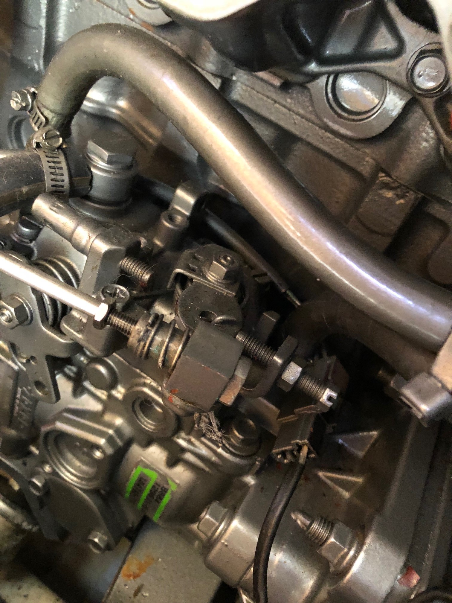

There are usually 2 stop screws on the governor lever, one for full throttle and one for Idle. Check to make sure that the screw for the full throttle has not come loose and moved to limit the governor lever movement. The governor lever is what the throttle cable connects to. What is your unloaded full throttle? If it is the full throttle stop adjustment the RPM in no load should also be low.

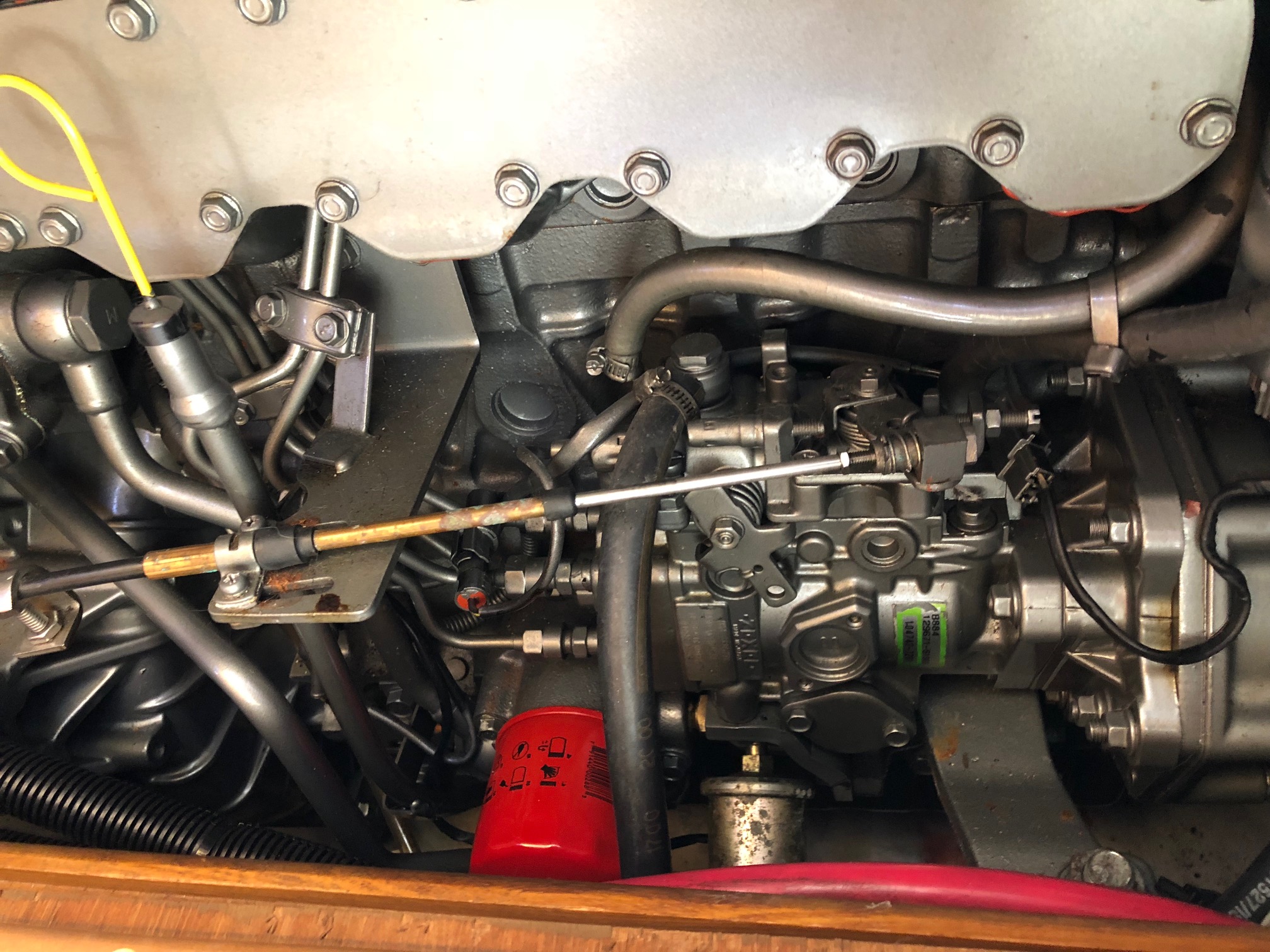

When the the bottom paint was done, I had them check the prop. It was cleaned and they said it appeared to be functioning correctly. I replaced the tach today but in neutral I was only able to achieve slightly better WOT rpm's. I believe it was around 3100 whereas before it was 3600. I'll try on Sunday when I return from the weekend. I looked at the throttle cable (see image attached), it appears to be OK. The aft screw regulates the max throttle. Would anyone advise adjusting it? Not sure how this would have changed over the course of the years.

Since the engine will turn at 3600 rpm in neutral it eliminates the upper stop and the cable adjustment as being an issue. It also indicates that the total volume of air that can be passed by the engine is free to flow out the exhaust, assuming the engine is naturally aspirated, (as opposed to turbo charged) and this most likely eliminates the exhaust elbow restriction. When the transmission is engaged there is a load on the engine which drags the speed down. As the speed reduces the governor opens to deliver more fuel to maintain the engine speed. If there is sufficient fuel being delivered the engine will burn the fuel and the engine speed is maintained. If there is too high a load on the engine there is not enough power in the engine to drive the speed back up, even though the extra fuel is being delivered. This results in black smoke coming from the exhaust due to the unburned fuel in the exhaust. (air to fuel ratio is wrong) The black is caused by a carbon rich exhaust. Too high a load can be caused by a miss pitched prop, fouled prop or dirty bottom. If the fuel being delivered is sufficient to keep the engine at speed with no load but only barely then there may not be enough fuel available to burn when the engine comes under load. In this scenario you would not have black smoke coming from the exhaust because the engine is able to burn all of the fuel being delivered.
If you do not have black smoke associated with the engine slow down then it is either a fuel delivery issue of a governor issue. The odds are clearly on a fuel delivery issue. If there is black smoke associated with the engine slow down then it is either the exhaust elbow clogged / restricted or an overload issue.
