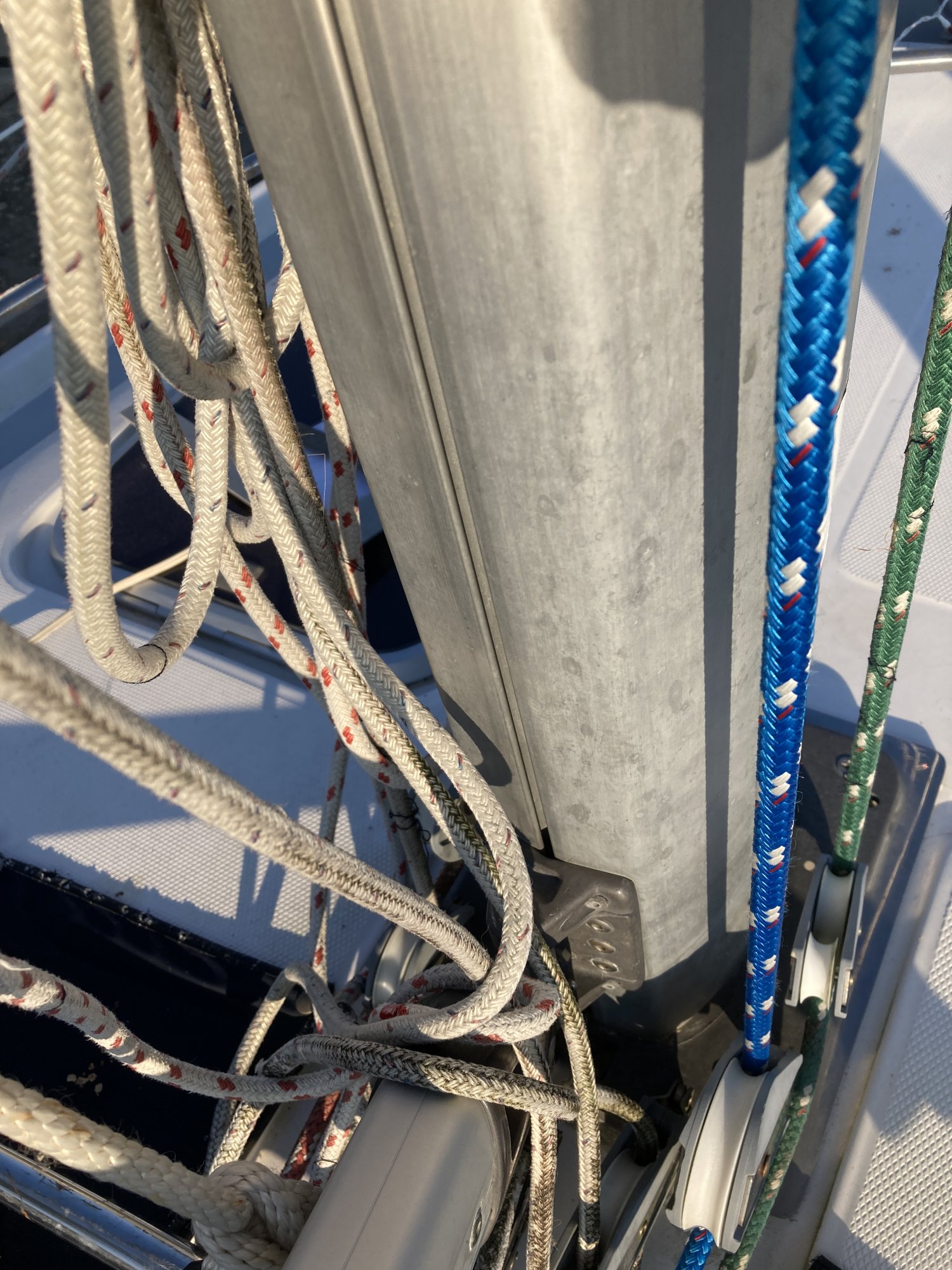

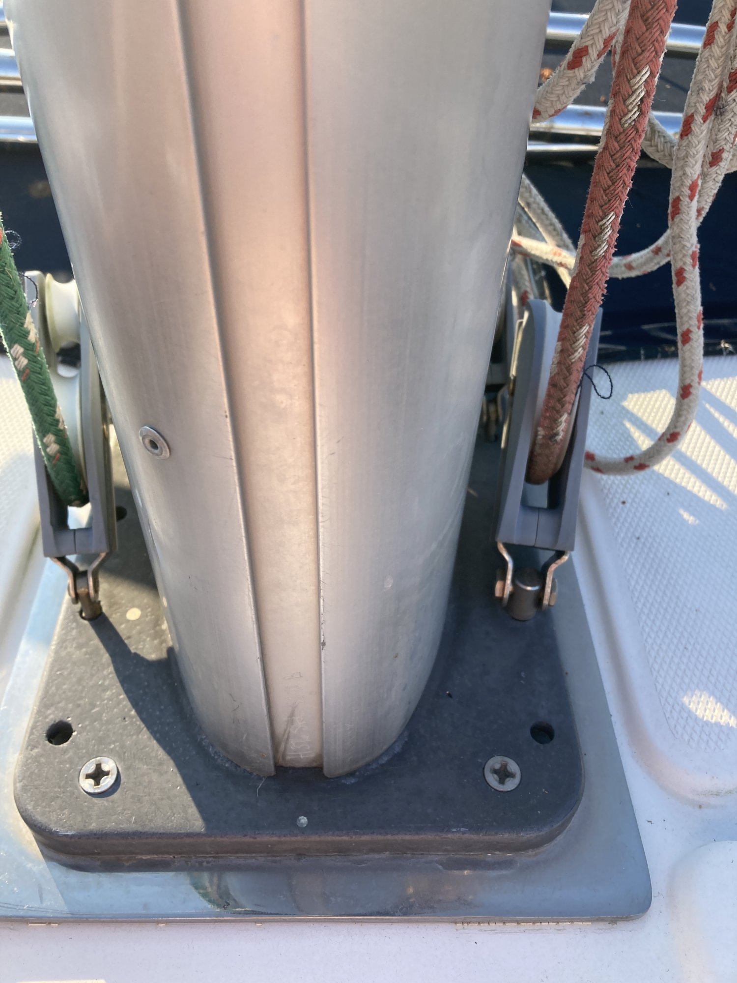

Thanks! I can't locate any mfg information on the mast. I checked out the rig-rite site, but could not find anything that matches with my base dimensions (9.0" x 5.4"). I've submitted a question to the Marlow Hunter website as well. I've attached a couple pics of my mast base in case anyone recognizes the manufacturer.

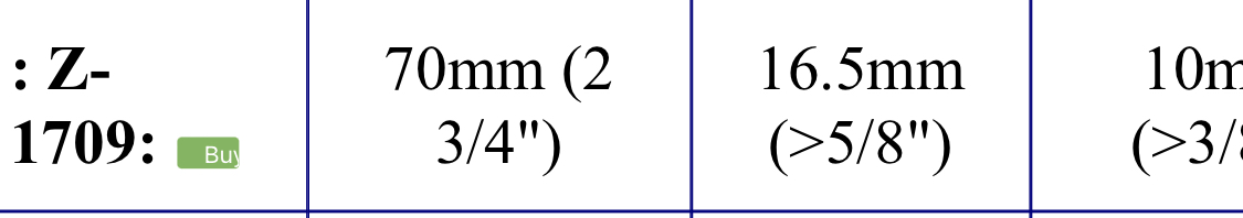

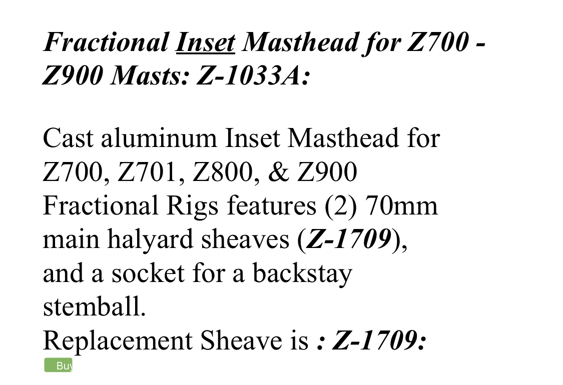

Based on the dimensions provided, I'd guess the mast is a Z-spars Z701. According to Rigrite...

I own a 2000 Hunter 380 with a B & R rig. This was the same hull as the 376 as I recall. The mast step shown in the photo is similar to my mast step which was made by Selden. FWIW.

Your mast is definitely Z-Spars. Give their service department a call with your hull / serial number and they can look it up. I did same a couple years back they they had all the details of the spec on my rig.
