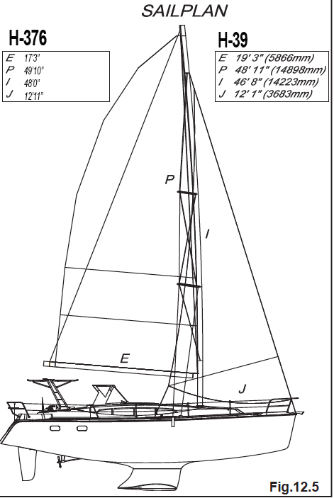

Can I use a H-39 Furling Mast?
Everyone - Thank you for your quick responses. I had found the corresponding pages for the rig dimensions in my owners manual, but when I sent this information to Seldėn they claim this was not very helpful to them and I needed to have my boat measured.
Phil, you answer my question spot-on. I was looking for what mast and boom was originally on the boat (i.e. Z601-M and Z480-B).
Now this leads to my next question:
CAN I USE A Mast from an H-39. It 2' longer but fundamentally (I believe) the same mast. Effectively this would create a Tall Mast Solution on my 376 without drastically affecting my RM 30% displacement - I've attached a side by side Sailplan comparison in the attachment.
I can pick up a 2010 H-39 Furling Mast for $1,800 if I act quickly, but don't want to waste money that wouldn't work or would jeopardize the safety of the boat.

As Phil pointed out, the cost of a replacement new mast, boom, sails and rigging is not cheap. As for used masts, they are out there but inspection is a must before buying.
Oct 27, 2011
154
Hunter 1980 Hunter 30 San Diego, Mission Bay
So it looks like $10K for the spars, plus maybe another $10K for rigging, wiring, new lights and fittings. You'll have to do the math to see if this is worth it.
I wouldn't think that the boom section is too critical, so if you could find a used boom that is close to spec, that would save a few hundred dollars. But with the B&R rig, I would think that the mast needs to be pretty much an exact match. If you converted to a conventional rig, you could probably use a section from a boat of comparable size and weight to yours, but then you are in to relocating the shrouds, adding a backstay, etc, etc. Not sure how the boat would balance out then.
