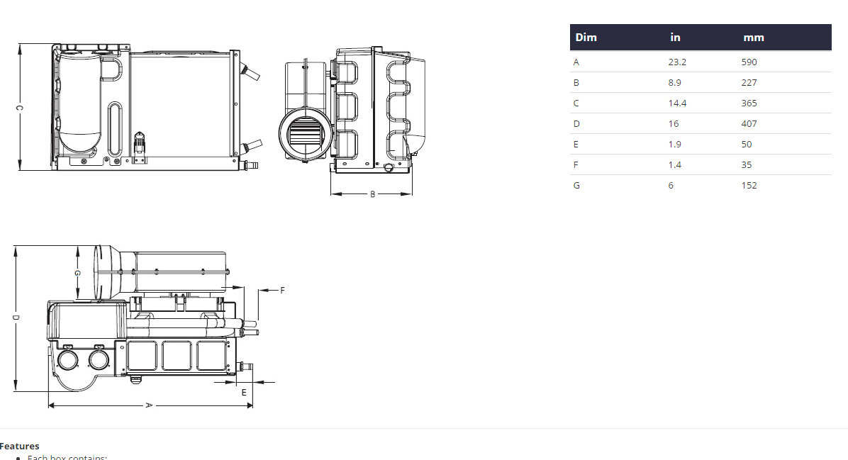

Dometic / Marine-Air - your link above. Image below of their 16K btu unit that I installed a month ago:

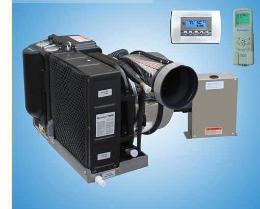

MarinAire - see https://www.marinaire.com/aboutus.asp Image below from their website of a 16K btu unit
Looks like 2 different companies to me... with similar yet different products
