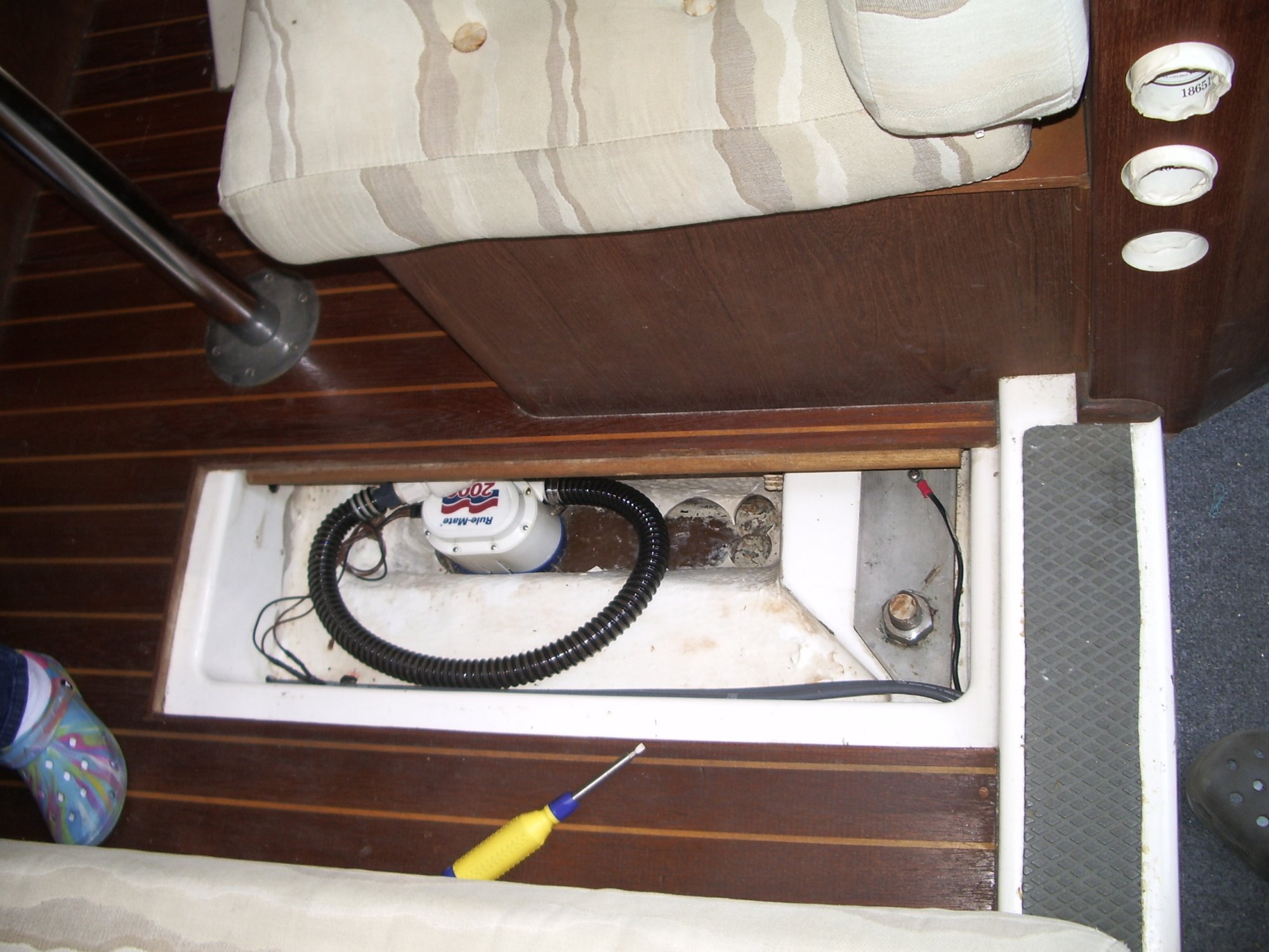

How can you tell if the false bildge had been exposed or not? I recently purchased a1984 Hunter 34 and want to do the modification, but came tell if it was done by a previous owner. I am cautious as the boat is in the water and don't want to go they the hull looking for something that may not be there. I am attaching photos of how the bildge currently looks. thanks in advance for any and all help.

I think this is the bildge "as built" and that it had not been opened up.... but I should would appreciate the feed back

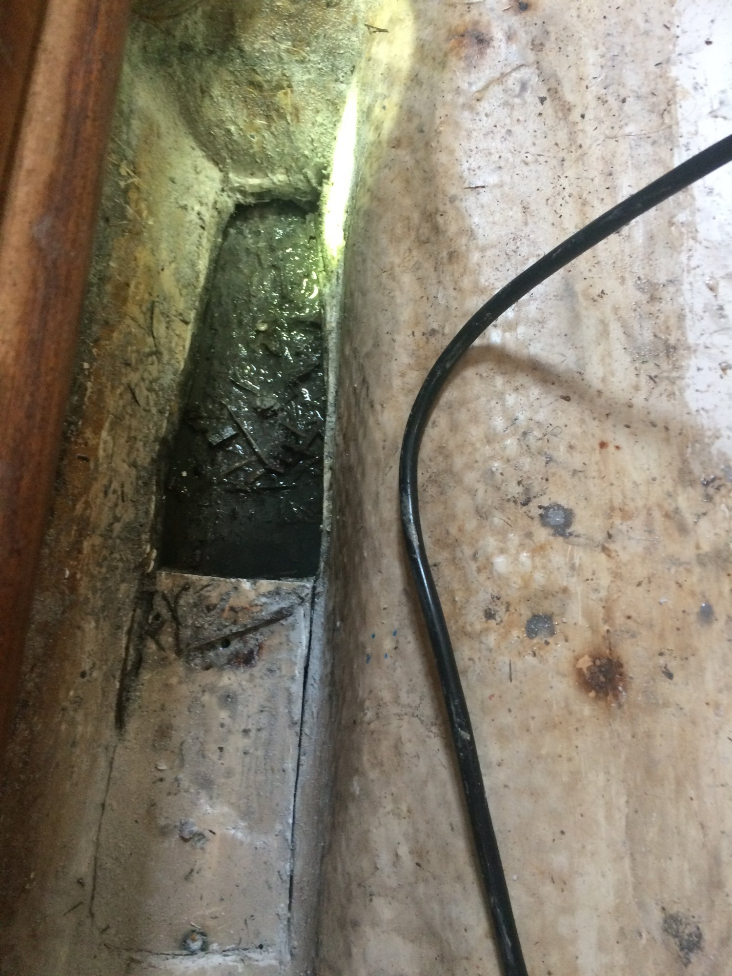

Here is a picture of mine, partially opened.. You can see the little gap or undercut and how grungy the water in there was.. You may be able to remove the float switch and probe with a tiny dill bit into one of the screw holes to see if water comes out or you find a void.. The ply false floor on mine was about 3/16" thick.. The void space under the false bottom was less than 1/2" deep.. Yours does not look to have been opened up.

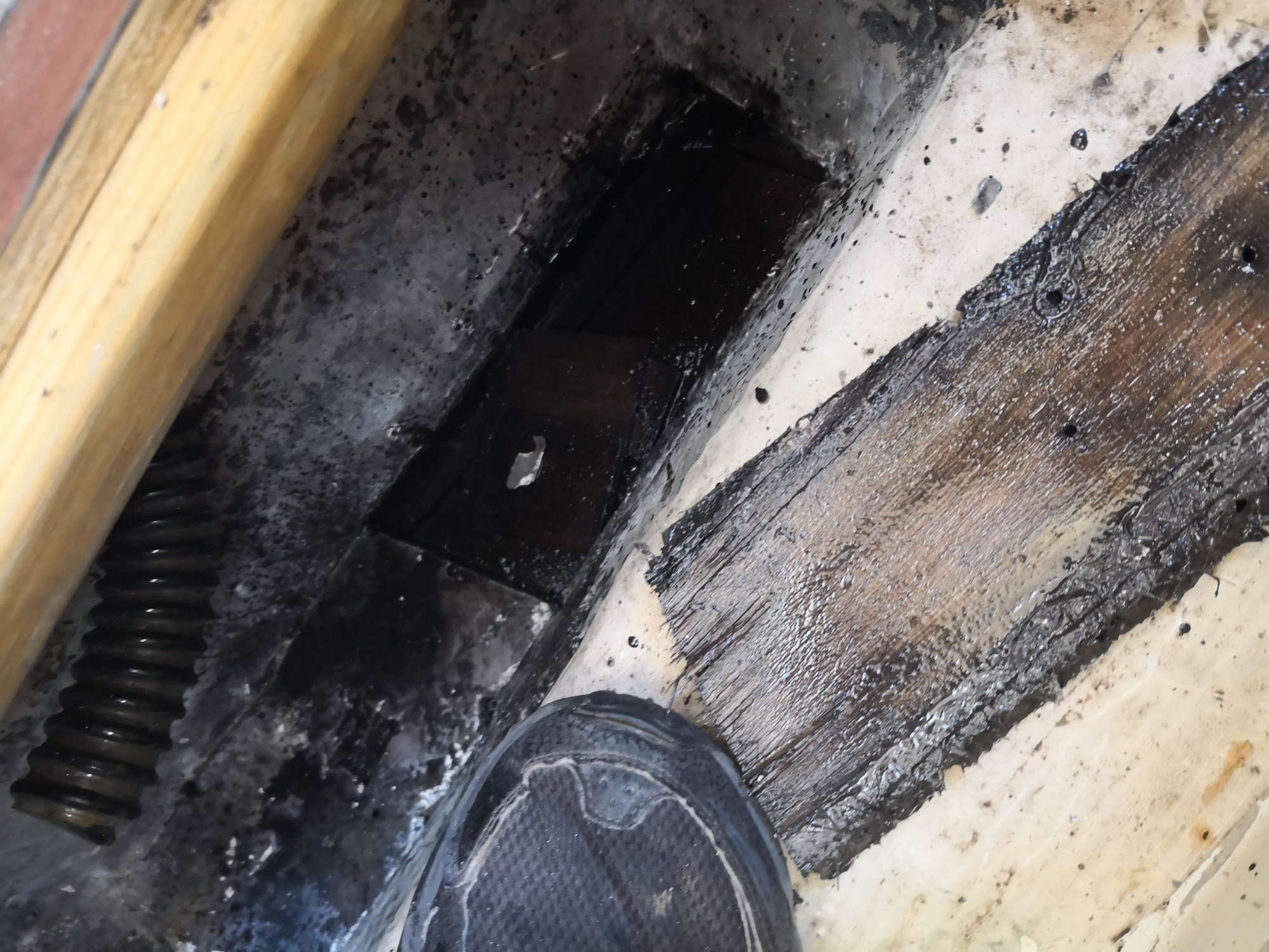

Allan, how did you open your up? it looks like a hole saw maybe?
Yes, I had a 4 in hole saw handy. Then I used a 1-3/4 in hole saw for the aft portion. I retracted the pilot bit so it did not go into the hull bottom. Much later I bought a multitool and cut off the sharp edges.
