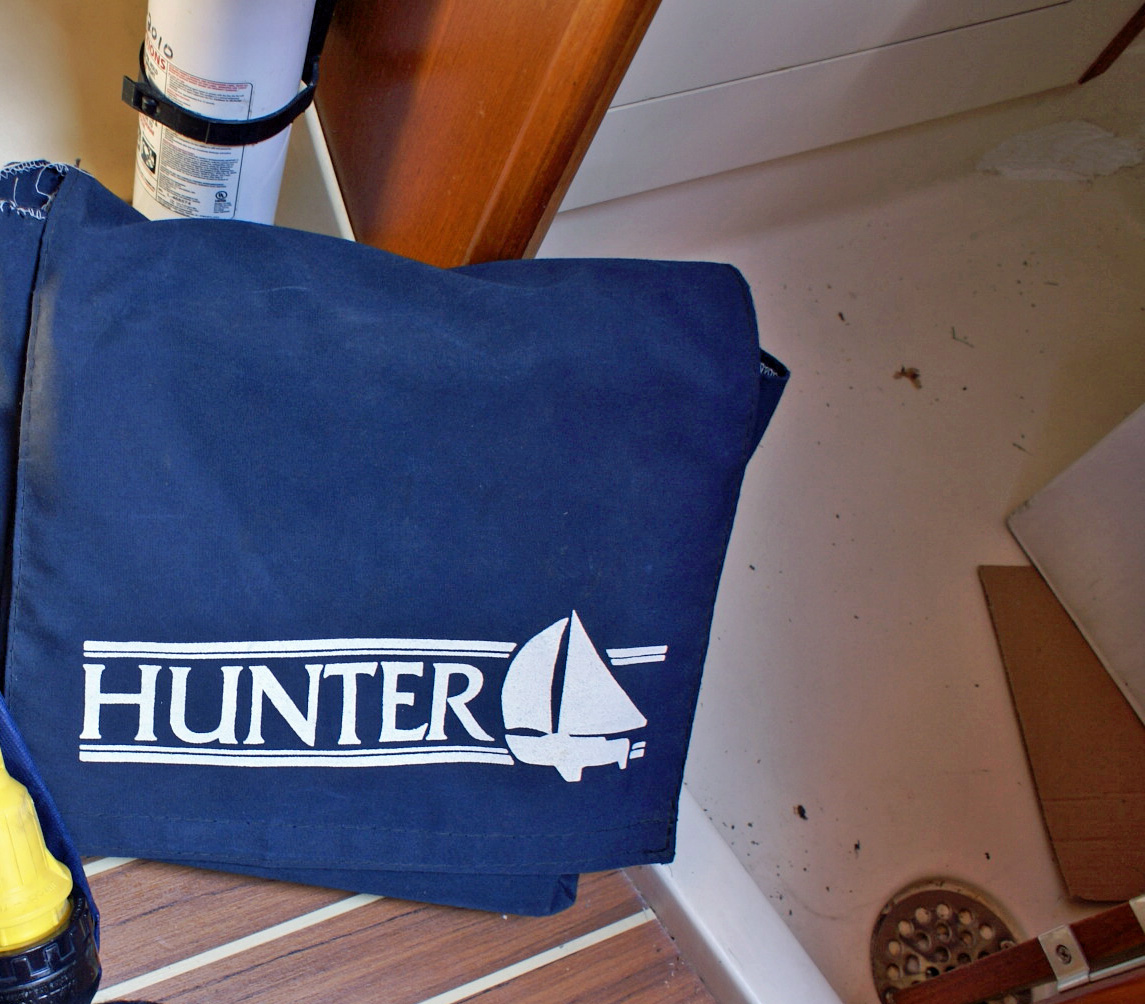

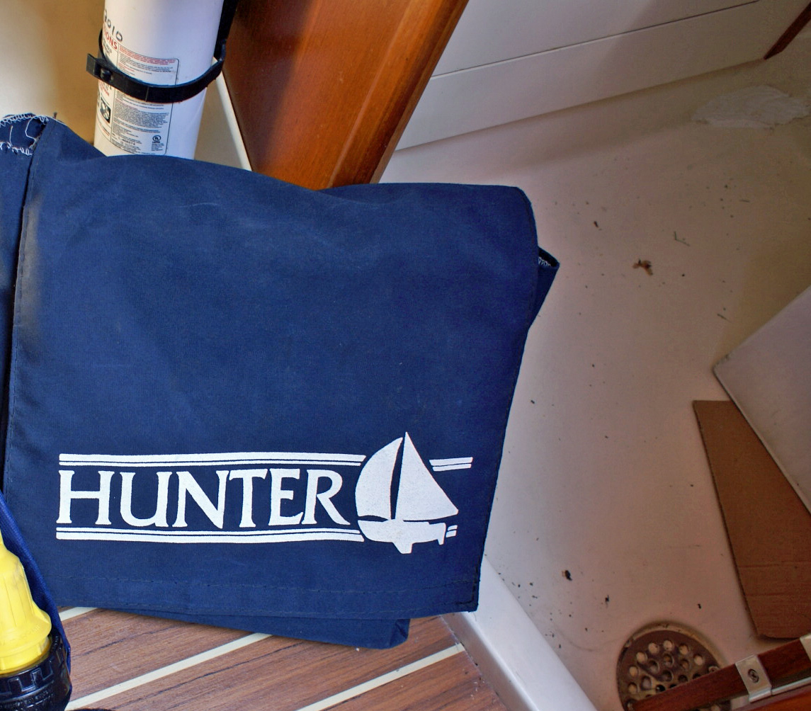

Here are a couple of pics:
a) the DIY silicon "splodge" on the edge of the head floor, top right of photo. It didn't get a mention in the survey report, probably just cosmetic damage but thought I should check here first in case there is some awareness of what might lurk within.

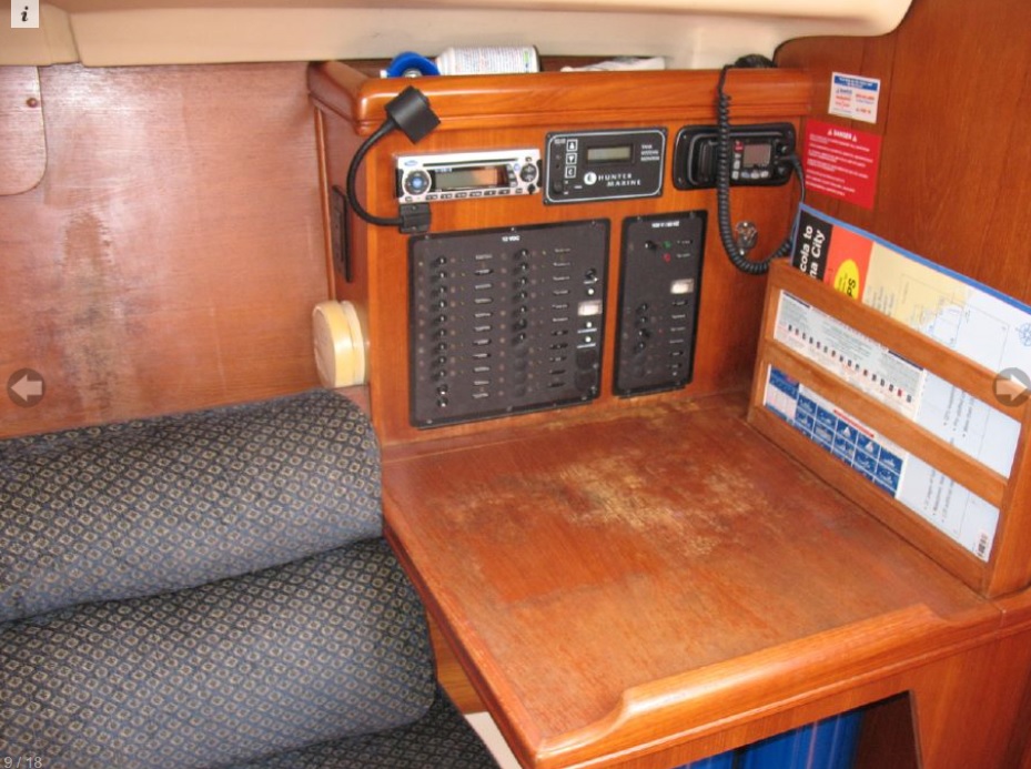

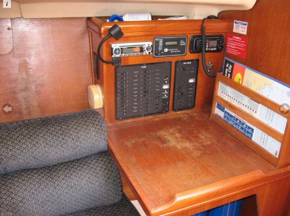

and b) the typical aging teak finish issues (this is not our boat but provides an exaggeration of our issue).
The PO may have been smoking crack when he applied the splodge. I can only speak for myself here, but I would have to know what is beneath the silicone.

the splodge is in a spot that is a common moulding defect in the glass - you end up with a thin layer of gelcoat on the mold, a void, and then the underlying glass in the corner. the thin gelcoat breaks leaving an open "wound", cosmetic but a dirt collector. normally just an easy gelcoat repair but who knows what the PO did...

I'll dig into the "silicon splodge" in the head floor and see what is revealed.

Congratulations on your purchase. The interior looks very similar to my H335.paper
I have refinished most of the interior wood. Everybody has their own recipe but this is what I have done and it looks good 2 years later.
For the nav table surface, I sanded it with 400 paper with a vibrating sander. Based on your picture, I think it will still look a bit mottled (light and dark) when you are finished. The I used wipe on TUNG oil (not teak) from Min Wax. I applied 2 - 3 coats depending on the desired color. I let it sit longer on the light parts before wiping off. Then on the flat surface like the nav table I use the Minwax wipe on poly. 3 coats.
For the sides, I sand if needed and use Tung oil only. For the sole, I removed any varnish with a varnish remover. You need to clean with soap really well. The "gray color" is dirt. Then I sanded with perhaps 200 then 400 and again used 3 coats of Tung oil. For the floors I found the most success with the brush on polyurethane. Best of luck. PS. if I could take the wood off the boat and do it at my house, it was much easier and faster. Although it could take a few days to coat everything.

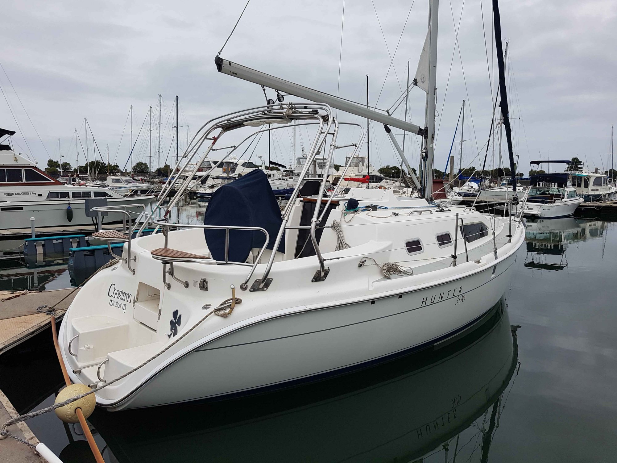

I'm back; finally! The boat arrived too close to Christmas for the trades to finish the main hull and rigging refurb but all done now and we have the boat happily in its long term berth (attached). The three blade prop gave me a good introduction to prop walk while trying to reverse in (only outboard trailer yacht experience previously) but we made some amused but very experienced new friends and helpers in the process. We live and learn! The space and layout of this boat in a compact 29 foot hull length is truly remarkable, we love it.
I'm about to tackle the "silicon splodge" and will report back on that. I also have a can of Mohawk spray lacquer on its way to patch the teak cabin trim and galley fiddles. The hull liner is in great condition but a little yellowed and "grubby" in places, especially around the cushion edges. We've carefully tried a few household products with modest success but please do let me know if you've discoverd the magic product.
