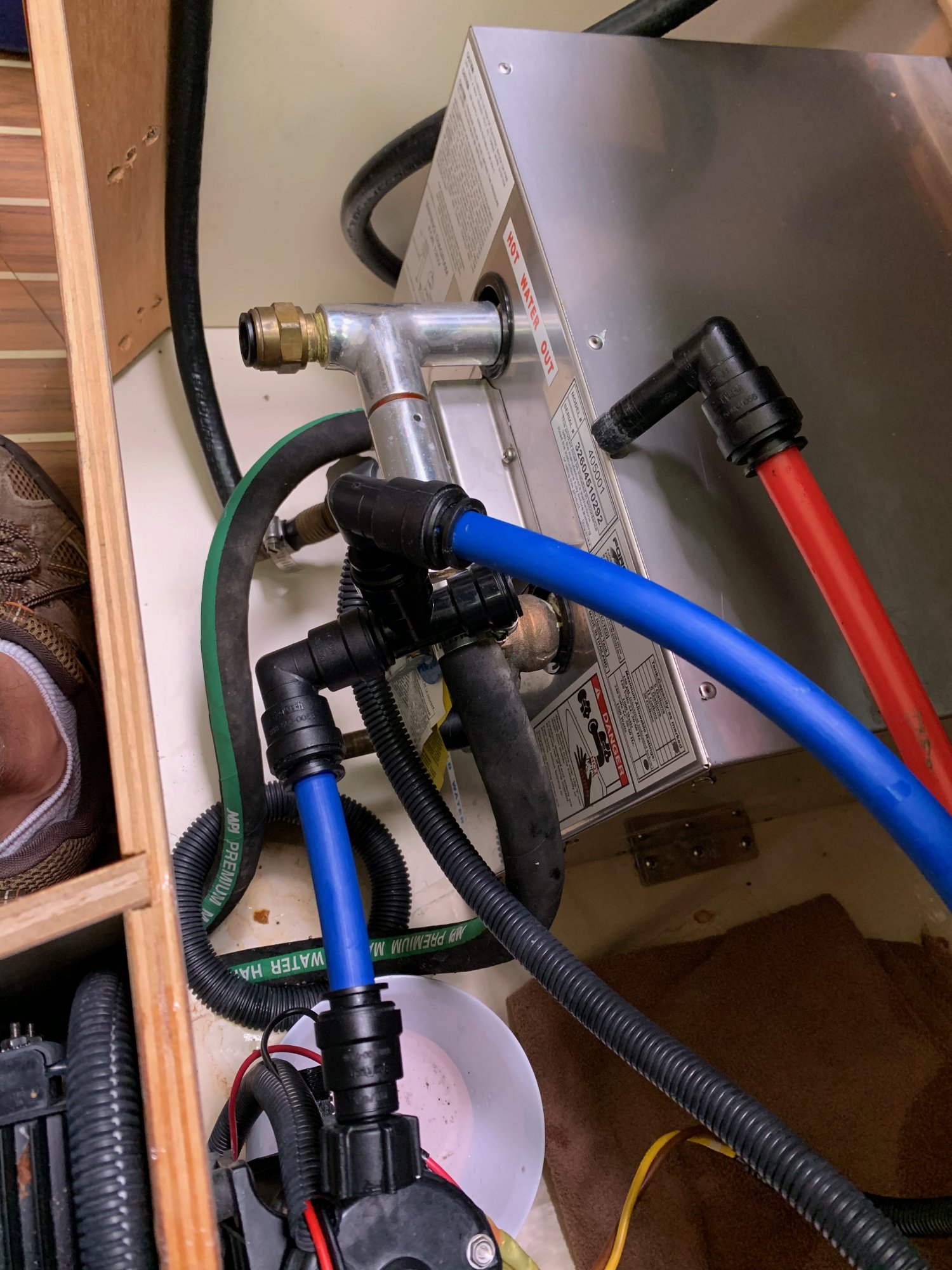

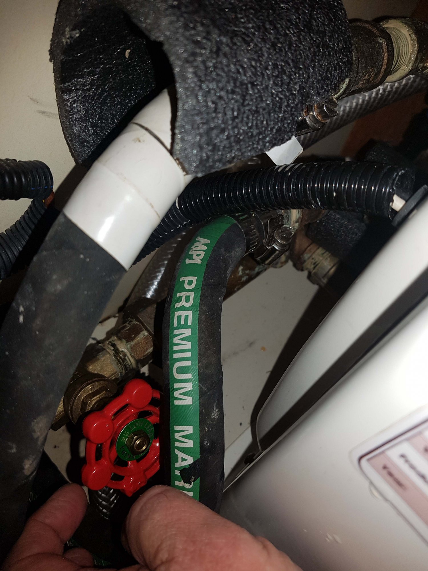

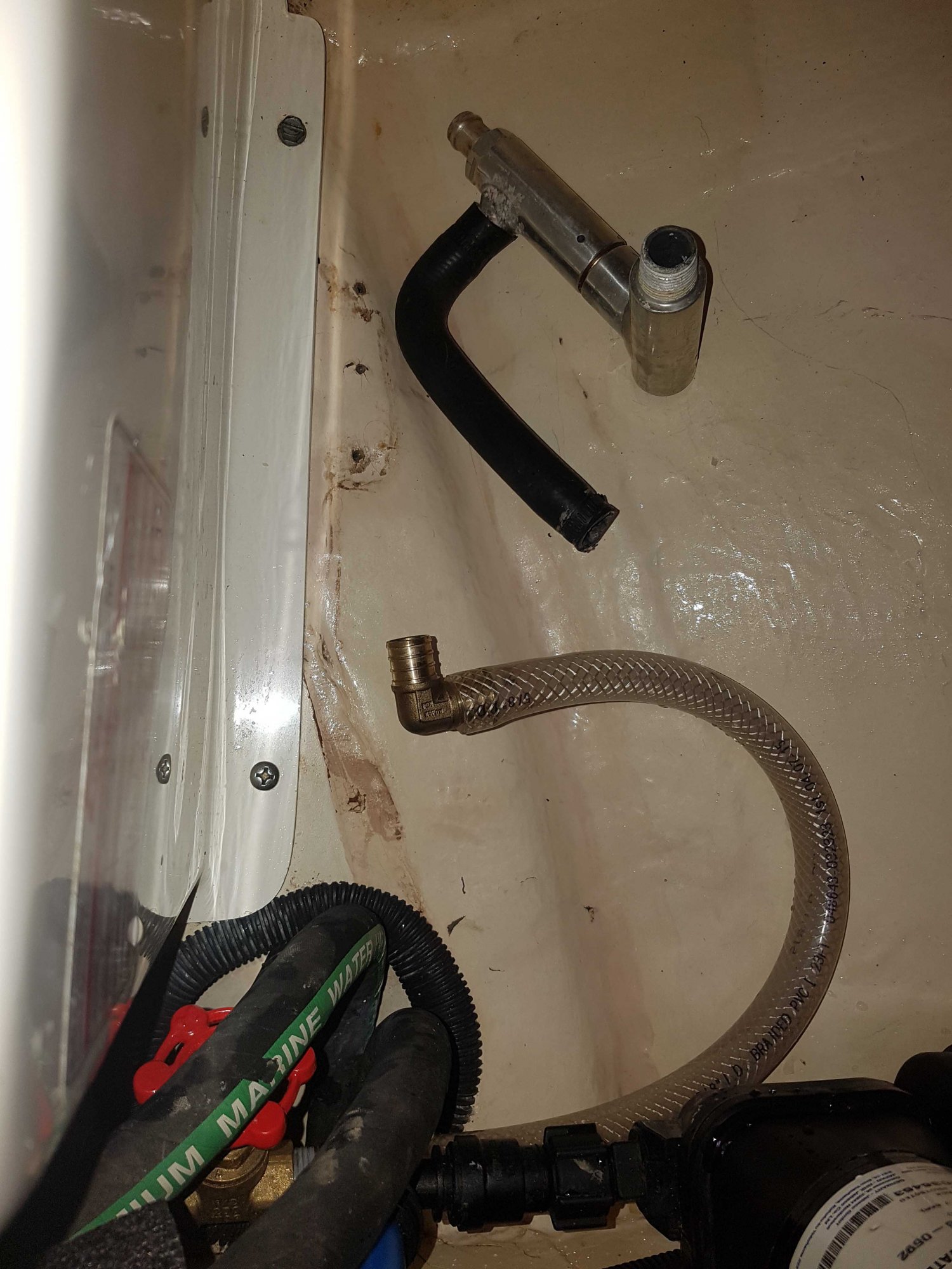

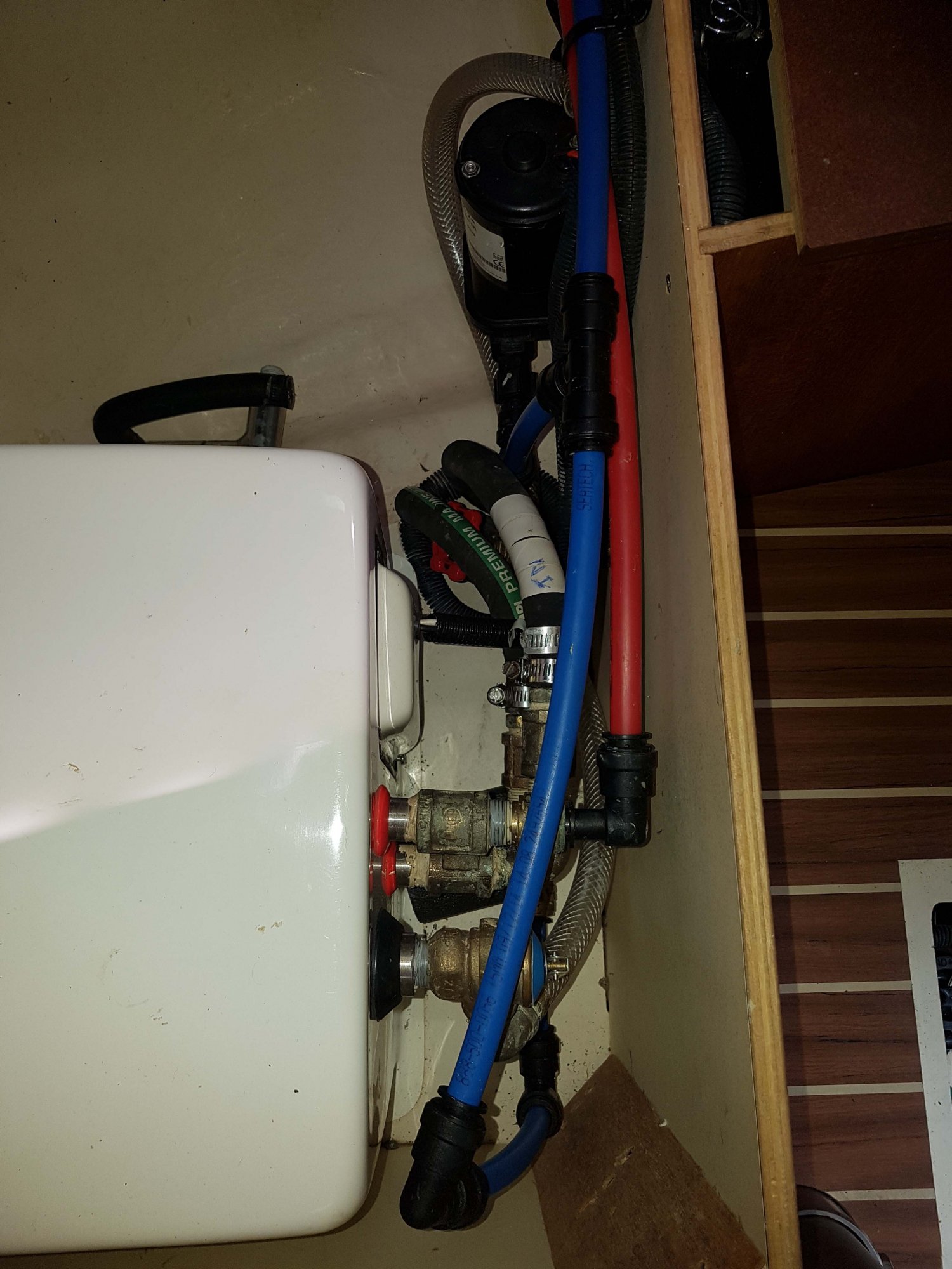

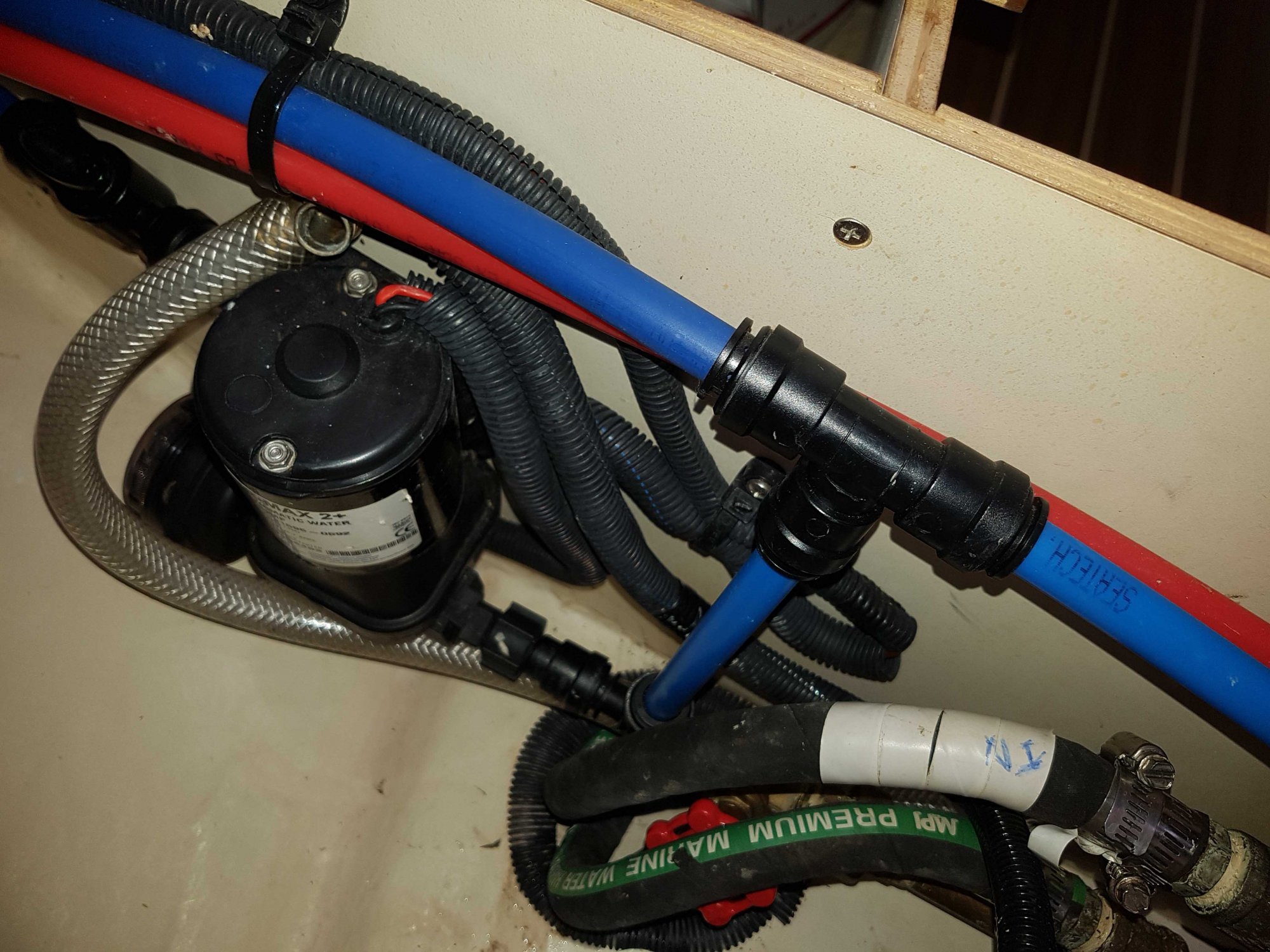

Thanks again Jay! I'll keep this next question more generic in case our boat is no longer to original spec.
Today we pressurised the water system for the first time, and as could be expected after the boat has been basically unused for nearly 18 months, there was a problem.
The good news is the water pump sprang into action and the system started to pressurise. The bad news, within 15 minutes we had a couple of litres of water in the bilge (I checked it was dry before we started). Checked the V berth where the water tank is, dry. Checked the starboard berth where the water heater and most of the plumbing is, dry. However, if you reach forward from the bilge underneath the water heater there is a shallow pool of water that trickles into the bilge. There was nothing in the rear bilge sections so we're confident it's coming from underneath the water heater somewhere out of sight from above.
The other frustrating news is that the set up and the manual don't look much alike. The page in the (2004) 306 manual is dated 1999, so I suspect several changes were made in the interim. There is a red "wheel" valve amid the main plumbing behind the water heater that was closed but I haven't yet worked out its purpose.
I'm back there tomorrow to try and figure this out but if Jay or anyone has "been there done that" i'd love to know. The hot water system wasn't activated, just the pressure. I'm thinking a water tank leak underneath where I can't see it, or a relief valve leak (drains through the hole into the bilge), or.....?
Thanks for any insight, photos attached of the area. Edit: I just checked the original sale details, the water heater was apparently new in 2016 and certainly looks new with its white enamel finish.

Your setup (near the water heater) looks almost the same as ours, except that your water pump is oriented 90 degrees to ours. Which they may have changed when they put in the new water heater. If you're seeing water coming from that general area (the heater), it should be very easy to figure out. Either it's coming from a leak in the tank on the bottom (very unlikely, since it's new), or it's coming from one of the plastic red/blue water line fittings. Oops: or it's coming from the gate valve (looks like a hose bib) which is (probably) used for draining the hot water tank. (At least ours is.) They may have just left this open when they were winterizing!
With apologies if all of this is obvious and you've already done it:
If it's not the drain, just hold a paper towel under each of the fittings and you'll find out which one it is. Don't forget the pump itself and its fittings and the filter/screen with the clear cover. Each of these fittings can be undone by hand (sometimes not easily) by sliding the little ring on the black plastic fitting towards the main body of the fitting, and then pulling the red or blue tubing out. One of them may not be seated properly. So you probably don't need to undo them: just push them in more firmly to seat them.
BTW: once you get this figured out, there's a really cool way of bypassing the hot water heater when you do winter layup by just unplugging the cold-in and hot-out from the HWH and connecting them together. You almost don't need any tools. This keeps the pink non-toxic antifreeze out of the HWH (which you do need to drain pretty thoroughly with a wet vac). But it allows you to put the antifreeze in the main water tank and then routes it into both cold and hot water tubes.

Thanks Jay - with a dry boat, a clear head and everything exposed when I pressurised the water today, the red gate valve controlling the drain output is indeed the issue. Whether it's open or closed, as soon as pressure is applied water starts coming out of the drain hose (attached). That silver hose obviously linked to the other piece of gear that is just sitting next to the tank (connects to the black hose) but I haven't got my head around the OPs original intention with it. At that particular spot, the water runs forward to the bow slowly before trickling under the tank, therefore giving the appearance of it originating from under the tank.
So, I just need to decide whether to try and clean/fix the valve, replace it, or just simply plug the drain (given we don't need to winterise here in Melbourne). There was no obvious leakage apparent at the time of the surveyors report with a very brief pressure test (from last May, how time flies!) so I'm hoping it might just have picked up some scale, dirt etc. in its travels to Australia.
Thanks again, Robert (PS if I read the code correctly we are hull no 571, HUN30571D405)

In regard to the hot water service drain leaking, I replaced the gate valve with a ball valve and problem solved. There was a lot of chalky residue that had hardened in the gate over time.
